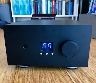

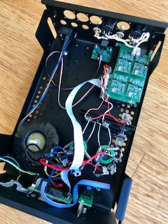

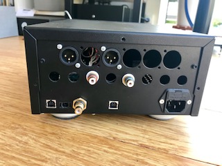

I'm selling my Mirand dac, because I have some new projects 🙂
It's the Mirand Ak4490, with, spdif and USB. Sonny's awesome balanced discrete output board. Frontpanel, and a Mirand cabinet.
Both frontpanel and output fits the new Dac AK4493.
There is also a linear psu with regulators from newclassd, mundorf capacitors, and an audio transformer from toriody.
Price 480€ plus transport for everything.
