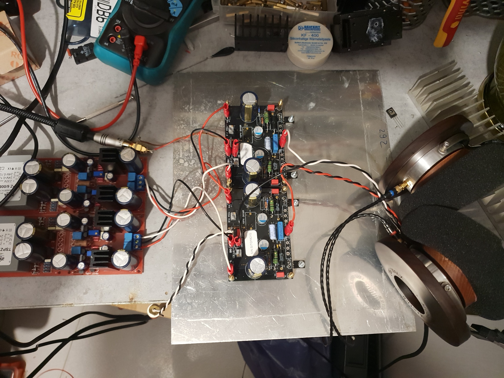

At my request, Sonny helped me make some changes to TSSA V1.8 for a headphone amplifier. TSSA is a superb amplifier and its sound is very nice. It was the same when we listened through the headphones. Total silence, crystalline voices, and the most beautiful bass I've ever heard in my headphones. Thanks a lot, Sonny!

How about heat? Also what supply and voltage are you using.
You got rid of the nasty Mosfets.... ha ha .... Sorry... But they slow the circuit down....
I have found replacement for some of the JFET's that we use. So this circuit is like a good idea for an headphone amp. And you are really fast at implementing it Vitalica.
Thanks.
Now Vitalica runs it as a buffer and the output is common cathode. So it the headphone looks into pure current drive with current feedback as well. Looks like the resistors are 100R for the KSA1381/KSC3503 which i still have in stock. So bias is 20mA. Offset voltage is easily trimmed to a few millivolts.
For those who have them in stock i have instructions for modification.
Hi Sonny ,
No heat. And instead of the 100R resistors we put 47R and set a 40mA current with a 0V offset. Bias and Offset are easy to set up and are very stable. At startup I do not have any POPs.
Voltage is stabilized +/- 25V. I really like this headphone amplifier.
TSSA V1.8 I used it only in Class A with a 2A bias. An exceptional sound.
That's why I was curious as to hear this amplifier for headphones in class A. But KSA1381 / KSC3503 a max current of 0.1A, you should use other transistors ...
But with a bias of 40 mA the sound is very good, thanks a lot, Sonny 🙂

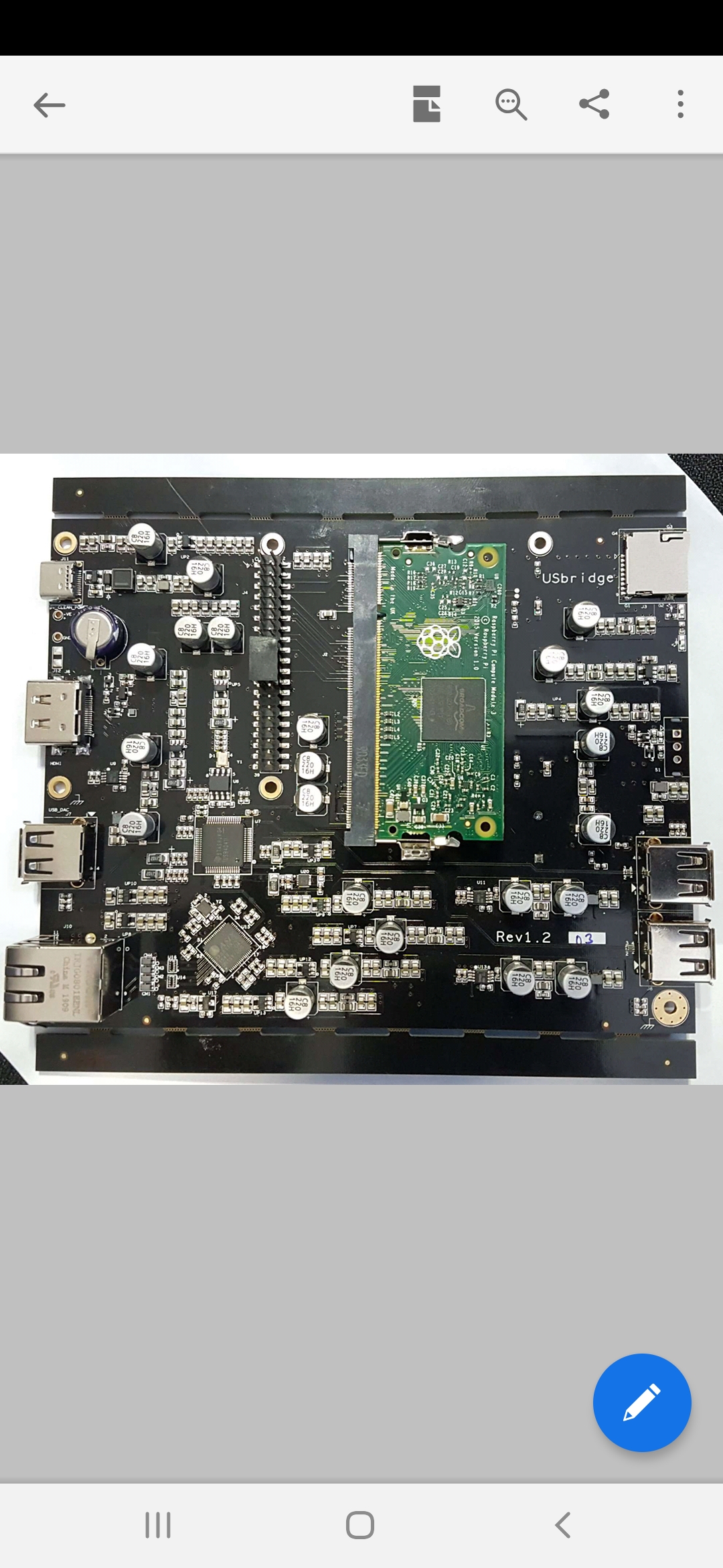

Updated USB Bridge coming to papaaaView attachment 771075

Coming in couple of months. Updated version of usbridge, good but a pain to use because the chip vendor refuse to update the firmware.I complained to allo some time back and they told me. Wait.. New product soon. But since the cat is out of bag on some other forum. No problem to release secrets.
A usbridge motherboard that host industrial cm3 rpi, without Lan or USB . Allo customises that and remove all the limitations of raspberry or general sbc
Since they can design the USB and lan. Which is very important for music streaming. They could properly design it at a higher quality thus better performance. These 2 issues cannot be solved by off the shelf sbc.
