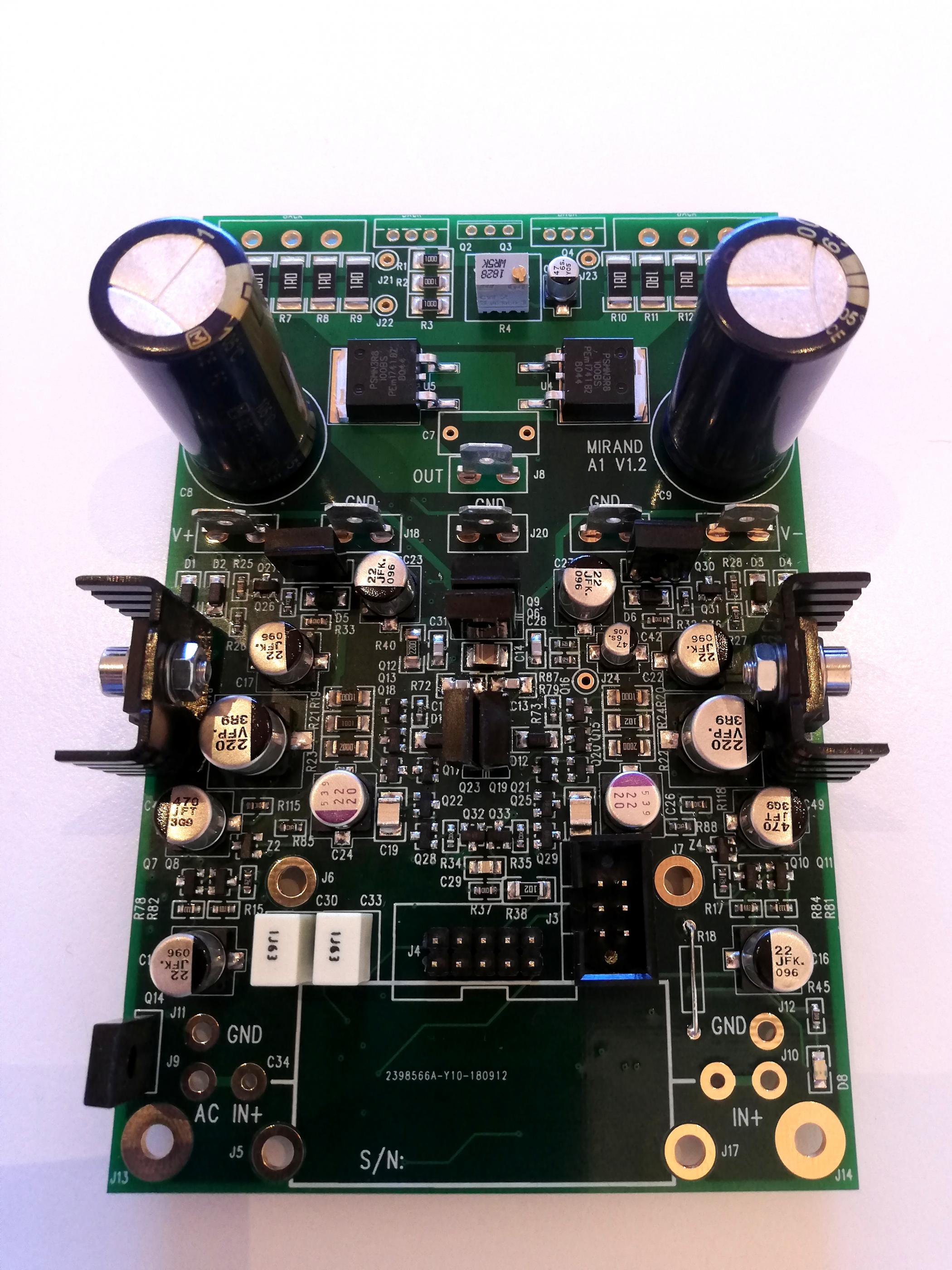

The Mirand A1 V1.2 is ready.
It is a 4 layer board and this amp is very good sounding and extremely quiet.
What we have done is that we have changed the Size to 120x80mm.
This have made it possible to add the DC and UnderVoltage protection to the amp.
We use Mosfet's with an on resistance of total 7.8mOhm making it possible to use them without heatsinks.
Secondly we have taken the Voltage regulators from the LPS V2.1 to make the +/-15V on the board..
The power supply i would suggest a minimum 300VA 2x24VAC and 2x22000uF
60.000uF and 500 - 600VA 2x32VAC or higher capacitor for an 100Watt amplifier.
It runs from +/-30VDC (1A max idle) to +/-50VDC (max 0.5A idle).. Idle is only suggestions but always take into account the heatsink cooling efficiency.
It can run stable at 100mA if you want to. That is 6 - 10Watt per channel in idle power.
Many options here.
I have attached a screenshot.
So key data:
+/-30 to 50VDC
50 - 100Watt @ 8 Ohm.
2 Ohm Stable
Bandwidth : 800KHz
Only adjustment is bias current, DC servo integrated
DC and UV protection
Current feedback
SE input : 10KOhm

MIRAND A1 V12 specs.
I have attached scope shots.
Measured slew rate is 200V/uSec.
Bandwidth 800KHz.
Distortion at +/-31V and 40Watt into 8 Ohm. <0.01%
Distortion at +/-31V and 80Watt into 4 Ohm. <0.01%
Bias during test : 35mA
total current consumption :100mA
Power disipation : 6,2Watt at +/-31VDC.
DC protection is tested and starts to kick in below 5 Hz. Above it does not limit.
Undervoltage lockout is below +/-21VDC
Many options here.
So key data:
+/-30 to 50VDC
2 Ohm Stable
Bandwidth : 800KHz
Current feedback
SE input : 10KOhm
