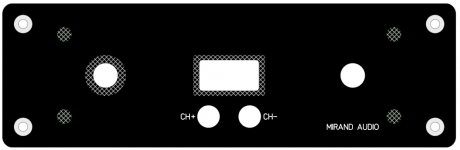

Frontpanel for preamp.
It is 220x70x4mm power coated black.
It will have a small OLED from adafruit model 938 (At least adafruit until i have found the the manufacturer of the Display).
The display is 29x15mm so that is enough to show basic information. Volume control is done by encoder. (24 clicks/turn)
BR
Sonny
I want it to be for both....
My biggest problem right now is that it would most likely need to be 330 wide rather than 220mm. My dream was half width but that is not possible as the preamp board is 130 wide, IEC inlet is 40mm and then i need to find space for bindingpost within 60mm.... that is not possible but with additional 110mm there is space for DAC or RIAA as well.
BR
Sonny
Fun you mention it. I have several times thought about suggesting 330 mm, also for my coming poweramp. My old Quad 34, FM4, 405-2 set is that with and beautiful to behold. To my eyes 330 mm just looks more "right" and easier to combine with other things in the rack. But that is just my view. BR, Per
