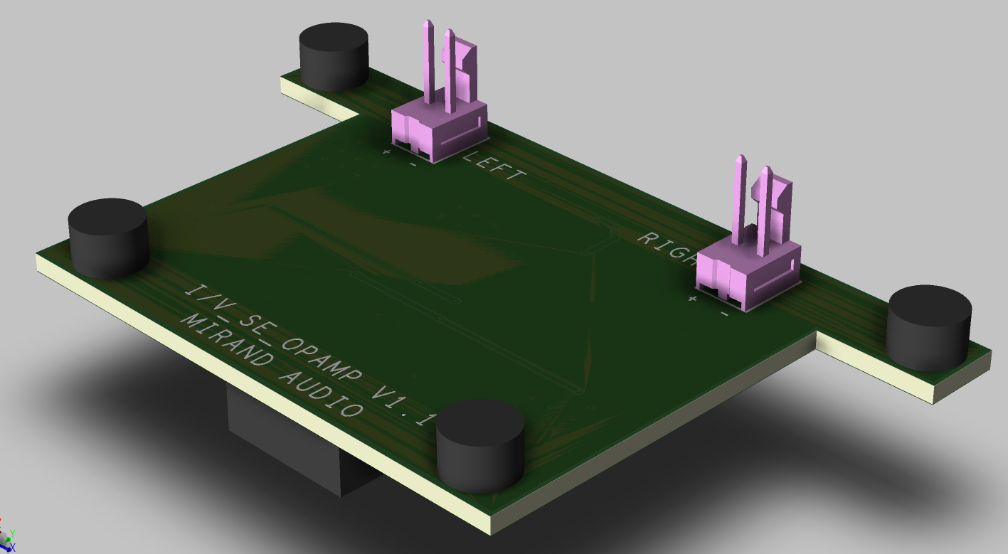

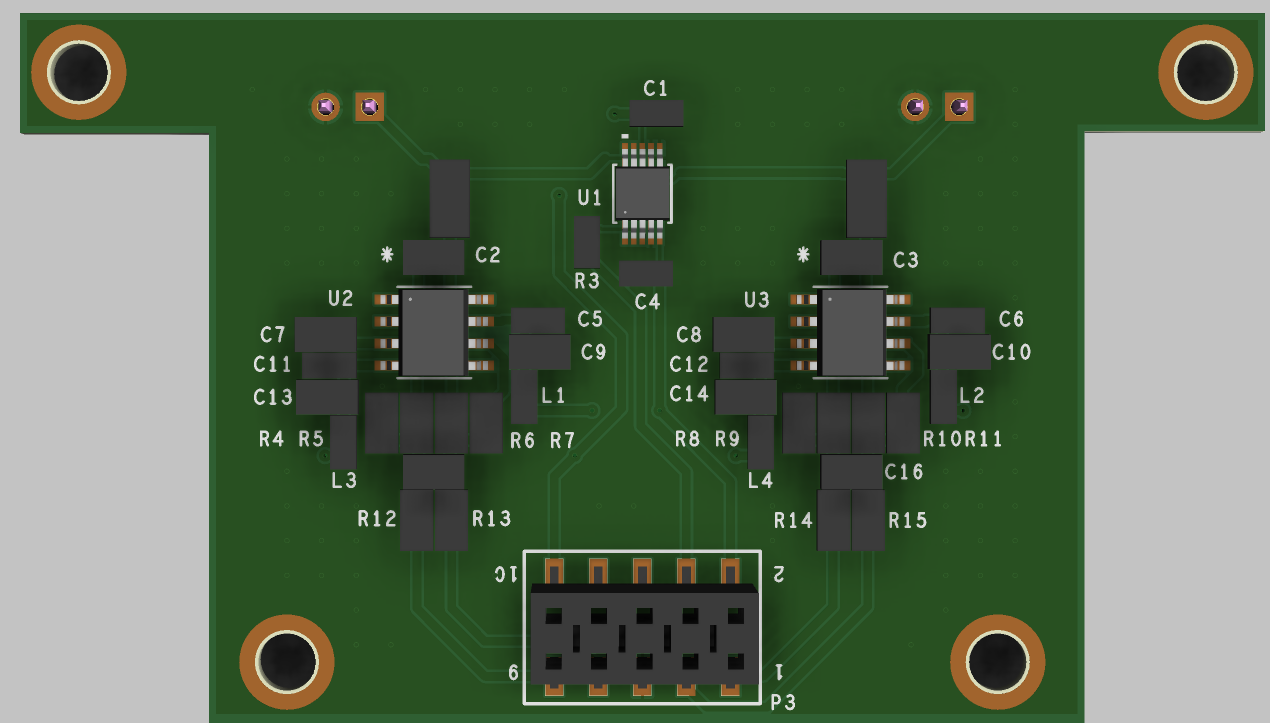

PCB I/V to SE OPAMP V1.1
This is a new board that uses the same mute circuit as the Discrete output shield.
It shunts the output to GND during mute giving a pop/click free transition on switch between DOP/DSD and PCM and vice versa.
In the filter stage it is populated with OPA1641AID, thinfilm resistors 0.1% 25ppm, PPS film capacitor 2%
It will also work fine with ES9038Q2M but in Voltage output mode.
39€/pcs
- Sonny

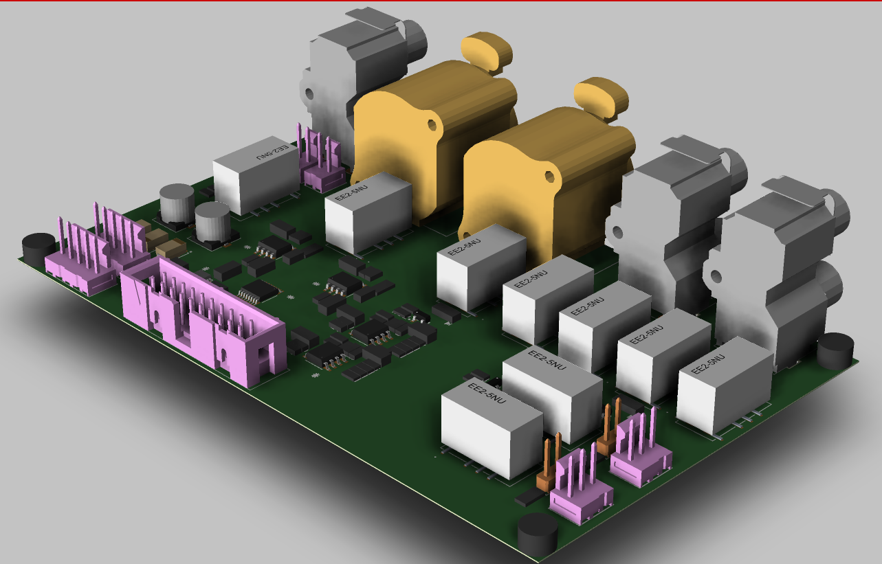

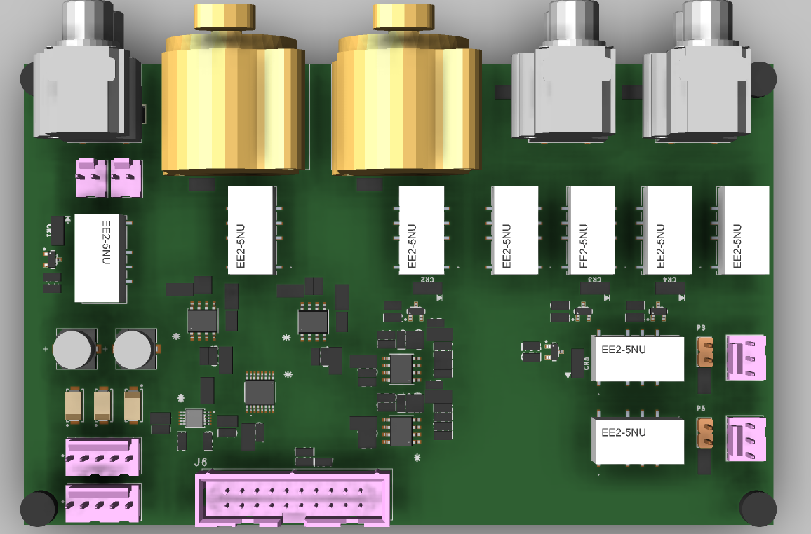

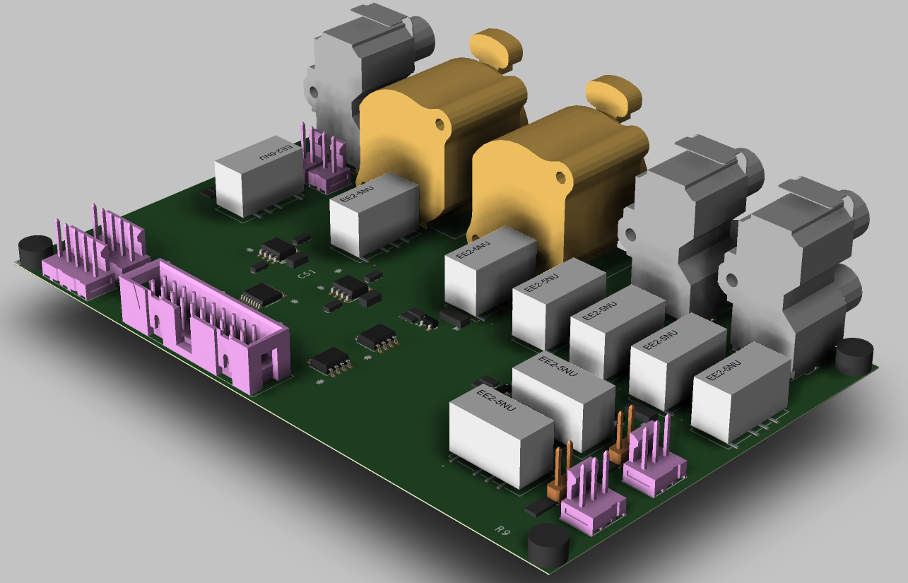

Preamp OPAMP based. (Have not given a name yet - Poor mans preamp .... nahh Ideas are welcome)
I have been working on this preamp board.
It will be finished by the end of the day.
The Volume control is based on the chip (R2R DAC) used in the Discrete preamp V1.1
The features are:
  • Width x Length : 125x80mm
  • Opamp based (OPA1641AID but alternatives can be used)
  • 4 channels input instead of 5.
  • 1 x XLR input
  • 2 x SE input
  • 1 x SE output on RCA and Molex 2 pin connector
  • 1 x internal balanced input on molex with jumper for SE support
  • Cable compatible with Preamp Discrete V1.1
  • Same interface for OLED display
Price wise it is 254€. And as all the connectors are on board. It would be very easy to implement.
A solution could be :
OLED display : 127€
Preamp : 254€
LPS V2.1 : 120€
The features are:
  • 1 x XLR input
  • 2 x SE input
OLED display : 127€
Preamp : 254€
LPS V2.1 : 120€
Just curious: Will the gain be selectable? All the best, Per
Sonny.. I do not know, do not want to push strong but I did find it a nice idea.
With today's opamps I think very high grade circuits can be built.
OPA827, OPA828, but also OPA1641, 42, ADA4627 or ADA4898 come in mind. I have used all of them and all of them have very strong points..
Presently I'm using the OPA828 with great satisfaction in a key position.
A careful layout, good quality feedback and bypass parts and it is almost there with the discrete circuits..
And no, I am not using them right now in Your output stage. The present, modded Sito modules are just gorgeous.. 🙂
Ciao, George
Ciao, George
I do agree with you. Also, the price delta between the two preamps could make this opamp version very popular.
I would, however, put in DIP8 sockets for those who like to do opamp rolling (in the DIY spirit).
Do
Sonny,
I see you've put in XLR and RCA jacks on that preamp module. Will you be doing conversion from and to balanced/unbalanced using the opamps?
Do
All inputs are handled as differential to overcome problems with ground loops. From the differential it is converted into single-ended. So it has only single-ended output.
The opamp's can as Joseph K points out be any of the types mentioned. But i will consider the OPA827/828 to be standard.
Feedback network is thin film resistors.
Bypass caps are 0.1uF X7R 10% close to the opamps.
I will put 25MU105MA23216 (1uF PML CAP) in parallel.
They (opamps) are all isolated from each other by ferrite beads.
Ok, for a first time in a long time i am releasing the schematic of a board.
I am only doing it because there is no of my discrete designs in it.
For the DIY community it is good to have, for modification.
As said i am upgrading the opamps to OPA828ID as suggested by Joseph.
To keep the price with the changes done. I need to start a production of at least 10 pcs.
So the price is 254€ for this board including VAT excluding shipping.
The price for non EU citizen is 203,2€ excluding VAT.
