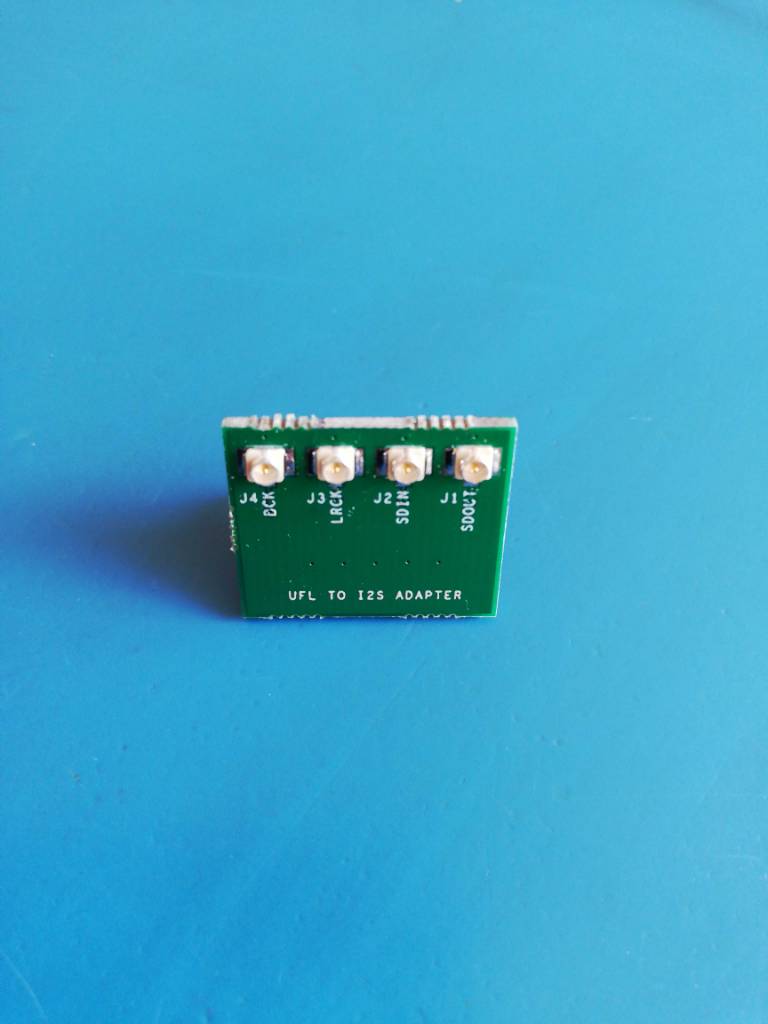

The i2s reaches to dac, will it go through reclocking at dac? If it is where does it get the clock?
Lateboomer,
Though it should be responded by Sonny, and he will for sure give You the correct answer, let me try to express the impression that I get about your 'quest'.
The I2S input is an auxiliary input in that V1.2a dac modul. It is getting through the SRC chip, asynchronous reclocking. It must be so because the dac core is always running from it's own, high quality fixed frequency clock. The external I2S signal is existing in it's own, independent clock domain. To synchronise these two clock domains one has to do something, and Sonny had opted for the texas SRC4392 chip.
So your I2S signal first enter the a-synchronous reclocker, gets resampled and finally gets re-clocked by the local, high quality clock.
So do not worry about the I2S signal path quality.
It cannot be maintained at the same ultimate level as the USB input path is handled.
For getting the maximum treatment for external I2S signals, a better option is a new dedicated dac only for this kind of application. That would come ! without any local clock, You the user should take care of clock quality, signal integrity, etc. Sonny offered this solution earlier on.

So I would suggest: just use Sonny's dac in it's best, maximally optimized (as originally intended) form.
If you wish, insist on in taking into your own hand the handling of the input data path & and providing an external high quality clock - (possibly controlled through measurements, so as to be aware of any problems maybe getting into the picture..) then there are other solutions, one of these could be the above offer of Sonny.
If you can convince him doing it.. 🙂
Reassuming: in my opinion, the path You would like to follow is reasonable, but it is not realizeable contemporarily in the same dac topology. If You wish direct I2S input, you need a Dac without local clocking.
A different structure. The designer of such a 'dac hat' had given up on fully controlling the final quality, it is totally up to the user and his actual realization.
Sonny offers a complete solution, fully controlled &guaranteed quality by him- but not promptly re-configurable for maximum quality for a signal with external, independent clock domain.
The two clock domains must be synchronized somehow..
