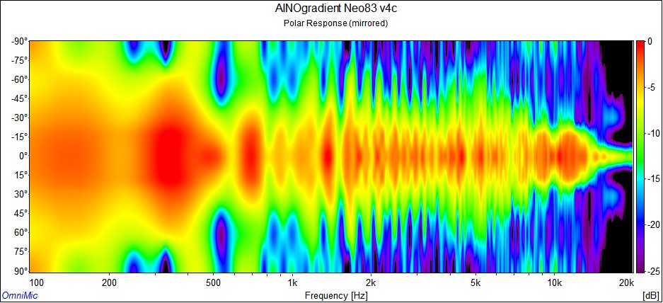

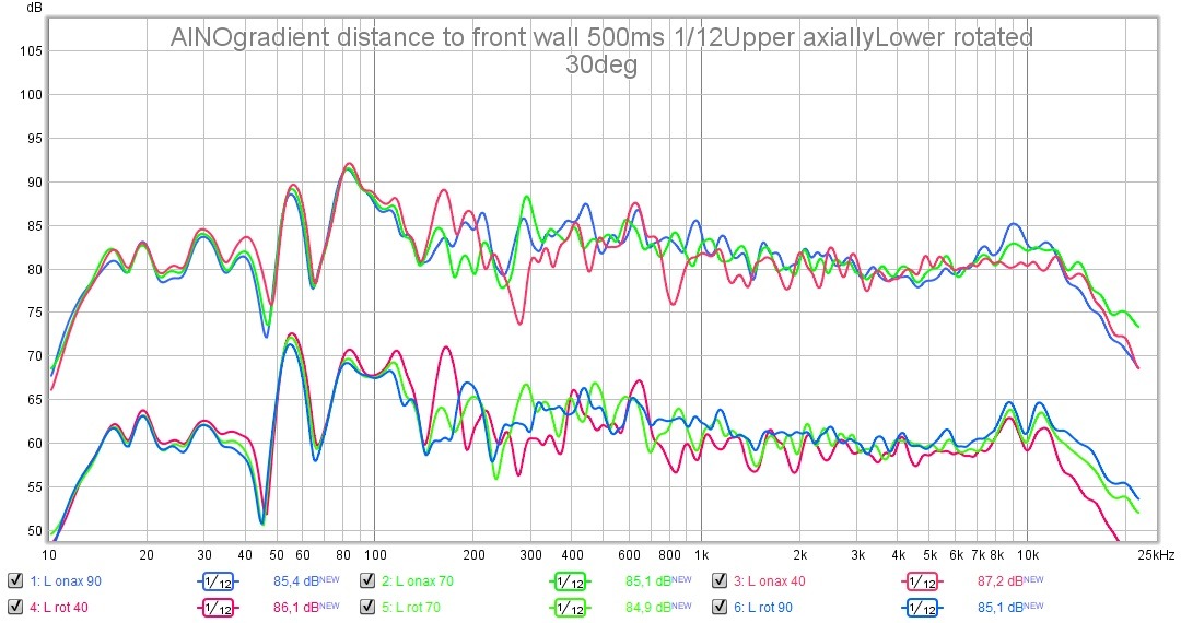

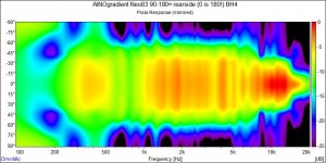

If I look Bushmeisters OB polar measurements, there are visible dipole peaks at post The 'Circles of Doom'.....Open baffleless full range speakers.Why on tweeter responses no dipole peaks and minimums visible?
As my estimation lower tweeter first dipole peak is probably at about 3-4 kHz, first minimum at 6-8 kHz, on higher tweeter little higher, but for both no trace of peaks and minimums in polar plot. At dipole peak this kind of OB speakers (basically small U-frame OB) as are your tweeters, must have nearly omnidirectional polar response.
on 2.8 kHz and 8 kHz but Juhazi had avoided them on his bigger baffles.
Where is the magic?
I'm travelling, I can answer on Sunday. But I guess it's the minimal baffle and some smoothing. My avatar is normalized to on-axis.
Please go back some 5-6 years in this thread!
Where is the magic?

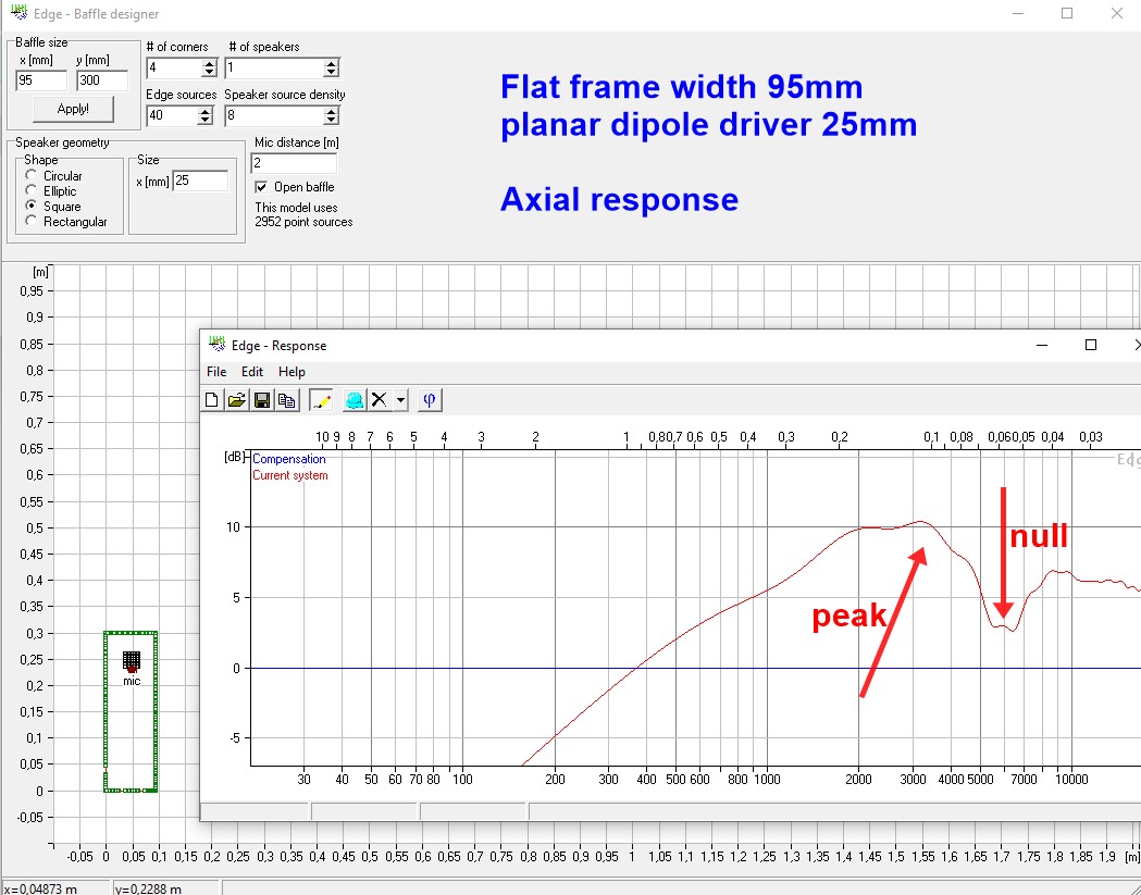

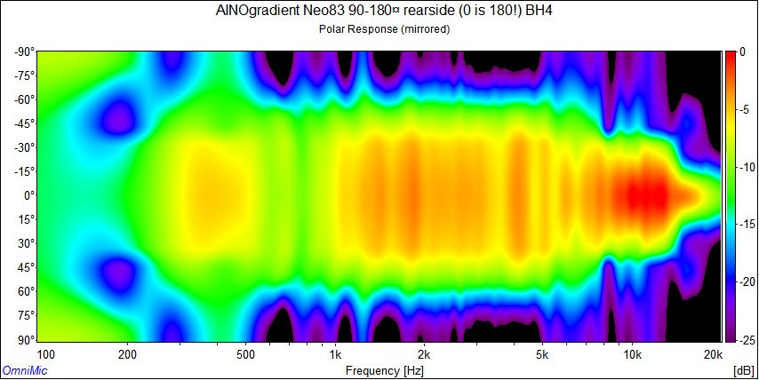

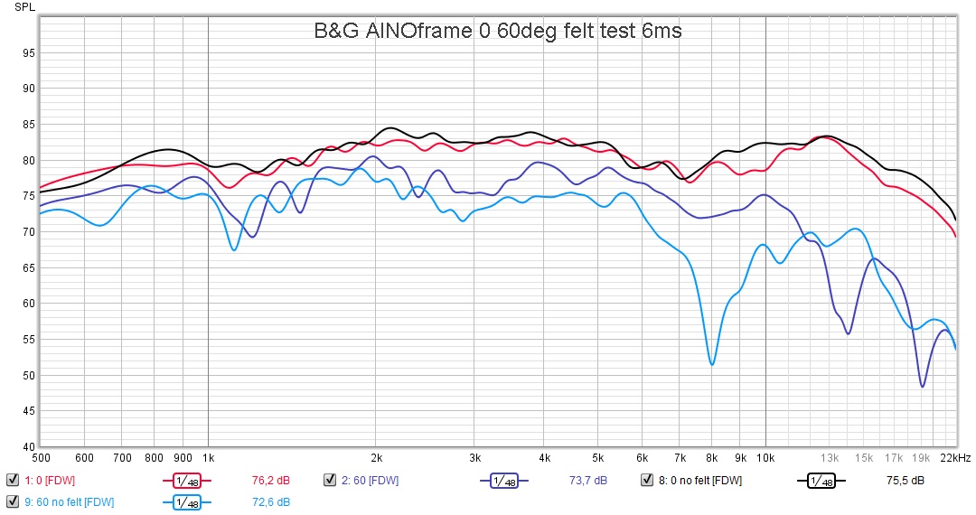

Every driver in any frame has dipole peak an null, and at null directivity is much wider than in dipole range. Above dipole null, directivity follows the same rules that a monopole driver has, determined by radiator width and frame width (narrowing towars higher freq.) "Ideal dipole patern" happens up to dipole null, so each driver must be lowpassed an octave below that (haf the frequency), so that directivity problems will be attenuated and compensated by the highpassed driver.
A planar driver has very symmetric directivity in both directions, but cone/coil driver's backside patern is pretty much disturbed by the spider and motor structure, specially abouve 2kHz.
When a planar driver is attached to a frame of some kind, it is important to make the frame as much acoustically transparent as possible. This means minimal thickness and smooth contour. Hanging with wires is best solution in this regard.

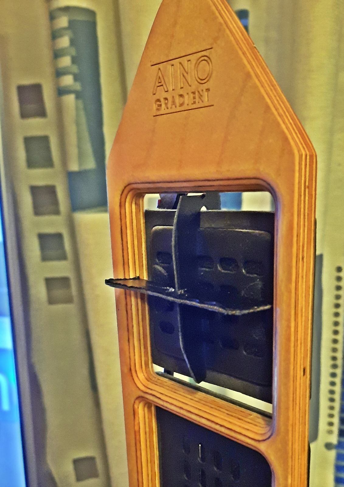

AINOgradient speaker has 8mm thick plywood frame for the upper mid and tweeter, which are planar units. Inner edges of the cutout are rounded with a file and drivers are attached on the backside. This means that actually backside response is smoother that frontal!

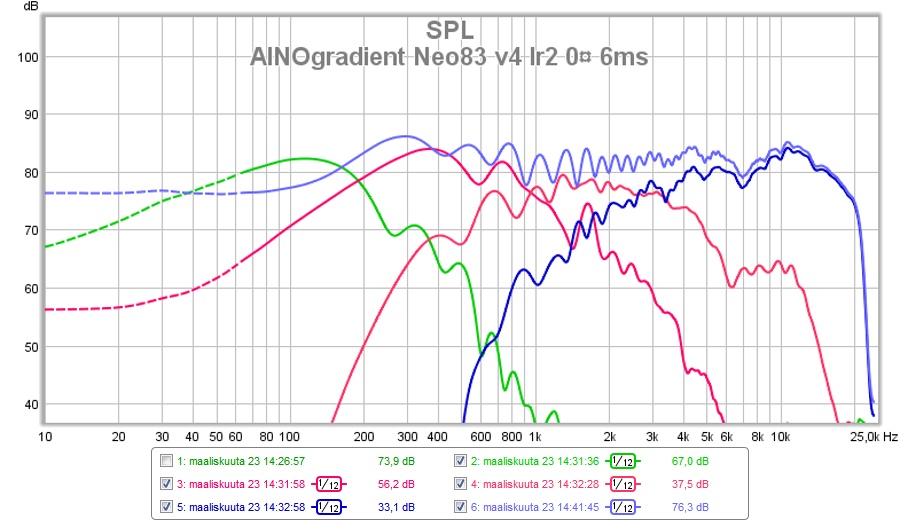

Attached a sim in Edge and several different non-normalized responses. After those polar measurements I have added felt pads to make tweeter's width narrower, which made response eve smoother, but I can't hear the difference.

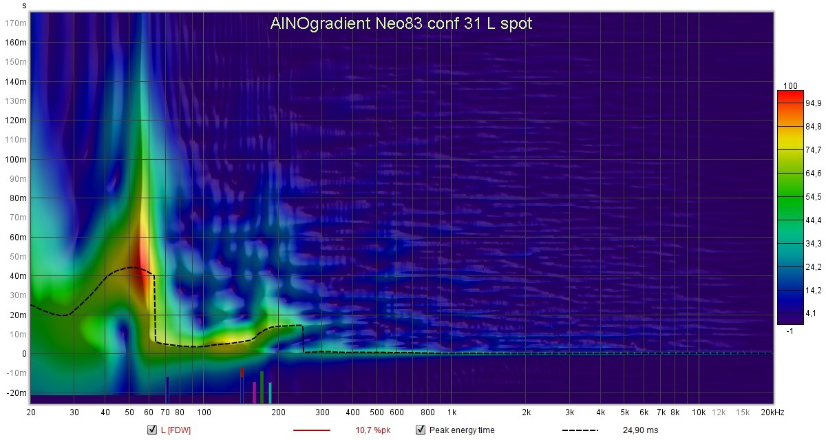

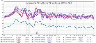

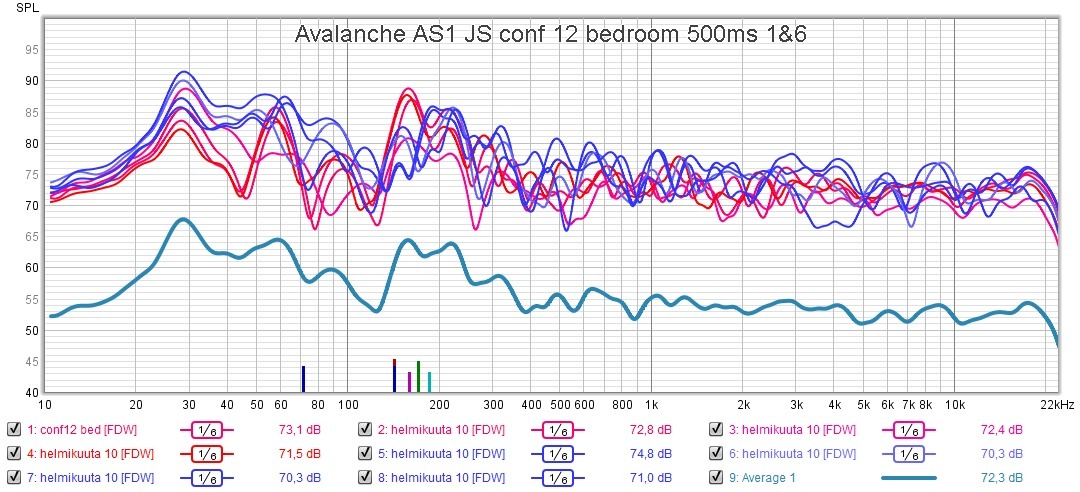

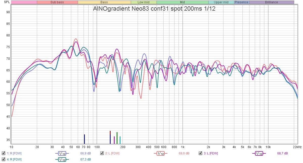

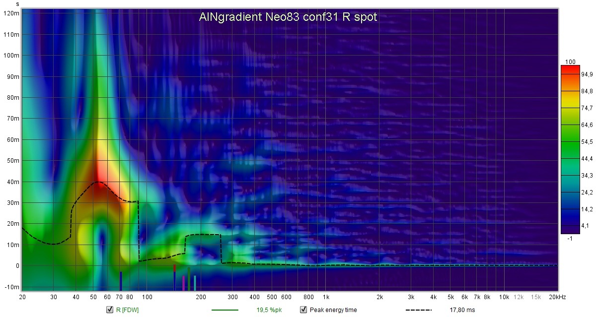

I had holidays for 2½ weeks and because of covid and low outdoor temp spent lots of time listening to AINOgradients and Avalanches. They are in different rooms, so maturally they sound very different. One common feature is sealed box bass with dsp, so lowest bass has similar prescise adn solid nature. I made som "tuning" for both and tested a divider for the dipole Neo3 tweeter of AINOs.

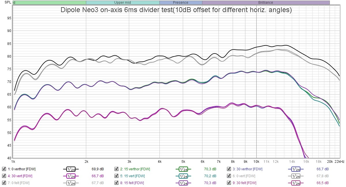

Planar tweeter has always very narrow radiation above 10kHz, and Neo3 has on-axis dip around 8kHz. I tested what a divider might do, so I took scissors and an old mobile phone's wallet and butchered it to make a cross on the frontside. Sad to say change in response was minimal by measurements and I couldn't hear any difference. Measurements were taken at 40cm axially, indoors. One on-axis response is widely different, it obviously had a different mic location.
Then I connected minidsp to laptop and made some changes in subwoofer's lowpass/eq, because some male speech voices were too heavy. Bass response is always very difficult to eq because measurement techniques leave many questions, and heavy room effects. I make final choices by listening, when measurements start looking good. My listening spot and speaker locations have been the same for all the time (almost 9 years now), and 55Hz room mode is dominant. I have tried taming it, but then my ears don't like the sound at all. I don't use any other high Q peak corrections either for room response, for obvious reasons (multipoint measurements!) Despite of cardioid pattern, 200Hz range looks nasty too.

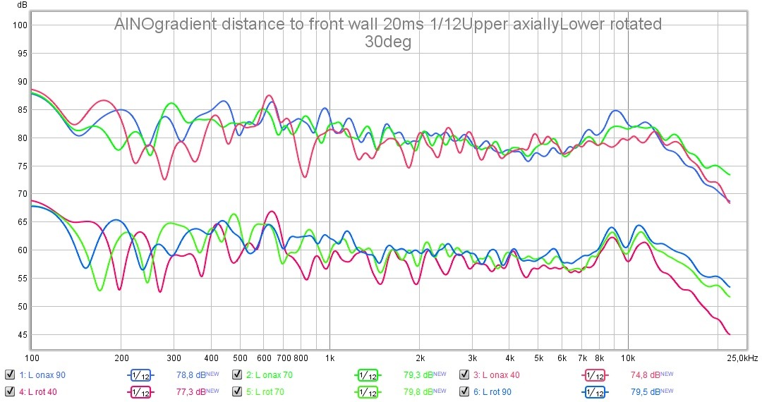

Attached measurements of the test I made after reading your post. Mic location was fixed, at roughly 1,5m.

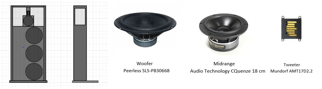

Hi @Juhazi, I have read a fair bit of this thread, I stumbled upon it googling NEO8 as I have bought NEO8 and NEO3 both PDR to build an open baffle. My current speakers are LXmini+2 with dipole subwoofer, not a great speaker with original EQ but now very good with modifications to XO qnd EQ.
Your measurements show great promise for the NEO drivers, I have 2 JBL 2251JPL mid/woofers that I plan to pair with the NEO's. Subwoofer will remain the Seas L26ROY
Thanks for documenting your journey.
