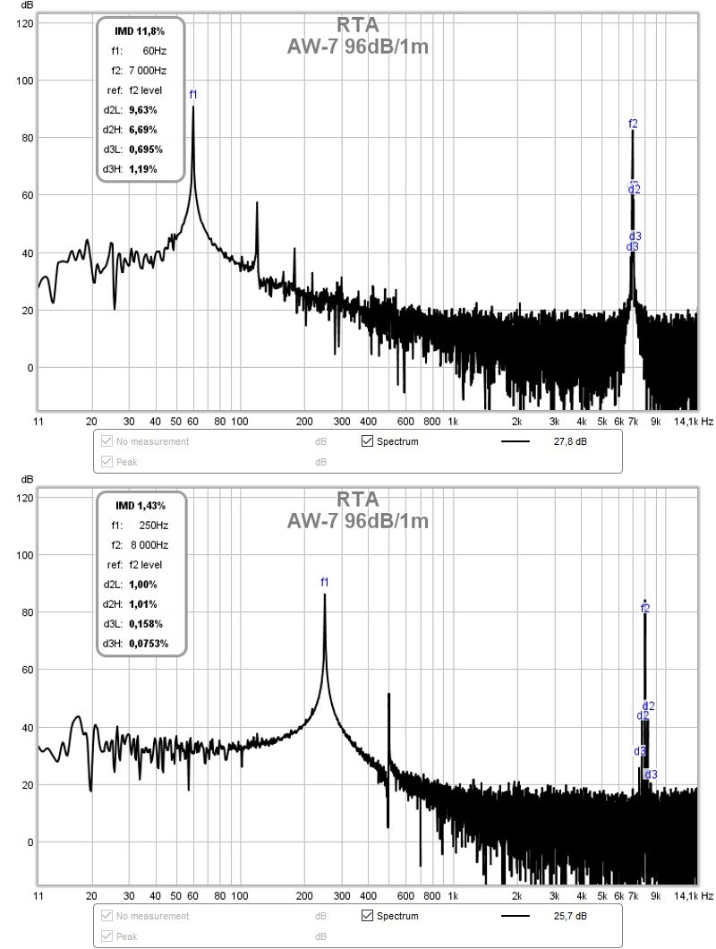

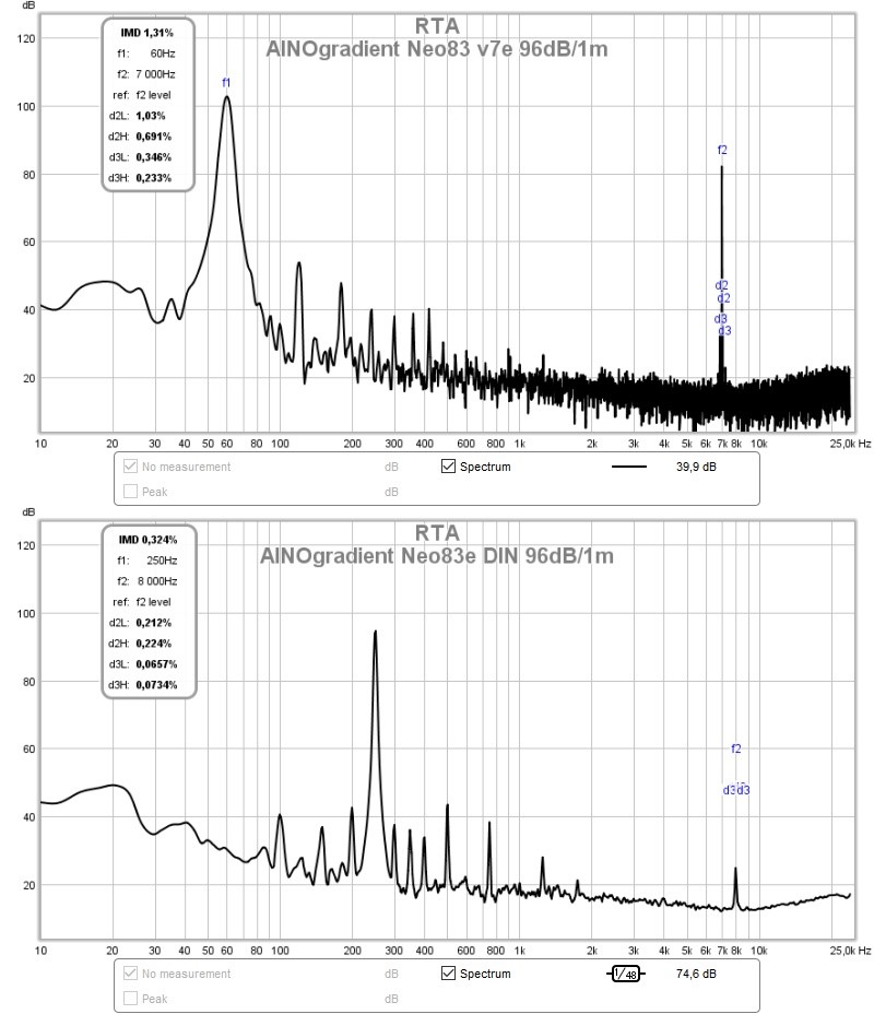

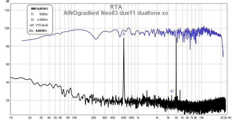

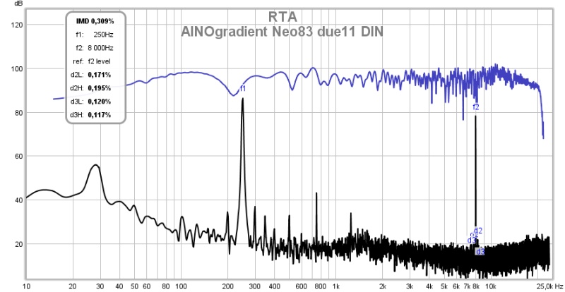

Some dualtone tests of AINOgradients with REW
AW-7 is a coaxial with SEAS T18

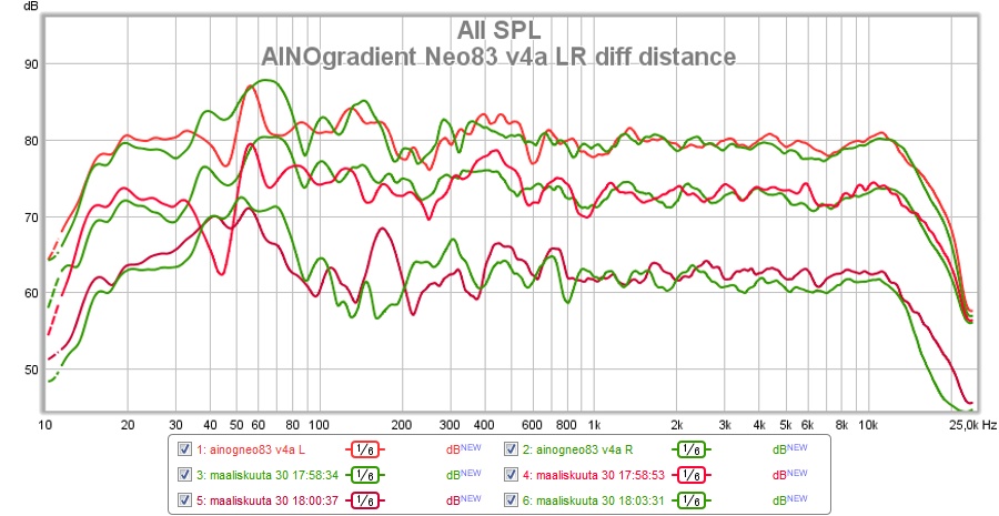

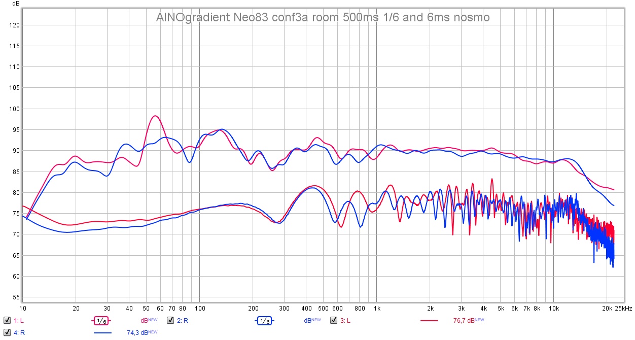

Yesterday I had a chance to revise dsp settings with indoor measurements. Crossovers now all LR2 acoustic at 150Hz, 800Hz and 3000Hz. Later on I added a 2dB peak at 7000hz.
IS that a suckout at 170~350 Hz? Floor reflection? I thought the xover between bass & 12" angled open mid was around 400Hz to prevent floor reflection issues?
I don't know what causes those. But most likely the back wall behind the listener/mic, and all other boundaries floor included. My tilted 12" angle to floor reflection point is roughly 45-50deg, but I have sofas and a table messing with that.
At 45deg a dipole is only 4-6dB down and typical listening spl is around 80-86dB... So tilting helps little, but doesn't eliminate floor or sidewall bounces!

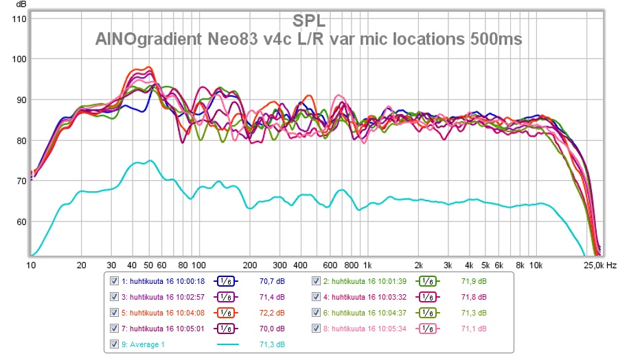

Response at various distance/spot

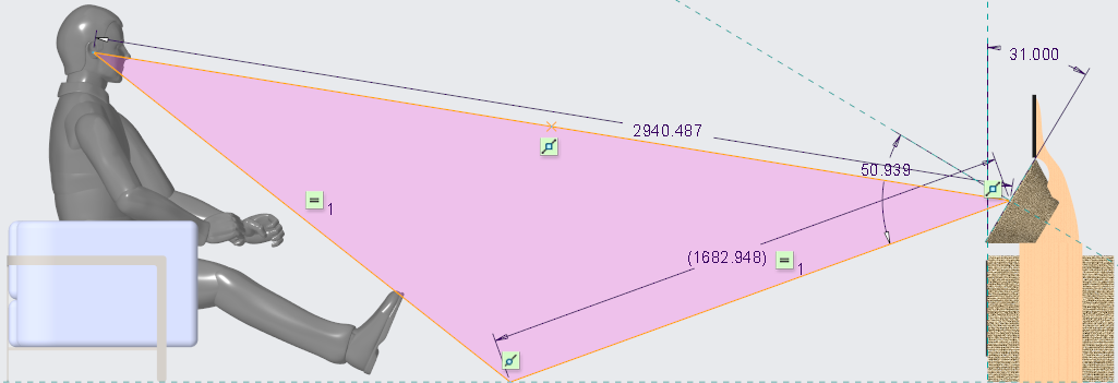

A quick visualization of the problem: A rearward tilt of about 30 degrees at a usual listening distance of 3 meters gives a first floor reflection at about 50 degrees relative to the driver axis. I think 4 or 6 dBs reduction is at least something, but for me not enough incentive to add tweeters (I'm running a 12" wideband now).
Thank you for those details, Juha. Much appreciated. Interesting that the tilt affects floor bounce so little. Your xover points are 100Hz & 800Hz, right?

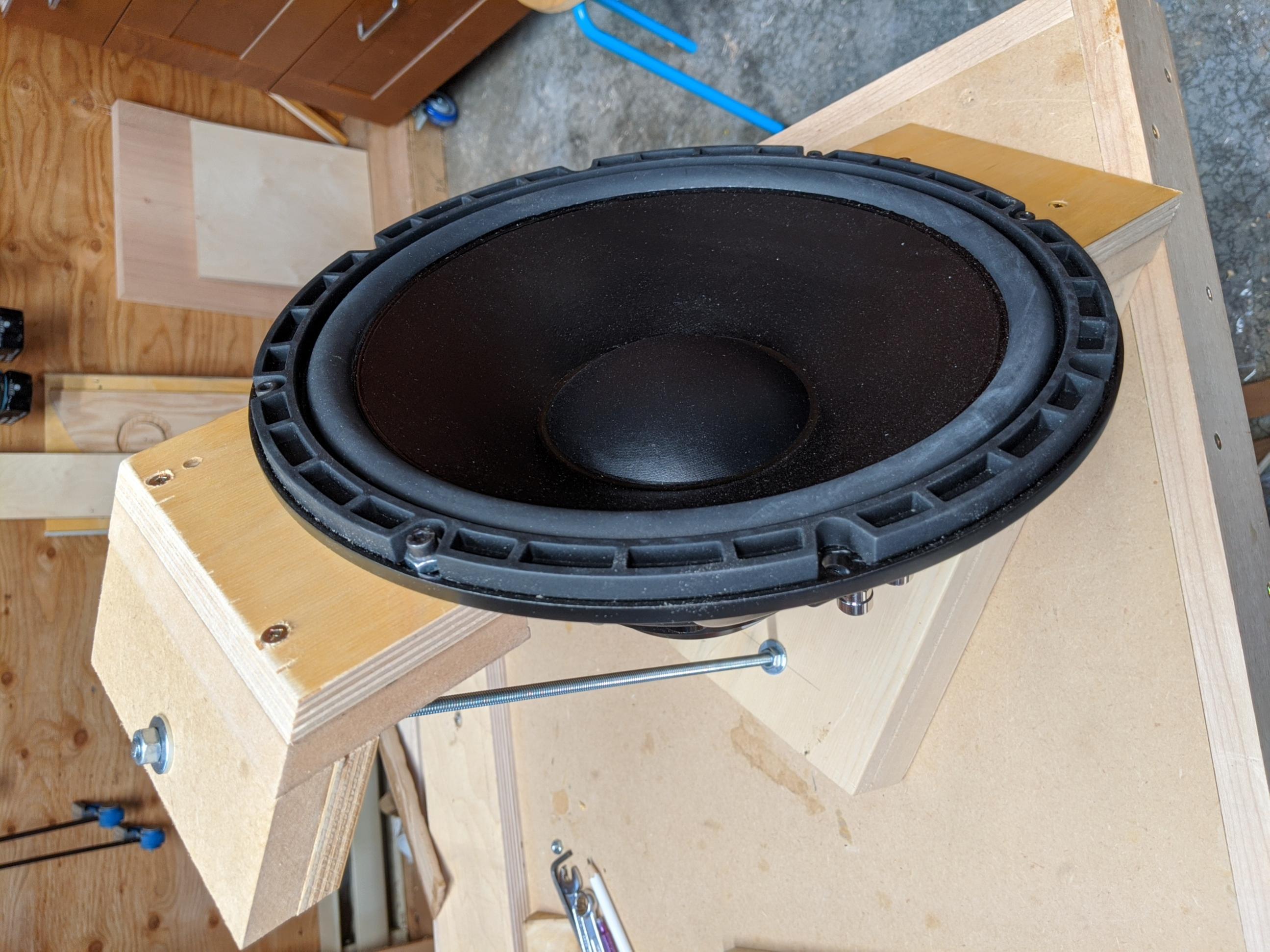

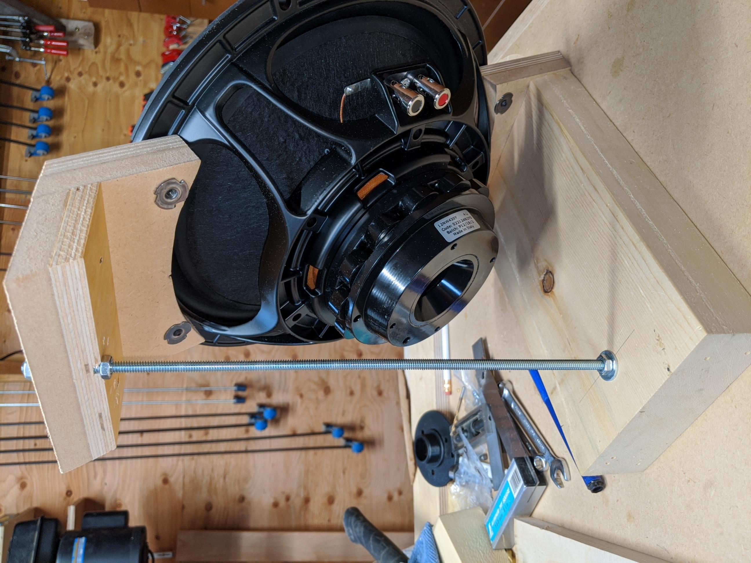

Juha, just wanted to show you how I stabilized the 30 deg angle open baffle for the 12" mids in my Gradient 1.3 project. A threaded steel rod. The driver is now perfectly stable at that angle. Not sure if this is useful but there ya go.
Mike, at least I can thank you, as I'm still looking for a nice concept for a holder that's good for less tilt.
You're welcome.Mike, at least I can thank you, as I'm still looking for a nice concept for a holder that's good for less tilt.
The keys to this method are strong "wings" cut to conform to the shape of the driver perimeter curve & big T-nuts with bolts to ensure the wings are firmly secured to the driver. And a strong driver frame. Once the wings are in place, there are lots of different ways to mount the driver open baffle at any angle.
