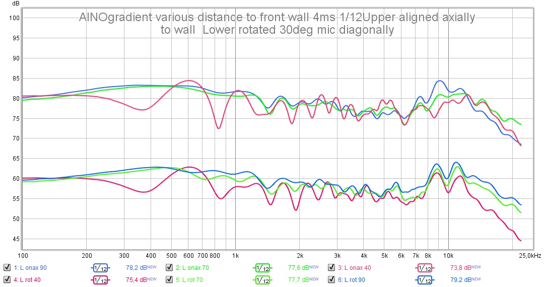

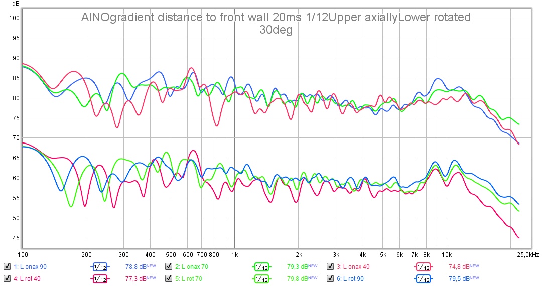

My house is a normal Scandinavian with wooden frame and gypsum board walls and many windows with triple glass. The speaker is in front of a window, so these measurements don't show as high amplitude of reflection interferences as in a room with concrete or tile walls.
I measured the response with the speaker projecting 90deg and 60 deg from wall plane. Distance from front wall was 40, 70 and 90cm. Mic was stationary 2m from wall, but lower than designed listening axis, so response around highest xo is attenuated. Rotated speaker responses are -20dB lower in graphs.
We can clearly see that 40cm to wall is making more aberrations than longer distances. Highest peaks/dips happen at 165, 285 and 830Hz. I couldn't hear those when running slow sweeps with REW. My normal speaker position is 60cm from wall and rotated 30deg. I don't make any eq corrections for "spot response", just bass driver level adjustment to get relative level right for my liking.

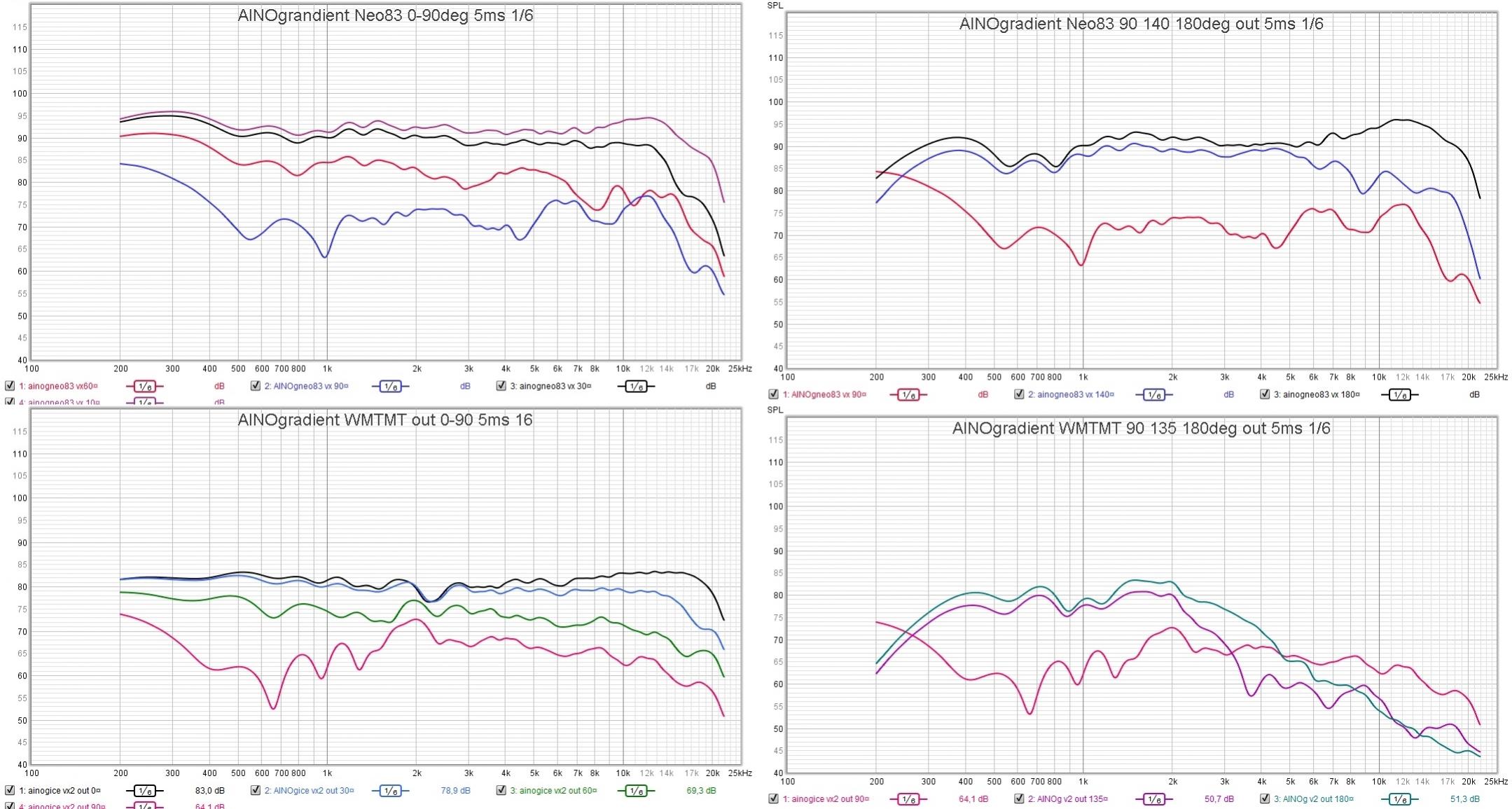

Here we can compare the difference of dispersio between AINOgradient with MTM pole (with monopole horn tweeter) vs. Neo83 with planar mid and dipole.
Cone mids lost dipole pattern at 3kHz and horn tweeter had no radiation backwards. The greatest diffrence in audition in a room was treble sound. Horn tweeter sounded very prescise and sharp, but lacked the decay and "air" of dipoles. Backside helper tweeter helped retty much, but planars have superior dispersion and sound is practically just the same everywhere in the room!
i hope i understood it right. the point is cone mids lost dipole pattern depending on their size. (If there are not special problem wiht the driver). The 2" driver frs5x loses his dipol pattern at 4khz. Therefore i think probably a small midrange is a possible solution for a good dispersion.
