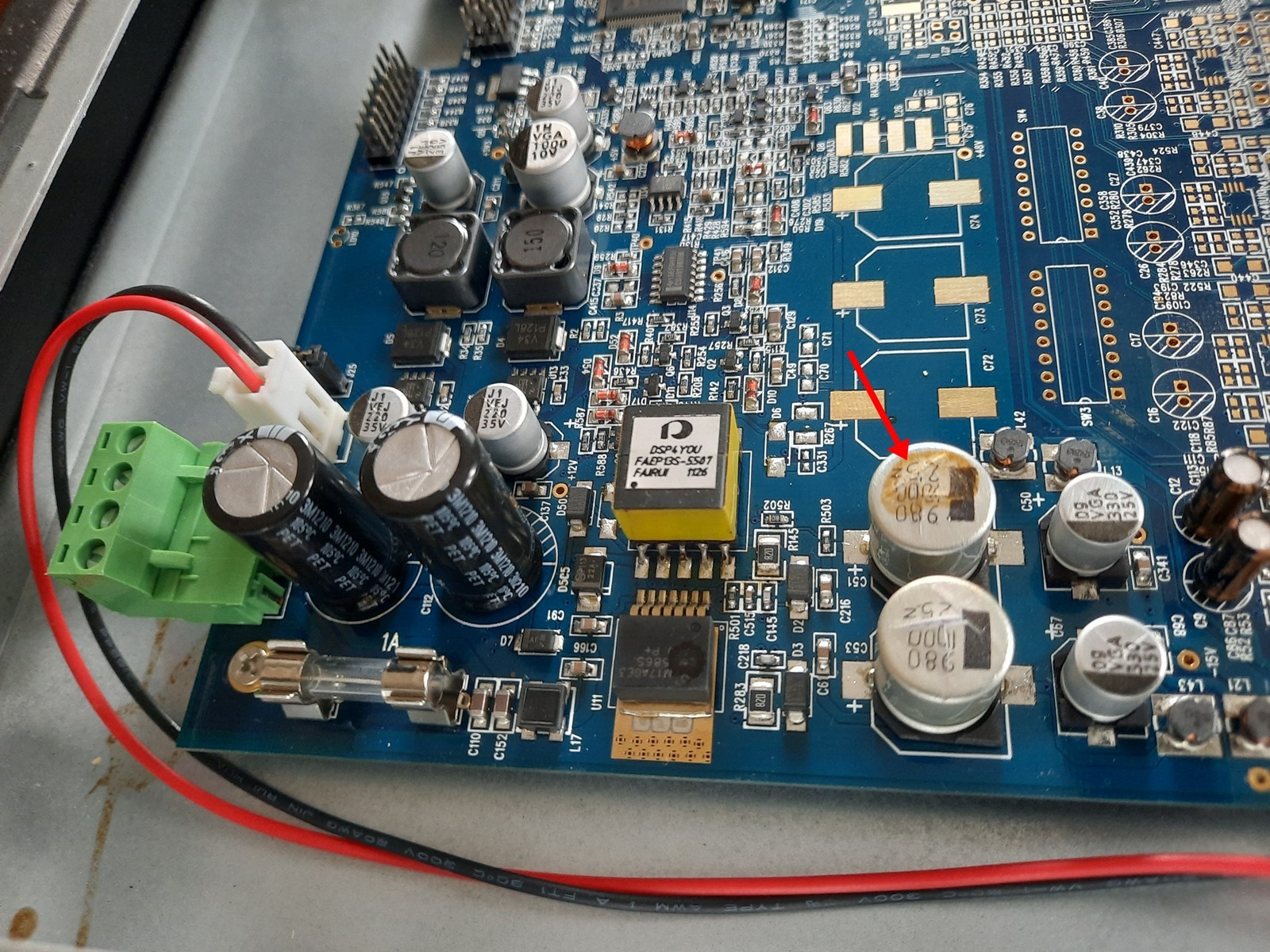

There is one cop dirty in my Minidsp 4x10HD, but the service is busy and sceptical about repair...

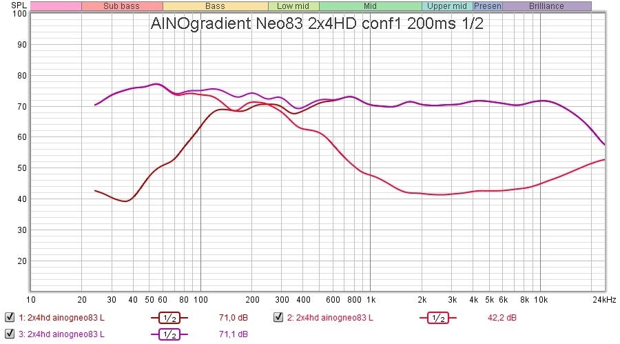

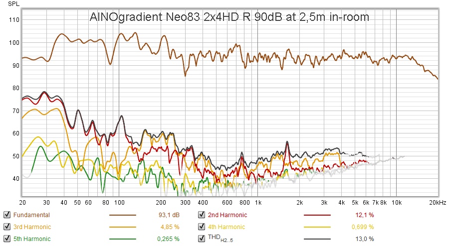

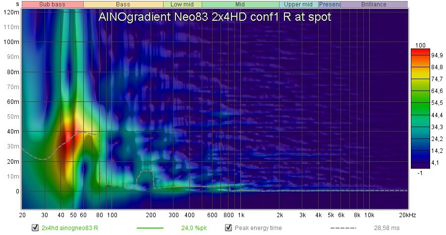

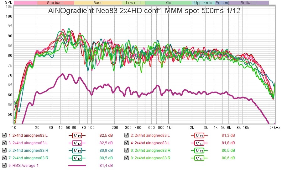

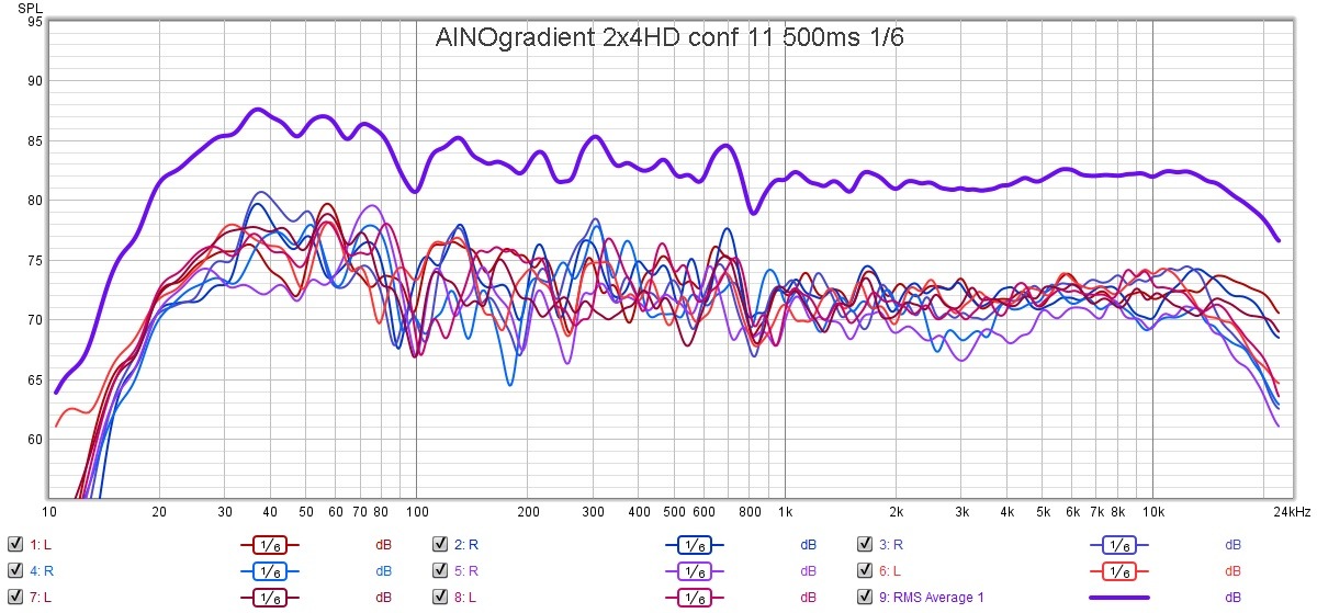

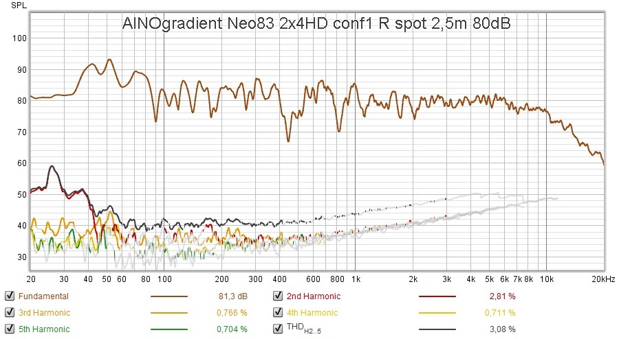

I installed my 2x4HD boxes and copied settings, but measurements showed need for fine tuning. After some 6 hours I got these pretty nice single spot measurements. I changed lowest xo to 200Hz, second to 1000Hz and highest to 4500Hz, all LR2 acoustic. Looks like tweeters still have different response, sample variance that I can't even hear.
I will go on with these as long as my 2x4HD units survive. The sound is very good, no difference though.

Multipoint handheld around the spot, L/R speakers individually.
Practically same as before. Elevation around 50Hz and dip around 100Hz come from room modes but locations are fixed. If I try to eq them, sound loses natural timbre. With more smoothing, the curve follows Toole & Olive (Harman) recommendation pretty well.

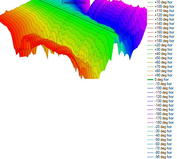

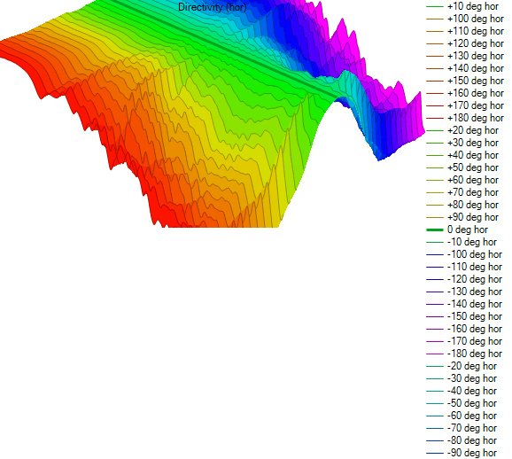

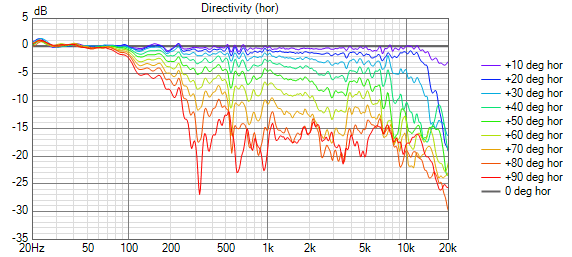

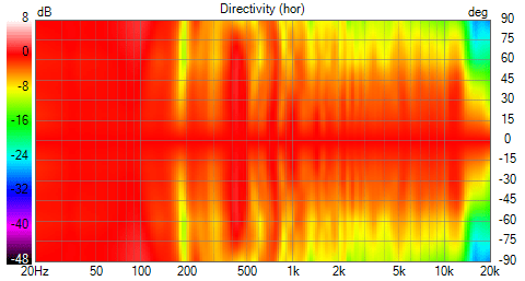

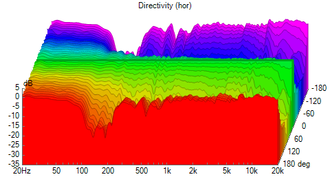

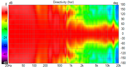

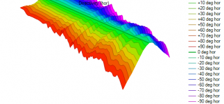

I converted my 2016 summer outdoor measurements to VCAD2. 40ms gating to show full range directivity. 1/12 smoothing. Normalized to eliminate boundary reflection effects.

What exactly is meant by the word "normalization" please ? I see every time this word in third party measurements, does it mean after applying the filter ? Is it automaticly given by measurement softs like Vituix and alls ?
Normalization means, that the reference response (typically on-axis 0deg) is drawn as straight line (0dB) and given dark red color. Then all othere responses are referenced to that straight line. This procedure eliminates the deviations in on-axis response and reveal the pure directivity characteristics of the system, which can also achieved by super-careful equalization of the on-axis response and taking measurements in an anechoic chamber.

In VCAD2 the use can not choose the basis measurement for normalization, unlike in eg. Dayton Omnimic software, that I have used previously (without licencing).

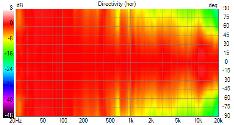

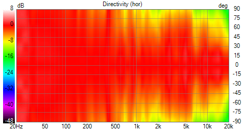

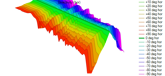

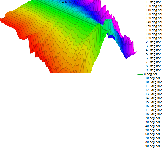

I converted some of my other speakers horizontal directivity measurements to VCAD2.
Only AW-7 was measured outdoors, but normalization helps to minimize reflection artefacts. General pattern of directivity is obvious.
All speakers except MR183w are on-stand 2-way models. MR183w and AW-7 are coaxial and JBL has a wide rectangular waveguide

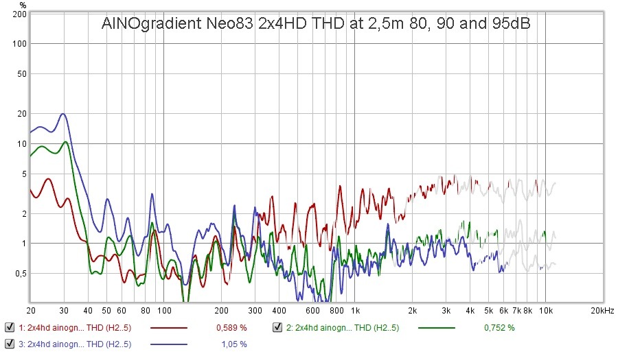

I have also other 2/3-way speakers that have not been measured for directivity and distortion in good enough conditions.

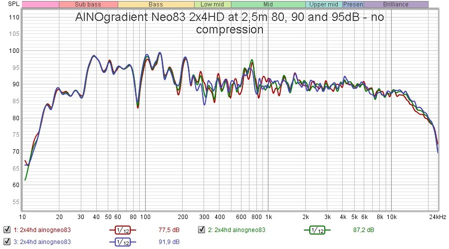

Another day off from work (semi retired), morning quality time with in-room EQ...
Version 1.1 optimized for in-room response. Treble boost is needed for my old ears!
