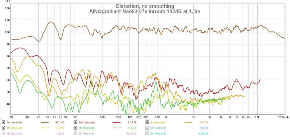

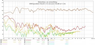

Here is my distortion measurement at 102dB of a single 10" in closed 30ltr cabinet, in a 35m2 room with open passages to kitchen and corridor. Measured at 1,5m distance, including rattles in the room. My max power for the bass driver is 125W, I guess is that I used 30W. Disortion at 30Hz is 22% - it sounds clean.

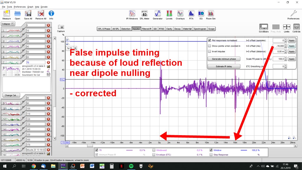

Now I had chance to put her on the table with a turntable. Backside response is quite ragged, that is because each driver's delay is optimized to frontside. The 12" cone is closer to the listener than upper mid and tweeter. Previous outdoor measurements done at longer distance are smoother and more reliable. Indoor measurements around 200hz from two different kind of radiators 60cm apart is mission impossible.
A funny thing happened again when 70¤ off-axis was reached. 16ms late reflection was louder than direct signal and REW set timing=0 there. Low freq response was so different that I noticed that immediately, and this was not first time... I had to move t=0 to get right response, see attached picture.
Now the constricted tweeter has much less directivity 5-8kHz but room response stays even. LR2 xo helps to keep vertical directivity smooth - 1,5-6kHz gets recessed, but fortunately it is difficult to hear and again room response is nice.
More graphics here AINOgradient - Google Photos

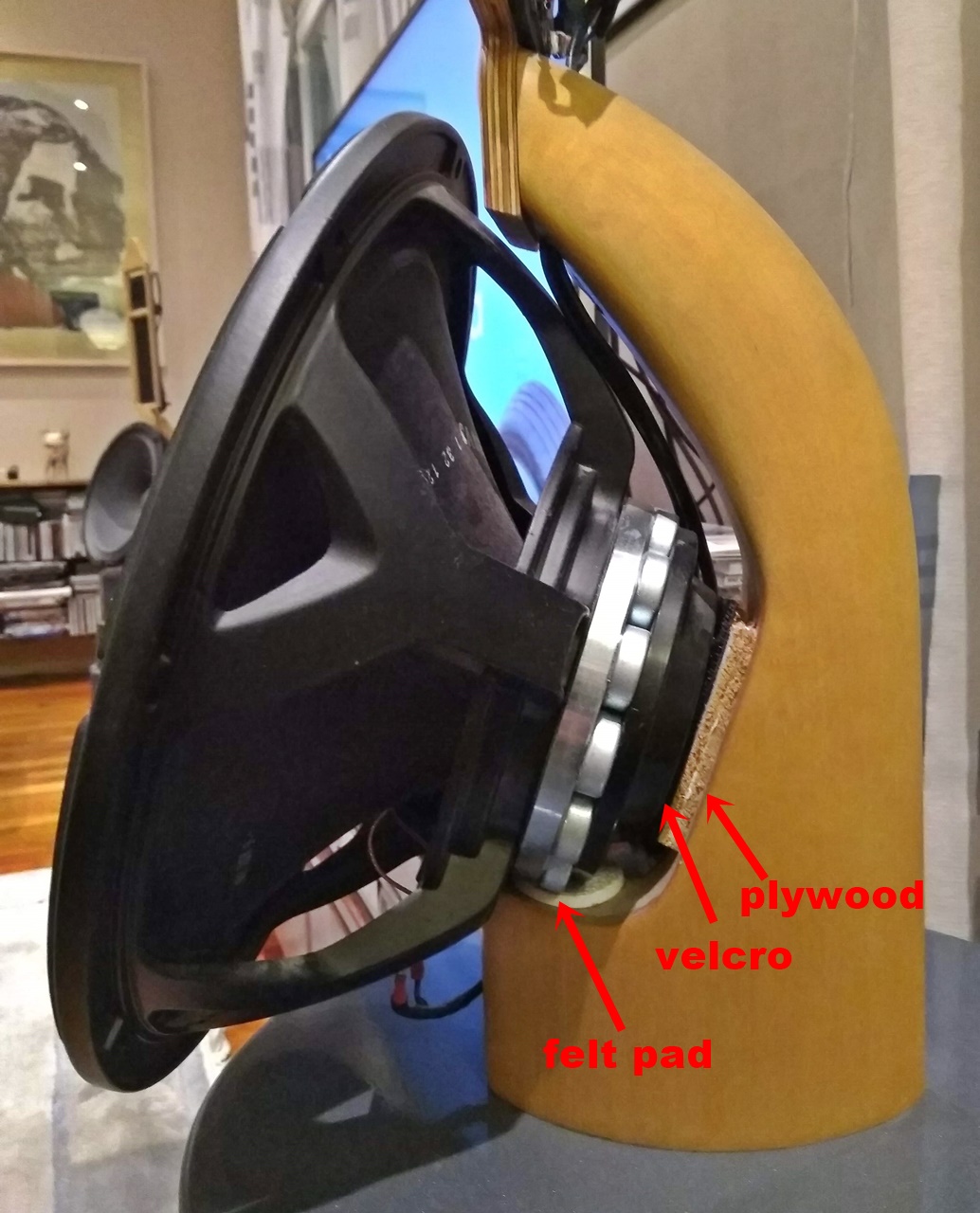

Of course, I'm now obsessed to replicate his Aino or the Gradient 1.3 & hear the magic for myself. 😉 With the Beyma 12mwnd discontinued, I've been scouring pro speaker directories for days. Hard to find the right balance of lowish mass, good FR, Xmax -- & good looks! Gadut's choice of ACR PA-75124 W-N FABULOUS (404 Not Found | ACR Speaker) looks very good but in North America, it is unobtanium. I'm considering B&C 12NDL76 (B&C Speakers) -- Xmax is only 7mm, but 53g moving mass is nice, and the basket/magnet looks similar to that ACR. Should be relatively easy to affix firmly to whatever bracket scheme I come up with. This driver is also modestly priced around here, which is good. Any serious issues with this driver that I haven't noticed?
PS -- have you improved on the velcro mounting of the Beyma, Juhazi? That seems about the weakest mechanical part of your system. Surely it can be improved upon, perhaps with an audible improvement? How about a custom clamp to wrap around the basket, something shaped from BB ply or metal? SL and his affiliate Don Barringer came up with a metal "puck" (shallow cup?) that clamps around the magnet of the 8" mid to secure it to the back bracket in one iteration of the Orion.
^ I don't have any special 12" driver suggestions now, sorry. Xmax should not be a problem, that can be handled with xo frequency and slope settings based on high spl sweeps and looking at distortion. Many woofers with heavy cones and strong motors get in trouble above 600Hz, but we need nice response up to 1000-1200Hz here.
usspeaker.com has 12MW Nd listed still Beyma Neodymium Speakers - Beyma 12MW/Nd speaker - Beyma 12MW/Nd 700 watt 12" woofer for all bass applications. Beyma 12MW/Nd neodymium speaker and other Beyma neodymium lightweight speakers here.
Temporary velcro strip attachement has served me well for 5 years now... I can't see anything strange in measurements, except sometimes distortion peaks when connection gets loose and the frame buzzes against the pole at 12 o'clock. In the beginning I had the upper edge bolted to the pole, but it buzzed all the time. Then I added a plywood plate to get more clearance. The woofer weighs 3.3kg.
