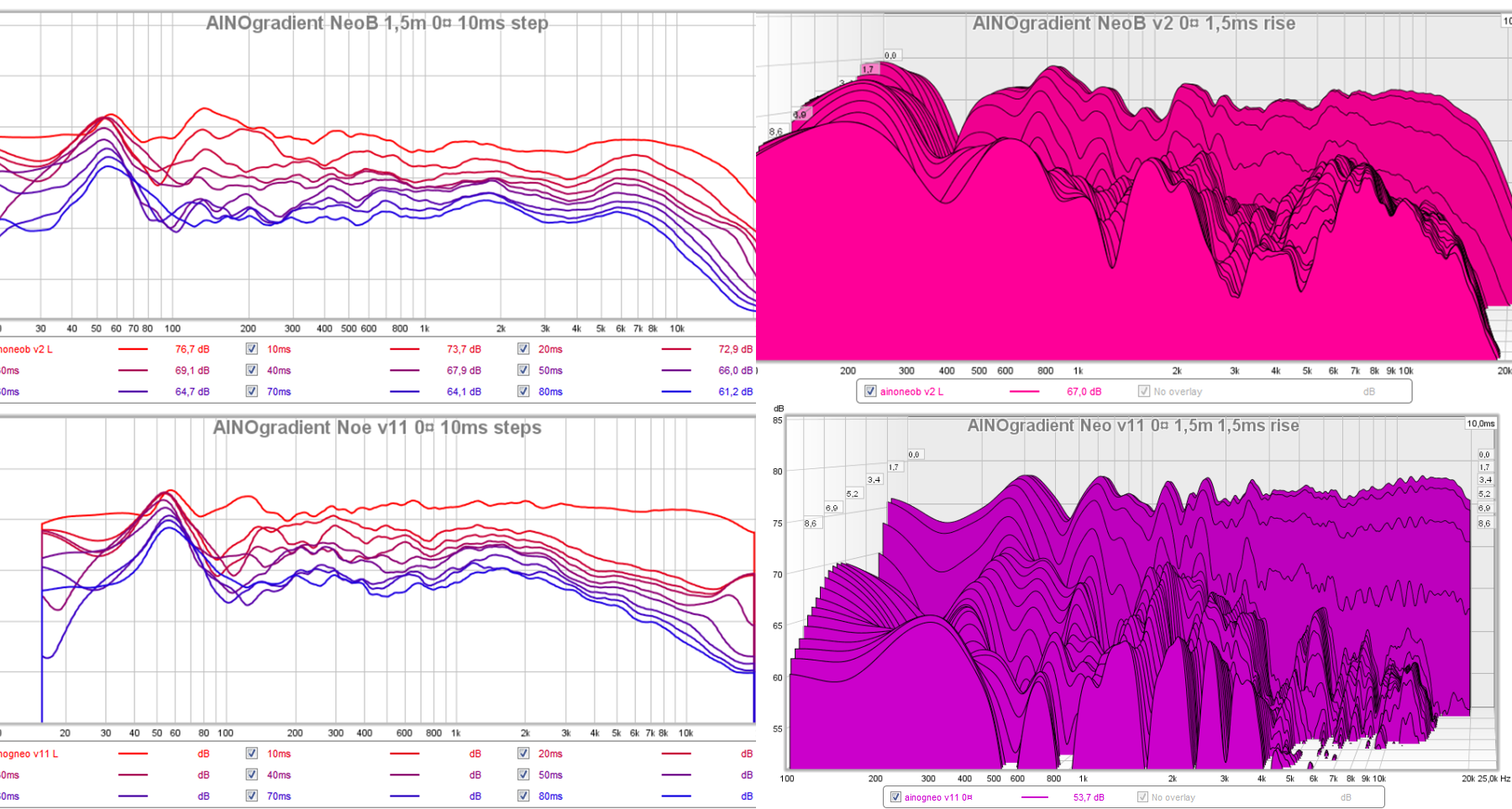

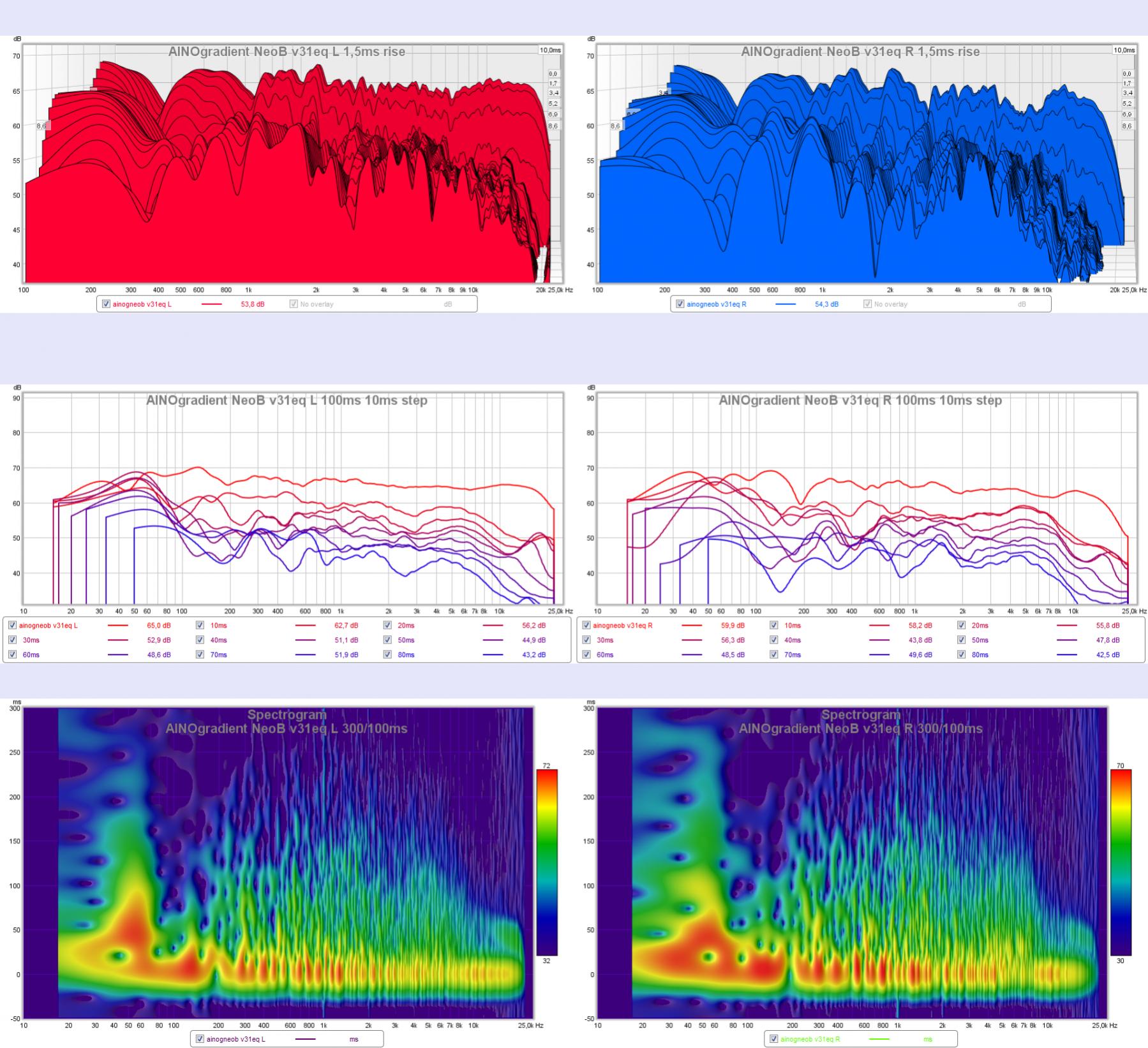

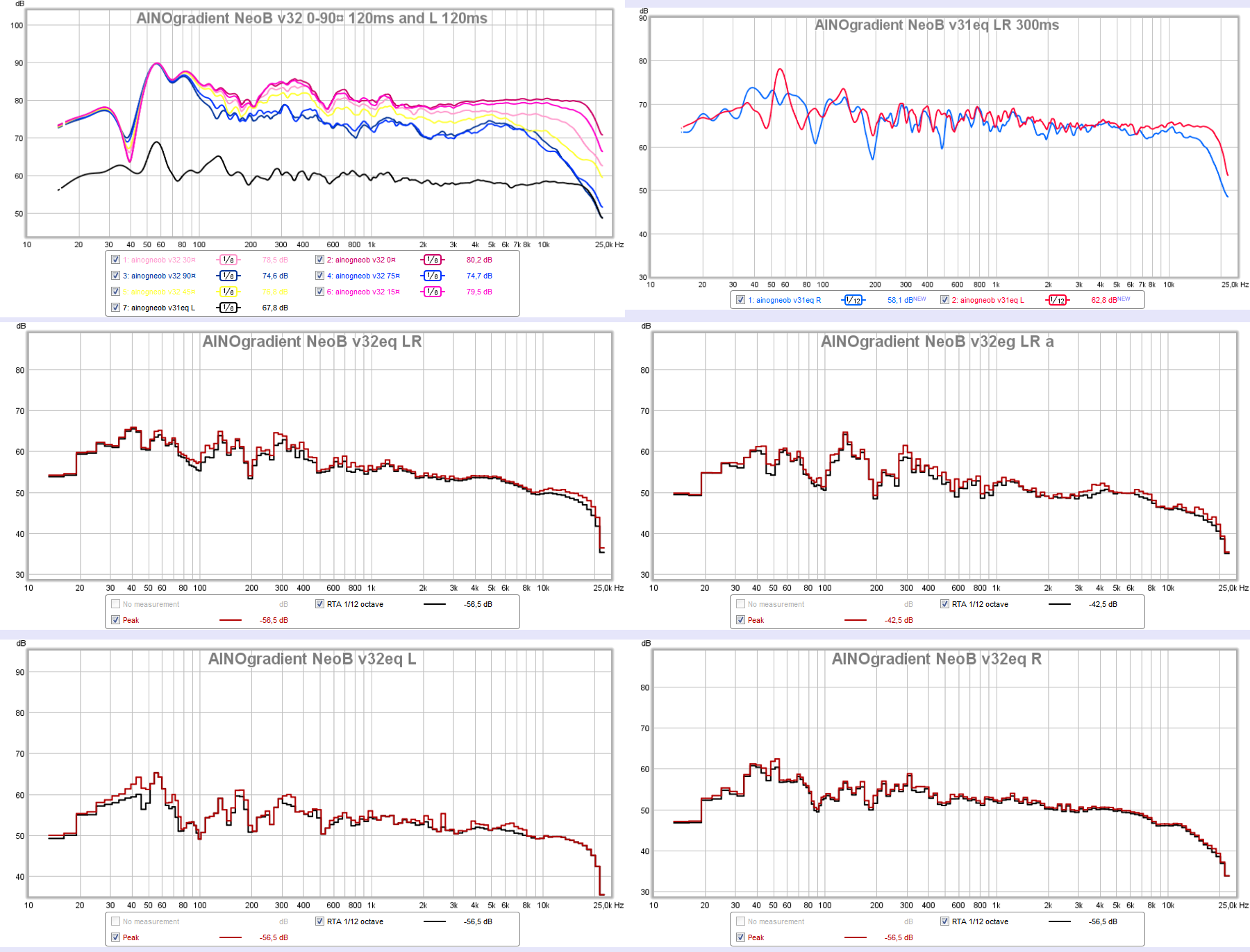

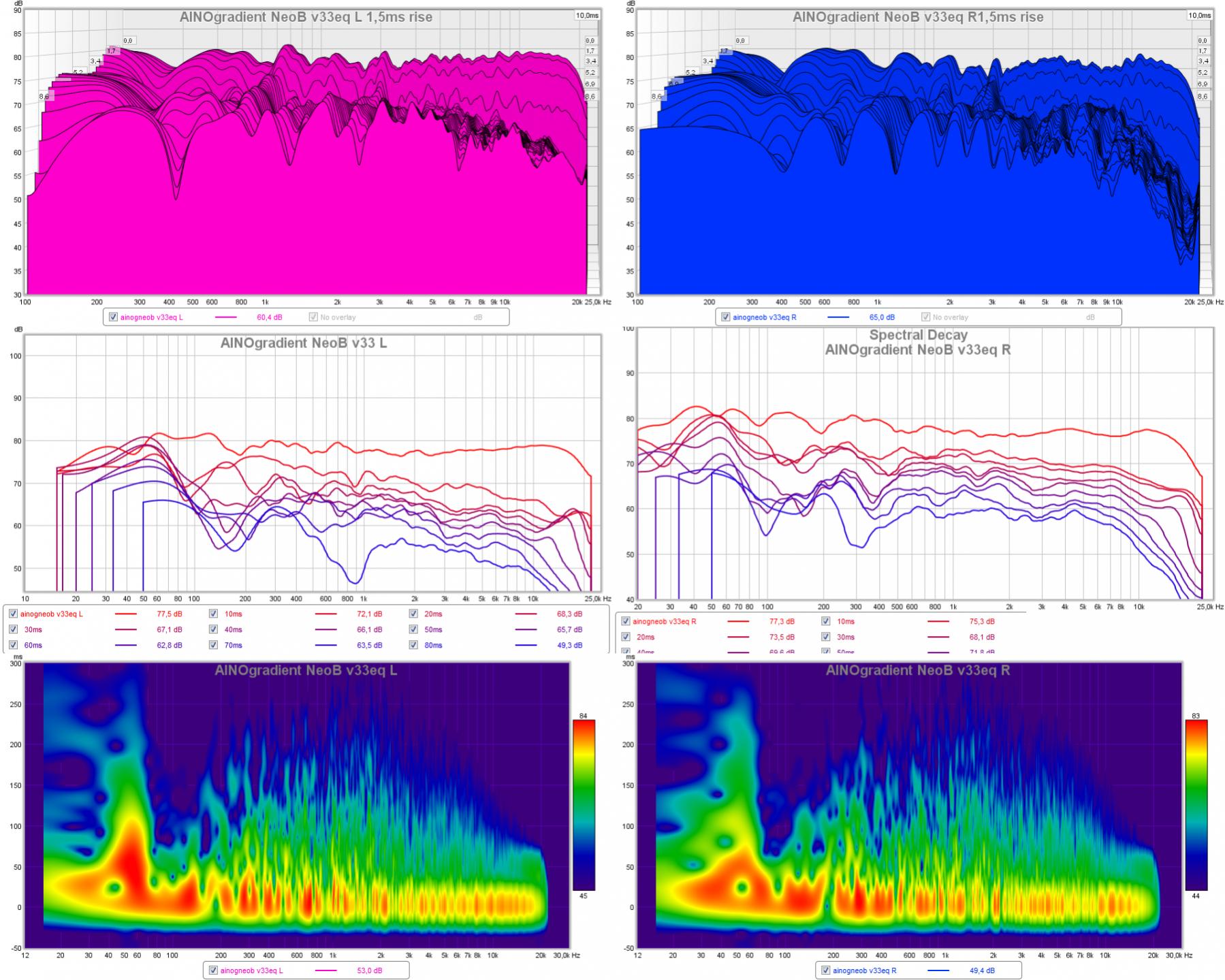

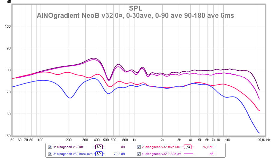

After a critical listening session with a audiophile friend, some fine tuning to response was done. Before listening I changed highest xo to 3,5kHz LR4 acoustic, to smooth power response and room RTA response.
The lowest xo between monopole bass and dipole woofer needs work still. It is very difficult to set indoors because of room modes and reflections. Different radiation patterns make this even more challenging.
Here are nearfield directivity and listening placement farfield measurements (with room eq at 133Hz). The backside tweeter is parallel with reverse polarity.

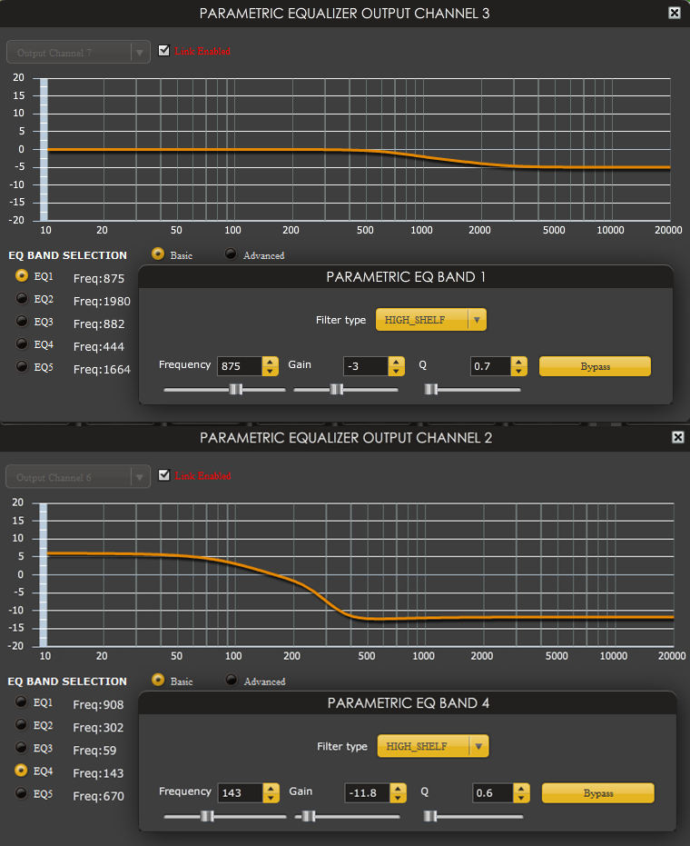

As it is easy with active and for curiosity : may you try to make a very narrow notch at 4 k hz : - 2 or 4 DB and say to me how it was ? (I know it's very near the XO....) ?
Yes, it's easy with global (input) eq. Select F, dB, Q. But sorry, I don't have words to tell how it sounds except perhaps a bit softer with piano's highs...

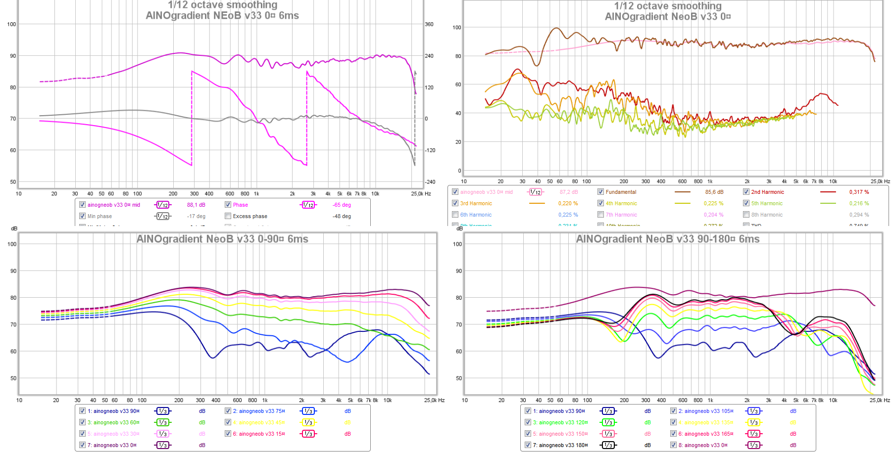

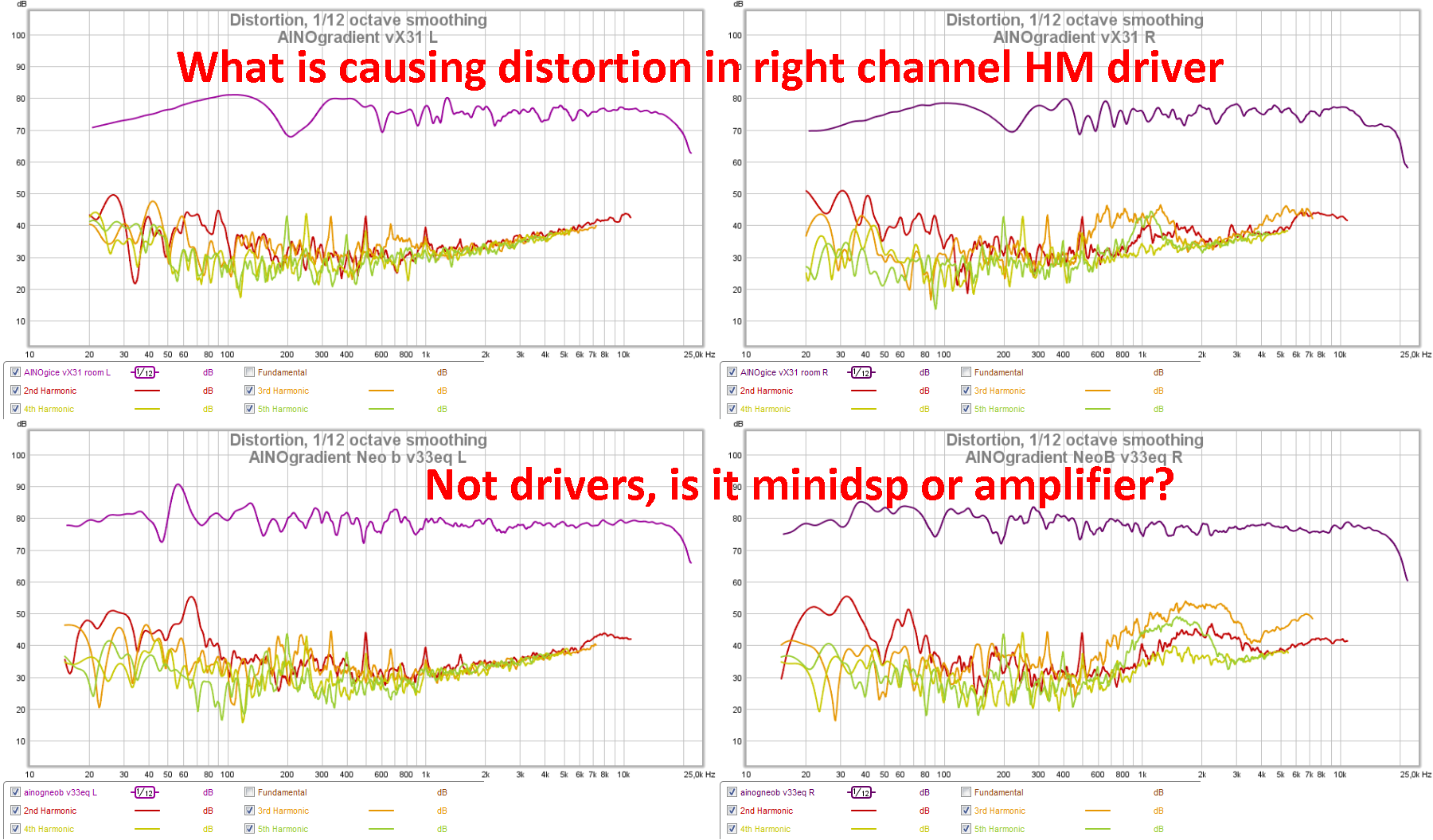

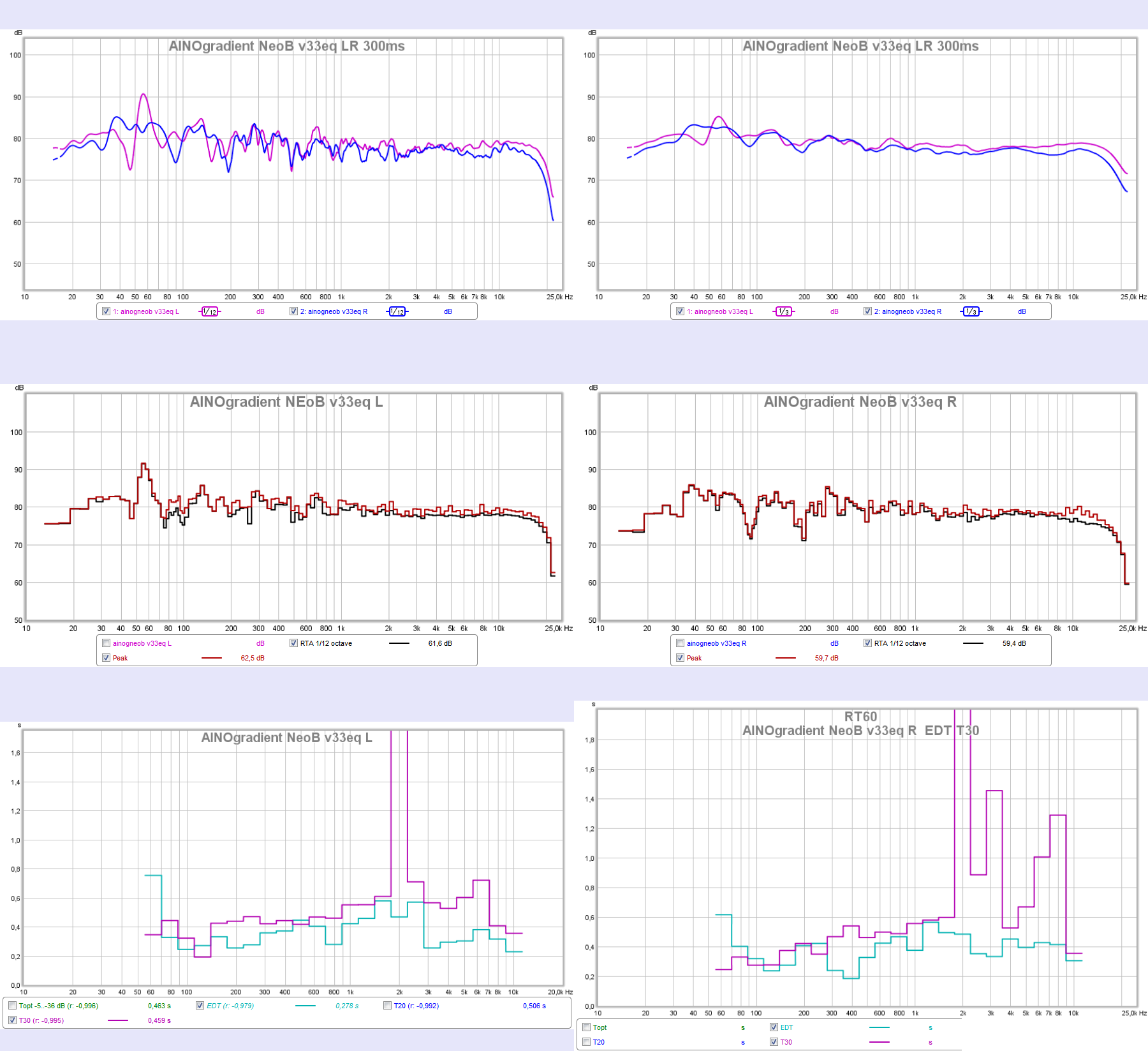

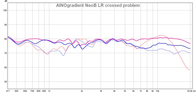

Damn, I just found out that my left channel has excess distortion at high-mid driver and perhaps with tweeter too. This can be seen already in June right after I started using diy ICEpower amplifiers! First I will check inside amplifier box - loose connections, faulty soldering? I can also change the whole ASX50 module. I have disconnected wires many times, so the problem must be inside icepower box or minidsp box!
I always measure my left speaker, this was the first time I looked at distortion in the right channel!
NeoB v33 has attenuated back tweetr and now it measures well. The sound has not really changed much according to my aged ears!

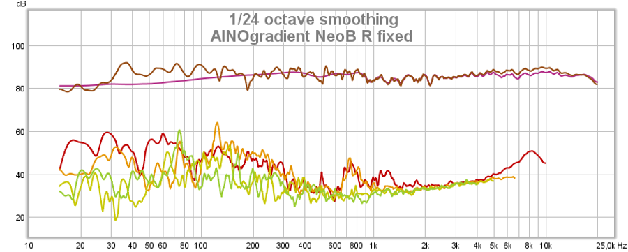

Right channel distortion issue fixed!
Yes, the right, after numerous cabling changes etc. I found it! I had soldered the speaker ground leads crossed inside my right channel diy-amplifier! Upper mid's - went to tweeter's - and vice versa. I use speakon connectors and they are well marked - a stupid mistake. Fortunately the smoke that runs the amp did not leak!

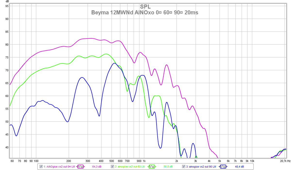

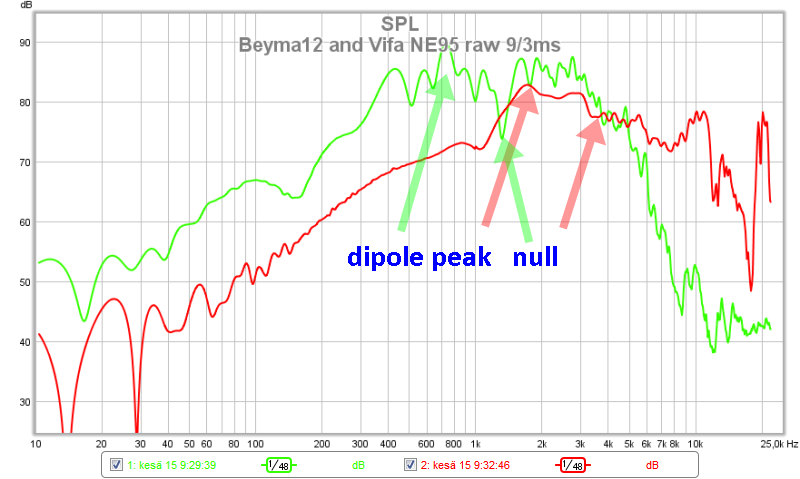

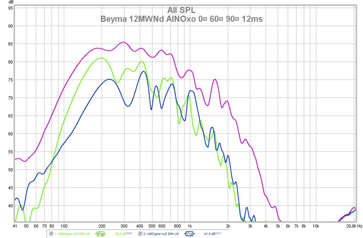

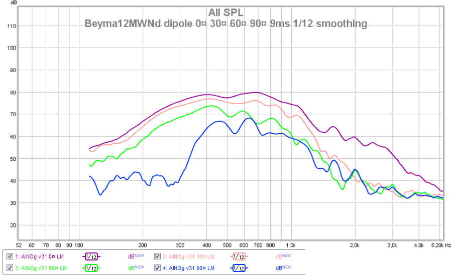

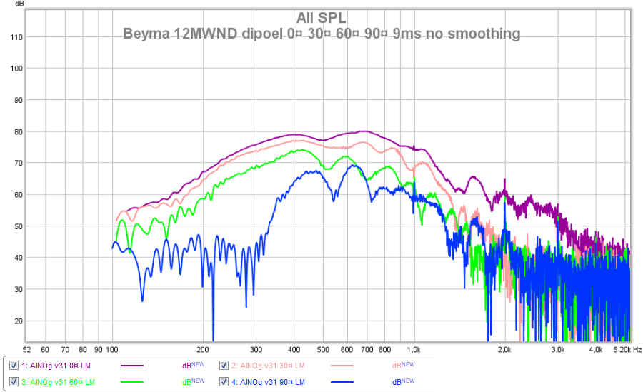

Hello there Juhazi, I got to wondering one thing when I looked at some of my measurements again... you don't happen to have full range 0-90 measurements of the OB bass driver as it is in the pictures which if I see correctly is basically naked without a baffle? 0-180 would be even better =)
I looked at my own with the 6.5" mid driver but when run naked there is no visible dipole null at all, or any ragged peaks off axis. I'll have to test if the result is the same on my 10" driver and it would be interesting to hear if you find the same in your measurements also.
I theorized that if this is something general and not just with my midrange then it is possible that any cone driver ( with small enough basket edges ) can be run rull range in a dipole without getting a noticable dipole peak. This because the directivity of the cone will loose directivity before the dipole peak occours, epsecially on the rear.

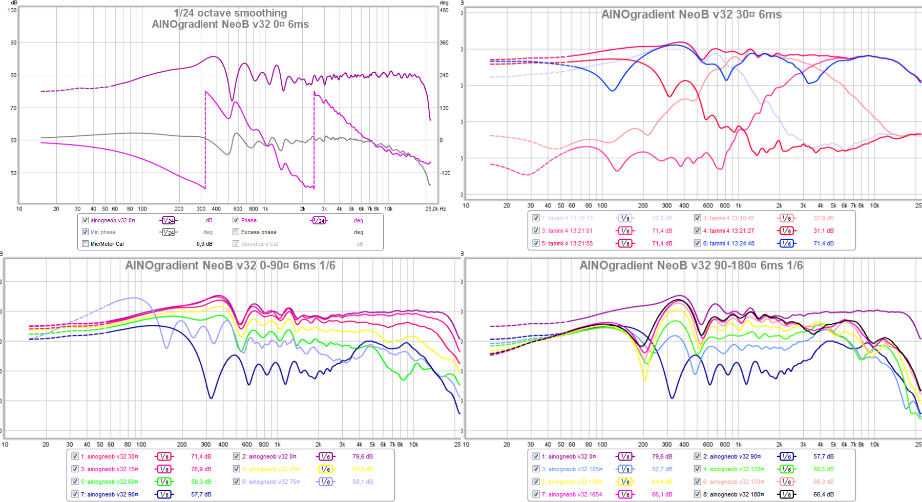

Here you are, nearfield and at 1m distance showing dipole response. No eq., measured indoors. Beyma 12MWNd no baffle but placed on top of a bass speaker cabinet and tilted 30¤

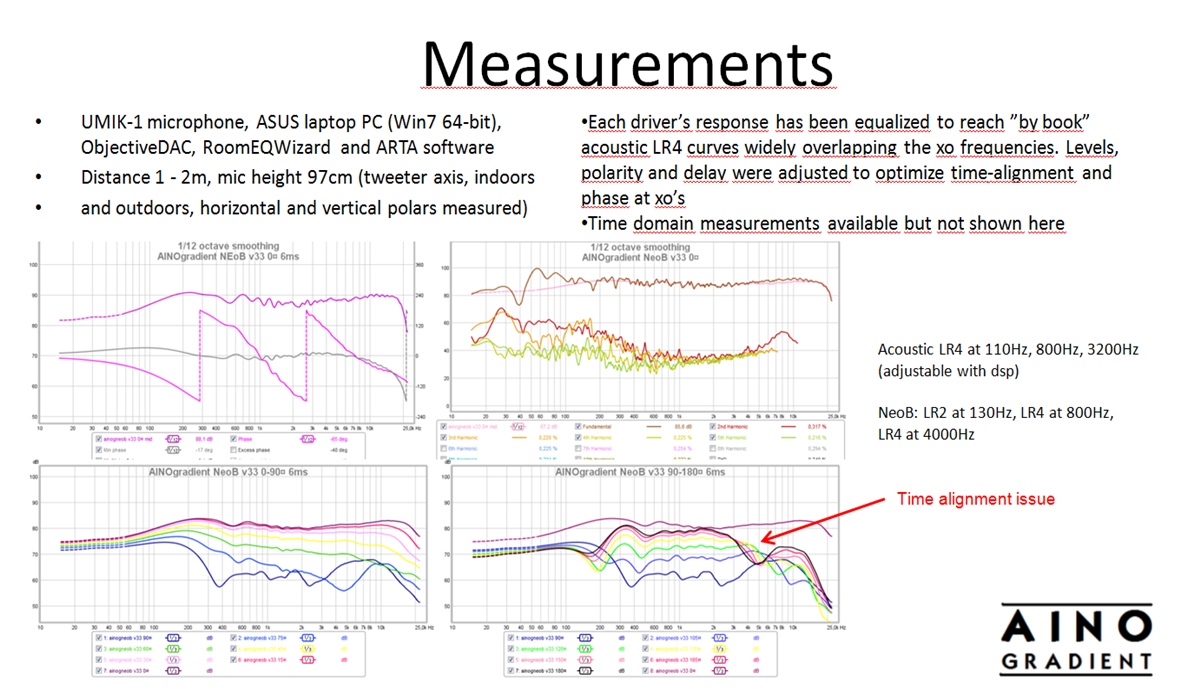

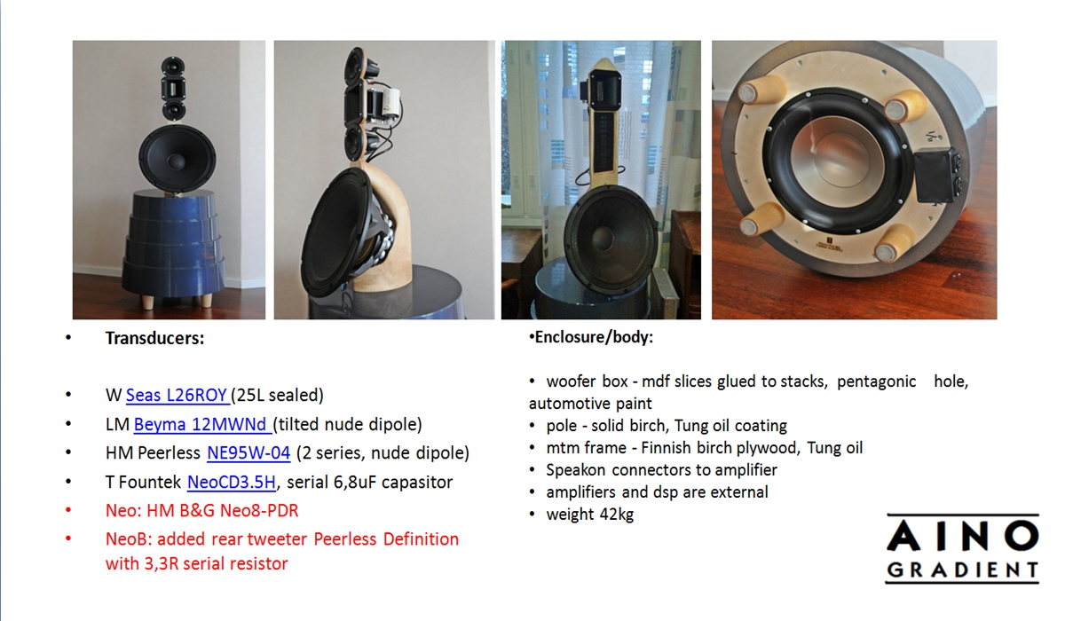

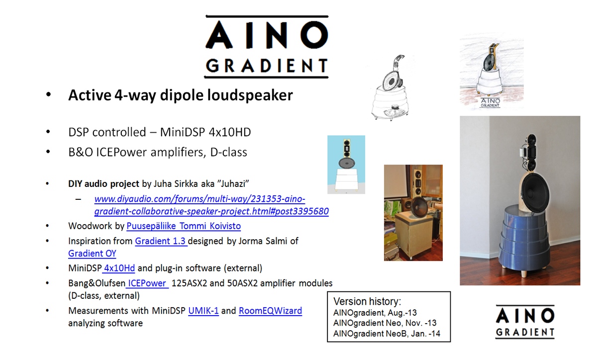

I have revised my presentation of AINOgradient for version NeoB. I show a 4-page summary here but if any of you want to get full 27 pages as pdf, please sen private message to me and tell your email, so I can send it as an attachment!
Here some others, "raw" response of Beyma 12" as nude dipole and directivity with xo and eq

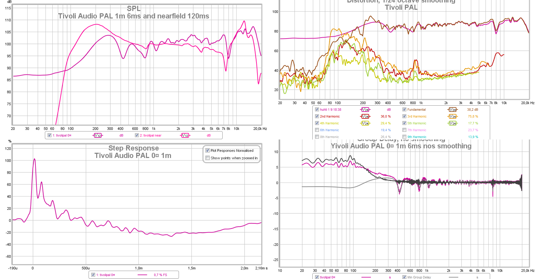

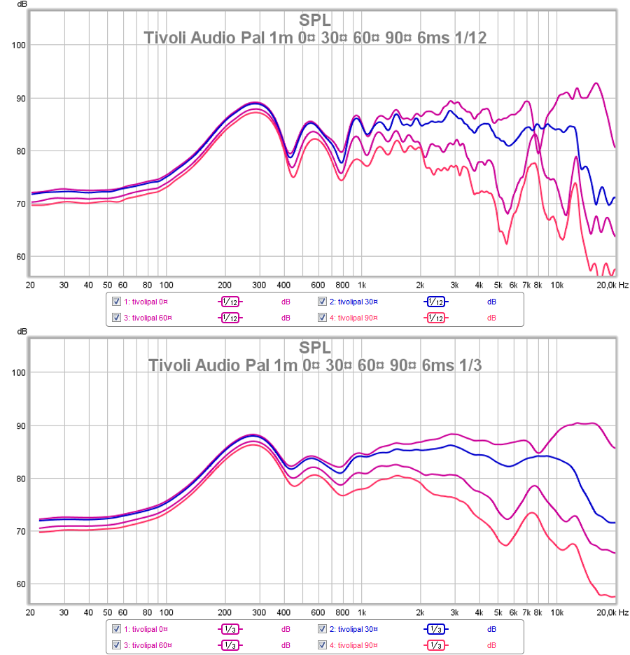

Tivoli Audio PAL

April Fools.
Stay tuned :

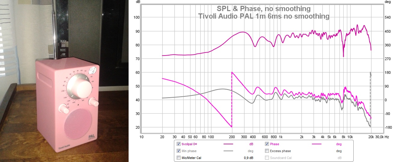

I have ben painting my fridge in pink from this morning... This afternoon I put on the door a standalone Lowter PM6 in the Tivoli way....
For measure at O, 35, 90°... I just move the door !
