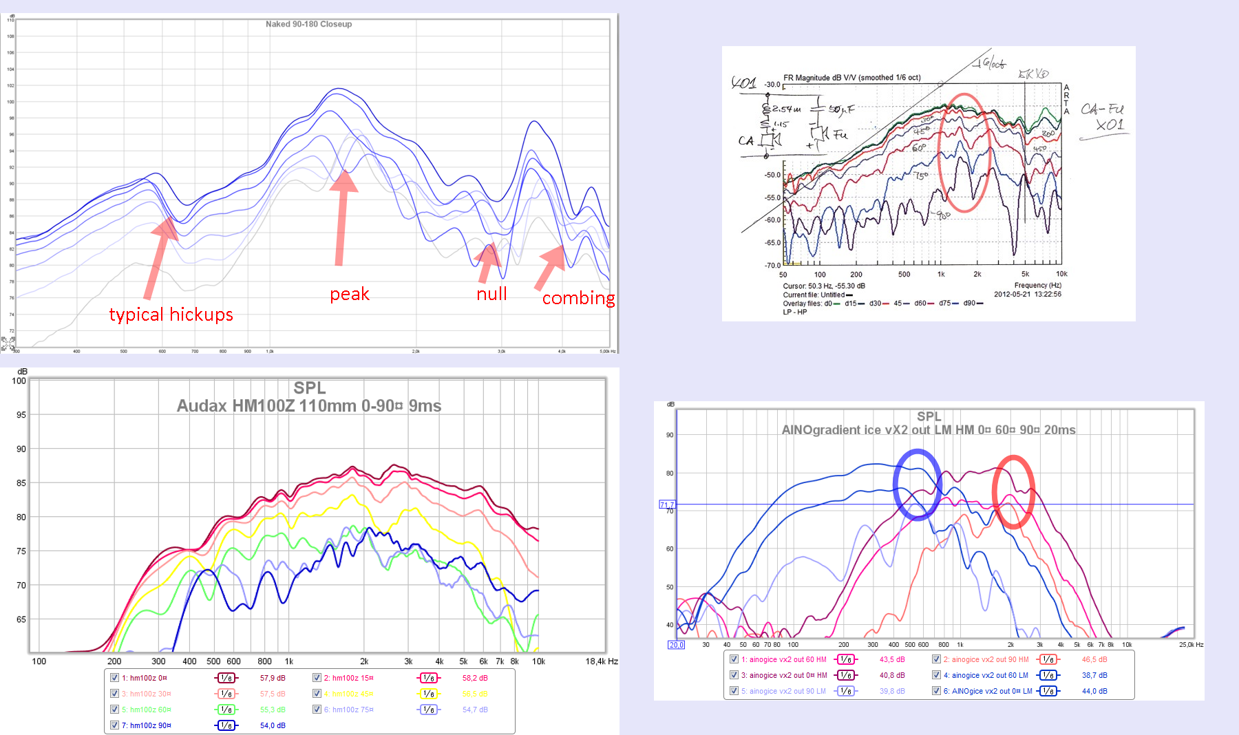

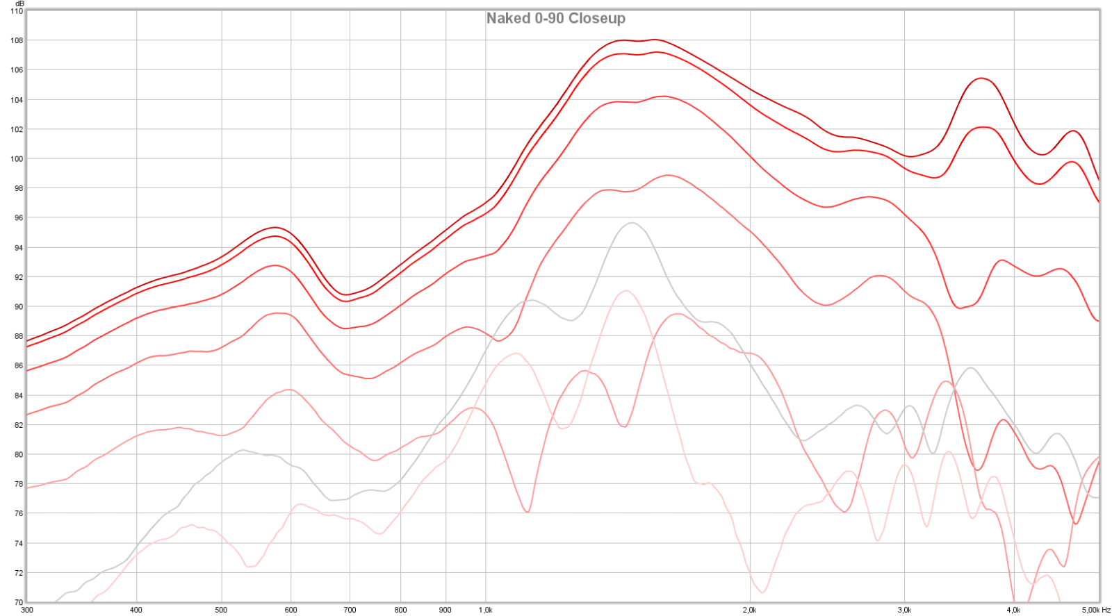

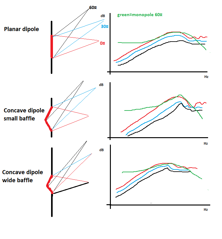

I made this illustration for another thread but I have explored this here earlier too.
I noticed that my 4" cone mid does not behave like a simulated planar dipole when we go to 60¤ and beyond off-axis. Instead of shifting dipole peak up, it comes down! my explanation to this is that a cone radiates differently off-axis than a plane or point source. I got supprot to this from a Klippel paper
Here are Siegfried Linkwitz and John Kreskowsky telling about dipole radiation. The model is based on a plane source.
Here is a collashe of OllBoll's, SL's and my measurements showing this oddity off-axis.
Attachment is my hand-drawn illustrations about what I see happening.

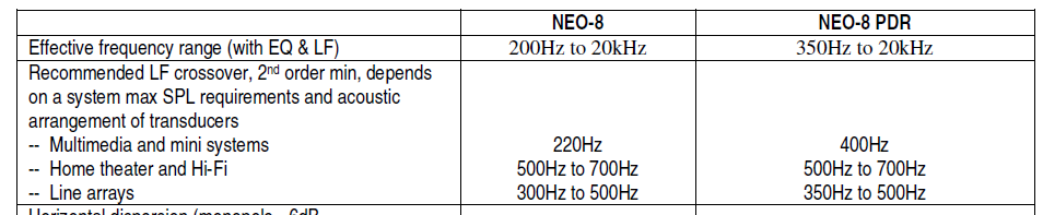

"the Neo 8 without box & baffle can't be crossed below~1500 hz ?"
How come? It doesn't need much eq to match LR4 at 800Hz. Distortion? Do you have a link to measurements?
B&G original datasheet says PDR can be crossed 400-500Hz LR2. Datasheet measurements are without eq. My measurements did not show any problem with distortion or csd (posted a month ago).

Keep in mind that my measurement is of 90-180 of a driver with a very large an obstructing magnet.
The 700 hz dip is an issue with the driver and has been observed elswhere too. The big dips and erratic response above 2 khz is probably more due to the magnet than of dipole peak behaviour. If it was dipole behaviour the front dispersion would have the same issues but it doesn't, at least not in 0-60 degrees:
Measurements of the driver by the manifacturer AE:

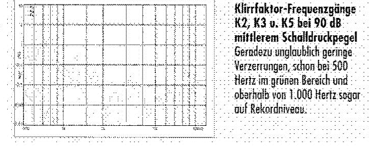

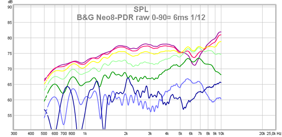

I have measured Neo8-PDR dipole response from 200Hz up and it has almost as low distortion as Audax HM100Z0, according to my preliminary tests. Vifa NE95-w distorts much more but I have two of them in series. Now we must wait a little before I can fit Neo8 in the new baffle. Then I'll perform new set of measurements, that are fully comparabe to present system.
I use minidsp for AINO. I don't use level gain above 0dB except below highpass, to avoid digital clipping/distortion. Because of dipole correction 6dB/octave any driver is challenged. However Neo8 has much smoother response than circular drivers as dipole, so it does not need that much eq. Neo8 has better efficiency than NE95 but less than Audax. Audax is too wide to be used dipole above 2kHz. (see my posts from late October)
Translated from German, test of Neo8. Klirrfaktor = distortion "Very low distrtion from 500Hz up (green level) and record-level low distortion from 1000Hz up"

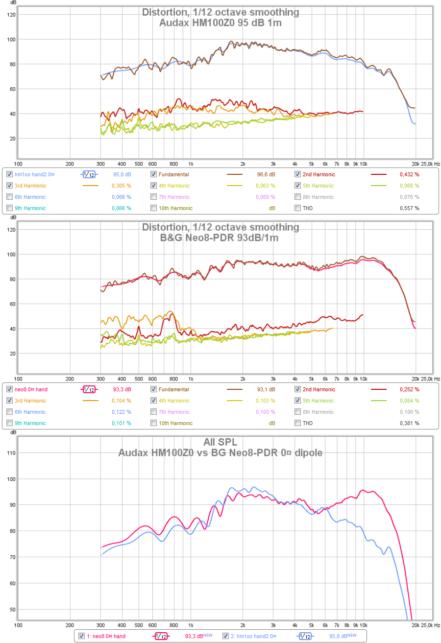

I checked the distortion of B&G Neo8-PDR vs. Audax HM100Z0 both as dipole and just handheld at 1m to mic. IR gating is 9ms in spl graphs. Measured without any eq or xo, range 300Hz-22000Hz.
Both have low distrotion but Neo8 is much better. Neo8 needs less eq to bo crossed at 800Hz. Neo8's dipole peak is higher than Audax. Both have very smooth but different off-axis behaviour (not shown here) because of their different dimensions.

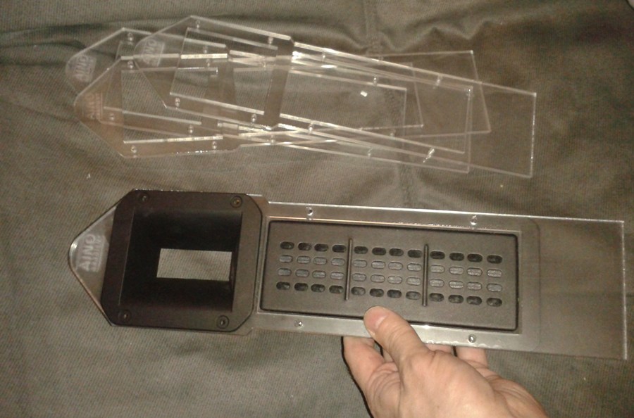

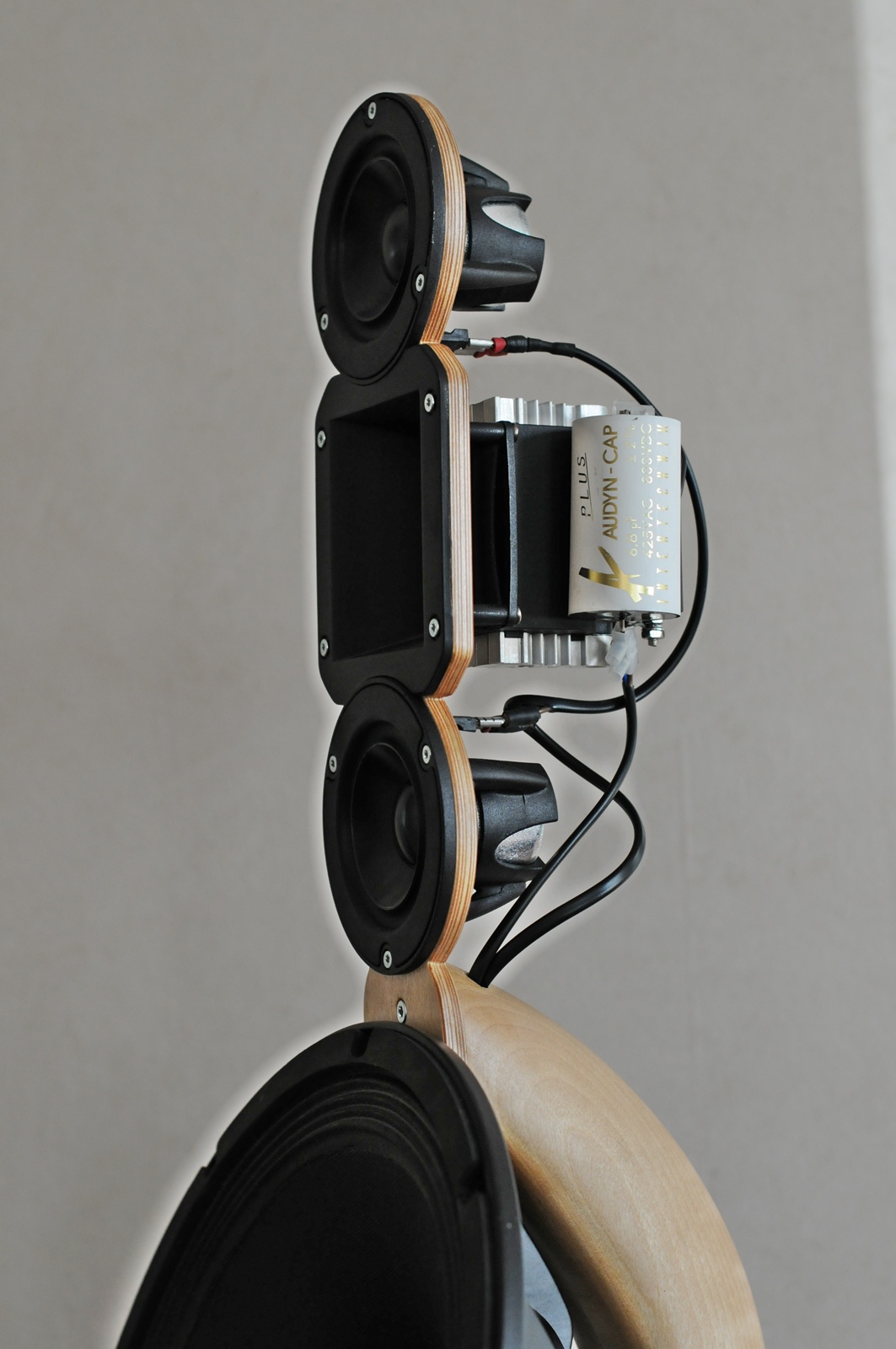

I got the new acrylic frame plates today! Delivered to my hand still warm from cutting! And smelly!
New frames will replace the MTM frames seen in teh first picture. Attached with three screws to the pole supporting 12" driver.
Logo is engraved on the front side. I must install tweeter horns on top to avoid edge diffractions. Neo8 goes to the backside. I don't have M4 bolts and nuts at home now and I have a busy evening tomorrow. Measurements can be expected on friday evening or saturday. Perhaps the sound will be transparent too?

Looks really nice, the Neo10 will replace the cone midranges?
Neo8-PDR replaces double Vifa NE95W-04, MTM becomes MT with c-c distance 150mm. Fountek NEoCD3.5H will remain as tweeter. The thickness of acrylic is 6mm. Width is 100mm/90mm

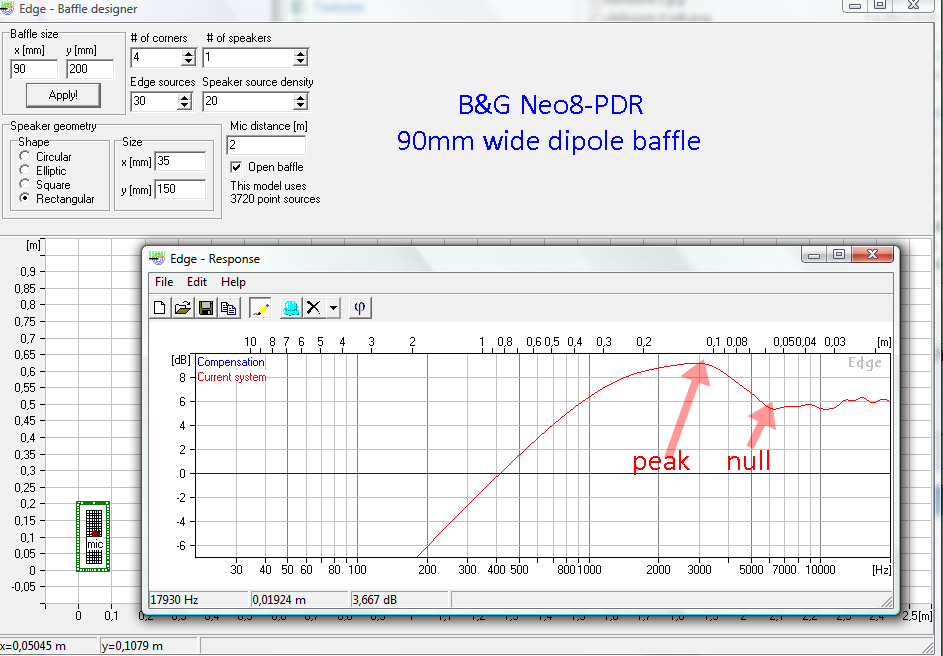

Edge simulation of Neo8 in 90mm baffle. Good match with my measurements in test baffle. Suggested xos 800Hz LR4 and 4000Hz LR8 (acoustic)
Yes Eldam, the aircraft grade birch plywood 2x4mm with tung oil coating looks fantastic. But it is expensive- a carpenter's unique handwork! Sad to throw it away really...

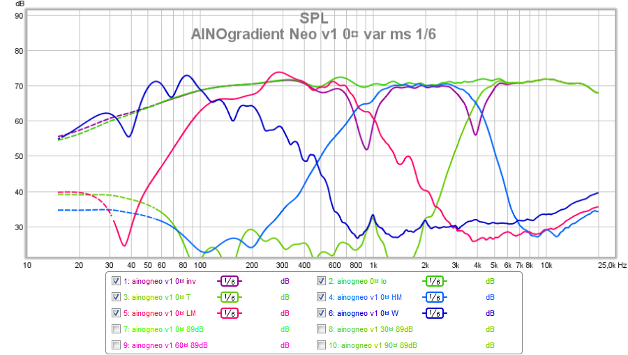

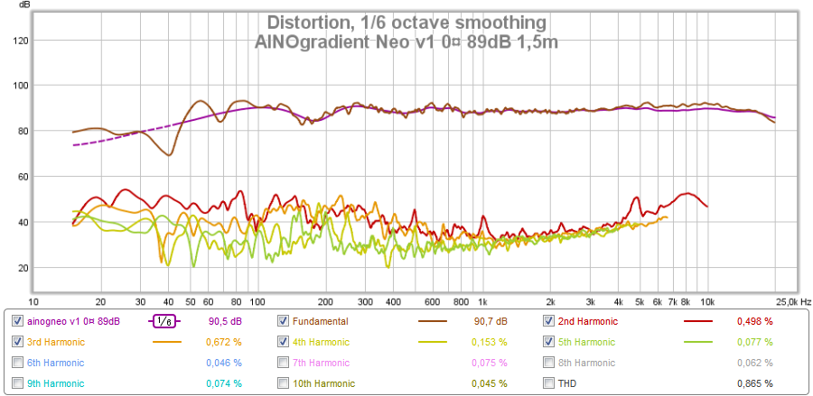

Bad news first - I broke 2 of 4 acrylic frame panesl during my fist test. Polycarbonate will be new material, but it must be cnc'd I guess. Laser cutting lead sto burned/melted edges.

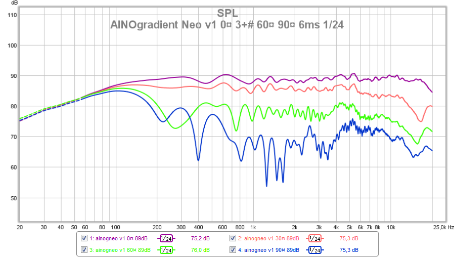

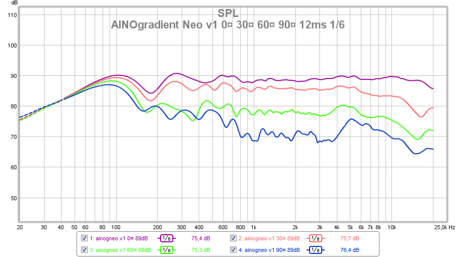

Good news, excellent measured results for AINOgradient Neo ! Low distortion and constant directivity when used below dipole null. Neo8-PDR was crossed 800Hz LR4 / 4000Hz LR8.
Only 0, 30, 60 and 90¤ measured now. Not listened at all yet. 4kHz area is too hot, LR4 4500Hz might be ok with some peq individually for Neo8 and NeoCD3.5H
Notice! Response below 500Hz is plaqued with reflections, indoor measurements!

thanks for measurement. One day you explain to me how you calculate or choose the LP XO of an OB driver in relation to its size 😱
I believe from my own taste that 4k to 5k hz bump will give you maybe some problems.... You maybe pad down the tweeter with 2 to 4 db ? Or an EQ to dig this aera (3k to 5 k hz).
Have myself yesterday a great improvement with a passive notch band pass at 4000 hz - 4db with my main speakers (measurement at 3,5 meters, listening position). before at 5k to 7k.
