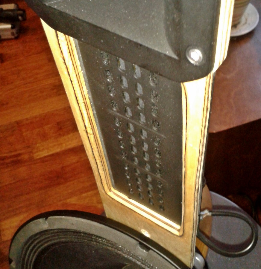

"Fractures were at the lower end of driver openings, not at bolt holes."
Are you referring to the corners of the opening? If so, consider a radius here instead of a square cut out. In plastics, a sharp (even "not so sharp") 90* cutout corner will develop cracks because of the stress imposed by the cut. A radius eases spreads the stress in the material at these points. Just a simple 1/8" radius will do the trick.

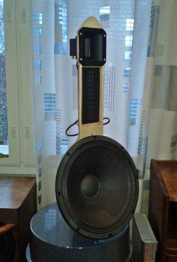

I invested 5€ for a piece of 9mm thick Finnish birch plywood, std quality and made new frames. I wanted to keep width at minimum 90mm, but despite of chamfered edges the Neo8 has some cavity interferences because of it. I can make alternative baffles that are a little wider but with recess for the driver. I don't like how they look, I must try to figure out something new...

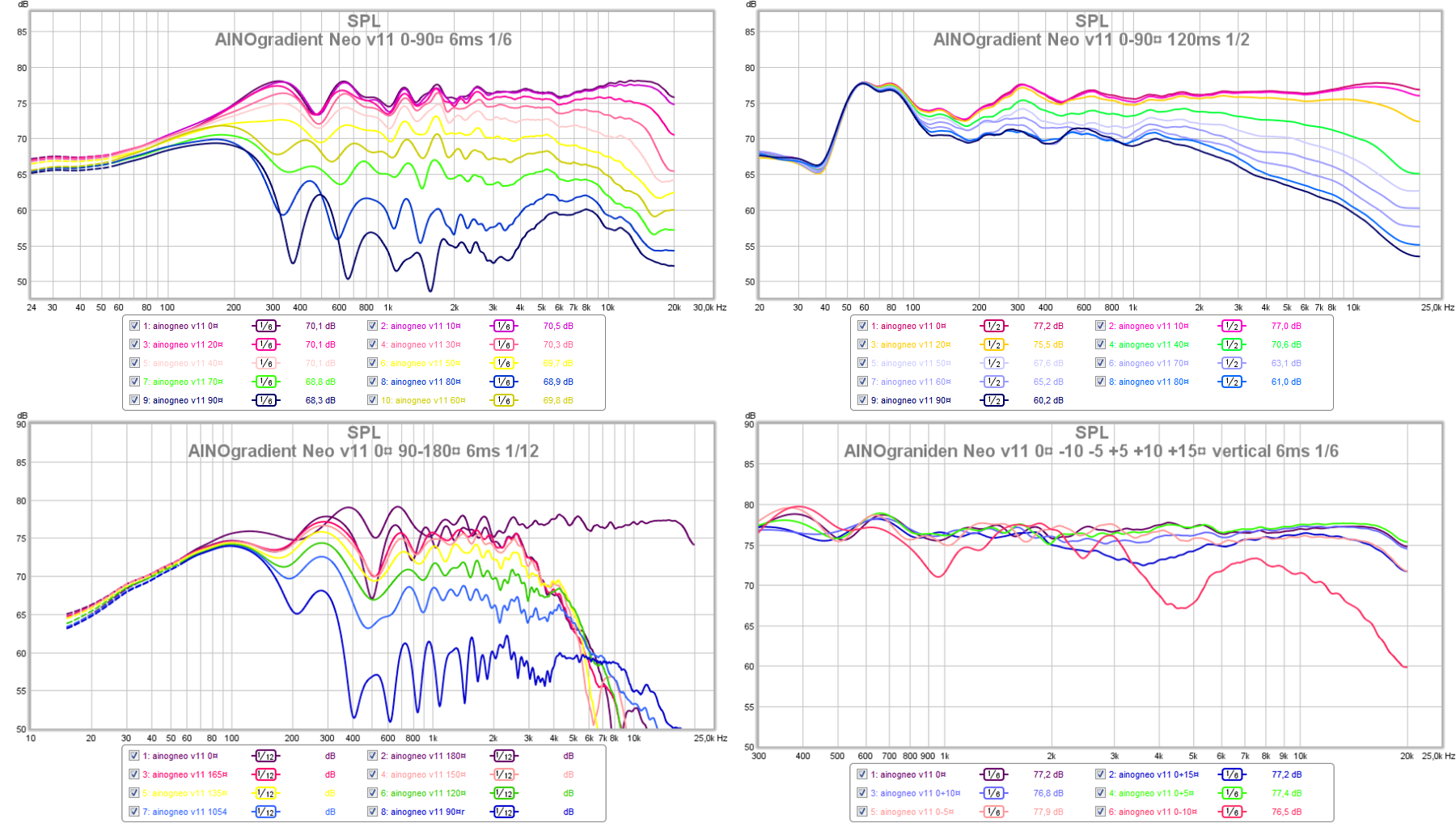

Indoor measurements show well behaved directivity especially the problematic 2-4kHz range. Vertical off-axis is acceptable, 0-level is at the lower edge of tweeter. Distortion is much better than previously between 600-2kHz.
Listened only briefly so far, but it seems like there is added definition and clarity in eg. piano right hand and cymbals. I am wondering where that comes -lower distortion, better dispersion or backwaves reaching higher. Perhaps it is the driver, faster decay? Anyway - success! I think this version will serve me for Christmas holidays😉

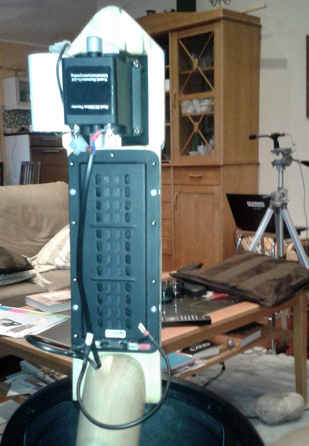

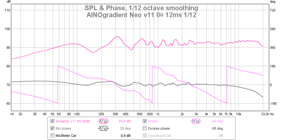

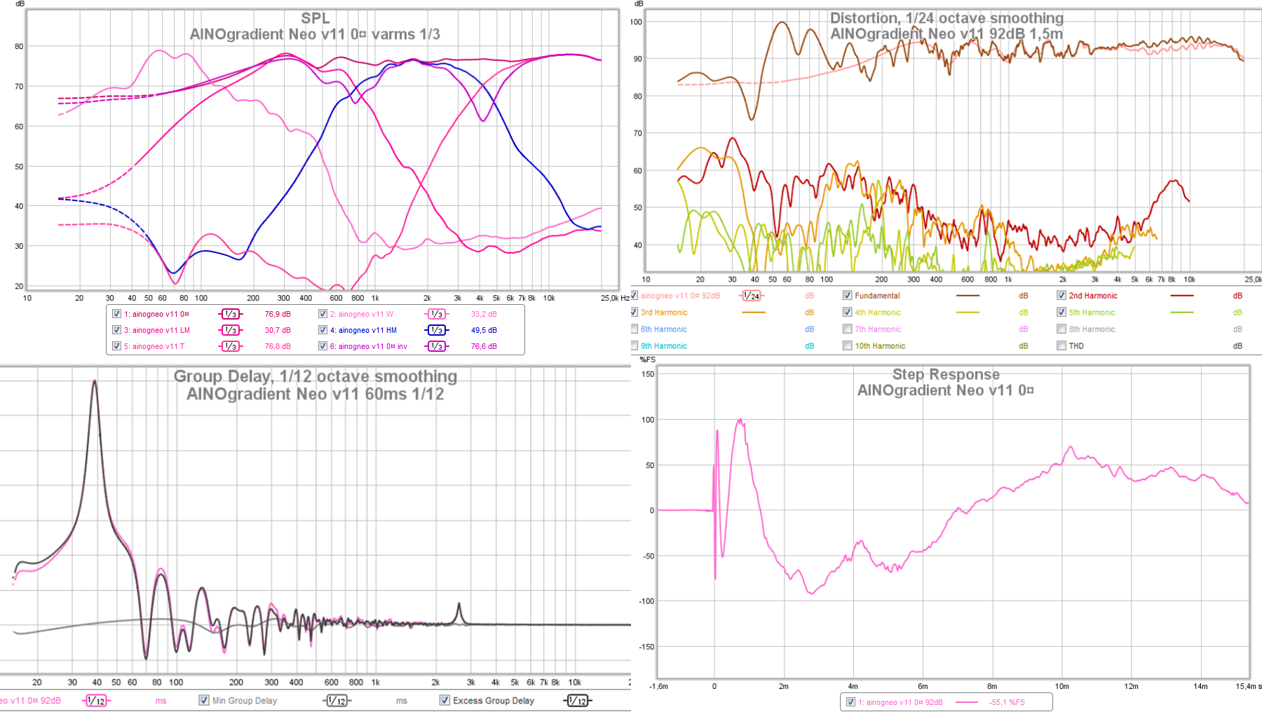

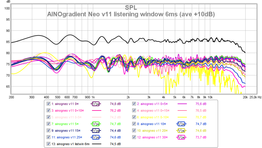

"Listening window" overlay here.
I used horizontals 0-30¤ and vertical on-axis -10 - +15¤ with 5¤ steps - not by book but close enough. We see how hor and vert directivity work together.
Good enough! Low treble range is perhaps too hot, it depends on personal taste. The response can easily be tweaked by personal preference, either for each driver or global eq. Global (input) eq with minidsp is perhaps best from now on, the basic performance is just fine.

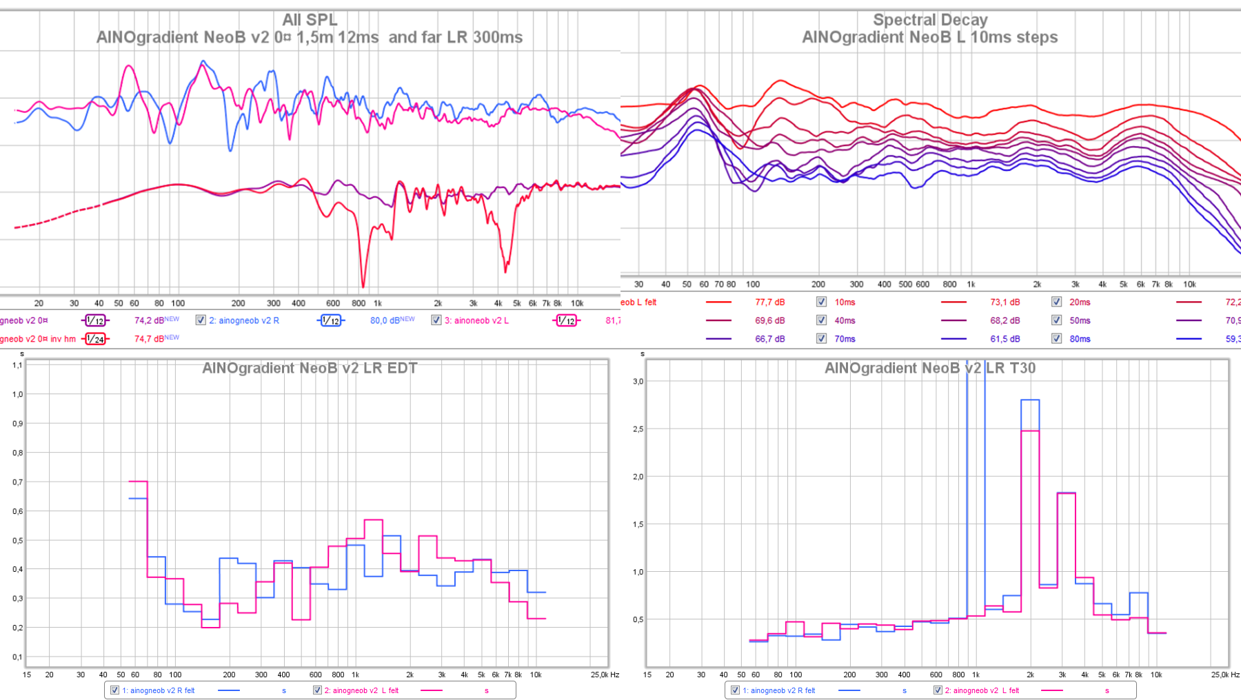

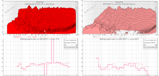

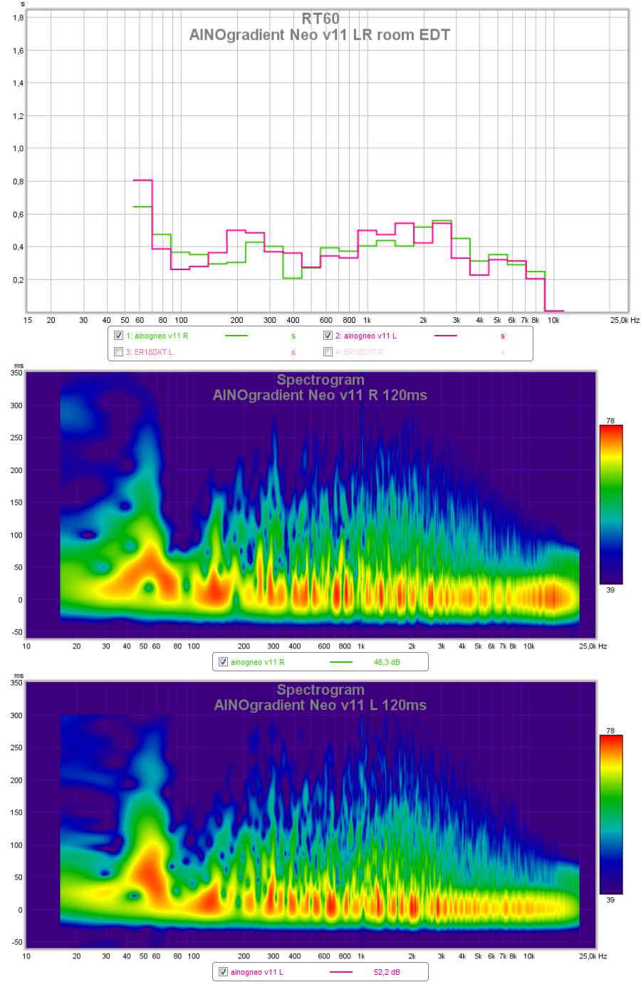

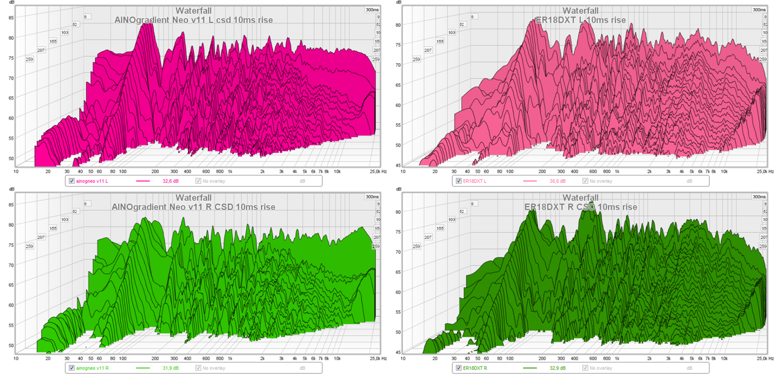

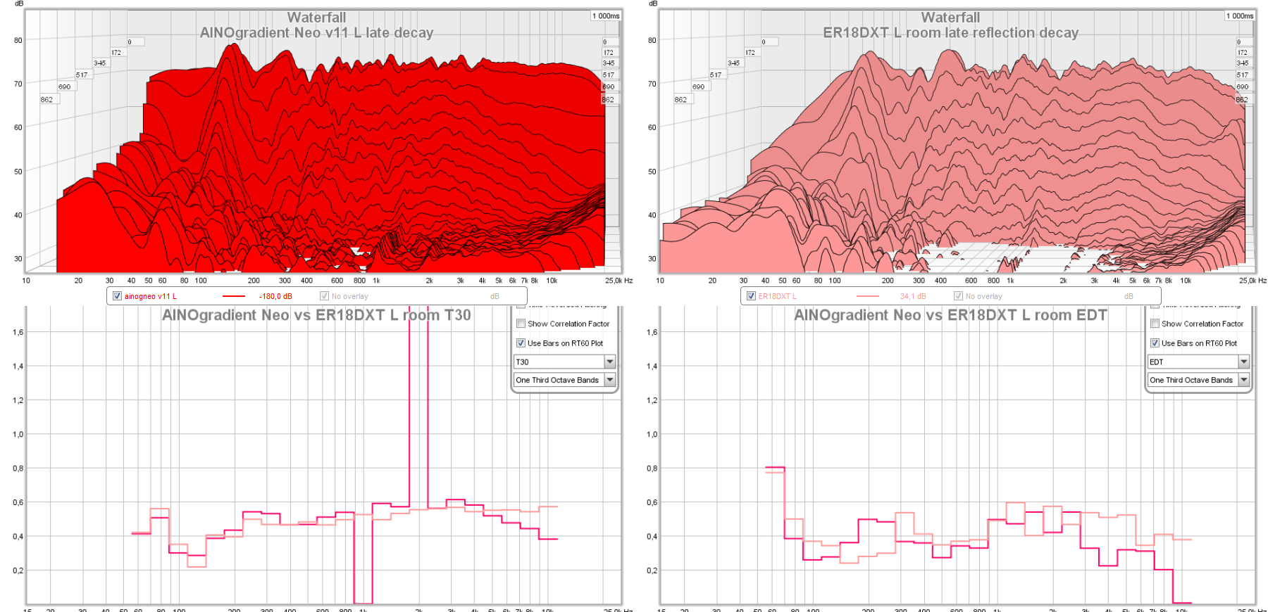

CSD and EDT from room response measurements, distance 210cm, speakers 70cm to front wall. Also compared to ER18DXT (mod) which are normal boxed 2-ways, at same position/setup.
The greatest difference is in tweeter range, the horn ribbon has very fast decay with minimal room reflections. Despite of dipole backwaves, mid region has faster early decay than monopole, but difference is small. Late reflections are stronger with dipoles.
Decay spectrograms of AINOs only. For some reason REW refuses to generate them from ER measurements.

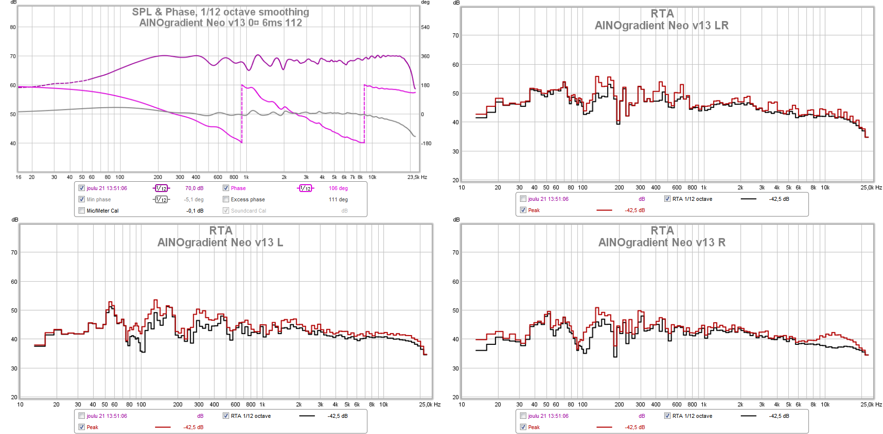

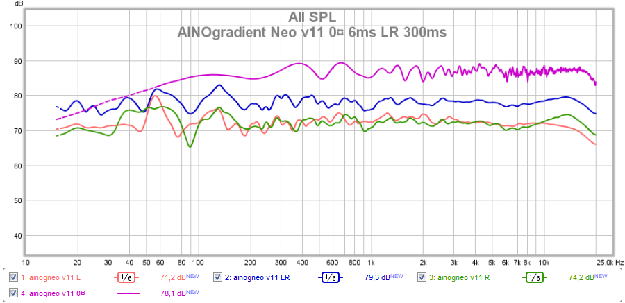

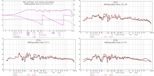

I did some fine tuning and voicing based on listening and RTA measurements. RTA with infinite averaging and moving the mic around my head during the measurement, pulsating pink noise.
Room does not have any acoustic treatment. Room modes and reflections make wiggles, basic shape of the graph comes from the speakers total 3D power response.
1,5 -2,2kHz might still be too hot, but this sound clear and defined, not at all hard or sizzling.
Now just even more listening of various music during holidays...
First measurement is on-axis at 1,2m with the speaker in the middle of the room. RTAs with speakers on normal position and mic hoovering around my head at listening chair.

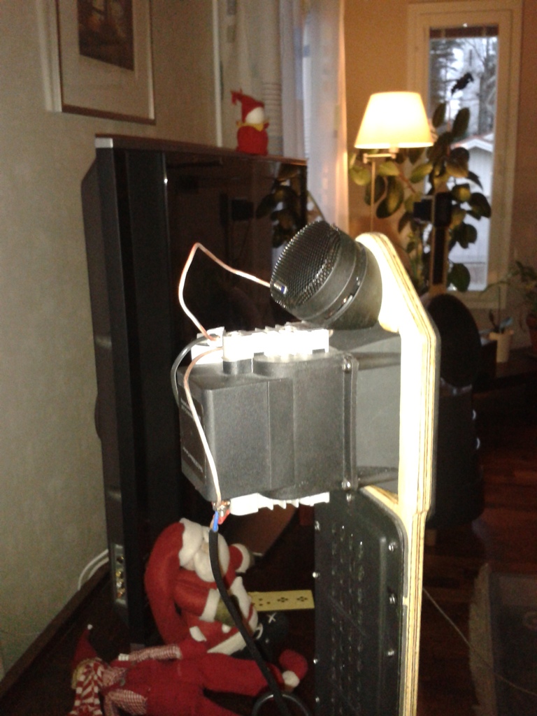

I decided to try backfire tweeters because decay plots and room RTA measurements show that decay above 3kHz is very rapid. It comes because of lack of rearwards radiation and late reflections. My xo is now around 4kHz LR4 or LR8. I'll do and show measurements when I have time and don't disturb the family!
I got a little help from the elves and installed one today. I don't have any minidsp channels free, so I can only try parallel vs- serial and polarity change effects.

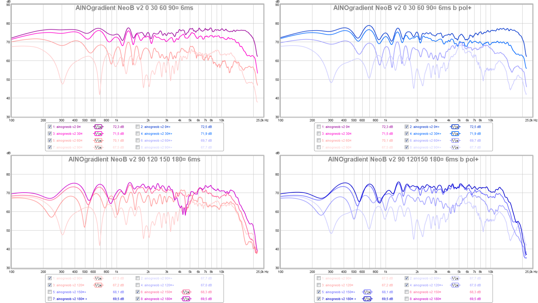

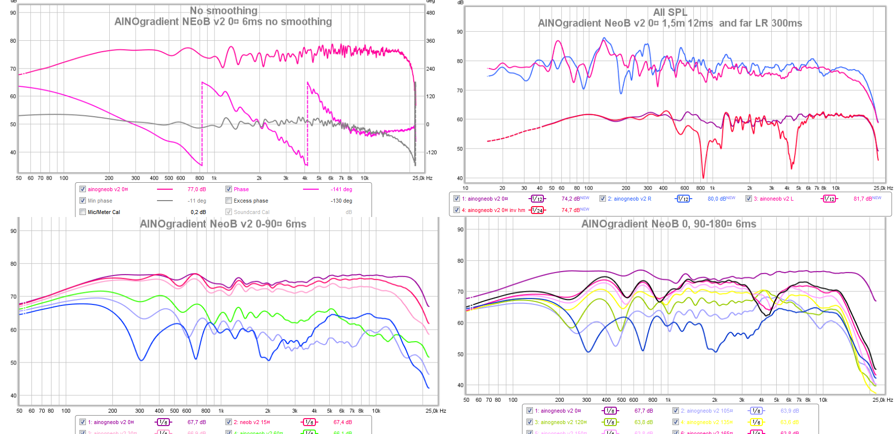

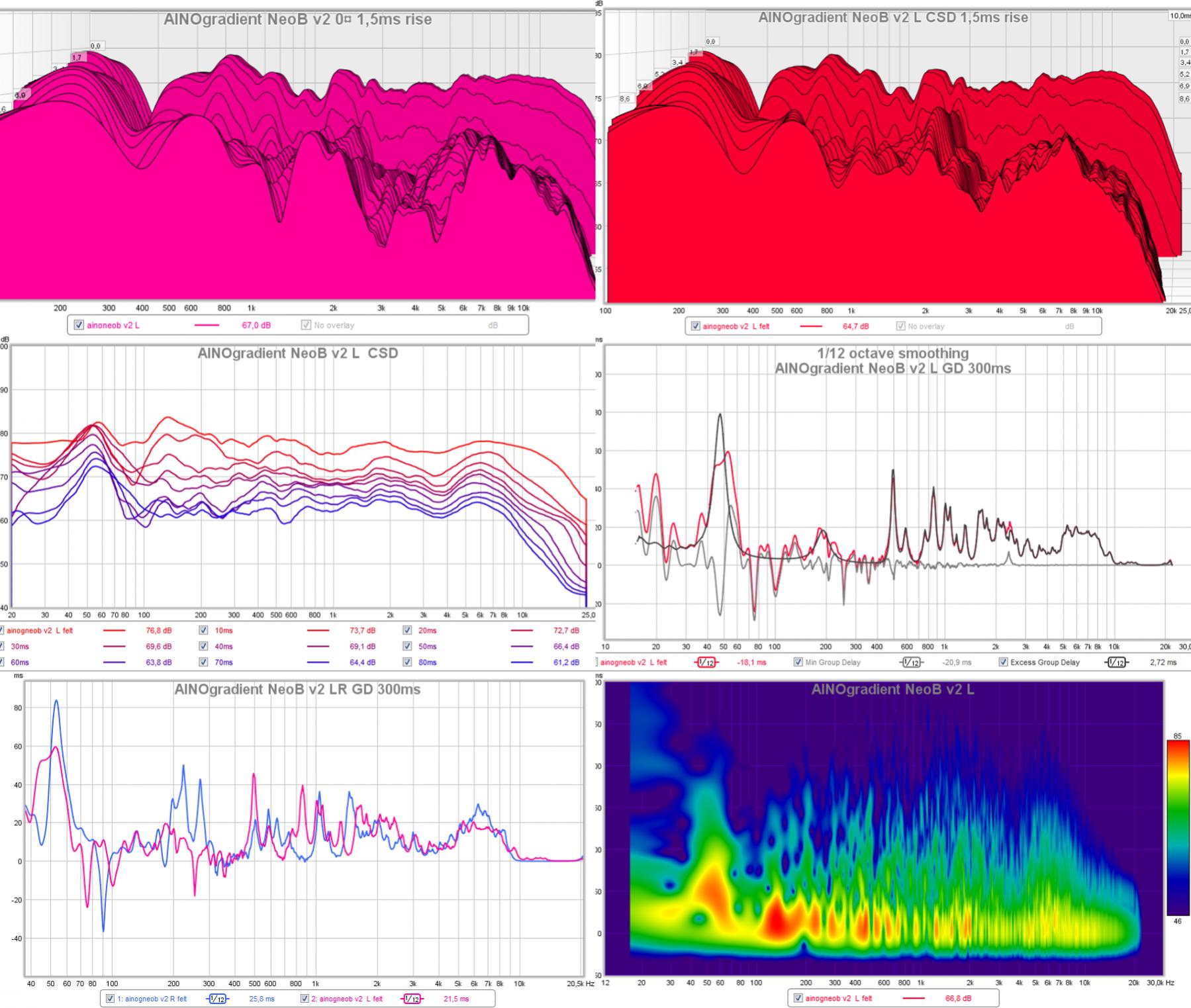

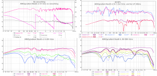

Some measurements of AINOgradient NeoB with back-firing tweeter
A dipole and omnipole radiate equally to 0 and 180¤ but monopole does not. AINO have monopole tweeters but now I tested bacfiring tweeters, connected parallel to NeoCDs. Rear tweeters are pointing 45¤ up because I don't want maximal power to push straight backwards.
This gets a little difficult, we are mainly looking at time domain changes here. Frontside on-axis is not affected at all in short gated measurements, differences appear off-axis and with longer IR gate (time domain).
The problem is that I don't have a minidsp channel left, so I can not use delay, eq etc. adjustments. The acoustic center of the reat tweeter is about half wave length bac, this results in strange summing behaviour that we see mainly in backside measurements. The last compilation shows the difference of changin polarity of the backfire tweeter.
After the nearfield directivity measurements I added 1x2cm pieces of felt on top of rear tweeter grilles, to attenueate them a little. Measurements with L or LR showin in the topic are fardield 2,2m with speakers on normal listening positions.
Measurements show different amplitude response off-axis from 75¤ to 180¤ - making power response different and boosting decay'd response above 3kHz.
