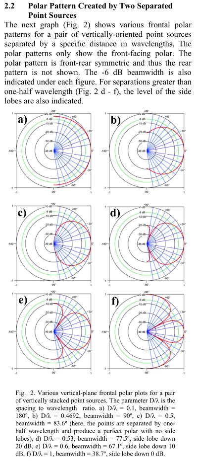

A bit of a long one if there is any interest. I have continued to spend (probably too much) time on arrays that meet the criteria that the midrange goes up to an XO where Ka = 1 (pure pistonic operation), and the spacing between the mid and tweeter is </= 1/4 Lambda at the crossover.
As we discussed before it is very difficult, even with the Bliesma T34B that can be used reliably down to 1.3kHz (it has an impressive Xmax of 1.3mm for a dome tweeter). It is also very wide, and unlike most dome tweeters the faceplate isn't removable, hence difficult to machine away (seems like it would be pretty risky to do it intact!).
The Accuton C51, crossing at 800Hz is interesting as a possibility in the tweeter position, the breakup almost usefully high, though there would be top octave rolloff and high directivity.
One of the problems with the approach is that the array in a large baffle would radiate at 180 degrees throughout. The directivity would be uniform until the tweeter begins to beam, but wide.
I recently found an article that shows the directivity of two drivers with spacing by lambda. This may provide a path to limited directivity in the vertical plane without lobes and relax the spacing criteria usefully.
Then again, maybe best to wait until @mabat develops the optimum waveguide for his Faital 1440f and cross it as low as possible :).

Bill,
for the Horbach-Keele idea to work (links in post #1), the target regime is d/\lambda greater than or equal to ~0.6.
In the overlapping band lobing (big source) and non-lobing (small source) sum to give roughly constant directivity, at least as measured out to some relatively large angle. That needs an unconventional cross-over (H-K or BButterfield's or similar).
It's weird to measure the individual bands (outer ring, inner ring) and get "horrible" results, which then smooth out when the next higher band is added in.
I first found the compromise shallow WG while examining measurements that Fluid had also spotted - see post #87 for links. Better WG solutions appear to generally be too deep for my "against the wall" requirement.
