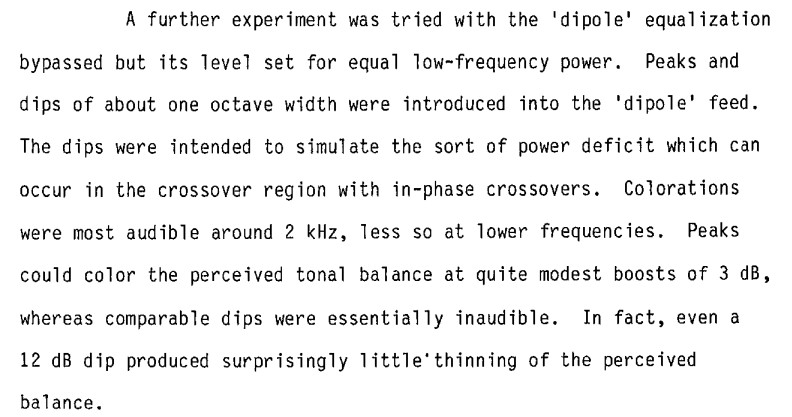

Ken the paper I suggested before is not the right one, that was a mathematical model analysis only, which I worked out when I finally read it :headbash:
Anyway I have now found the study and got a copy of it, it is this one
AES E-Library >> Experiments in Direct/Reverberant Ratio Modification
Here is the section that was being referred to, PM me if you need more

Fluid, thank you for the excerpt - it matches my experience.
Combined with what I set out in post #101 it's becoming clearer to me how to understand the array. In particular, how the "array of small drivers" kind of in-room power response hands over to the central WG/tweeter's "WG-like" declining power response.

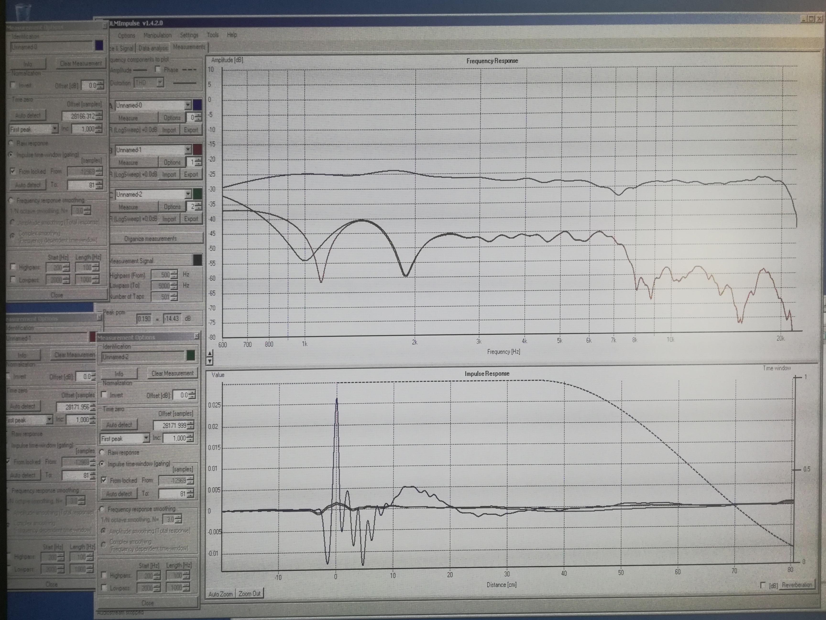

Dips and peaks 2 - measurement
I compared nearfield (~50cm from tweeter) measurements at about 15 degrees off axis (reference) with others in the plane of the baffle, all at tweeter height.
With Holm Impulse, normal gated responses were adjusted such that window reaches zero at about 2ms for all three traces.
Blue (upper curve) - this is the reference.
Red/Green (lower curves) - with outer ring off or on 20cm from edge of baffle, mic tip aligned to the baffle plane. That's ~10cm from the back wall and ~1m from the side wall; reflections from the latter are gated out as are those from the top of the woofer cab on which the speakers sit, the two earliest significant reflections as judged by FR ripples when they are not gated, at least, beyond that come the bigger reflections from the large room surfaces.
It is interesting to see the smooth blend of inner ring and WG even in the plane of the baffle.
The general level in the midrange, at the baffle edge, is ~20dB down from the reference. I've not given this plane much thought before, nor extended simulations out to such large angles, but it seems a good result. I doubt that edge diffraction at this level is a concern in the "sea" of room reflections that come a few ms later.
Dips are due to half-wave cancellations in the array (see green vs red traces above 1kHz). The dips "move around" in frequency depending on both of the angles around the array (altitude and azimuth, etc.). As noted in #101, these average out in the power response as would be expected from an array of point sources, which is a good approximation up to 2 kHz or so.
Ken

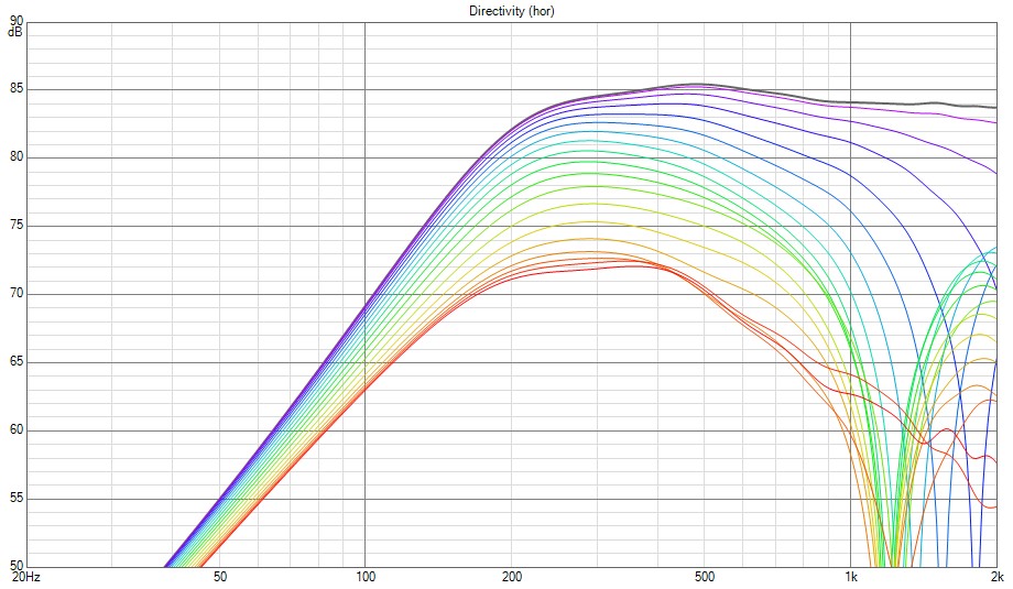

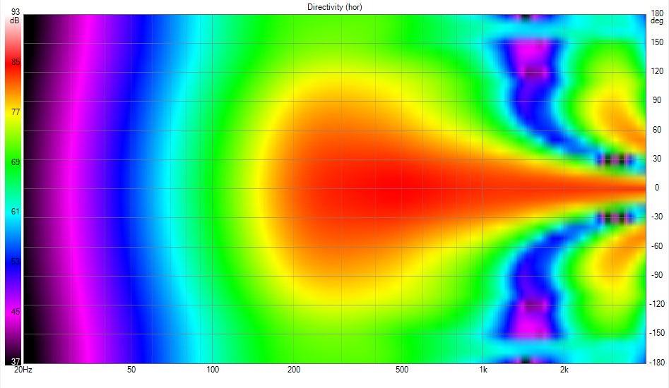

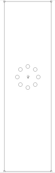

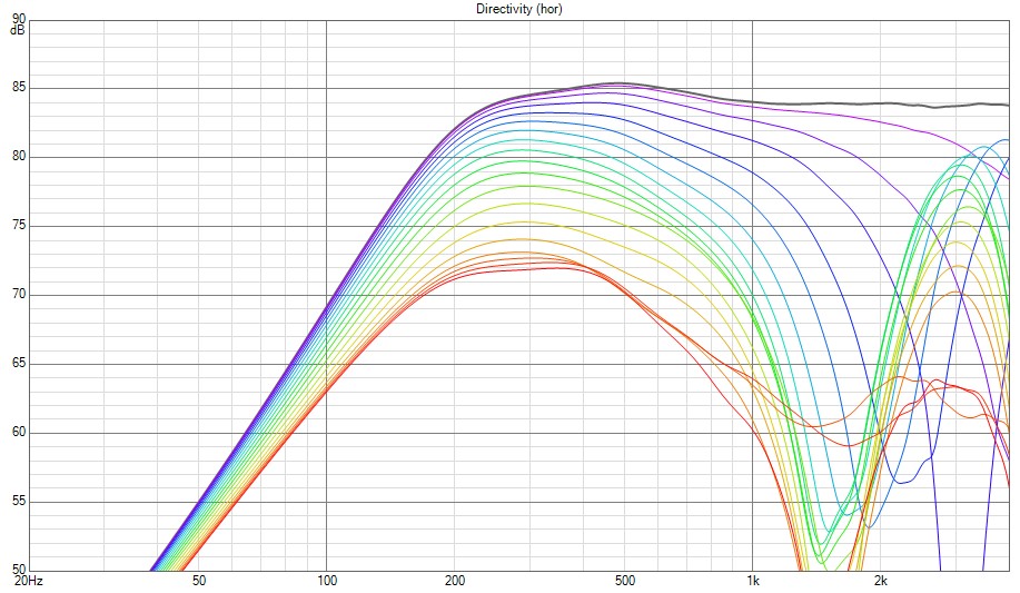

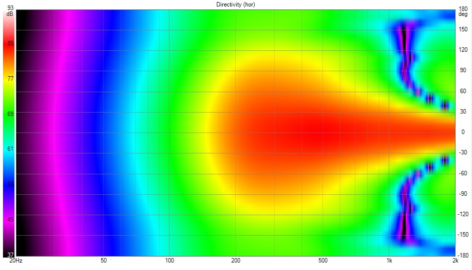

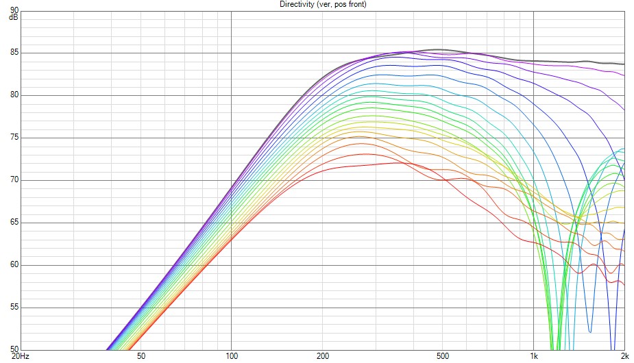

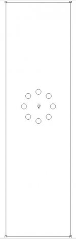

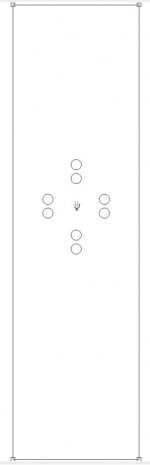

I decided to try and learn a bit more about VituixCAD by simulating the Aura nsw2 (2") driver in a couple of different array configurations. This is using the Enclosure and Diffraction tools to generate a full space response based on the drivers diameter and roll off in an enclosure. This is smoother and more idealized than would be in real life, but the basic principal holds true.
I started with a ring of 8 drivers placed so that a round waveguide of 170mm (Same as Monacor WG300) could fit inside. The baffle is 1800mm tall 500mm wide with a 50mm roundover to help reduce baffle diffraction effects. Virtual mic is 1m height 3m distance.
Baffle

Horizontal
attachment.php
Vertical
attachment.php
Horizontal Polar
attachment.php

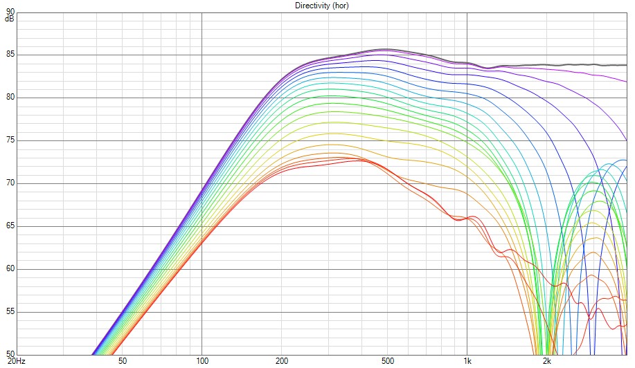

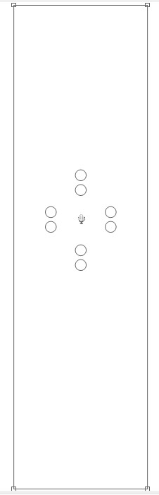

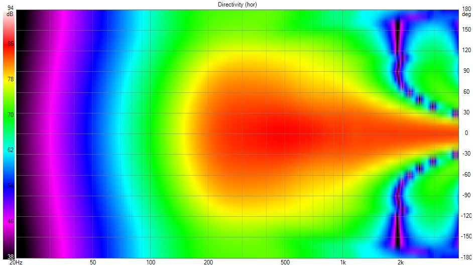

Squeezing the ring down to be smaller with a 90mm centre space gives this response, more wiggle room to keep the nulls out of the power response but narrower directivity with frequency and more difficulty in finding a driver to match the centre space with a similar directivity.
Horizontal
attachment.php
Horizontal Polar
attachment.php
Fluid,
good sims, thanks.
They highlight choices: i) equal H &V or V narrower pattern than H and ii) how to blend the tweeter. My conclusion is that both of these are room dependent.
I started out placing too much emphasis on i) I found little to support narrowing the vertical response (in my context, not claiming generality).
I'm glad I made the last array, despite simulations predicting a dip in power response around 1-2kHz. The result, when the room adds its chaos of reflections, is relatively benign, whether measured or, to my taste, on listening.
It could be interesting to find a solution with less of a dip, but all such appear to be complicated or risk introducing other problems. I suspect it could be another decade before I build such a thing.

Great sims, fluid. Thank you very much.
I have been wanting to do similar with Vituixcad, but don't have a PC.....
Each of the small drivers would have 180 degree radiation up high, so it seems the dips nicely demonstrate the dips based on their interaction in the array only.
If we could cross a tweeter low (and/or or squeeze one in a WG to control directivity) I suspect the power response issues would be mitigated, as Ken has found.
