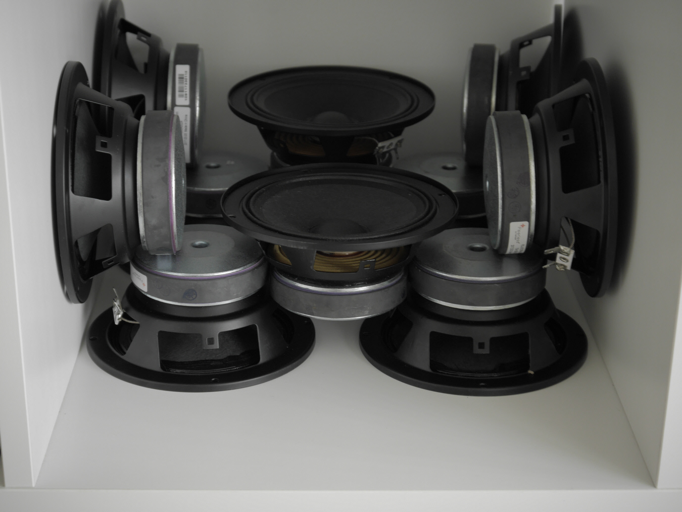

Bill,
yes, that all makes sense, thanks.
I've always been reluctant to spend big $$ on drivers though I suppose I've bought close on a hundred low $ ones over the decades - arrays help push the numbers up. I do see the technical attraction, however, especially the tweeter. I'm less sure that the 10Fs would be worth the extra (at least with the relative cost compared to the 3FE25s in Europe factor 8+).

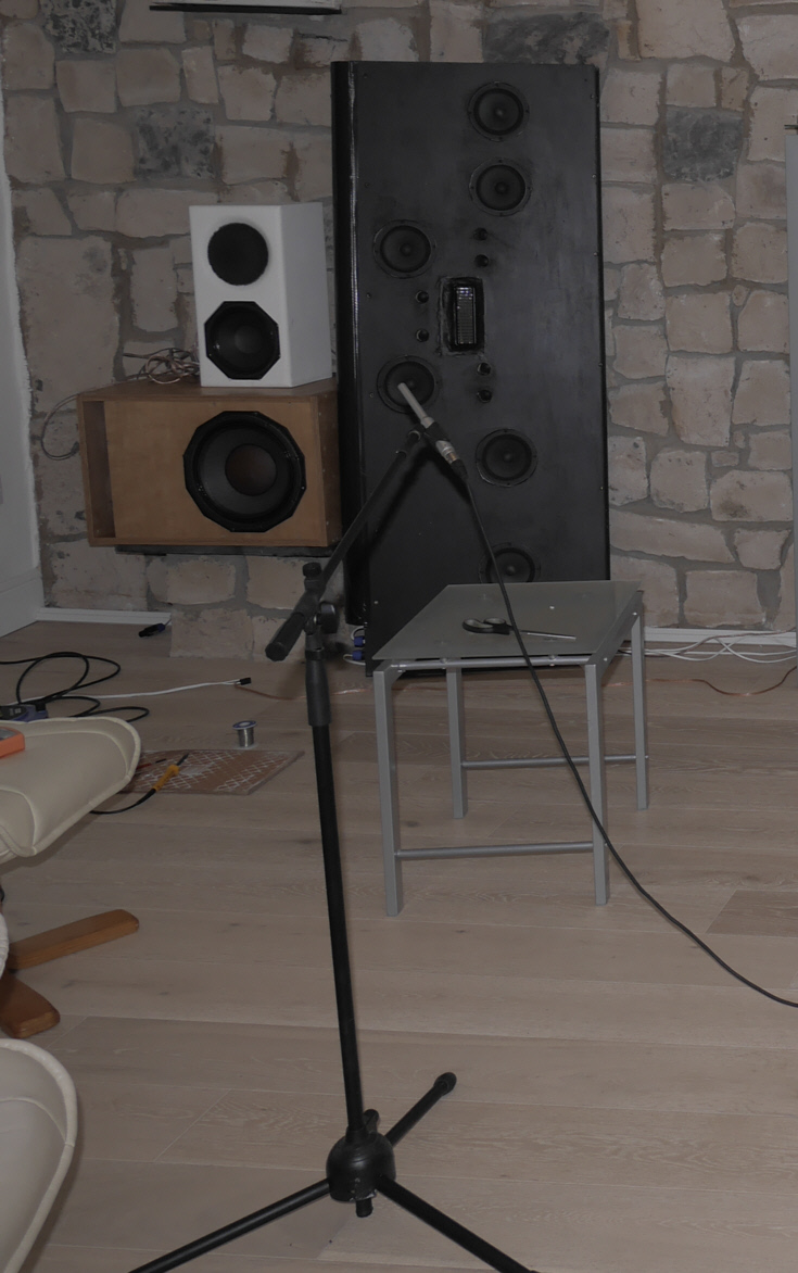

Dips and peaks 2 - measurement
I compared nearfield (~50cm from tweeter) measurements at about 15 degrees off axis (reference) with others in the plane of the baffle, all at tweeter height.
With Holm Impulse, normal gated responses were adjusted such that window reaches zero at about 2ms for all three traces.
Blue (upper curve) - this is the reference.
Red/Green (lower curves) - with outer ring off or on 20cm from edge of baffle, mic tip aligned to the baffle plane. That's ~10cm from the back wall and ~1m from the side wall; reflections from the latter are gated out as are those from the top of the woofer cab on which the speakers sit, the two earliest significant reflections as judged by FR ripples when they are not gated, at least, beyond that come the bigger reflections from the large room surfaces.
It is interesting to see the smooth blend of inner ring and WG even in the plane of the baffle.
The general level in the midrange, at the baffle edge, is ~20dB down from the reference. I've not given this plane much thought before, nor extended simulations out to such large angles, but it seems a good result. I doubt that edge diffraction at this level is a concern in the "sea" of room reflections that come a few ms later.
Dips are due to half-wave cancellations in the array (see green vs red traces above 1kHz). The dips "move around" in frequency depending on both of the angles around the array (altitude and azimuth, etc.). As noted in #101, these average out in the power response as would be expected from an array of point sources, which is a good approximation up to 2 kHz or so.
