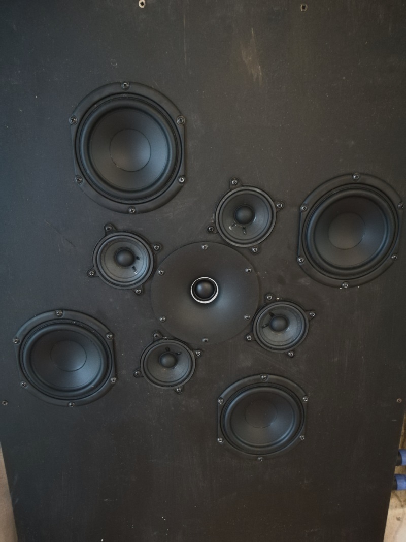

Image of new toy design
I built the above described speakers in only a few hours each. They ended up 608mm x 900mm (sitting ~400mm above floor) x 90mm deep.
Quick measurements of the first suggested it was worth completing both. Thus far I've used crude crossover filters and plan to improve these at some point (though that's more as a matter of principle than due to dissatisfaction with the sound, which I find surprisingly pleasant in the first month of listening).
Image of (nearly) the full test baffle for initial tests.

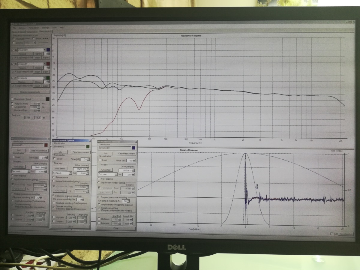

Here is a sample, early Holm Impulse measurement: in room, ~2m distance, ~30 degrees (that's more or less in front of one normal listening position). The default "complex average" in Holm is a crude, heavily-averaged response measurement I used for initial checks of the balance after adjusting the crossovers with higher resolution - there's no equalisation between <200 Hz and ~10 kHz. The measurement is misleading below ~200 Hz, and not the final crossover between the new speakers (red) and a couple of different states of the woofers & sub-woofer array (blue & green) which had not yet been matched to the new speakers.
https://www.diyaudio.com/forums/attachment.php?attachmentid=869930&d=1598181177
As explained earlier, I'm not going to put in typically 1/12th octave averaged measurments used to set the crossovers. It requires a whole ensemble of plots and too much explanation to separate out interference effects from the speaker response. I don't plan to descibe the crossovers, certainly not in their current state.

Thanks. When I measured the 3FE25s on a test baffle, I was amazed at just how well-behaved they are. I'm not surprised that the '22s are just as good. One of the reasons I updated the thread was to provide another hit if someone searches for those little Faital Pro drives. They are a different stratum of quality from the wee Peerless mids up-thread.
Amusing: I'd put the 3FE25s and tweeter in the baffle, connected to a 4 pole speakon tweeter wired to one channel, one mid to the other, and made a measurement at 60cm on the tweeter axis. The response was so extended (IIRC ~14kHz) and so flat - because it was slightly off axis from the 3FE25, that I thought I'd messed up and was measuring the tweeter with its waveguide and capactor. Had me puzzled for a couple of moments.
These were by far the highest fun-to-effort ratio speakers ever, and the most immediately satisfying. The crossovers for the above measurement took about 10 minutes to set up. A huge contrast to failed attempts at an MEH a decade ago.

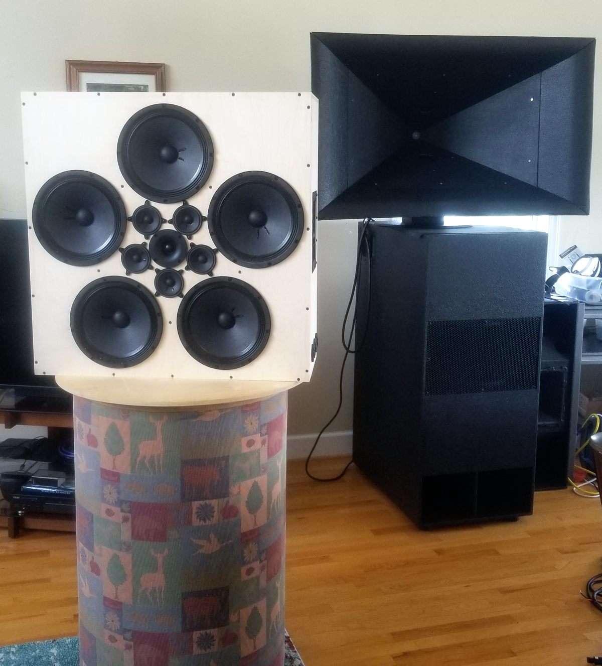

Hi Ken,
Many thanks for your reply a few days back. Very valuable info.
I have meant to say thanks for days.
Been studying all the posts I can find on these things, while working on a first proto attempt.
Just finished the box below which is 29x29x11" interior. Same drivers as dicussed. 68 1/2lbs, yea !
Like i said earlier, don't mean to pirate your build thread...just wanted to show I'm not blowing smoke Lol
Should be able to start measurements tomorrow.....

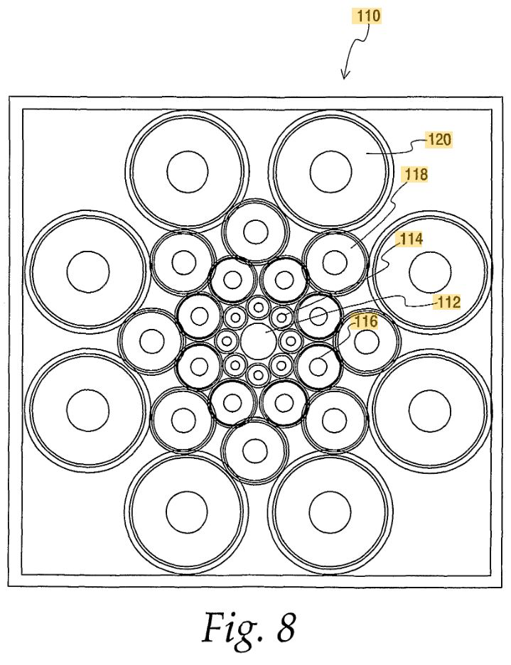

Speaking of synergies...perhaps you've seen this Danley patent ...
US8284976B2 - Sound reproduction with improved performance characteristics
- Google Patents
The depiction of the ring array, and how Tom likens it to a synergy, has been another of the motivating factors for trying this.
There are some comments about the ring at the very end of the patent, that tie with the patent snip below..
I believe the straight-sided conical horn (by far most often horn used), is a bit of a synergy's Achilles heel.
I'm hoping the ring array gives synergy like acoustic combining, and maybe smoother pattern control.
But that hope is, as you pointed out,..... if the dang rings can get close enough, and ring circumferences can match wavelengths, etc...
Synergy issues deja vu 😀

Hi Ken,
Wow - looks fantastic. Have fun with the measurements. Remember you need to allow enough distance for the individual wavefronts to blend (I'm sure you know that). Of course that makes it harder as a longer window is needed...
Nope - I think that's new to me.
Ken
ps. the ring of 10FE200s does look particularly impressive
Thx for the compliments Ken 🙂
i wish they were deserved...measurements were horrible !
First thing I learned was why all the fuss about diffraction....
The SG tweeter with wave guide was soooo bad, this morning I made a standard test baffle to see what's up. Until i recessed it to flush mount with the baffle, it still totally sucked.
Once recessed, it turned beautiful. (I'm a CD/horn guy...diffraction is so much less of an issue with them, i had no experience here...)
So it's obvious I need to make a new baffle for whole project....
I'll recess them all...😉
With regard to the 3" ring, the center of the 3fe25's is about 3 3/4" from tweeter center.
The 5 driver ring consistently gives two closely spaced sharp impulse peaks, about .11ms apart. If i kill response above 6kHz, the two peaks merge into one broader peak. I need to investigate this...but am going to get new baffle done first.
On both the 3" ring and 10" ring, I have 4 drivers on one amp channel, and a single driver on another channel to be able to compare ring vs single.
The 3" single is fine, ring goes pattern whacky above 1-2kHz...my fear is that the spacing is simply to great for use above there...hopefully new baffle changes things.
Tens worked fine, holding pattern nicely though about 400Hz.
Anyway, hope you don't mind all this in your thread. My build simply isn't worth a new thread till it's at least halfway successful .
And since you already get what I'm finding out....i figure if nothing else we all get to keep learning a little from what you've found out about these type arrays.
