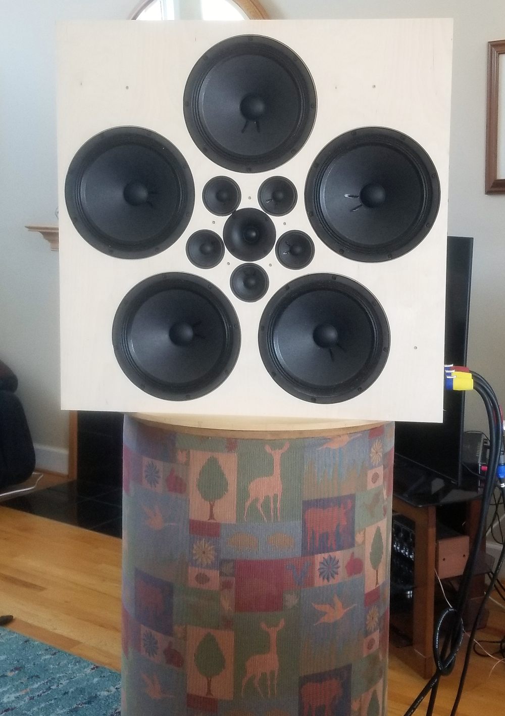

Continued thx Ken,
I figure since i have to go to the trouble of getting a flush-recess mount for the tweeter, i might as well do the same for the 3fe25's (which are a PIA with their mounting tabs), and the 10"'s.
Gonna put a 9mm sheet of BB over existing baffle, and shim/route the various drives to flush fits.

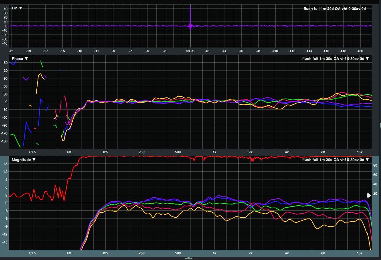

And i think i need to do this flush mount for the 3fe25's to determine why the dual impulse peaks exist.
I measure the dual eaks at any distance from 1 to 3m, onax to +/- 20 deg.
Since they are so closely spaced at 0.11ms apart (approx 9 kHz WL), I can't rule out diffraction...especially since i barely know what it is lol.
If I didn't measure them on axis, I would probably just chalk them up to geometry to mic, ie different off axis time arrivals.
When I say the 3" rings radiation patterns go whacky, I mean solely within the range i hope to use them..which right now would be from about 400Hz to 1.5-2kHz.
This is either raw, xovers-only in place, or full flattening with xovers.
I even questioned if I had any polarity mismatches.
It's why i'm praying for some diffraction effects !
Yes, I use FIR (and linear phase xovers).
The one part of this project i feel 100% confident to handle, is the xovers, and finding/blending radiation patterns.
(If more folks only knew how much easier lin phase is to work with...😉)
Hope to get baffle fixed tomorrow...

Pause for thought
Mark,
I've been looking at your design to see if there are any useful comments I can make. I'd not appreciated how quickly you would cut wood - I'd still be musing or making test baffles 6 months from now.
Measuring from the photo above, I estimate ~10" radius for outer ring and ~3.5" radius for the inner. A ratio of 2.9:1, which is on the large side; that will make it harder to integrate the rings. Integration is easiest with a 2:1 ratio and wide coverage and gets harder as the ratio increases or the coverage narrows. Note that I chose a ratio <2:1 in the latest array.
Let's say the outer ring is directional above ~500Hz - depends on the angle for which you choose to design. The inner ring would then have matching directivity at ~2.9x500Hz = 1.4-1.5 kHz.
The problem I have with this choice is I don't see how to blend the rings very well in the range from 1kHz to 1.4 kHz: seems to me that you'll need to let the pattern narrow and broaden again (that's guesswork, not a model).
What about tweeter integration? For you this is much the same as the problem of integrating an 8" mid with the chosen tweeter: in the horizontal plane - that's a benefit from symmetry, only one problem to solve. I write 8" as most 8" mids have 7" cones.
Aside: if you are concerned about multiple impulses from the 3FE25s, think of those as coming from parts of an 8" cone - but with holes, so the sound doesn't arrive from the whole surface.
If you "pretend" you are making a standard 8" two-way with your tweeter, you should end up with a reasonable starting point filter. It's the standard dome-tweeter problem only marginally helped by the waveguide: it's hitting the directionality (I guess) you want above ~5kHz while the inner ring is reaching to 2.5kHz at best.
Given the above, I'd likely choose to run the outer ring to 800Hz and the inner to
2.3 kHz where it is 10dB down at ~45 degrees. With the tweeter something like 10dB down at 1.2 kHz (as well as another 3dB chopped off the tweeter response to flatten it below 5kHz).
How would that sound? Of course that depends on the room. It's worth throwing together some FIR filters and trying that. It might be better than you expect.
At the moment, I'm not sure what else to suggest.
Ken

Hi Ken, really good stuff 🙂
Your explanation or radius ratios makes total sense.
I had built a speadsheet for pattern control, based on ka charts, and also on Dunlavy's formula for coverage angle, = 57/(diameter/wave length in inches).
But i hadn't yet connected the diameter ratio rule of thumb, you showed me.
Your radius estimates were dang good !
3" is 3.625", 10" is 9.75". I don't really know how to spec the tweeter, but the curvature in the waveguide ends at about 1.44" radius.
Big question...when you say radius....
do you mean to driver centers (seems so) or to outer periphery ?
Which do you find correlates best with off angle measurements?
Ideally, I'd like about a 80 degree pattern control.
I get the contraction-vs-widen blending game between driver sections.
Re-looking at measurements, I'm guessing 600Hz and 1600Hz might be best xover point compromises with the drivers in play.
Oh, and pls don't ever think I'm invested in a design I'm working on...
I'm a build, measure, rebuild, re-measure, on and a on type guy....simply cause it's easy and fairly cheap for me, and i feel i learn alot doing so...
So tell me straight. and trash me ideas away 🙂

Good questions
The standard formula for coverage is the place to start.
Here's how to understand the radius: the small drives that make up the ring act as point sources, and to a first approximation those drives can be replaced by points on the ring. I've checked this by simulation, for the rings in my speakers, and it's a close match up into the crossover range for each ring. I did a quick (i.e.<30s) simulation of a ring of five 10"s in Edge and it's the same with a ring like you have: changing the drive size from 10" to 1" barely changes the response at 30 degrees up to ~900Hz. A nice thing about Edge is that you can adjust the size of all elements with a couple of keystrokes. Above 900Hz, 10FE200s aren't like pistons anyway.
For 80 degrees, I would look for a much more directional tweeter: down to well below ~1.4 kHz. - probably a CD+WG. Unfortunately there does not seem to be anything commerically available. [For my own use, the best I could think of was taking a mold from one of my Harpers and modifying that to include space at the edge for a ring of mids - that's a little wider than your 80 degree target].
I believe 1.44" is an over-estimate of the effective acoustic size of the WB WG (look at the coverage at 5kHz shown on the datasheet). Anyway, what matters is the pattern in the overlap range with the inner ring - you need to find a way to merge them together keeping the summed pattern as smooth as possible.
My AMTPRO design managed to yield narrow vertical coverage by using six drives per band, including drives close to the tweeter. This knocks the worst lobes down, but can't be done in two dimensions at once.
You might think of something like an XT1086, but the narrower vertical radiation and pattern flip breaks symmetry, and forces the rings to be distorted too. I'd recommend a (non-existent?) circle, square, or -for you - a regular pentagon.
As an example, if the XT1086 has acceptable coverage above 1.4 kHz, you'd want to transition from inner ring to WG from 700 to 1400Hz (and suitable CD). With the 10" wide WG a ring of 3FE35s is a little too wide for an easy transition. There might be a compromise to be had there, however, as the gap is not huge (I did a quick sim in edge with 6 3FE25s close packed around the outline of an XT1086).
I gave away my XT1086s years ago - I didn't like the sound at ~5kHz.
A better approach would be to use "mabat"s tool to design a custom 80 degree WG about that size - OS with a roll-over suited to the purpose.
I'd probably start around 22" for an outer ring (perhaps of four 10s). (Other than Edge simulations, picturing this in my head, so unsure how it all fits together.)
If there was something like an XT120 but circular (say 7" OD) I'd have tried that with a ~10" ring. Follow that logic a few more compromises, and you see the path I ended up taking.
Ken

Mark
Quoting myself: "I believe 1.44" is an over-estimate of the effective acoustic size of the WB WG" is not well phrased.
The WGs on your tweeter and mine are not approximated by a piston radiator of any size. That's the point of constant directivity waveguides. The rest of the paragraph stands.
The rings can be modeled as pistons as a starting point, but the tweeter WG can't - it is not right to think of an equivalent diameter when there's a WG.
The W148+tweeter combi that I use is about 6dB down at +/-60 degrees off axis at 1.8-2kHz, narrowing slowly to ~90 degrees full-width at 10 kHz. At ~1kHz it's close to a point source with roughly the same sensitivity as the naked tweeter has at 3kHz.
Even with this friendly tweeter+WG, integration with the inner ring is not easy. There are very few combinations that do as well as this.
If we believe the datasheet, the SB26STWGC waveguide is directional above about 3kHz suggesting an inner ring considerably less than half the radius of the one I use. That is impossible with the 3FE25. Even a ring of 1" Aurasound units or similar right against the tweeter would be a little too large.
The SB tweeter might be more directional than the datasheet suggests, even so, there's a gap to fill.
Ken

Hi Ken, everything you are saying makes good sense to me.

All i did was add a 6mm piece of BB over the existing baffle with cutouts for all the drivers ..looks better too, I think 😀
Anyway, this morning has been my first chance to try to tune with the flush baffle, and it's unfortunately an attempt made at only 1m indoors.
Because there is so much dang boat traffic out on the lake stopping outdoor measurements. (but it's really nice to see everyone having fun!!)
As near ridiculous as i imagined 1m tuning would be for this, i think results held up surprisingly well.
X-overs used were: for the 10"s .....100Hz LR8 & 520Hz LR8.
for the 3"s........520Hz & 1.6kHz LR8
for the tweeter.......1.6kHz LR8 & 20kHz BW4 .
(Linear phase xovers and min phase EQ's based off raw polar averages.)
Below are horiz polars in 10 degree increments, 0-40 deg.
1/6th smoothing mag and phase.
They go in order of the rainbow colors, ie violet =0, orange =40.

Mark,
looks promising.
The directivity broadens at the two X-Os. You've got too much of the inner ring at 520 and too much of the tweeter at 2k. The latter is as expected, probably hard to solve, the lower one should be fixable using a different crossover (higher, shallower).

Yep thx, i think that about the rings' xover points too.
I was actually trying to optimize at 1m, vs the raw polars, just for ring-tuning practice, knowing it's more hokey than not.
I saw that response for both the 10" ring and 3" ring fell super fast up so close, as angle and freq increased.
So I let the xover points move low enough to handle the response fall off.
I'm completely sure xovers can move up when at a more reasonable distance.
Plus, need to get the SG26 above 2k just for SPL safety room, i think.
Oh, i did try shallower xovers....was worse all around...
Tried steeper too, no real improvement....

Ken,
You are clearly correct about the difficult matchups I threw together.
Outdoors, testing at >3m did not solve the rather drastic narrowing up close indoors that was forcing lower xover points of both the 3" ring or the 10" ring when off-axis more than 20 degrees.
The 3" ring is pretty much unusable above 1.7kHz. The 10" unusable above about 650Hz.
And I've seen the SB26 has some very nice curves when on its own smooth baffle, but the flush plate overlay has overcome only about 1/2 the diffraction issues.
So, it's scrap-pile time for round one!!
Time to rethink, study some more. (which btw, sorry for getting your projects confused as to where you currently are...)
Anyway, these arrays are really intriguing...thx for the nice help...

near post 54...
My best response was with an array of DMA45 1.5" full range driverrs. When I replaced the central driver with an OC25 tweeter, the polars weren't quite as good. One needs a minimal waveguide to control the tweeter and then you get the spacing issues you've been discussing. Using 1.5" drivers for the mids helps...
The beauty of Vituix is if you have the directivity of individual drivers, then it can calculate the polars of the array. For cone drivers, its baffle diffraction tool does a decent job of synthesizing drivers for a quick look. For a waveguide, you would have to measure.
So if someone posts directivity files for a small waveguide, it would be fairly easy for me to put a Vituix sim together like I did in the referenced post.
Not too long ago I simulated something close to what you are doing - tekton tweeter arrays in this thread
https://www.diyaudio.com/forums/multi-way/336743-help-understanding-tekton-tweeter-array-schematic-6.html#post6316442
near post 54...
