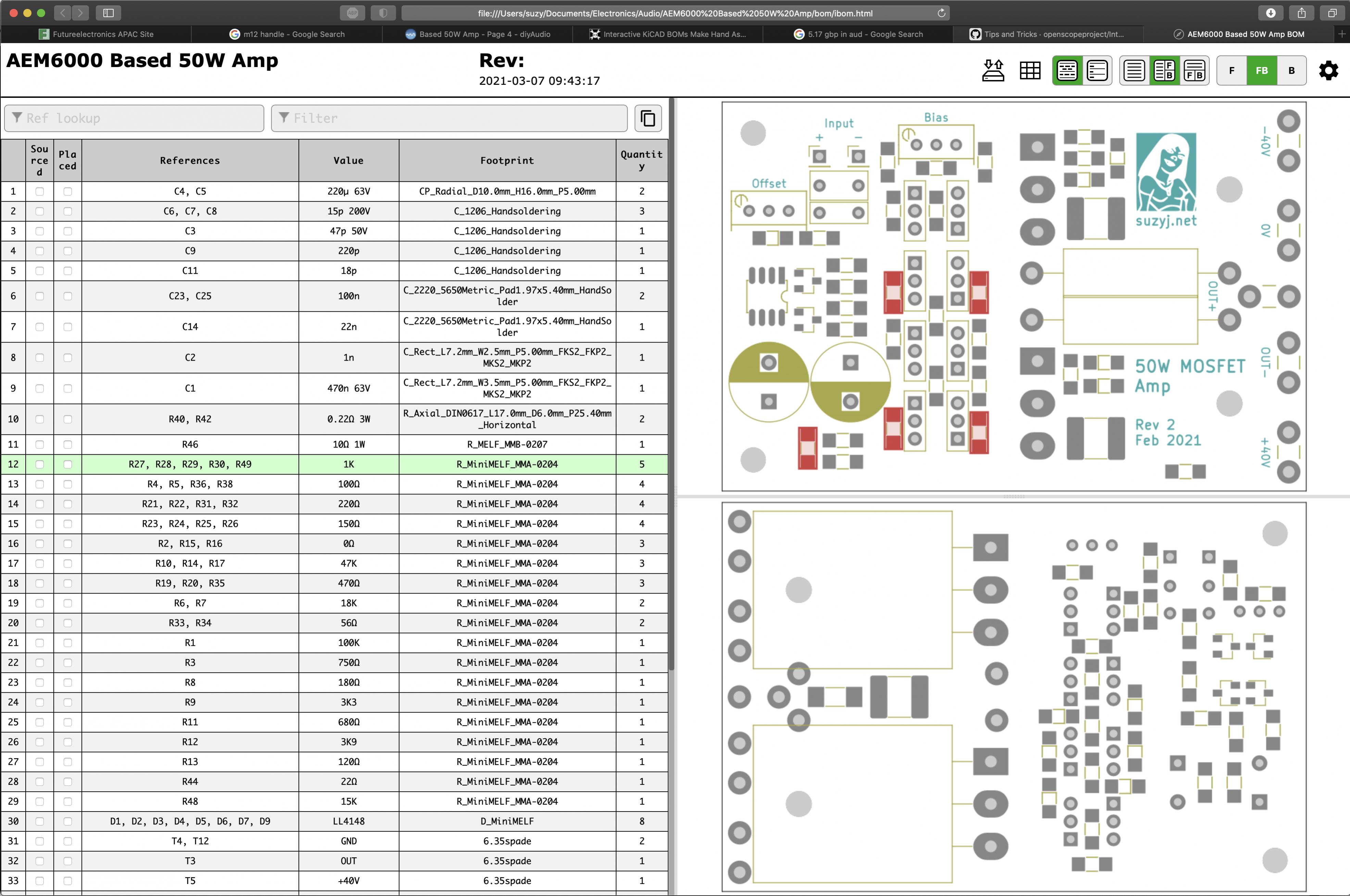

Hey Suzy, have you considered trying out one of the KiCAD plugins that allow you to export an interactive assembly diagram as a .html file? Since you don't really use designators in your silkscreen, this could make assembly easier for people building your designs and might be another step forward in your KiCAD journey 😉 I haven't tried it myself but I was going to use it whenever I publish a design that lacks silkscreen designators. Also interested to see what your lab PSU design looks like!
Interactive KiCAD BOMs Make Hand Assembly A Breeze | Hackaday
Edit: Maybe someone suggested it before (didn't read all the pages in between tbh), but I just used the stuffing diagram that came with the first version of the 50W amp and thought you might be able to improve upon that with very little effort (hopefully).
What a truly wonderful tool.

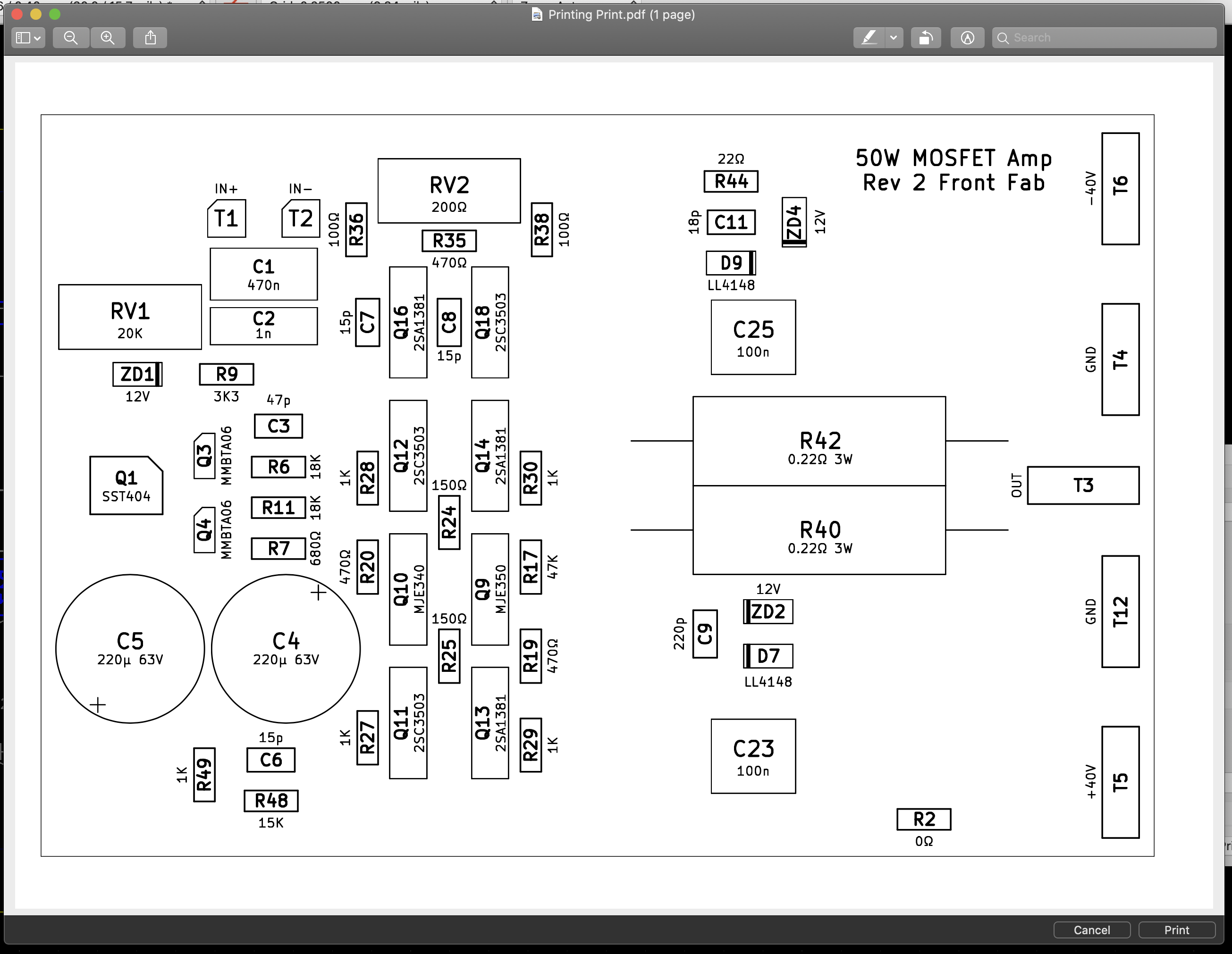

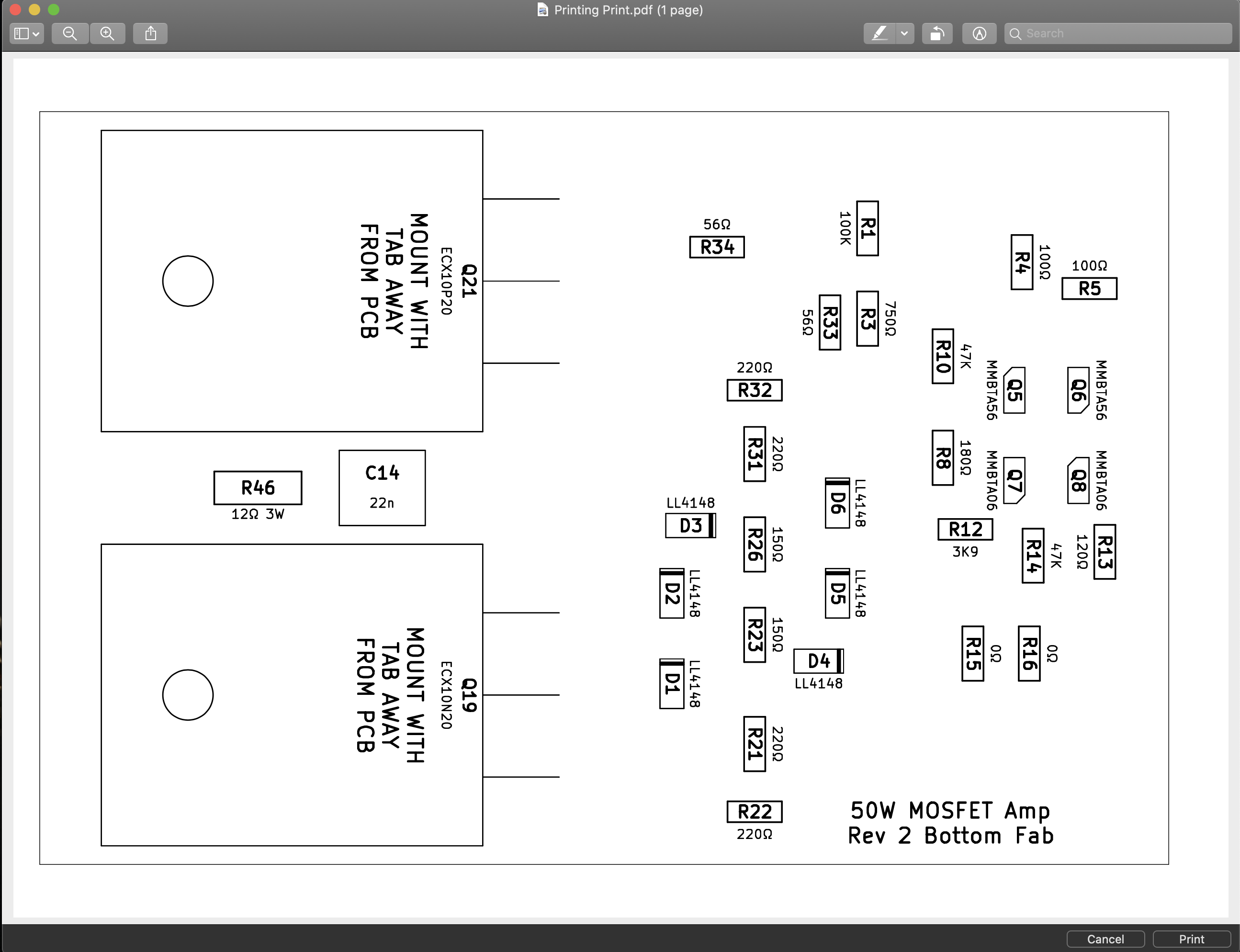

I've been creating new Fab layer plots today, and building a rev 2 amp (with Renesas TO-3P FETs, as that's actually all I've got in stock - been building too many amps). I put together a shopping cart of double-die Exicon FETs in TO-264 and TO-3, but I'll have to wait until my play money has recovered a bit from buying power supply parts before hitting checkout, or face significant doghouse time.
If you look closely at the doco for Rev 1, you'll note that the PCB layouts are a bit clunky. This is because they were done in Protel '98. It's nowhere near as clean to drive as KiCAD. The Rev 2 amp is completely drawn in KiCAD - schematic and PCB, so I can do nice fabrication plots. Like those below:

That tool is so incredibly cool. I shall never print fab layers ever again.

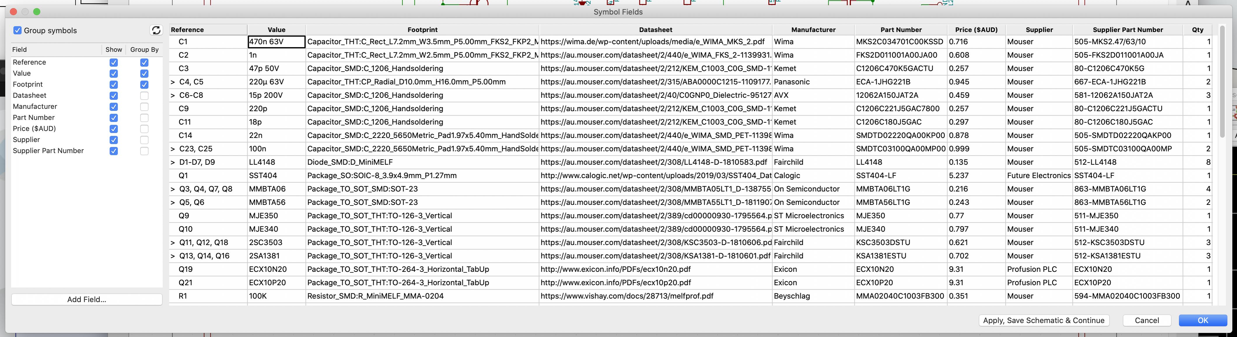

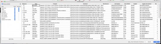

The other one I found was how to edit every single part on the schematic in spreadsheet form, to rapidly build a coherent BOM, with all the detail for everything, without having to tediously open every component. Just go to Tools -> Edit Symbol Fields, and you get a spreadsheet view, ready for copy and paste from your favourite vendor.

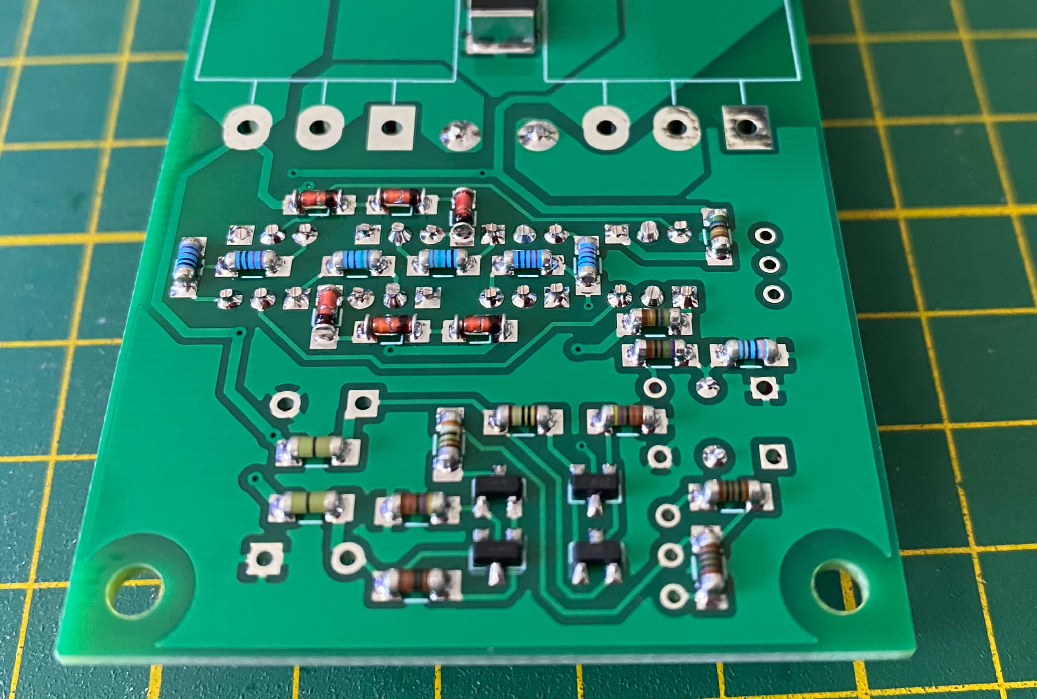

The new TO-264 boards are coming together rather well. It’s nice to have a helper.

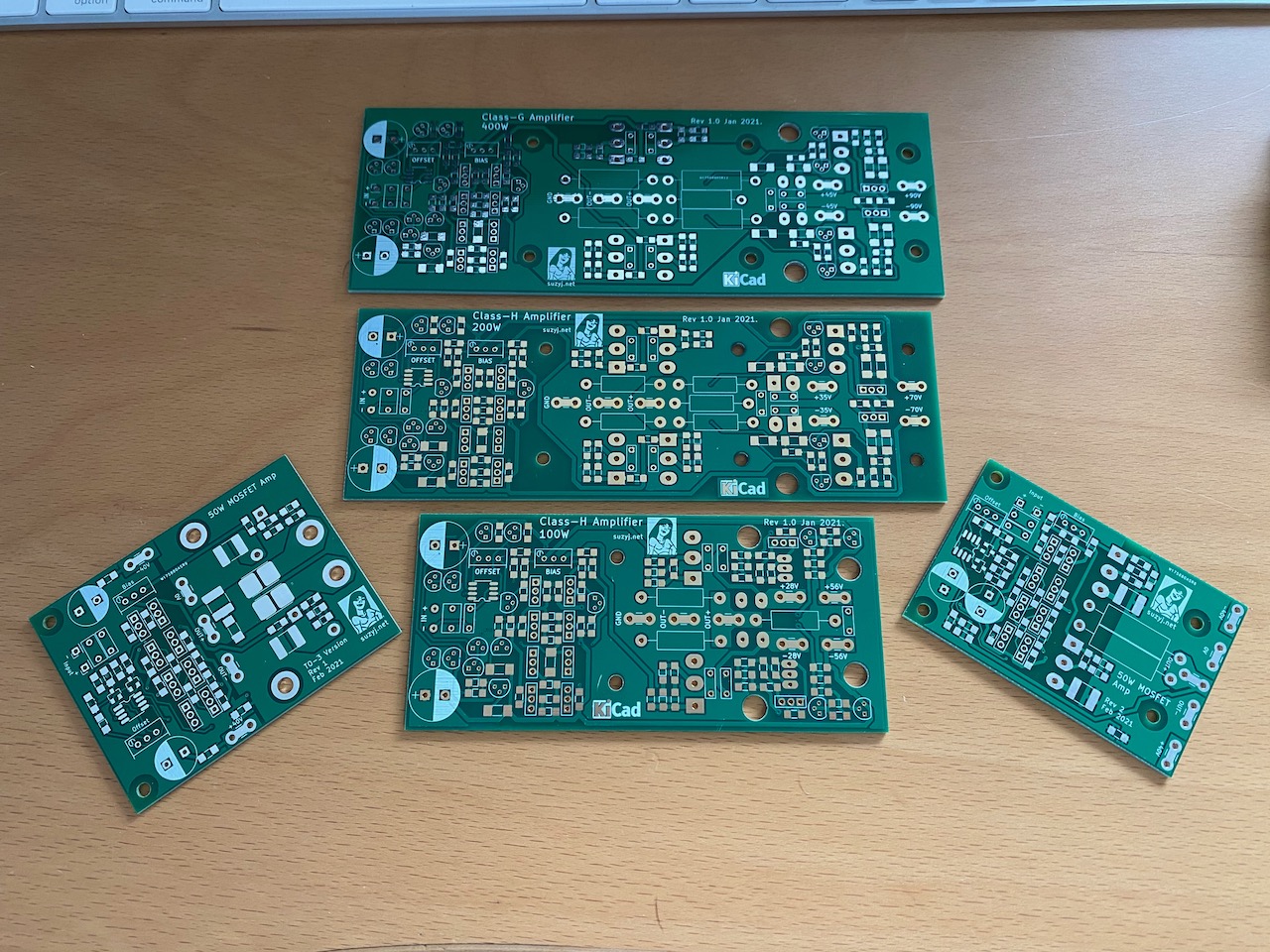

50W Amp TO3 Version:
AEM6000 Based 50W Amp TO3.zip - Google Drive
I've included all KiCad design files, to encourage you lot to try KiCad, plus a BOM in numbers format as well as excel format, plus interactive bom, plus gerbers.
Bear in mind I'm still building this, though the differences from the previous 50W version are very small so I expect it to work without issues. If you want to build it with double-die MOSFETs, you'll have to wait for me to prototype and sort the compensation out - or you could sneak a peek at my 100W amp for where I will start with compensation caps etc.
