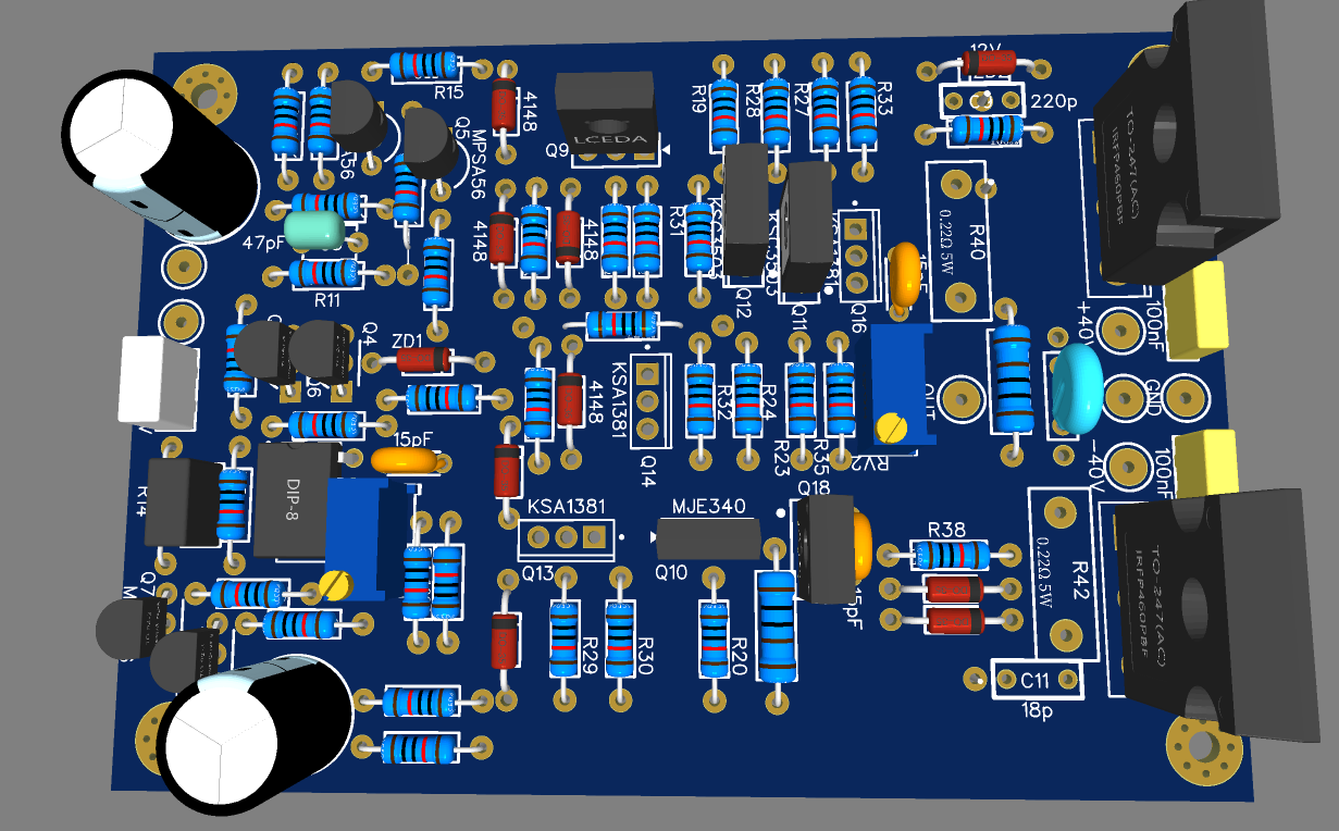

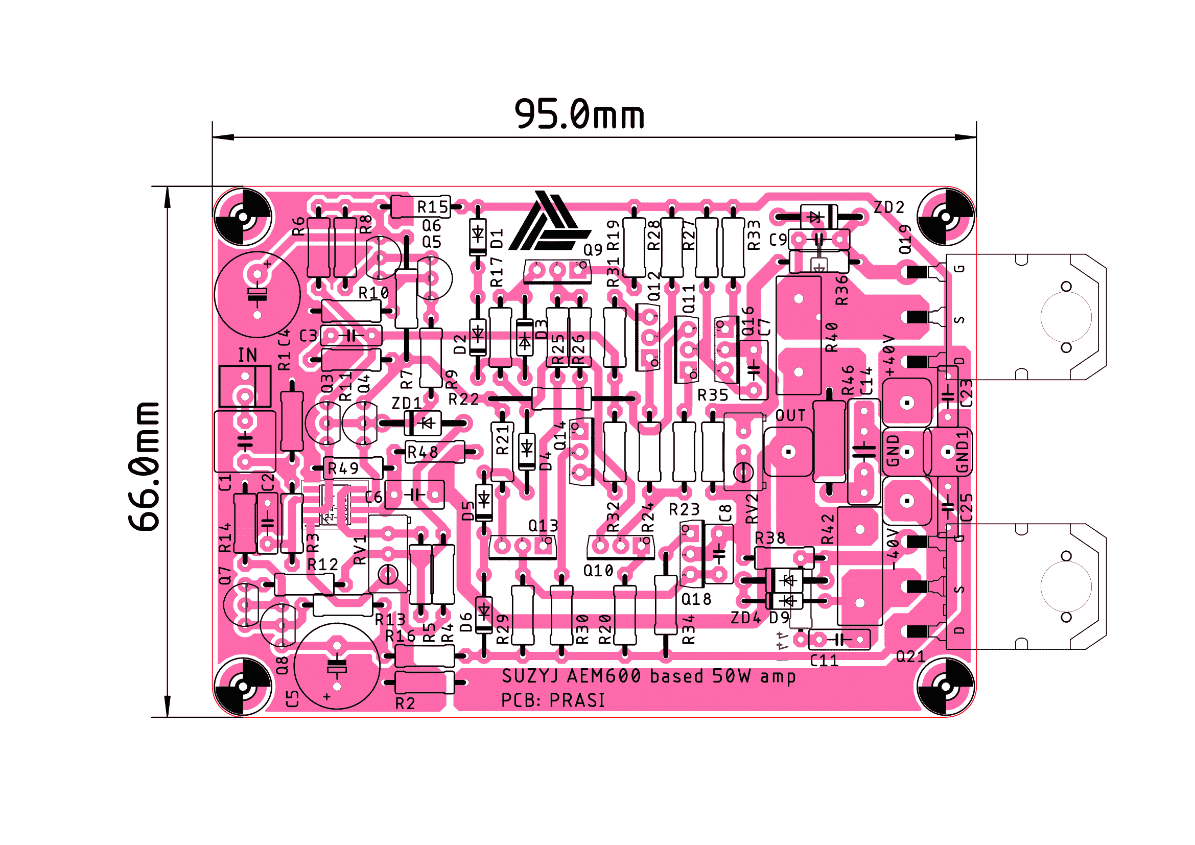

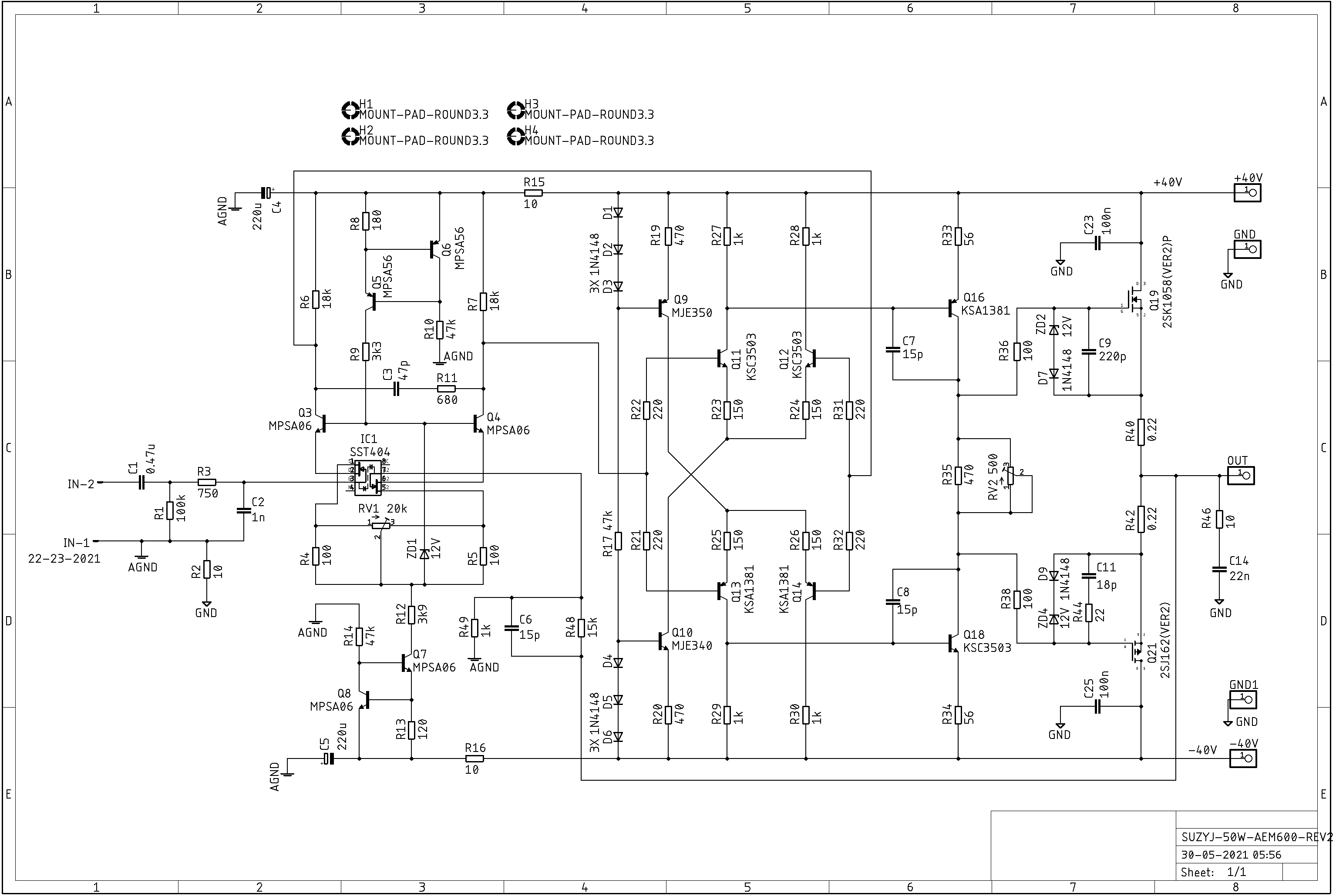

here is a layout for your 50W rev-2 version amp schema. Single sided with THT components, except for the SST404, which goes on the bottom side. To-92's are MPSA06/MPSA56. Any reason not using KSC1845/A992 .
As expected, size is more, 66mm x 95 mm.

yes, saw that, but weren't in stock at mouser, vishay: obsolete, interfet: non-skocked-lead time 13 wks..
Any other that one can substitute?
