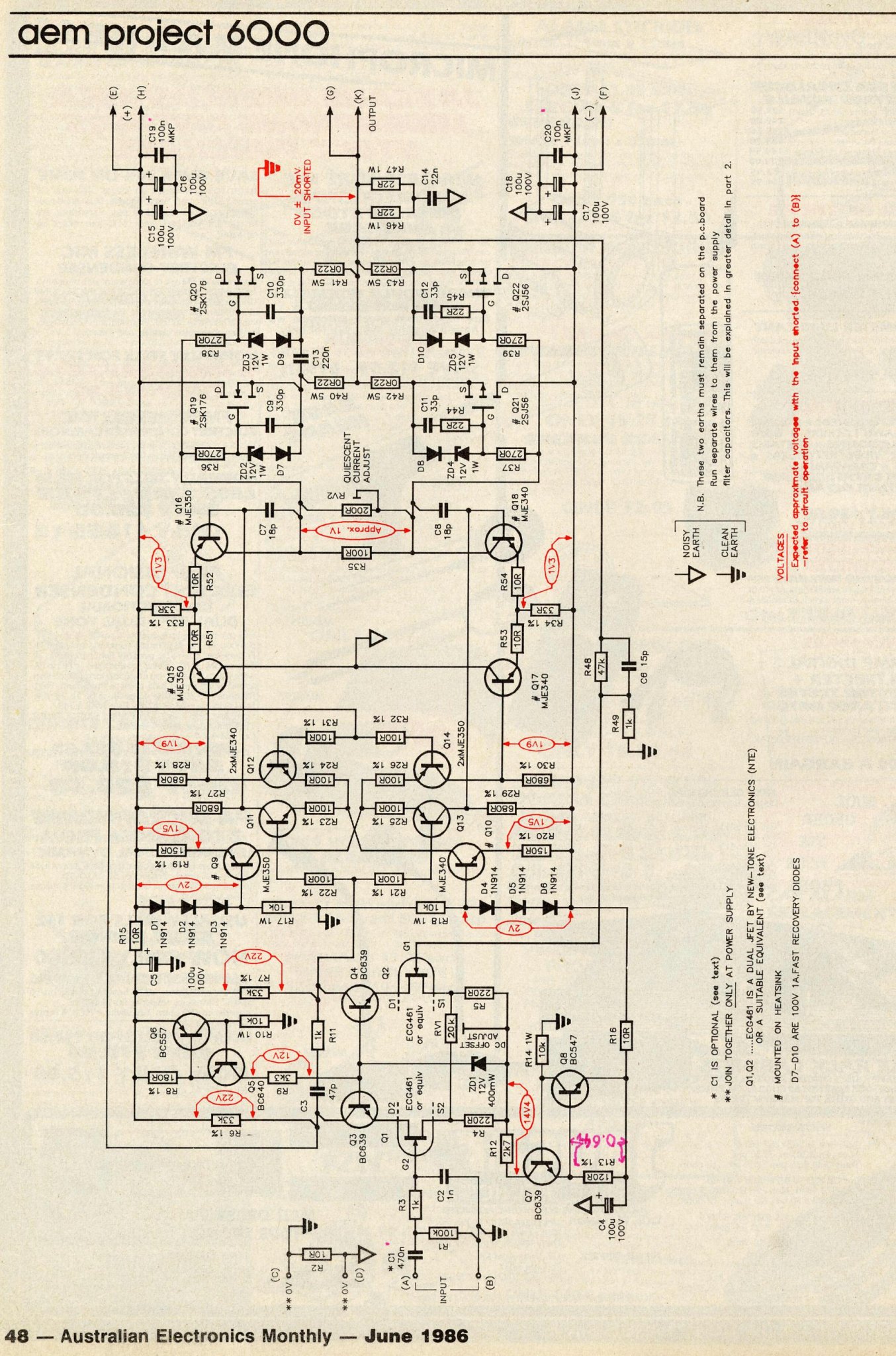

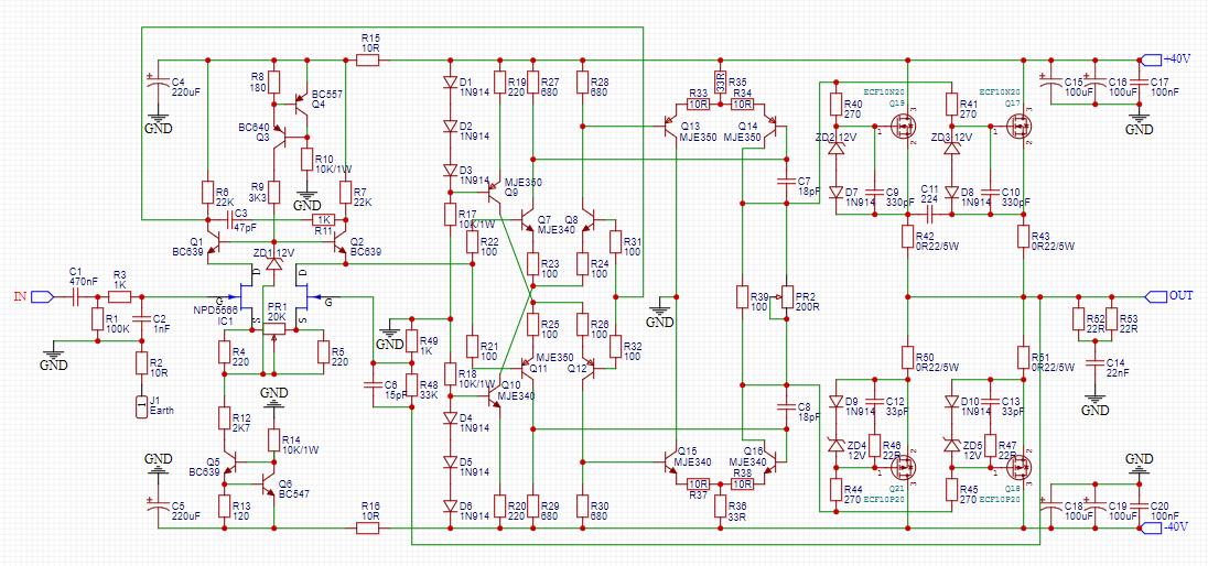

on a side note: this schematic is slightly different compared to the gerber folder. are you sure this is correct one?
Yes, I suspect the take off point for the second diff pair base is taken from the emitter of Q2 the right side rather than the collector.

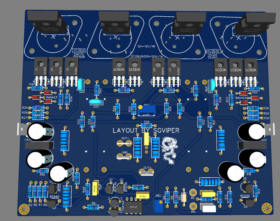

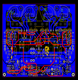

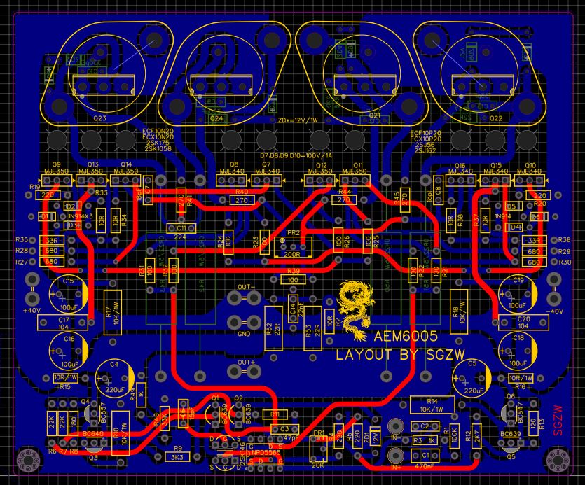

The layout was redesigned to be fully compatible with TO3 and TO247View attachment 1074266View attachment 1074270
Any update on a PCB?
Just according to the original SCH, see the original picture of the PCB drawing, there is no change.
This is the layout that has been modified for many times and has not been verified. If any mistakes are found, please guide me. Thank you
