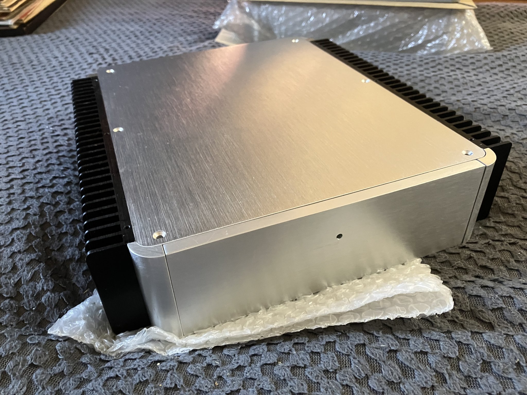

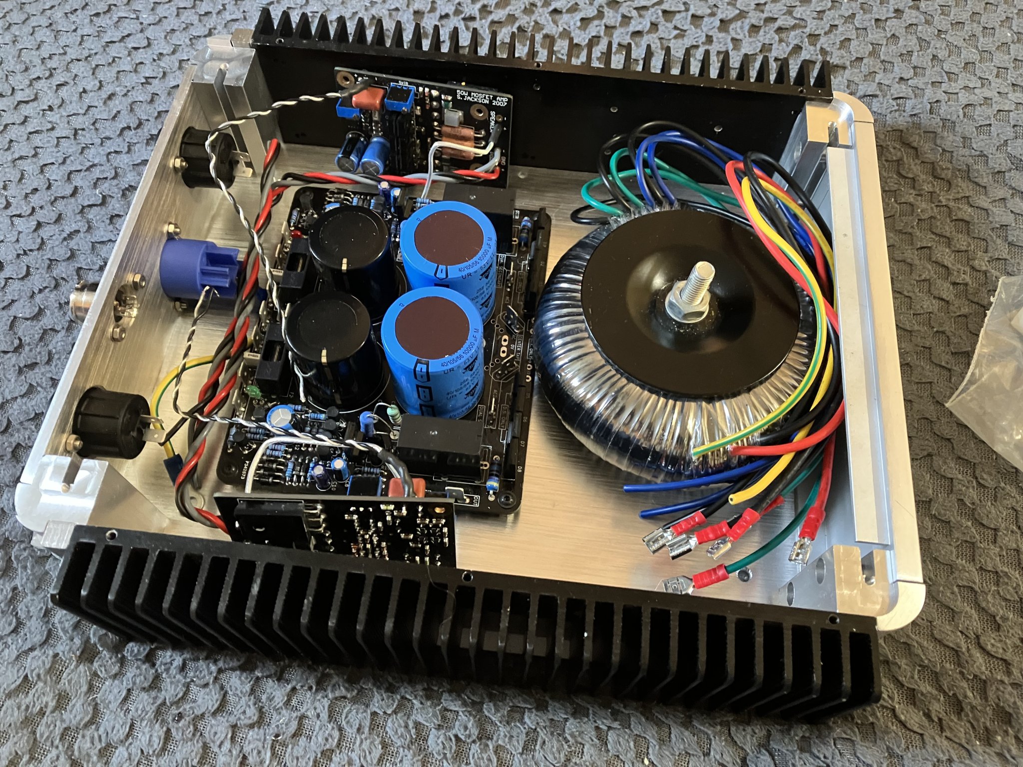

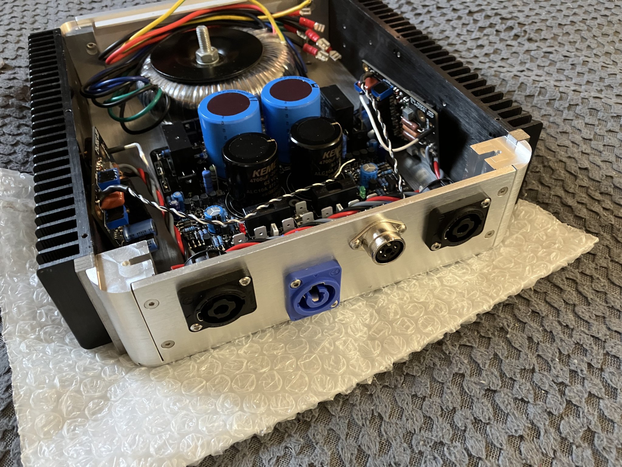

While I'm here then, here is my AEM6000 build using Suzy's first version PCBs. It's a long story getting to this stage, I made some boards up, sold them, then made some more. I love SMD designs, these little amp boards are just great design by Suzy (then she publishes updates...)
Anyway, James transformers took ages to make a 160va O-core then it arrives with the secondary voltages all messed up, they screwed the puppy totally. Now they are on holiday and it might take a while yet.

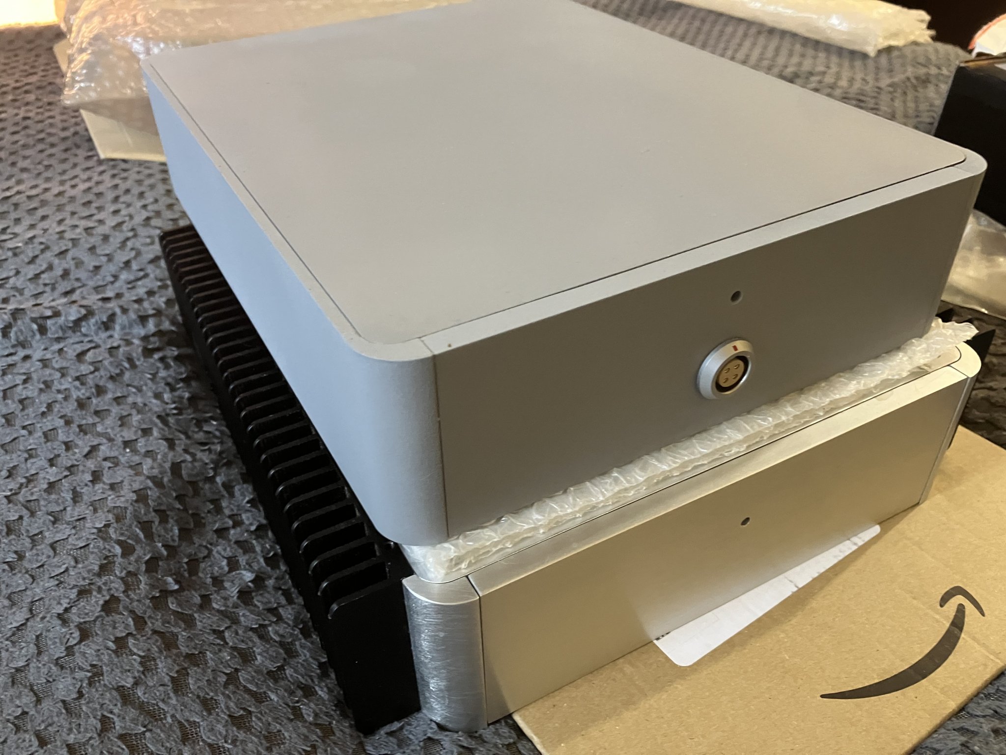

Using Shaan's power supply PCB with protection built in, very tight in there. Neutrik Speakons and DIN connector for input, I'm done with RCA's, they are not designed for audio signals. Ultimately I will spray the case matt textured grey such as my headphone amp pictured.
If anyone is interested, I highly recommend this compact enclosure with these 60mm heatsinks for Suzy's 50W boards.
