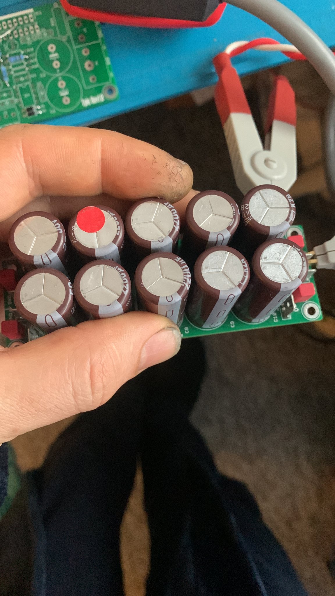

You can look bob cordell lsk389 desing note for preamp, but lsk389 is not good for this amp, because input capacitance little high and it is mean low slew rate… Lsk489 jfe2140 or sst402 could be nice. Jensen 990c or skulptor sk99 discrete opamp could be nice. also my favorite opa1641-42 or opa1655-56 for simple preamp…But if you have dac thats been vout 2vrms, you do t need to preamp. If your sources have vout 250mv like phone stage you need to preamp…. I started to desing new discrete preamp class a (balance and se input direct input or 8x gain, mc mm phone input.)i can share whrn it finish. Definitely i have started to use cap bank on my amplifier. 5x4700-3300 or 2200uf. Cheaper but super fast and good perfermons with Low esr caps.

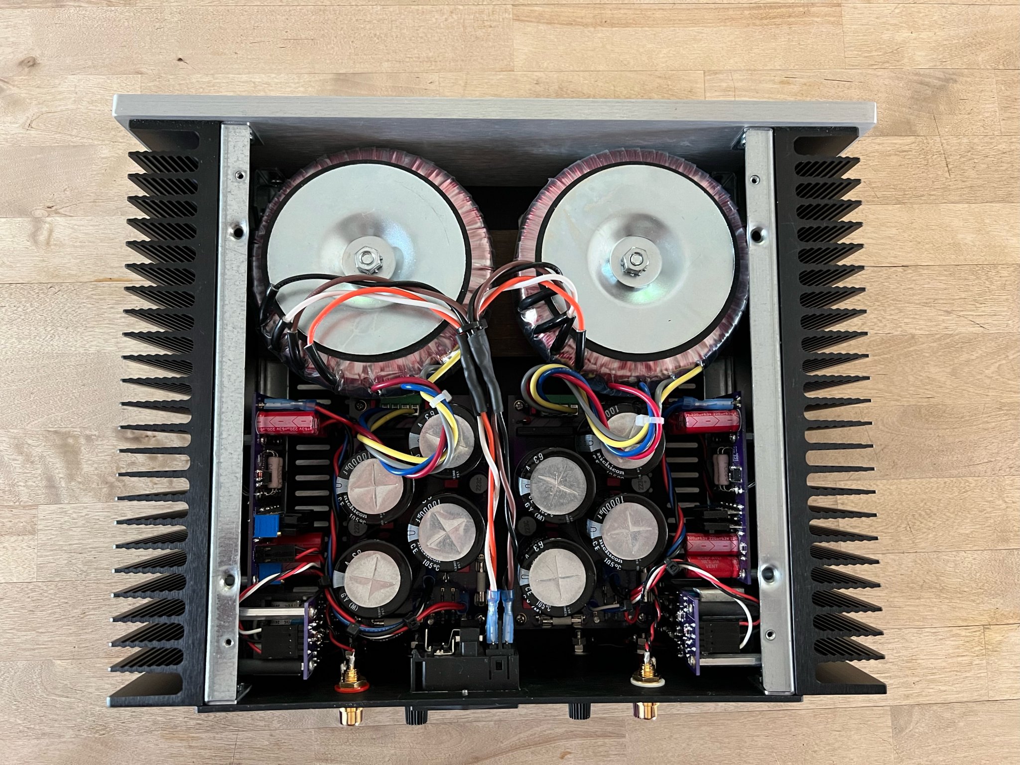

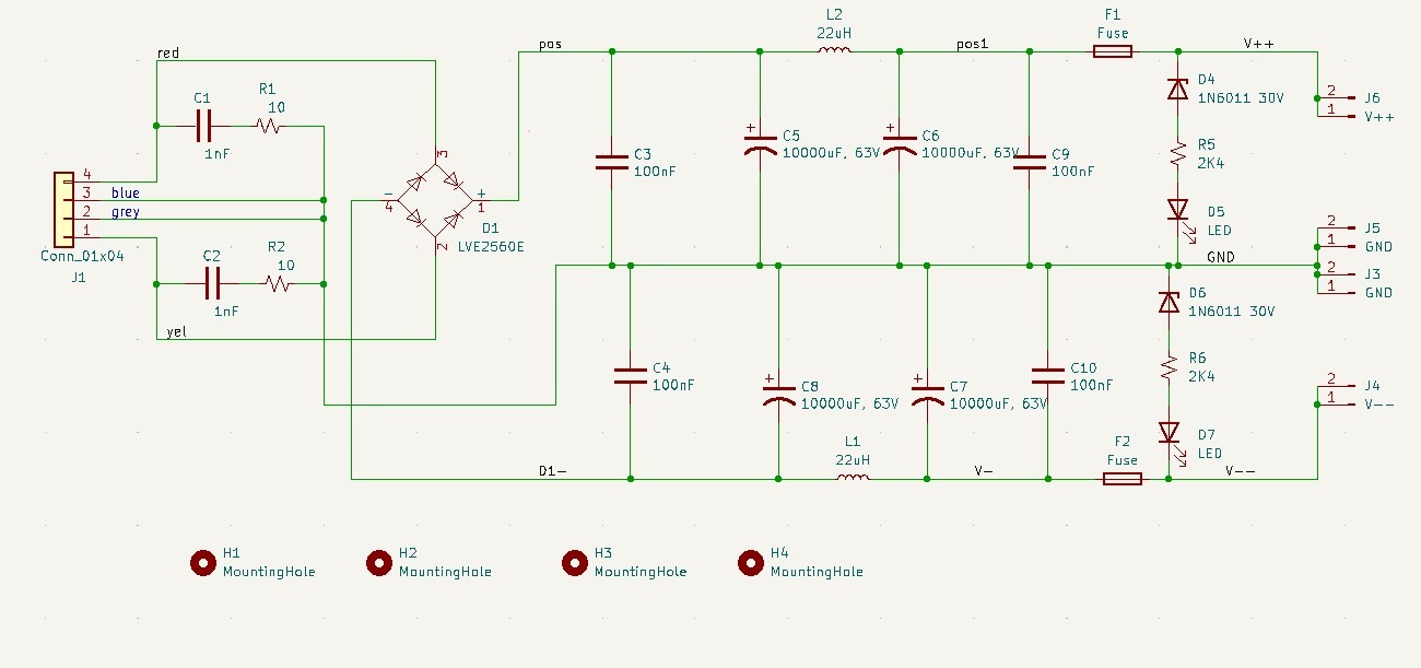

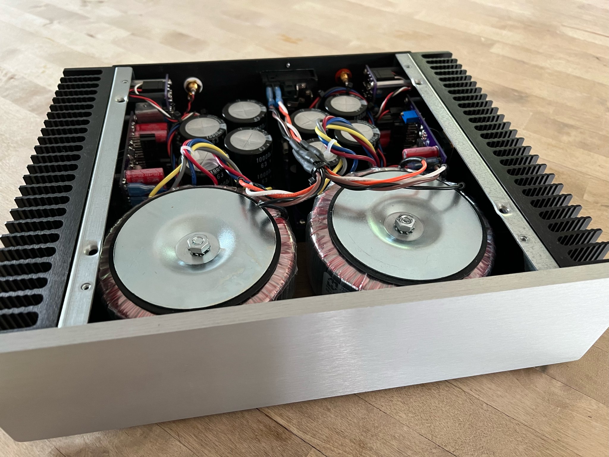

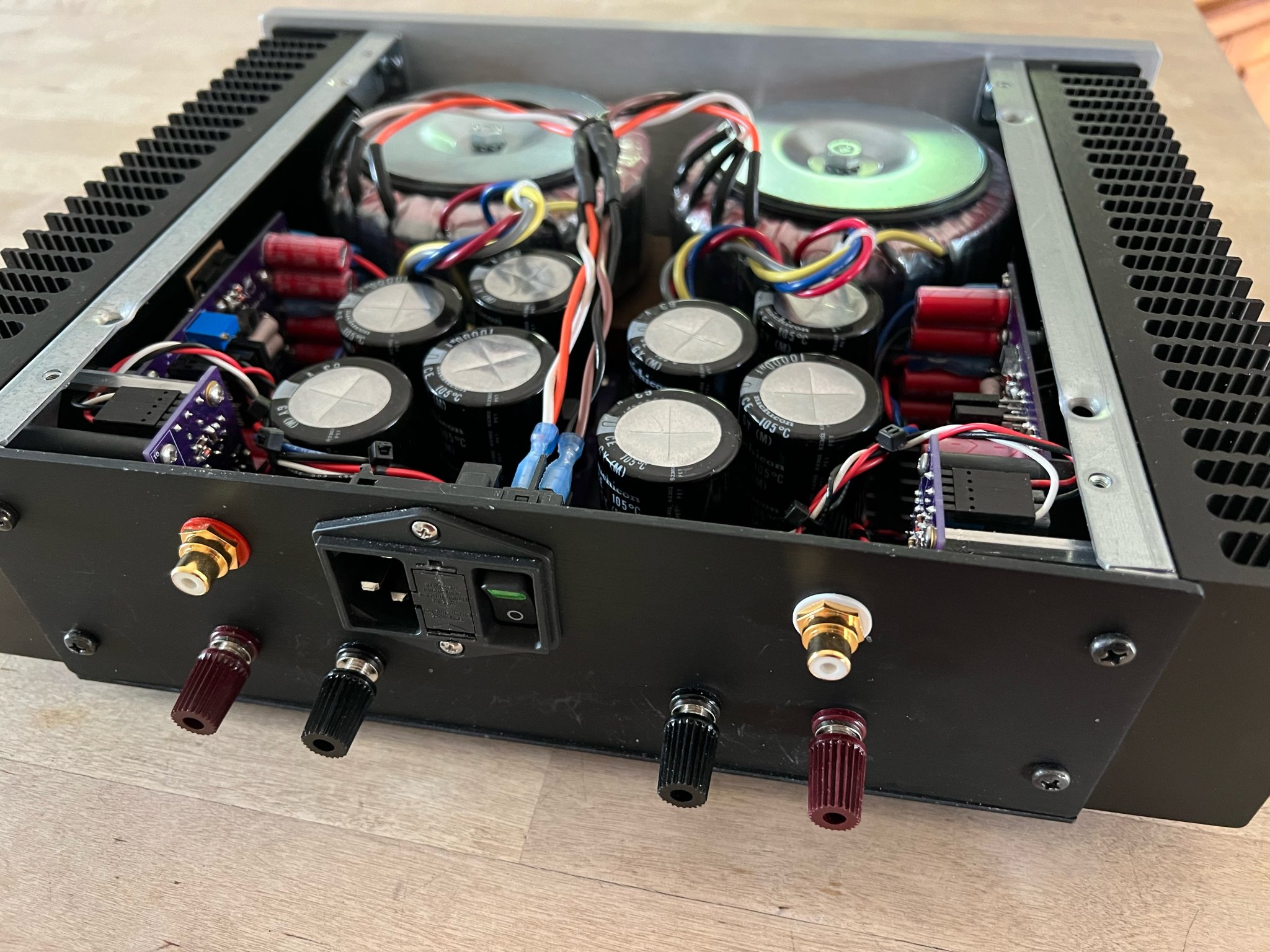

I have just finished a build using a Hammond 1182F30 transformer for each channel. This should result in a bit over 60 watts, rather than 50W. The schematic of the supply circuit I used is attached. Note that the fuses are after the bulk caps. This would match the power amp layout that added caps to the board. If you build with the amp design that does not have bulk caps I think most would argue for placing the fuses ahead of the bulk caps

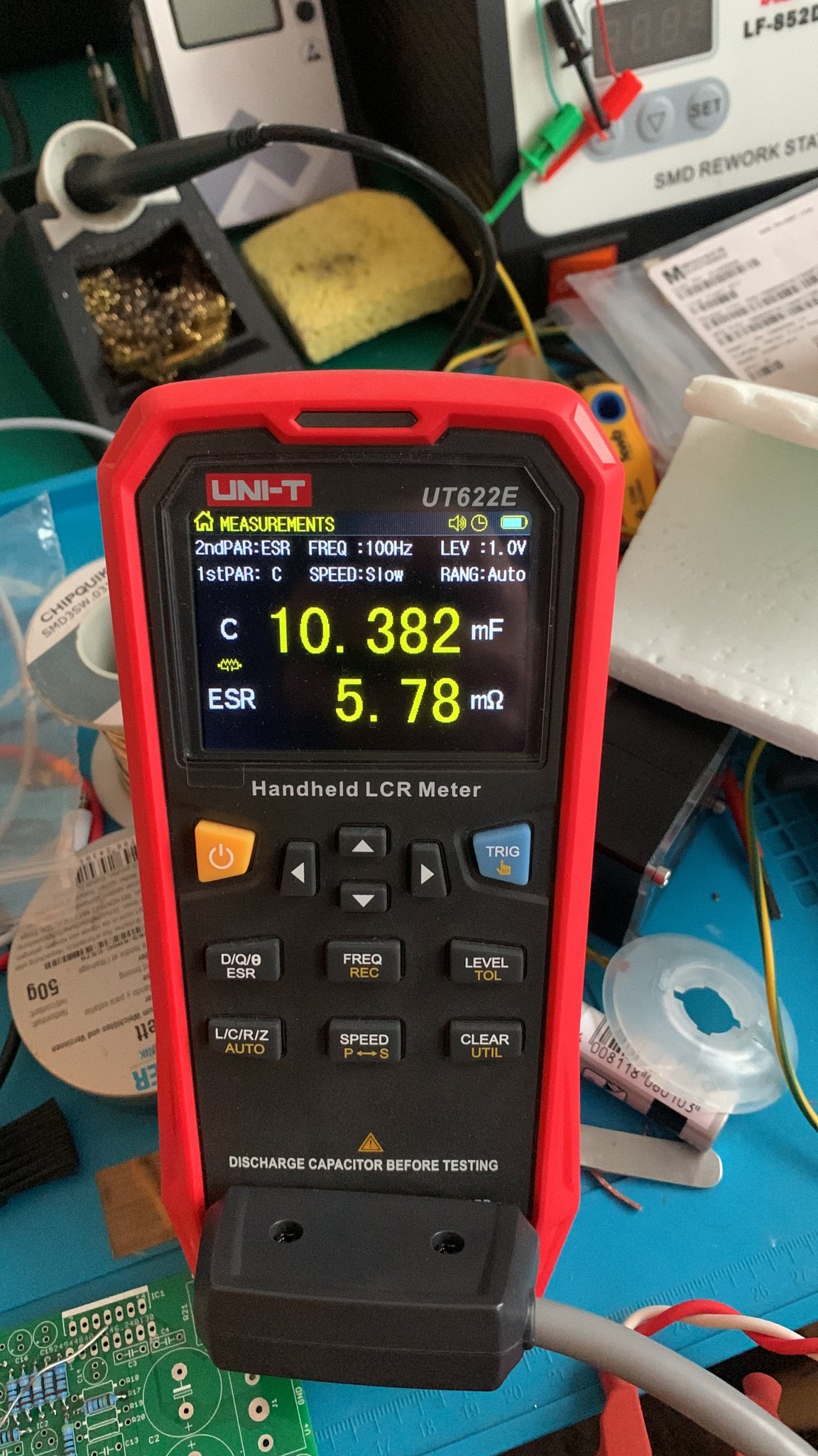

of course no... because aem 6000 isnt a class a.... you need to use low esr cap and hıgh ripple... 10k uf low esr could be expensive. you can try build cap bank... look my cap bank....
i have started listening to the amp, taking the place of a Yamaha B2 in the audio system associated with the flatscreen. Listening to Youtube videos of Joe Bonamassa/Beth Hart, Larkin Poe and Mark Knopfler/Emmylou Harris and the like. It sounds great! The Yamaha needs to go on the bench to have its input switches cleaned, but I am certainly not thinking I need to get that done quickly. Again, the amp sounds great!
In the environment we have it in now, where we sit 8 feet or so from the speakers that flank the tv, I can't say that I really hear a difference. Slide guitars are still crisp and clean, the female singers’ voices are still beautiful, and the base is clear and tight. The speakers are reasonably high quality mini-monitors with Scan Speak dome tweeters and Morel woofers, so they should not be masking anything. The setup was designed to make speech more comprehensible, particularly when we watch English murder mysteries with Scottish actors (no offense intended). We discovered during the pandemic that system was very good for music videos as well.
The amount of power it requires for comfortable listening in this space is probably less than 10watts. Both this amp and the Yamaha are specified to have distortion in the range of 0.00x at this level, so not hearing a difference maybe isn’t surprising?

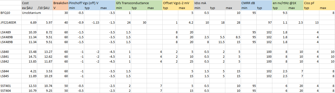

I have compared all the similar dual monolithic JFETS that can be purchased from Digikey and or Mouser.
Yeah, for sure SST404 gets the closest to the Philips BFQ10 that was specified for use in the original AEM6000.
SST401 is binned to have lower offset voltage and is also available from Digikey so that should be a viable alternative as long as the package is the same.
The LS844 is close to an SST404 but lower offset and noise and less than half the cost 🙂
Also, there is a full datasheet for this whereas I have only seen a brief for most of the other Linear Systems dual JFETs.
But of course the package and pinouts have to be different 🙁
In isolation, the JFE2140 looks great as it has the lowest noise and highest transconductance (which tend to go hand in hand), the downside might be the higher capacitance Ciss and lower breakdown voltage.
I might run some sims to see if the much higher Gfs helps reduce THD but I wonder if too much gain could saturate the IPS?
