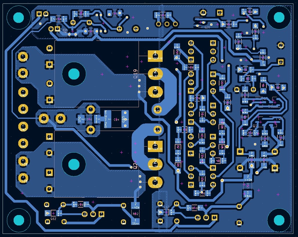

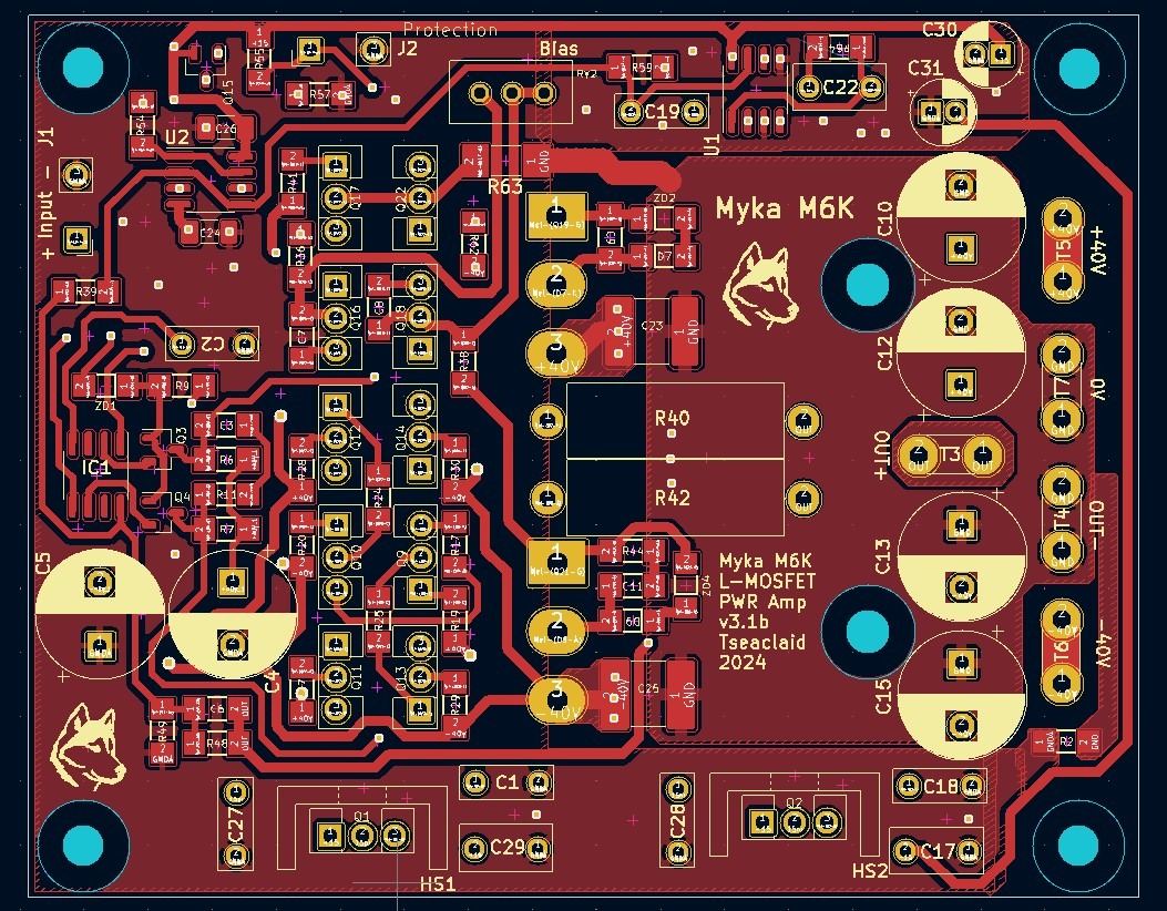

I had already started work on a layout for boards that better utilize the space available in the 2U mini disipante chassis. I was going to add the two op amp servo circuit from Bob Cordell and also a dc detect that will open the output realay if someting goes bad. To make space for these circuits the board will grow to a 70mm width. I will add to the list of changes the parts for the second differential.

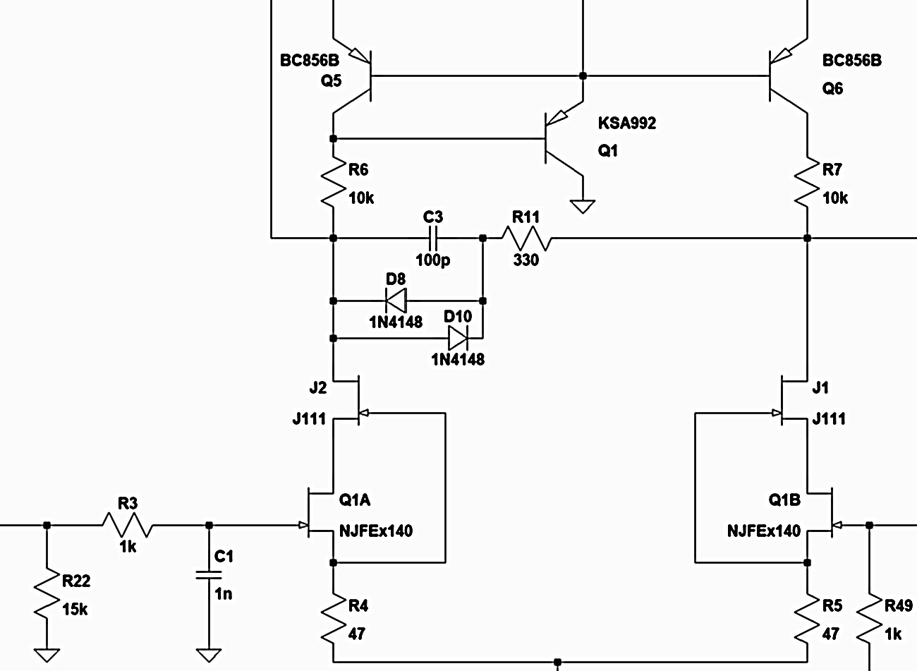

Hi. Don't forget to add two diodes. Then the clip will be better.
Hi Printnik, Thankyou, I did try the clamp previously and I left it out as it increased THD even with a 10k resistor in series but it still did a good job of preventing the rails from sticking during overload.
I also tried 2 diodes in series with 10k but still a very slight increase in THD when not clipping at 10KHz.
But you're right, it does need something to make the overload recovery better so I will look at it some more, maybe a diode connected FET will be better.
I spent all day trying to incorporate some way of improving the clipping behavior and everything I tried 2x 1N4148 diodes, 4x diodes, low leakage diodes, diode connected JFETs, diode connected BJTs, combinations of diodes and JFETs, resistors and they all increased THD when not clipping and this contribution scaled with frequency which is why I originally abandoned the idea as I was trying to get the 10-20k THD figure down.
Then I though about why and realized all of these clamps add capacitance, so adding 2x 1N4148 adds about 8pF to the 100pF compensation cap, when I change this cap to 92pF so that the total capacitance is 100pF again (the value prior to the clamp existing), there is much much less of an impact to THD when the amplifier is not clipping and the clamp actually improves the THD performance slightly around the onset of clipping.
I would use the clamp only if using the current mirror, If you're not using the mirror (AEM6000 and SuzyJ 50W don't use one) then there is no need for clamps as the clipping is already nice and clean.

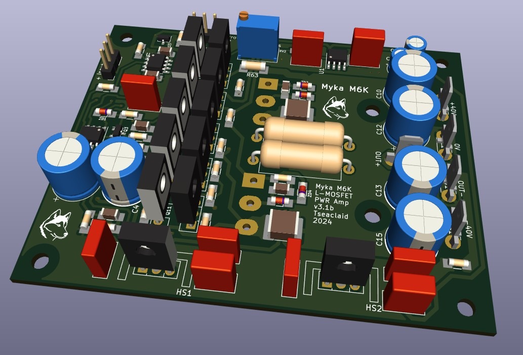

The attached schematic is essentially the original 6000 circuit but with more modern components. The protection circuit monitors the servo output and will trip when it gets close to a rail, indicating too much DC is present. The amp itself simulates very nicely. Perhaps not quite as low a THD value as more significant changes deliver but very respectable (single digit ppm).
  • Myka_M6K.pdf
    Myka_M6K.pdf

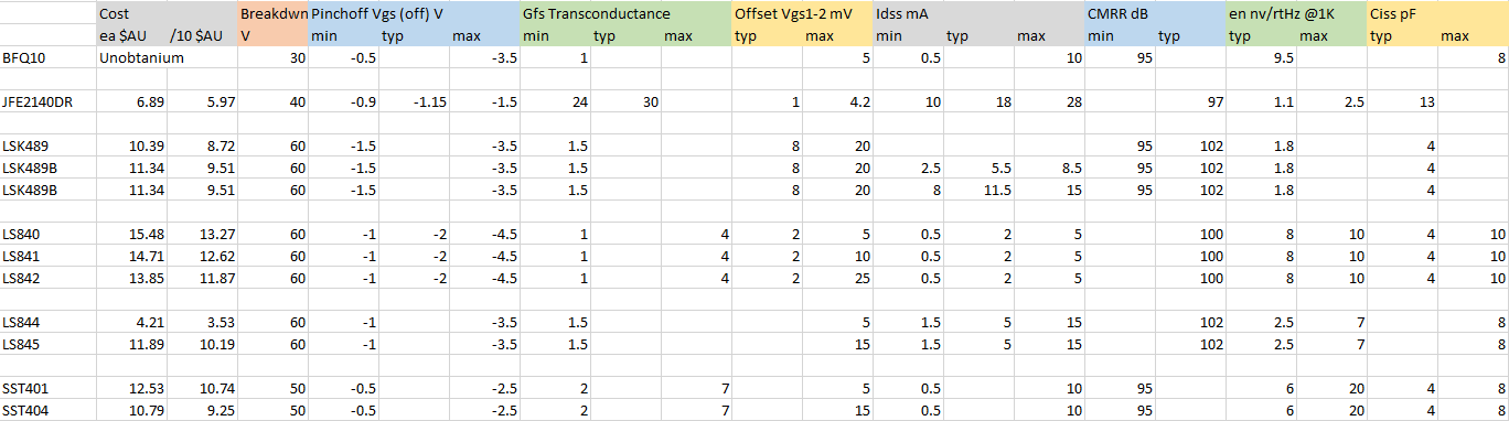

I have compared all the similar dual monolithic JFETS that can be purchased from Digikey and or Mouser.
Yeah, for sure SST404 gets the closest to the Philips BFQ10 that was specified for use in the original AEM6000.
SST401 is binned to have lower offset voltage and is also available from Digikey so that should be a viable alternative as long as the package is the same.
The LS844 is close to an SST404 but lower offset and noise and less than half the cost 🙂
Also, there is a full datasheet for this whereas I have only seen a brief for most of the other Linear Systems dual JFETs.
But of course the package and pinouts have to be different 🙁
In isolation, the JFE2140 looks great as it has the lowest noise and highest transconductance (which tend to go hand in hand), the downside might be the higher capacitance Ciss and lower breakdown voltage.
I might run some sims to see if the much higher Gfs helps reduce THD but I wonder if too much gain could saturate the IPS?
In the original article I believe they mentioned BFQ10 up to BFQ16 as a replacement for the ECG461. I don't know which one would be the better subsitute: BFQ10...BFQ16.
