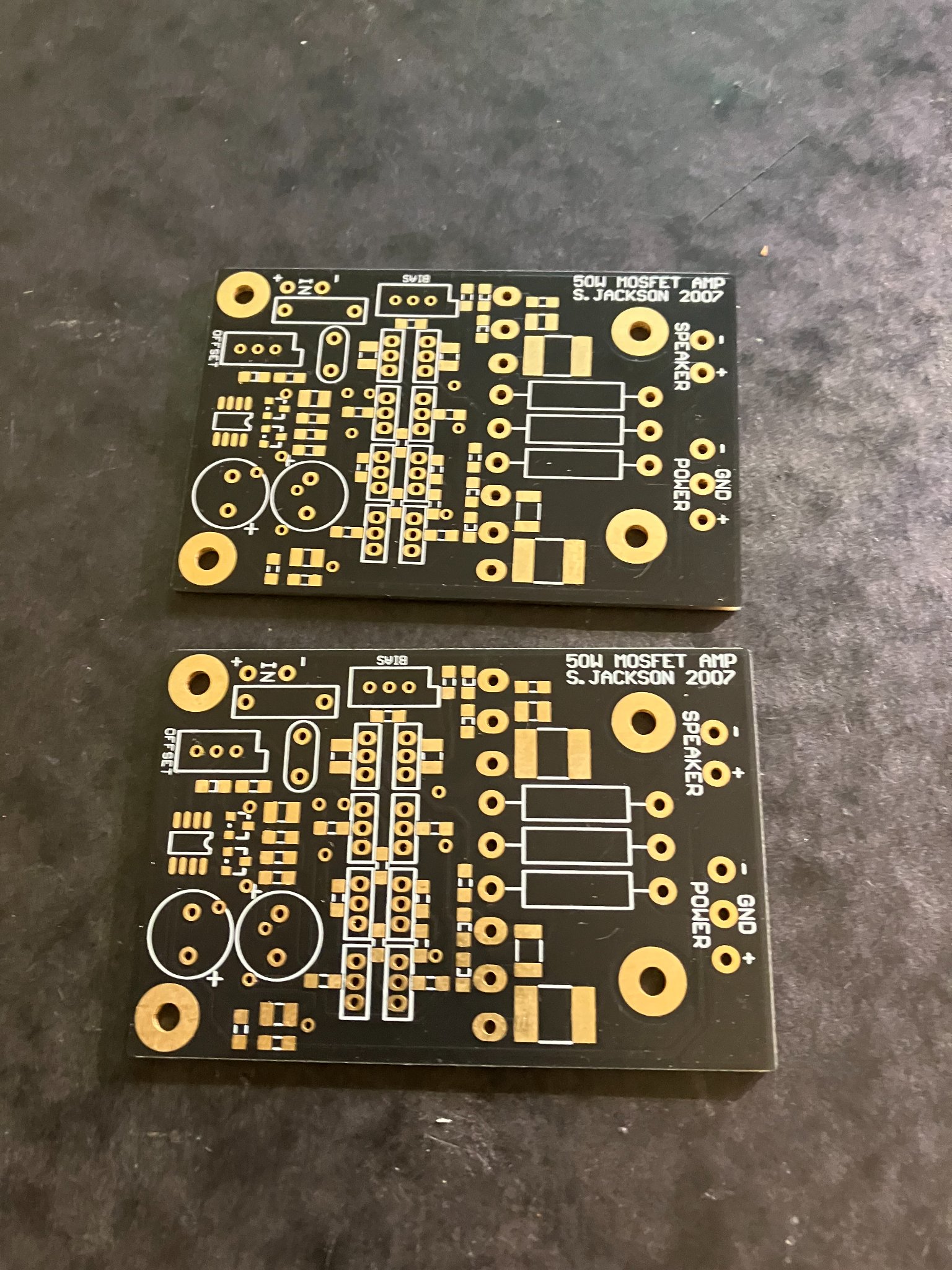

For the VAS, 2SC3648T and 2SA1418T will perform about the same if not better than 3503/1381 but they are NOT TO-126 so the PCB will have to be redesigned.When ordering parts for this latest etch I saw that On-Semi has issued EOL notices for the KSC3503/KSA1381 pair. I am thinking that the TTA004B/TTC004B pair may be the best substitute.

I simulated with MJE15030/31 with 75pf compensation cap.The performance isn't great. The phase margin at 20Khz is around 35 degrees which is below the nominally acceptable 45 degrees, although gain margin is around 40dB. With slightly smaller compensation capacitors it improves to barely 40 degrees of phase margin. Have to simulate with TTA/C 004
Sasmit, Cob is what's hurting your phase margin, the TTA/C will be a lot easier to compensate, Cob of the MJE15030/31 parts is around 10 times that of the TTA/C and 35-40 times that of the A1381/C3503.
You might need to play with the feed forward cap and also try more tail degeneration in the LTP and 2nd diff to get more phase margin.
Sorry to say that but you don't seem to understand what the gain and phase margin are, nor why they are important, so your conclusions about stability are wrong. What happens at 20kHz or 30kHz is of no interest from the stability viewpoint. What is important is the phase at the frequencies where the loop gain is around unity, say -10dB to +10dB - you want at least 30° phase margin there.
I think this is amp is doing exactly that and more . At 1mhz it has a margin of 30 degrees and gain of around 10dB. If you look at the attached output transient simulation plots.
