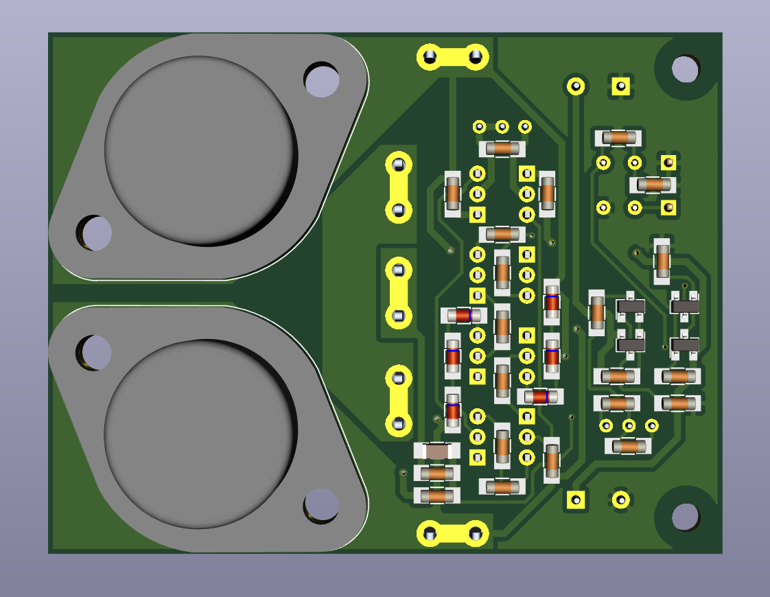

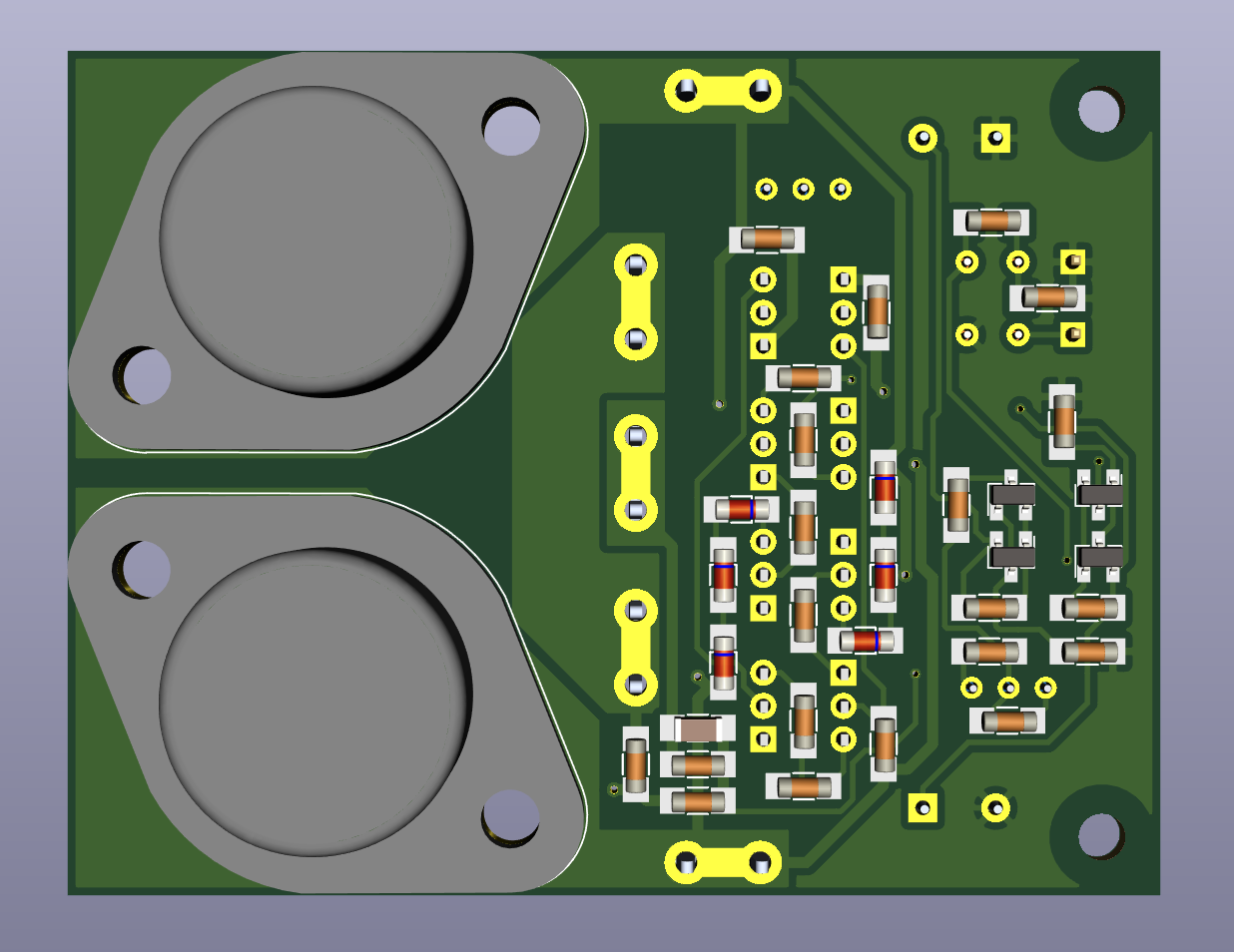

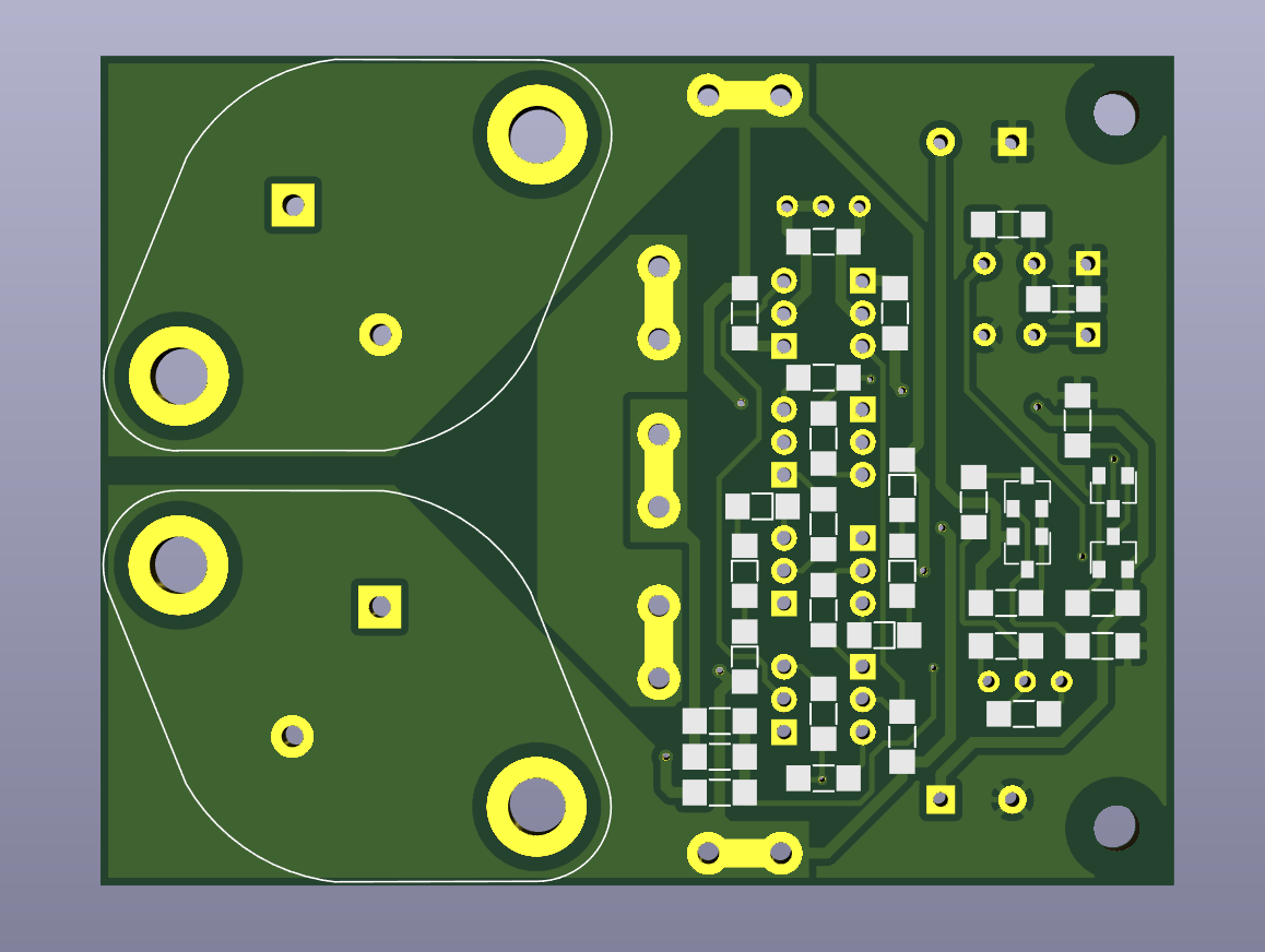

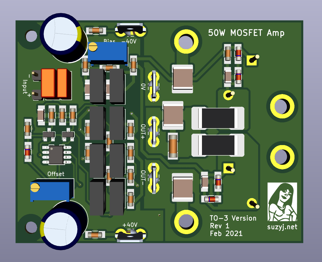

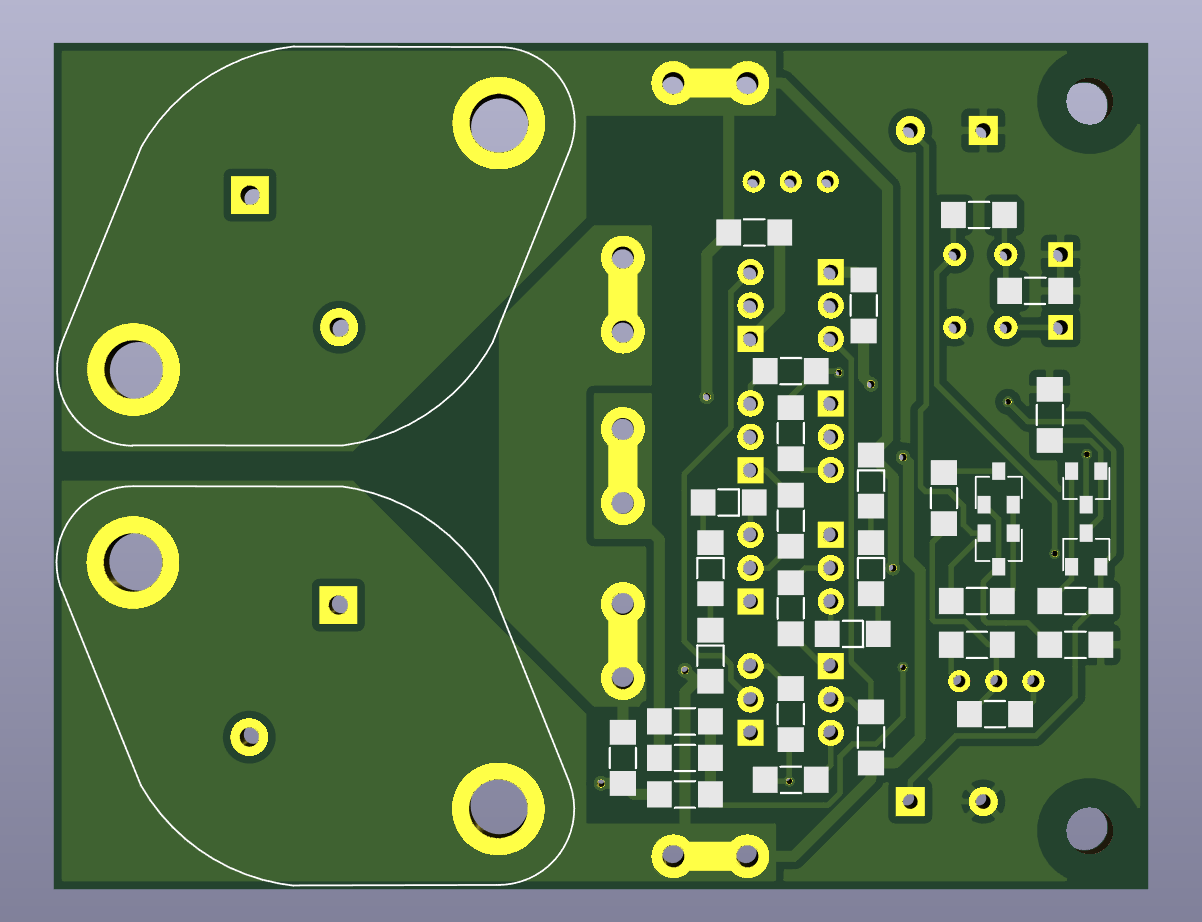

And here's where the TO-3 version is at. I think that's probably a goer. I'll check over it in the morning and then post up Gerbers tomorrow. There's something particularly weird about mixing TO3 with SMD.
Very nice. Again, don't bother if it's too weird or doesn't make sense to do this one! 🙂
Couple of questions:
1) Are the gate resistors back beside the bias pot? Is that close enough to the gate pins? (I've often read for laterals to have them as close as possible, but I'm not an expert. And, it probably is pretty close as this is such a small pcb.
2) I believe the pins on the TO-3 are gate and drain, not gate and source, or am I misinterpreting the diagrams.
Thank you for what you've done so far, and don't feel bad if you don't want to continue on this one.
Steve.

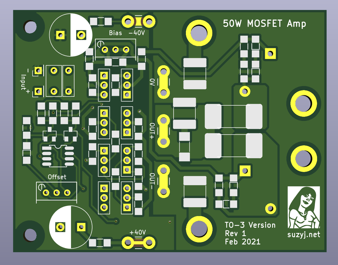

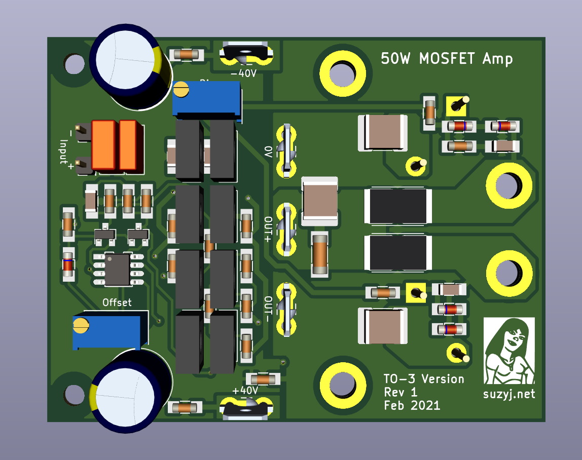

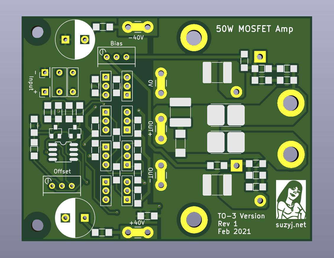

Steve.
Hey Steve, very nice catch - thatnks for picking that up. I'd assumed the pinout of the TO3 was the same as the TO3P (1 gate, 2 drain, 3 source), but it makes sense that the body is source as it's a lateral.
I've also moved the gate resistors, plus added pours for the +40V and -40V terminals on board top, just to ensure no other pours get in between the pins.
This new version of KiCad is _so fast_ to design in, as is no doubt evident by how quickly I've been producing boards in the last few weeks. It's like I have an idea, I draw the idea. The tools help rather than hinder. I'm probably sounding like a broken record here, but I've used many different PCB CAD systems over my career, and this is by far the best one I've ever used. And it's FREE!!!
Also I found a cool resistor that I can use for sources. It's allegedly 7W in a 7.1 x 4.6mm package, and really low inductance to boot. See https://au.mouser.com/datasheet/2/427/wshm2818-1762134.pdf
And here's the Gerbers, as promised.
AEM6000 based 50W Amp TO-3 Gerbers.zip - Google Drive
Again, please bear in mind that it's completely untested, as with the TO-264 version.
Also as with the TO-264 version, it may do slightly more than 50W.

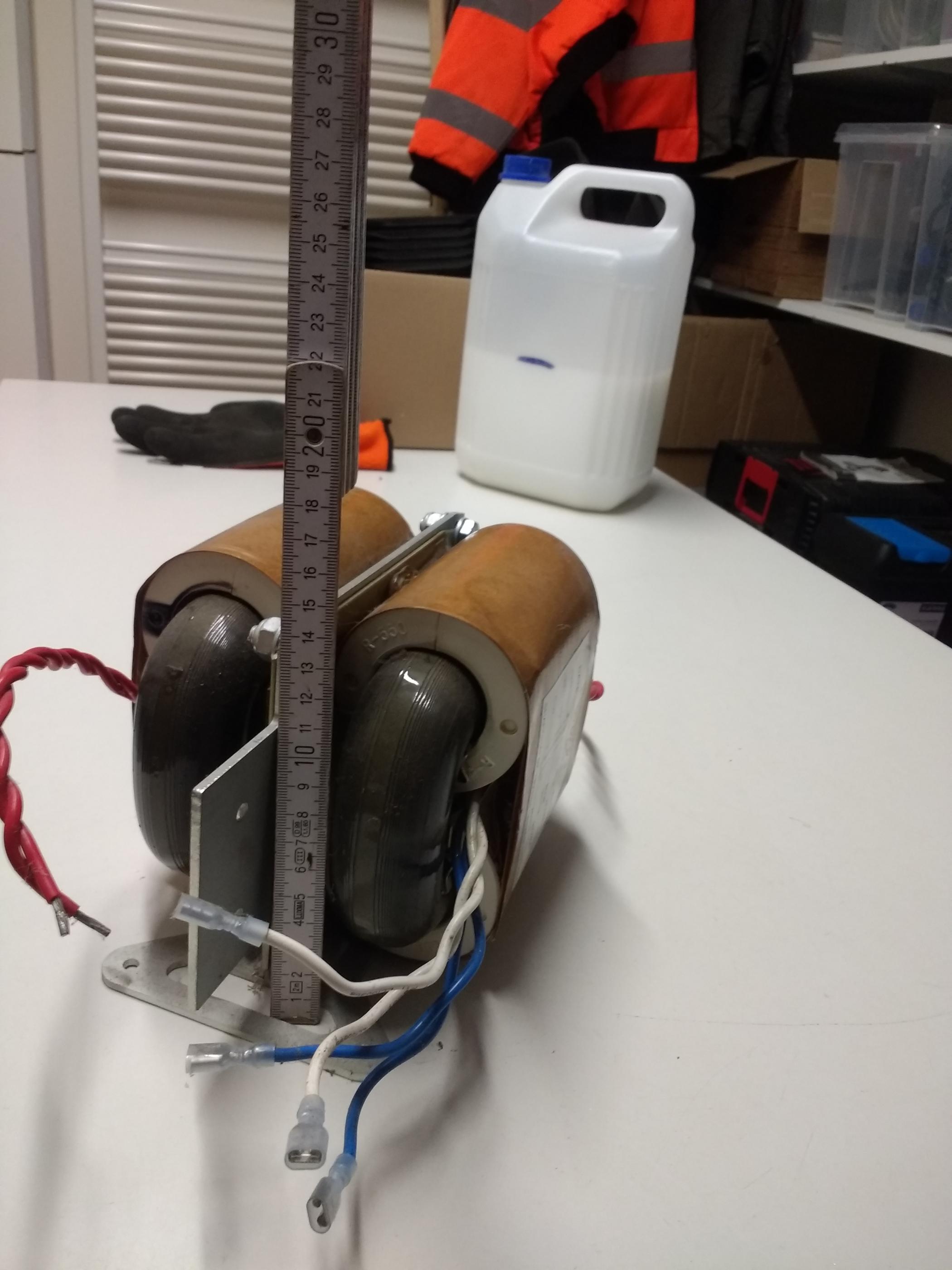

Suzy , according your manual 40Vdc is the most ideal rail voltage . Can I use 50 - 51Vdc without component value change .
Or I can go for 38Vdc , have some Nice R Core (Selectronic )Transformers for that .
It rather depends on your speakers and heatsinking. 50V is a bit much, especially with lower impedance speakers.
I’d go for 38.
I’d go for 38.
Will go for the 38Vdc than , only it's a 400 VA .
More than enough!
