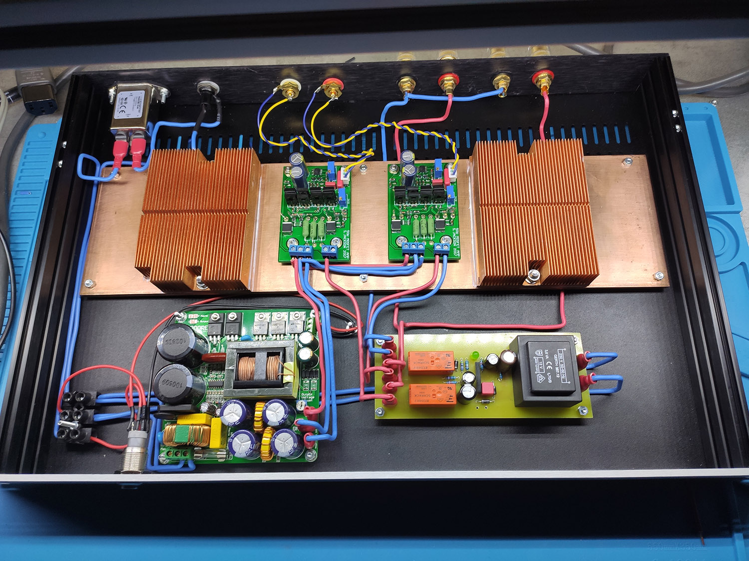

The 50W amps found their home in a slim Hifi2000 1U chassis.
For the heatsink, I went full copper with two Dell server heatsinks bolted onto a big slab of pure copper, a gift from the metallurgy lab.
Total heatsink is about 4kg and does not get hot during normal listening.
The power supply is a 2x36V 300W SMPS boosted to 39V.
Sounds great for such a small vertical footprint, no hum no hiss, just music!
