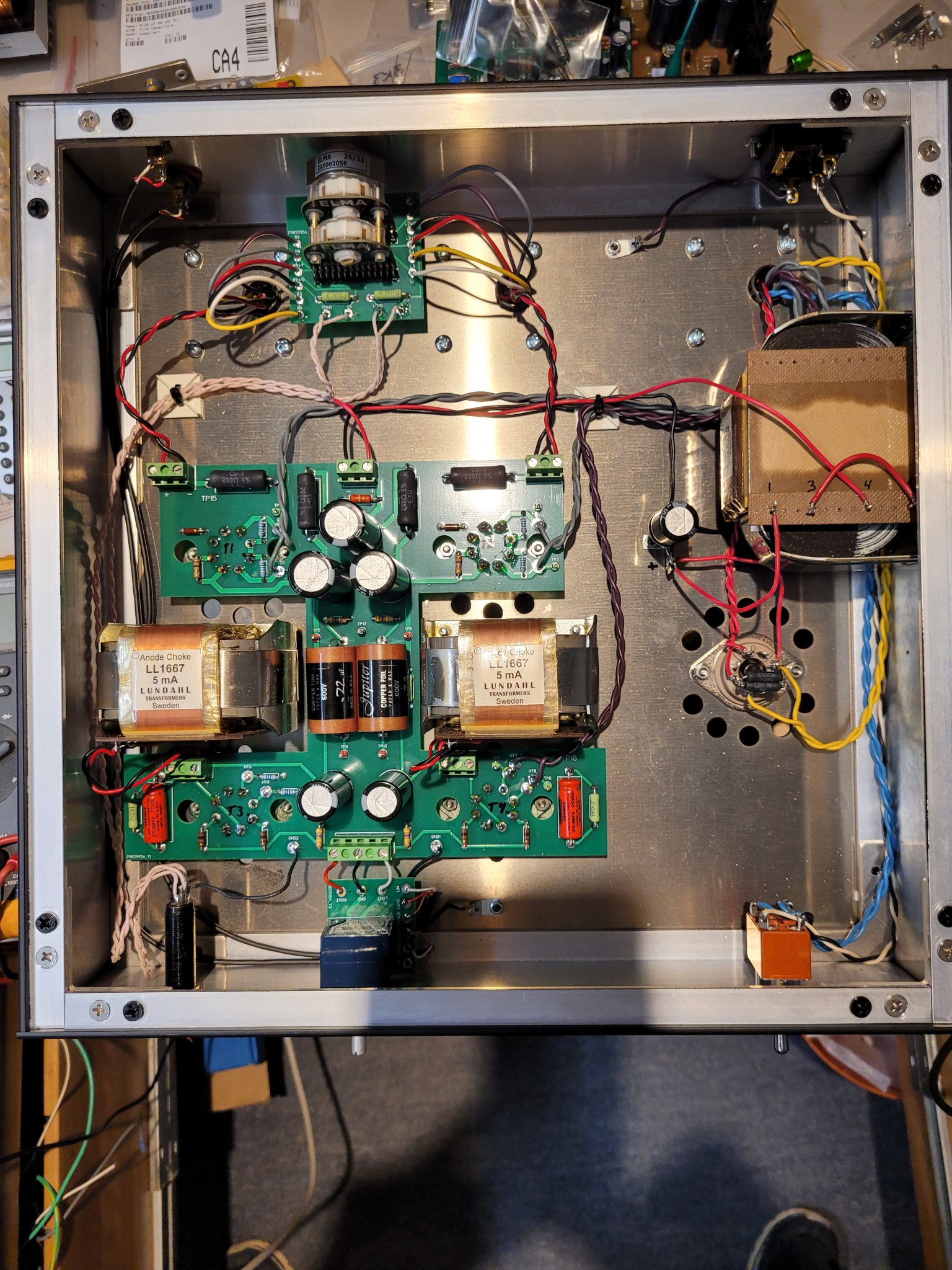

Hello LordGwyn, thank you for sharing your build! I'm quite interested in assembling it and have already purchased most of the necessary components. However, I have a question for you guys regarding the power switch. Would it be possible to substitute it with something like this?
https://www.mouser.com/ProductDetail/TE-Connectivity-PB/AV1921P724Q04?qs=oOQ3ApaRe9CYT2e%2BP0G%2BGg==
I think it has 3 pins. If it's possible, can you guys guide me on how to wire this, and would I need resistors to make the LED work?
For a switch like that, you need to derive a DC power supply for the LED. There is an unused 30VAC center-tapped winding on the LL2758 mains transformer that would probably be the best way to approach that. There are eight pins on the switch... six for the DPDT 250VAC switch, two for the LED. The switch has built in resistors, make a 24VDC power supply from the 30VAC winding and apply to the + pin and ground the - pin.

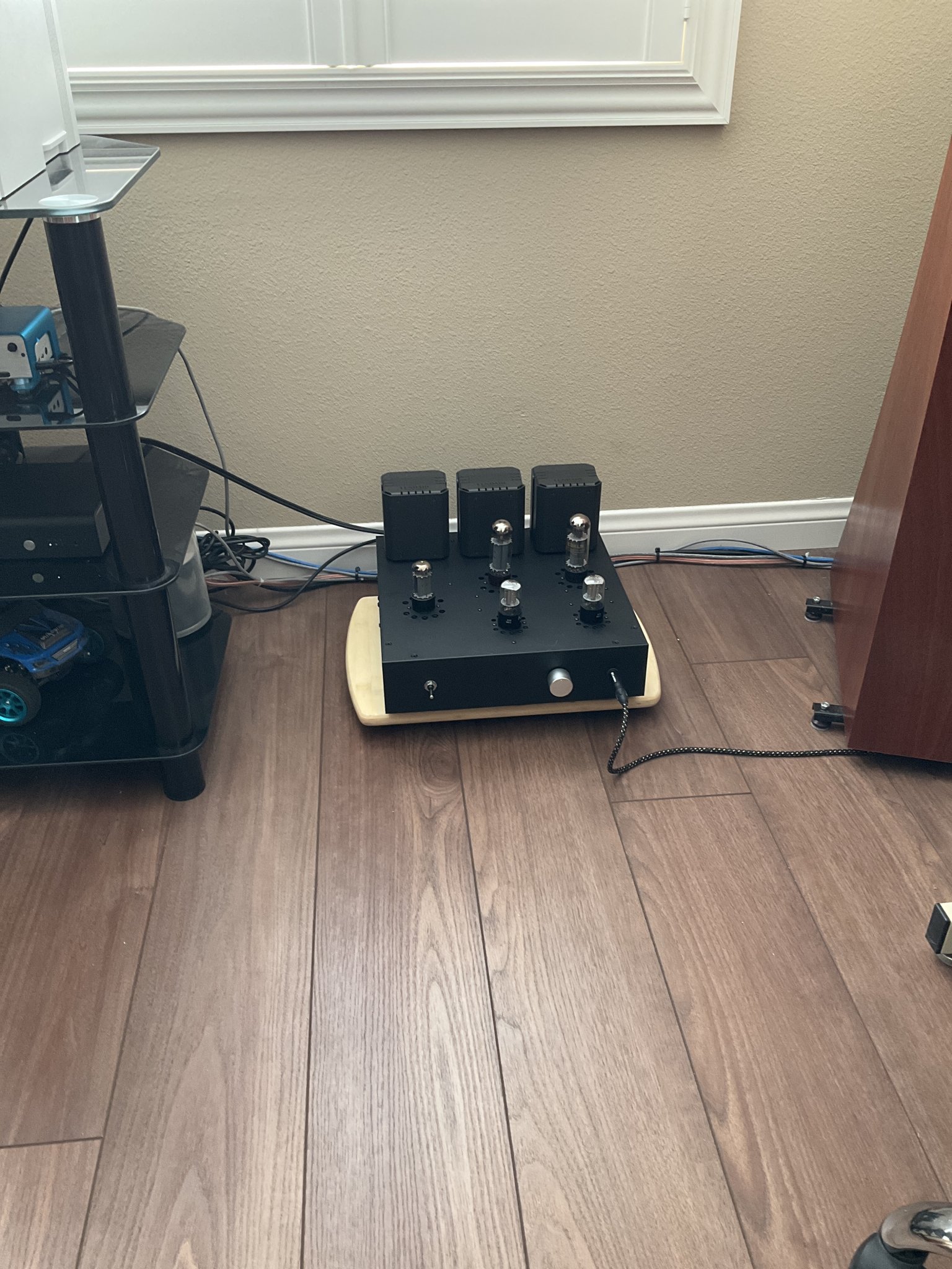

I completed the Aegis project, the kit docs is perfect, no error. The circuit is beautiful, very stable. Btw with the volume at max, there is no noise in the headphone, no hiss, nothing, just perfect, pitch black silence, very impressive.
Here a few measurements, tested into a 33R resistive test load, EL34, 6SL7 and 5AR4 tubes:
Gain (depends on Headphone Impedance swithc on the rear): 13.3dB/16.8dB (Vin 1V, Vout 4.64V/6.89V)
Bandwitdth (Ref 1V, 1Khz) = 54Khz, lower limt is so low that it is difficult to measure with my setup, at least<14Hz
THD, 1Khz, Vin: 100mV= 0.02%, 1Khz, Vin 1V: 0.05%
Me and a friend we compared this amp to all my other DIY headphone amps I made and a few commercial ones as well, and this one is the best in every aspect, period!
It is an expensive project, but it is worth every penny.
This is really an exceptional headphone amp.
Take note that the assembled amp weights a ton! it is really heavy, because of all the superb Lundhall irons aboard.
Thanks for sharing this superb project.
I built it for an audiophile friend, now I have to make one for me I'm afraid...
