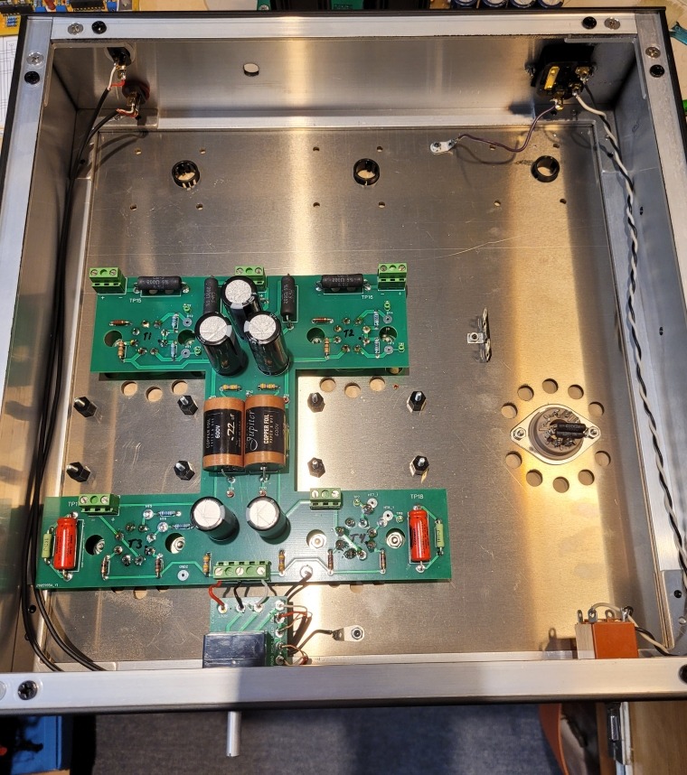

No problem, if you do your own chassis and want to use the PCB, just make sure everything lines up correctly, the tolerances are pretty tight to get the PCB to drop right onto the tube pins like they do in the instructions.
Started the project for a friend. Received most of the parts, except the Lundhall and the ELMA Switch. Started the assembly, superb instructions manual.
