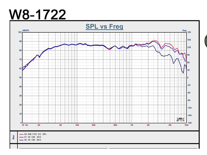

Here is the SPL graph for the Tang Band W8-1722 from the TB home site. There are some web reports that TB data is very optimistic, but it still seems useful to look at the 0, 30, 60 degree curves for this 8" for this discussion. The SPL looks like 87 db from the graph, but I don't know if this is "per watt" or at 2.83V. ...not high efficiency like Lambda target. This is a 4 ohm speaker. There is a diyAudio thread on these new TB underhung speakers and Zaph is starting measurements.

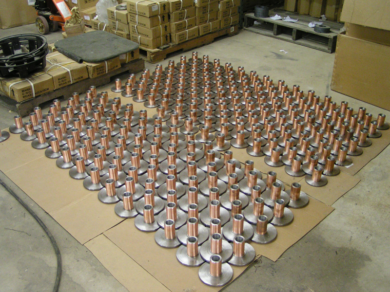

Hello,
I remember Mr. McKinney saying that his motors are having a 100mm central pole piece, with a 12mm gap. I hope I remember thid well. Is this pole piece straight or is it machined, with the termination (the length of the gap) being smaller in diameter than at the base? I ask because I don't understand how can you cover with copper a pole piece machined like that.
Mr. McKinney told that the copper layer is pretty significant so I guess it's not a chemical layer.
I hope I'm not asking for trade secrets here 🙂
The lambda drivers use a 2" diameter coil. Since we are pulling the heat away with the copper, and in the apollo options the alum as well, the 2" VC can handle high amounts of power. The smaller coils also keep the inductance low. In the pic that Sheldon posted, you can see the non-TD T-yokes. These are the standard vented poles that go on the SBP drivers, PB drivers, and on our upcoming SL series drivers. They have a thick copper sleeve that is drawn out for us by a company in lower michigan. We turn every T-yoke down by hand to within .003", then by hand put on the copper with a special adhesive. We clean up the edges, polish the copper and they are ready to get sent off for plating.
We have looked into doing a coaxial version in the future. The issue currently is that we need to go larger on the VC diameter to do so. For a 1" throat driver we'd need to go with a 3" diameter VC to keep enough steel in the pole and be able to get the proper flare rate to mate up to the cone. I have some prototypes started, but need to get a small CNC lathe here in the future for experimenting on things like this.

SunRa said:Thanks for the link.
By the way, how's the TD motor different?
TD motor has a solid pole with a phase plug on the end, other style is a vented pole. Dipole is a TD pole piece with a single magnet and 38mm top plate. Everything else is the same.

SunRa said:Did you had the chance to try permadur in your motor?
Very very very few people are willing to pay that high cost. However if someone wants to pay for it up front we will make them some.

I looked into the Hiperco50(permendur) for the poles. It is VERY expensive. For 2" diameter bar stock it is around $230 per INCH! That means for the typical pole in the TD drivers we are at about $920 in raw material alone! It is also extremely difficult to machine and work with as it shatters and cracks easily.
For all practical purposes, the copper sleeve works well. Another option is to use powdered iron as it is magnetically permeable(although about 20% less than 1010steel) and non conductive electrically. Since we have more BL than needed in the higher diameter coil drivers, this can be a possible option as we get to those. The drawback is that you don't get the heatsinking ability with the powdered iron that you do with the copper sleeve.

Tang Band W8-1722
Hi linesource,
I can`t seem to find the data for Tang Band W8-1722, could you send me the link, please? Do you know who is selling them?
thanks
Hi linesource,
thanks
Re: Tang Band W8-1722
http://tang-band.com/index.php?page...emart&Itemid=3&vmcchk=1&Itemid=3&lang=english
This site lists a 2 month delay until the W8-1722 ships. Listed at 89 Euros. zaphaudio.com is testing the 6.5" W6-1721 which Parts Express sells in the US
