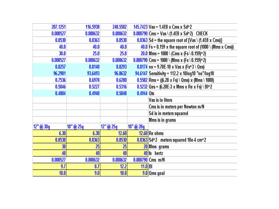

I posted T/S parameters in this thread which would make the new Lambda 10" midbass 95db efficient and very well suited for a dipole midrange which could cover the 80-1,500 Hz human voice range. A Qts ~ 0.5 was selected with a Mms of ~25 grams. The new Seas Exotic 8" with underhung motor has a Qts of 0.44 and 10 grams Mms, so great minds do think alike. Full Range speakers have a strong following, which I believe it due to crossover free vocals, and I think this "single driver voice" philosophy is the best challenge for new speaker technology.
WinISD Graph shows some comparison data between current TD10M and the proposed T/S parameters for 10" Midbass. Hope this helps generate some discussion and possible agreement.
Green = TD10M ported
Yellow = TD10M sealed
Red-ish = 10" Midbass ported
Orange = 10" Midbass sealed

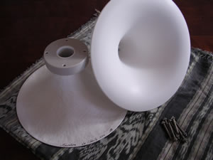

Australian Azurahorn AH-550 which with 300mm is his smallest, and supposed to be easy to send cheap by airmail
But he hasnt responded to my mail, so I dont know how it goes
