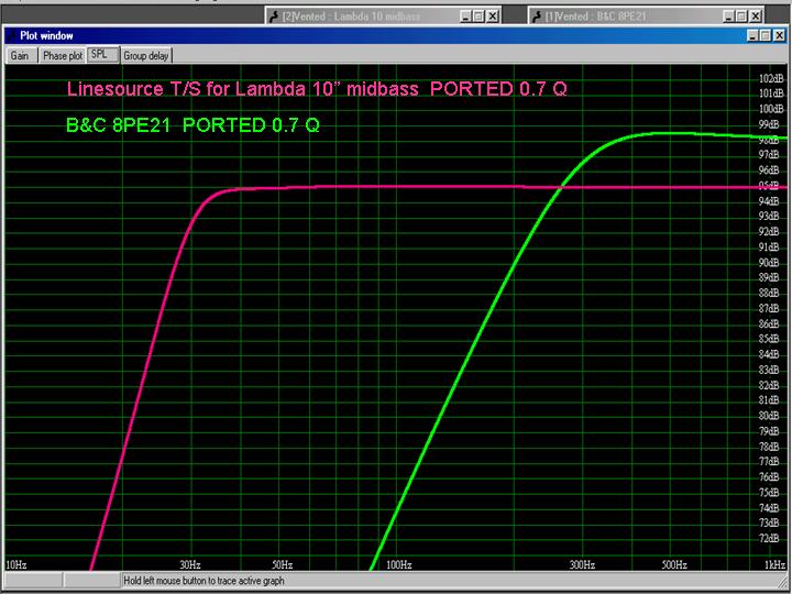

LineSource said:
Graph shows 0.7 Q ported box for the T/S prameters I've prosted here for a Lambda 10" midbass, and the B&C 8PE21. The B&C is spec'ed at 1mm Xmax and Qtx 0.21 which seems best suited for a horn. The Lambda goal is 8mm Xmax, and a Qtc ~ 0.5, which is also a good match for a dipole design.
You must have been fiddling a lot with that sim as I get F3 around 85hz with TD10M in BR
John_E_Janowitz said:
Yeah, the TD10M won't be the eventual version though.
John
