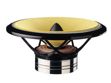

Picture of B&W 6.5" underhung motor midrange. You can find these for $140-$160 on eBay. The cone is woven Kevlar that goes all the way to the surround edge. My textbooks claim that woven kevlar can mix both high strength weave patterns with high dampening weave patterns to create exceptional speaker cones. B&W website has laser interferometer pictures of the kevlar cone break-up. There are a couple AES papers using laser interferometer cone measurements which cover minimal optimal cone mass vs. break-up modes vs. distortion.
The three chrome rings in the motor are:
1) thick steel top pole piece
2) thin NdFeB center magnet
3) thick steel bottom pole piece

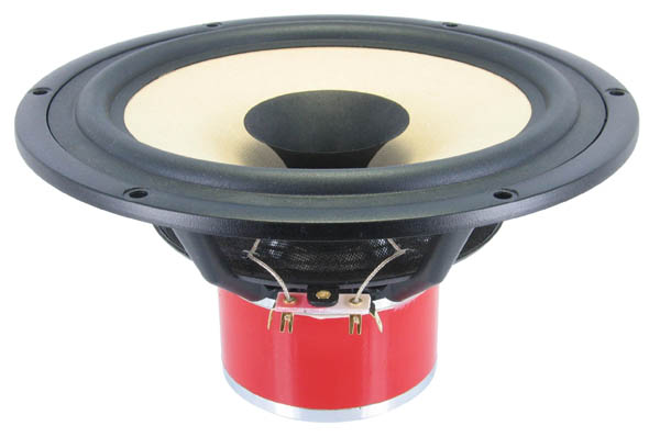

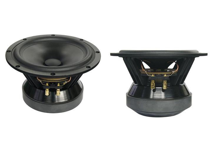

tinitus said:Hi Linesource, why do post the same text twice with 2 clearly different drivers
Hi tinitus,
The two pictures are supposenly of the same Tang Band W8-1722, 8" midbass. One is from a European sales site, and the second from the TB home page. I think the second photo with 8 mounting holes is the real W8-1722 and the first photo with 4 mounting holes is really the 6.5" W6-1721 - mislabeled. Thanks for point this out.
I posted the Tang Band as an example of a Ceramic underhung motor for discussion.
I posted the B&W as an example of a NdFeB underhung motor and woven Kevlar cone for discussion.
The Lambda underhung motor should be pretty good, even with a 0.85" thick Ceramic magnet. The B&W motor shows some value in using a thin slice of NdFeB. I'm hoping a clever cone profile with Mms < 25 grams will get tested as one Lambda midbass option by Nick and John.
