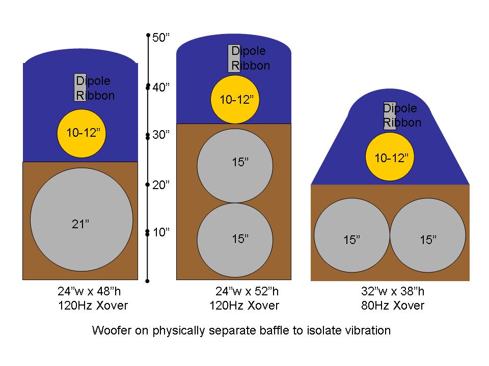

Three possible 3-way open baffle sizes for modeling.
The bass baffle should be physically separated from the mid-tweet to remove vibrations. Assuming the midrange is clean up to 1,500 Hz, the tweeter can be a dipole ribbon, or monopole waveguide/horn and compresson driver, or high efficiency dome tweeter with or without small horn/waveguide.
A wider baffle, like 32", seems desirable for 80Hz bass-mid Xover since 80Hz is close to the baffle dipole frequency, and this might simplify the Xover circuit.

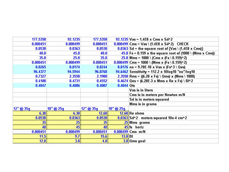

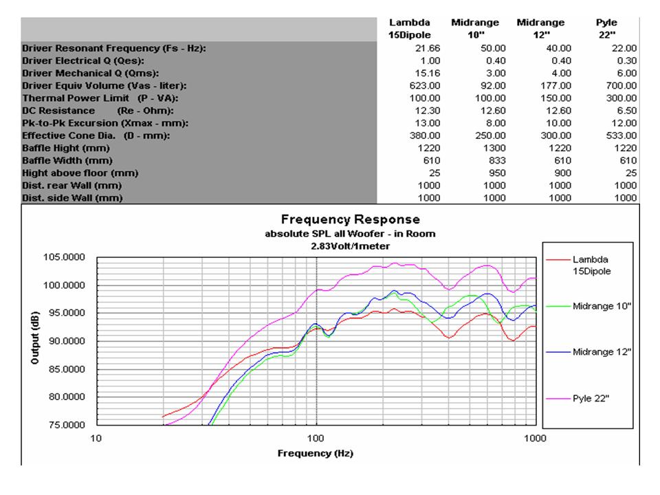

Some guesses for T/S parameters for a 10" and 12" midrange assuming 0.85" thick Ceramic_5 magnet on the Lambda underhung motor. It looks attractive to search for a "magical" 12" curvelinear cone profile which has unusually good 30 and 45 degree off-axis response. A 10" seems the more successful option for a 1,500 Hz Xover target with low beaming.
30 AWG Copper clad aluminum wire seems capable of ~ 6 gram voice coil which is necessary for the low Mms used in this guess.
