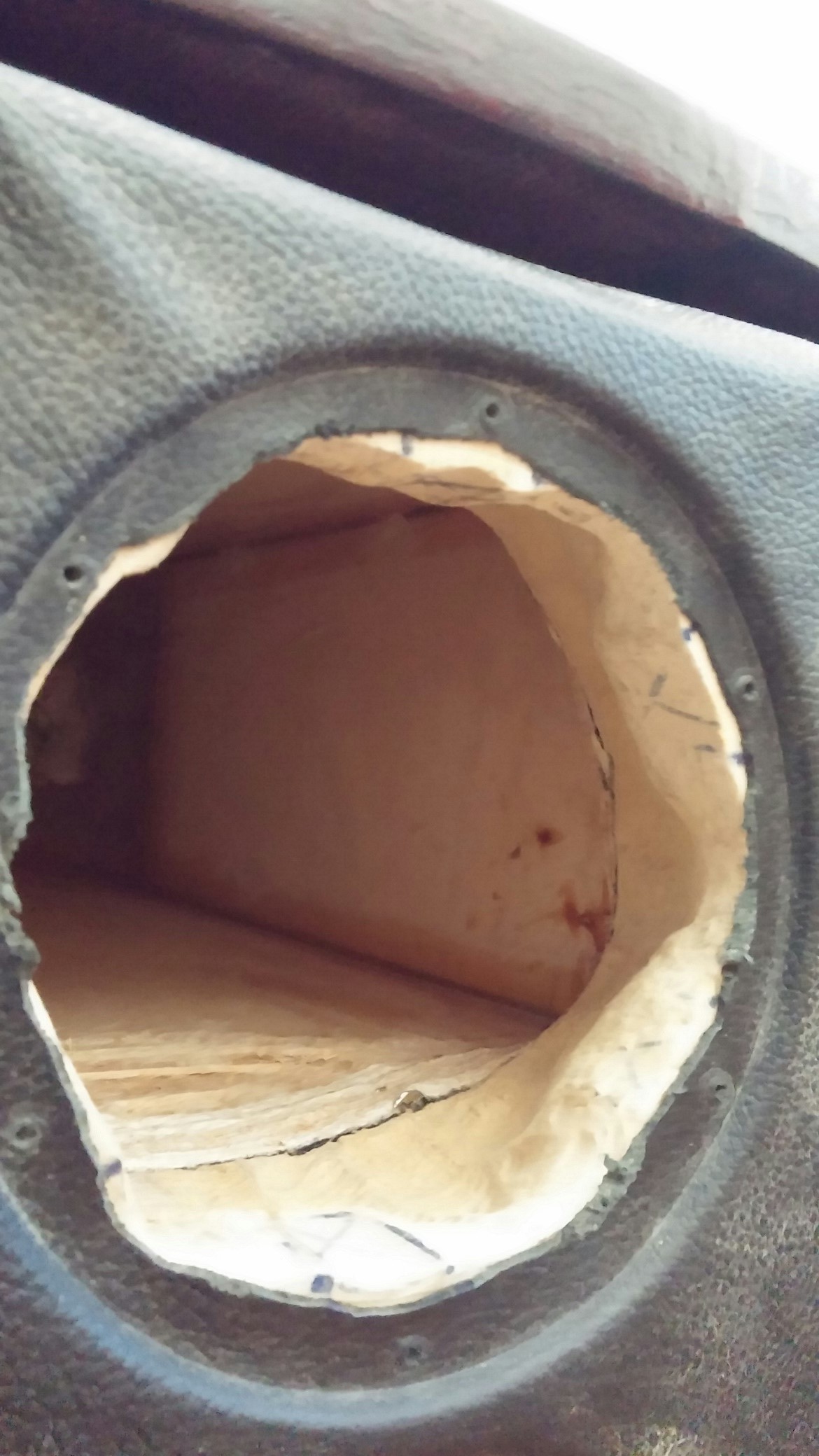

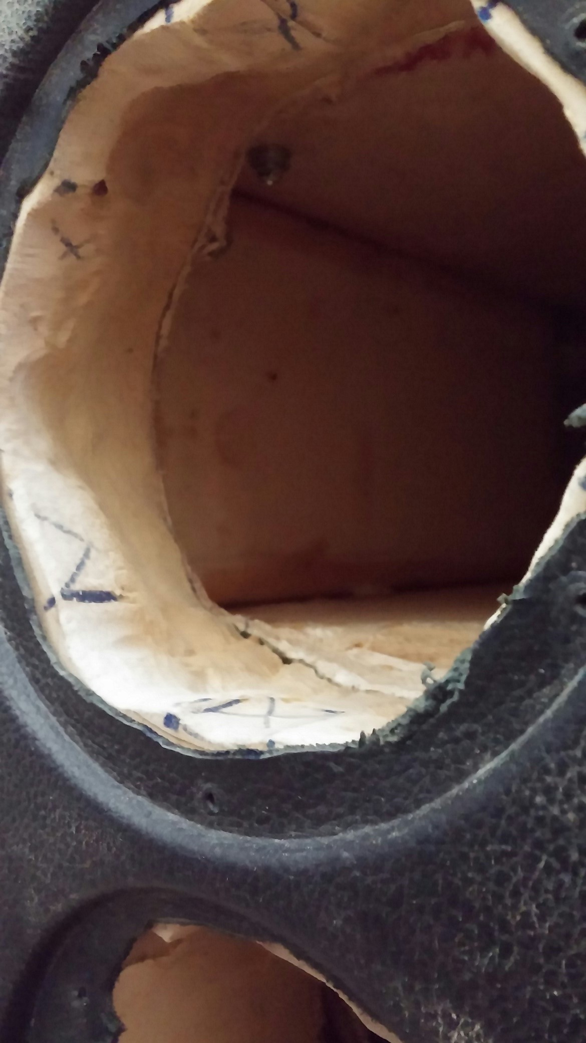

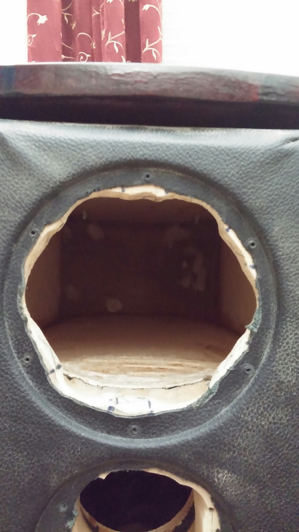

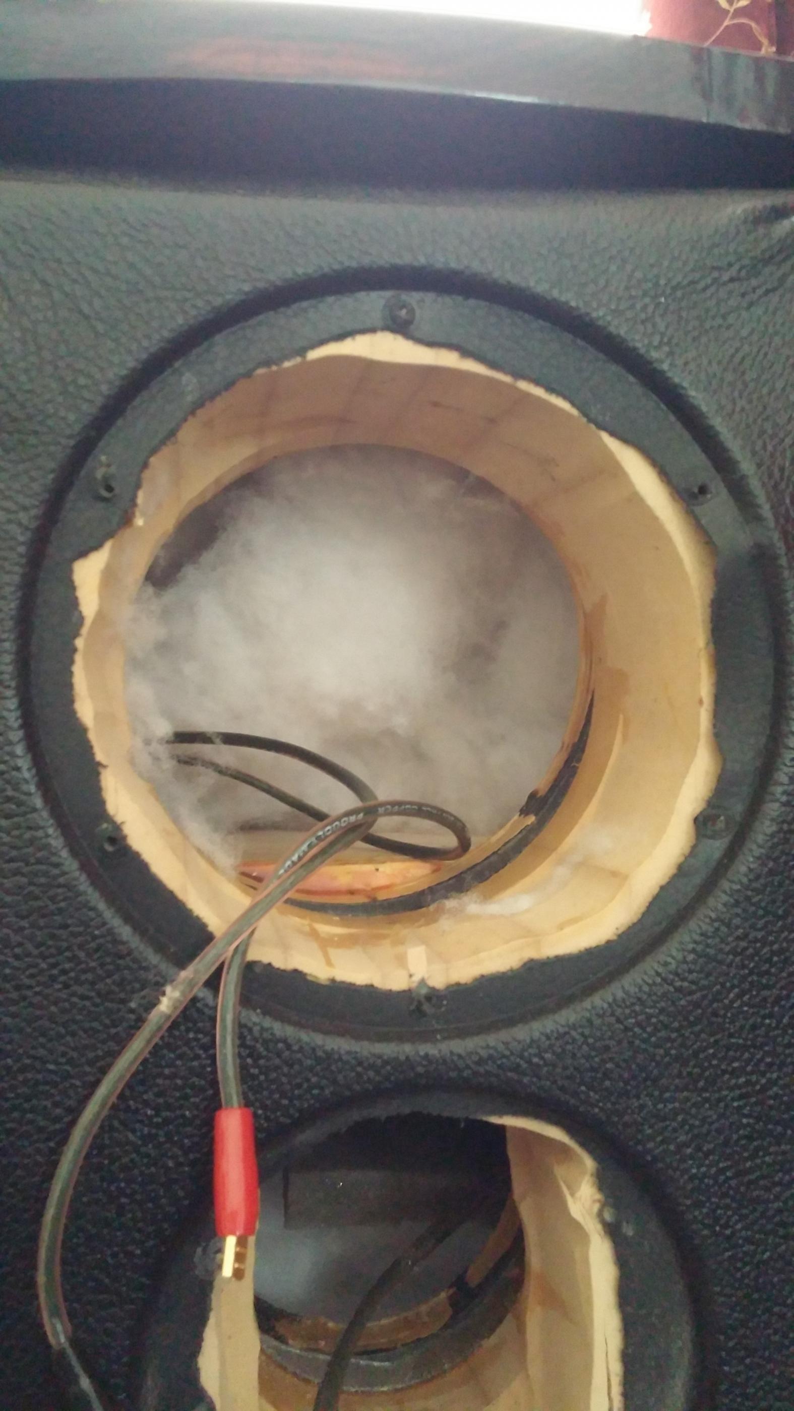

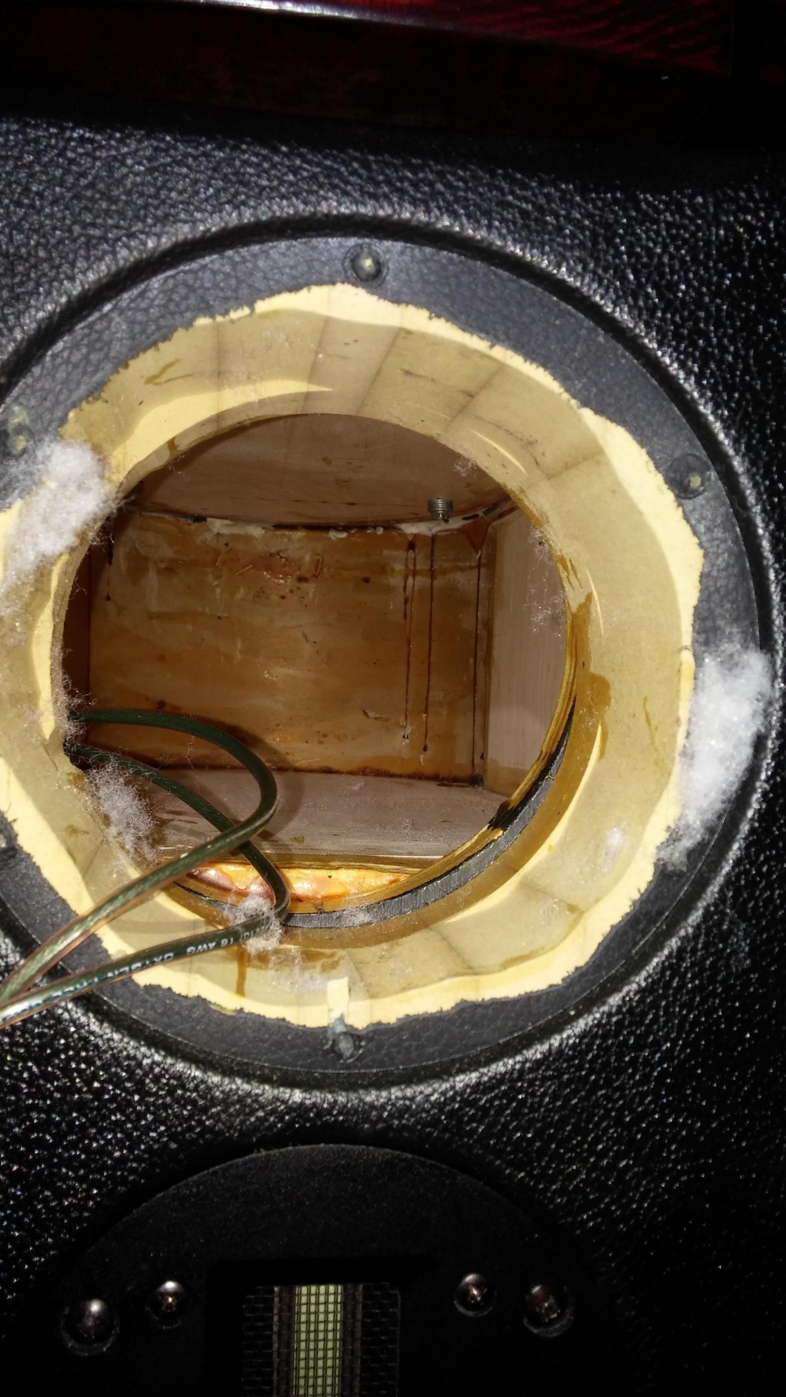

I was able to carve and chamfer out the mid range mounting holes to the extent possible. Not very tidy but should help.
Picture of original holes included for comparison.
But some updates.
The enclosures also have 8mm felt lining now. Some blocks of dense rubber foam placed to break the parallel surfaces and also slightly reduce the volume as Rick had suggested. Finally the stuffing goes back in.

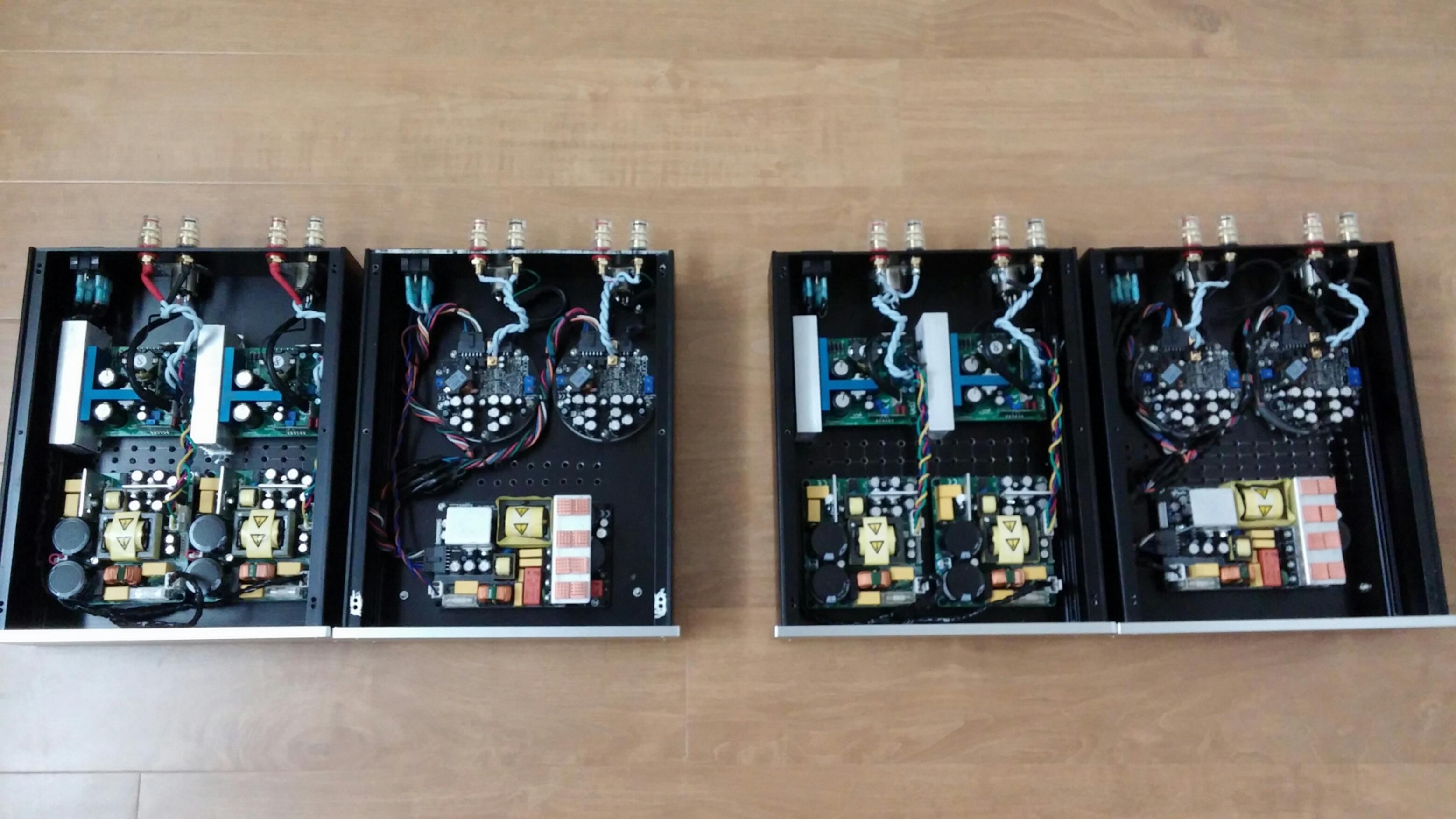

Updates:
I had eventually taken the route of a full DSP active system.
I have put together 8 channels of amplification using Hypex modules.
2x NC400 (mid, high) + 2x UcD400HxR (bass, sub) Per side.
I am currently working on a Najda DSP preamplifier with WaveIO USB to I2S

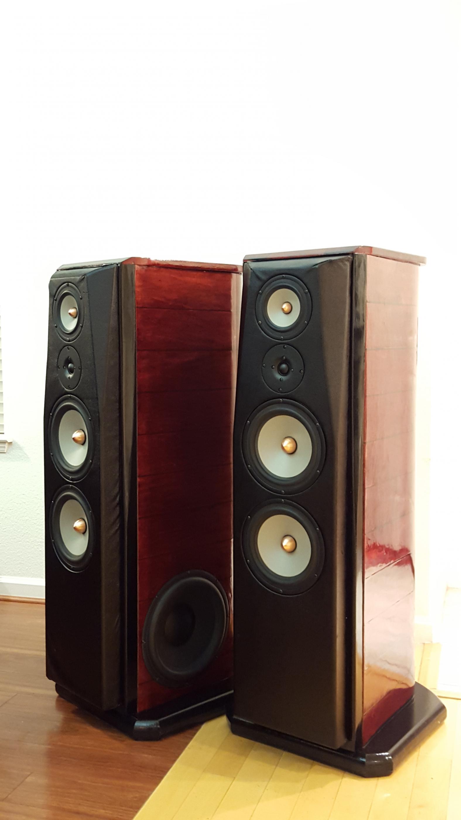

Here is the speaker with new tweeters.
Drivers are wired out (without XO) to dedicated binding posts for direct drive with the Hypex Amps.
Also note the cabinet refinish to taper the baffle edges.

Good to see progress and a very flexible setup albeit at what looks to be very high expense.Thread is pretty much dead, but will keep posting my slow updates.
Just jumped in and picked up some basic woodworking know how
8CH ES9018 DAC is under development.
DSP XO will be on an Laptop.
Has the new tweeter (what is it?) lead to a noticeably cleaner sound at higher SPLs? What crossover frequency and slopes did you end up with?
Now you are starting to pick up some woodworking experience are you considering new cabinets?
Is the laptop dedicated to running the crossover? I fairly swiftly abandoned using a large laptop that was also used for other things to control music.
Andy,
Yes the expense was a conscious decision. No regrets about the Hypex amps.Though i could have stayed with a pro audio interface instead of the DAC.
The tweeter is a T25CF001 originally recommended by 5th Element.
Still need to complete the XOs and tweaking. But Here is the XO, again based on discussion with 5th element
mid - Tweeter : 2KHz LR4
parallel W22 woofers - Mid : 300Hz LR2
Woofers - 12" sub : 60Hz LR2
12" side sub and parallel W22 woofers are shelved to overlap over the 60Hz-100Hz region

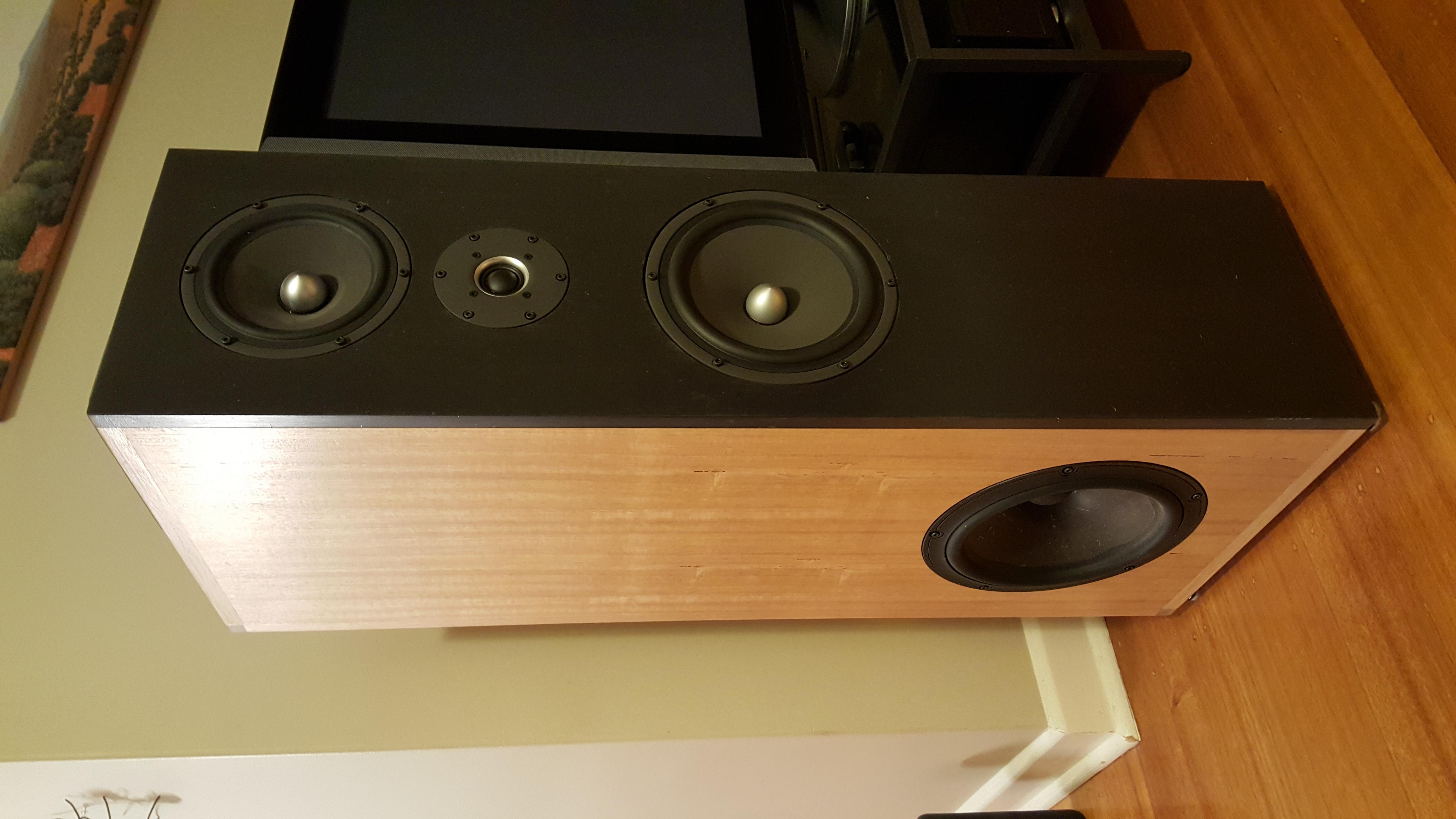

Hi
Just saw this thread and I can sympathise with your dilemma.
I have just completed a 4 way project using Seas Excel and Vifa components, in some ways similar to your.
T29CF002 crossed at 2000 Hz LR48
W18NX001 crossed at 246 Hz LR48 and 2000 Hz LR48. The mid enclosure is 8.6 l sealed, stuffed with wool.
W22NY001 Crossed at 60 Hz LR12 and 246 Hz at LR48. The woofer enclosure is 16 l sealed, stuffed with wool. Previous incarnation had Dayton RS225-8 but that combination was just awful.
NE265W-08 X 2 in parallel crossed at 80 Hz LR1. The sub woofer enclosure is 55 l sealed, only vertical column behind the MTW enclosure(s) is tightly stuffed with wool. The main cavity between 265W's was initially stuffed as well but this did not work out so I have removed the wool from this area and now it is not stuffed at all.
All significant surfaces are internally damped with butyl based 4 mm thick sheets.
This is an active system using miniDP 2X8. The amplifiers are three channel HPA-nxV203 (TMW) + single channel HPA-NXV200L R4 (Sub) for each speaker.
I tried LT for the subs but it got too complicated. Not much filtering was required after all, a shelf at 50 Hz seems all was required in my room to bring it down to 35 Hz.
The sound, good enough for me (for now, dual 12" subs may happen in future). I can enjoy the beauty of the sound in addition to the usual program. Certainly seems to handle the natural instruments such as kick drum and double bass well. Seem s to handle the electronic music lows but with this one who knows what the original was really like.
The problem (or blessing) is that I do not have anything to compare them with.

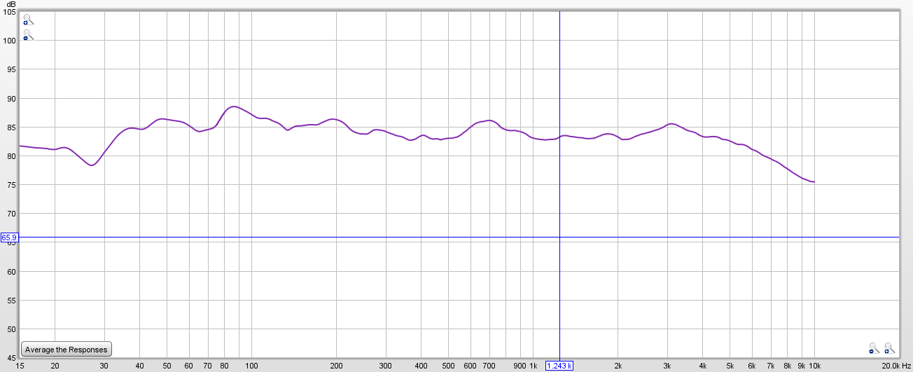

Just made parameter measurement of the drivers in the enclosure
Is this variability in the left and right tweeter params normal and acceptable
