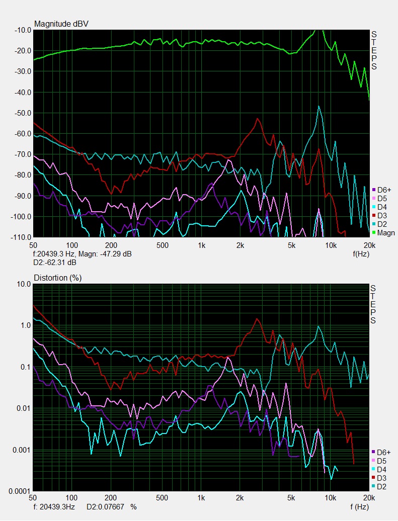

Yes the breakup of the W15 is well suppressed, that is the peak at ~8k has been tamed by the crossover. The problem is the huge whacking peak in the third order distortion at ~2.7k. This is why you cross the W15 at 2kHz with a 4th order slope, not to help keep the 8k breakup out of band, but to suppress the third order peak it creates at 1/3 the frequency of the breakup. This also applies to pretty much all drivers with very stiff cones, you generally have to cross unusually low for the driver diameter.
The neo3CD obviously cannot cope with that.

Not following this at all. The third harmonic distortion @2700 is generated from 900Hz, not 8000. To suppress this peak limiting it's range to less than 900 would be in order.
This is not what the graph is saying. The graph is saying that the third order product of a 2700Hz stimulus is exaggerated vs the rest of the drivers performance. In other words when you put 2700Hz into the driver the motor and soft parts generate a certain level of third harmonic distortion at ~8kHz. Now as the cone rings like a bell at this frequency it starts to resonate in sympathy with the third harmonic and amplifies it considerably. The only way to reduce the effect is to reduce the level of the 2.7kHz stimulus, which means crossing low and steep as a means of avoiding it.

The third harmonic peak is generated from ~900. IM third subharmonic is what you are referring to and that is not what the measurements show or are measuring. This can be easily verified by exciting the driver by sweeping 800-1000. Now do the same 7k-9k.
I am sorry but you are simply incorrect on this.
The way ARTA displays distortion data is not how you are thinking. If the graph shows a peak in the third harmonic distortion at 2.7kHz then it is saying that the stimulus of 2.7kHz has its third harmonic elevated to the level of the peak.
The mechanism of why hard, rigid, cones exhibit peaks in the third harmonic (and at other harmonics at their respected frequency divisions) at 1/3rd the frequency of their primary bell like resonance I already described. But once again to reiterate, the motor and other parts of a drivers construction generate non linearities.
If under the excitation of a 2kHz signal the motor produces a third harmonic, at 6kHz, of -60dB, then if coupled to a suitable cone would show -60dB worth of distortion, or 0.1%. If however you decided to use a cone that rings like a tuning fork at 6kHz, such as some sort of aluminium based cone, then the cone will resonate in sympathy with the third harmonic produced by the motor and thefore amplify the third harmonic product. 20dBs of amplification isn't unusual, turning your -60dB third into -40dB and from 0.1% up to 1%.
You can see this clearly in action if you look here at some of the metal cone drive units.
Zaph|Audio
The W15CY001 is included.
If you want I can hook up my W15CY001s and show you an FFT spectrum of the driver excited by a 900Hz tone and a 2700Hz tone and you can see what the third harmonic is generated from.
Alternatively here is my STEPS measurement of the driver, taken some time ago now, but you can clearly see the relationship between the frequency response and the harmonics generated. The driver is flat as a pancake at 900Hz and is operating as a pure piston, there is literally nothing within its construction that could generate a spike in the third harmonic of a 900Hz stimulus. However a 2.7kHz stimulus and its respective third harmonic? Well the third harmonic of 2.7kHz lands at ~8kHz and what do we have happening at that frequency? Oh right the cone is ringing like the liberty bell.
