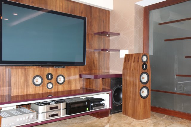

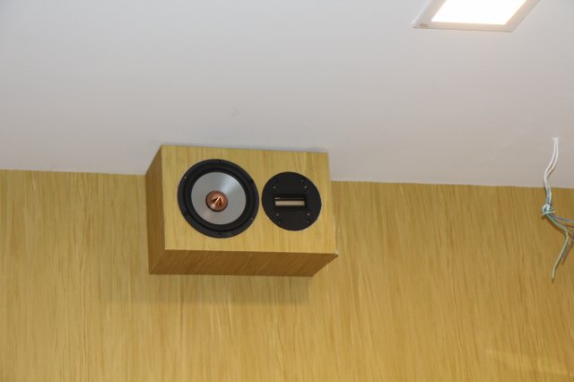

I have attached a picture of something similar that I built about 3 years ago (2102). Jojip is already aware of this system so I am just posting here for those who are not. There are grills and a fold down shutter for the electronics to ensure that the system is less noticeable when we don't need it.
I believe many who buy speakers with side mounted subwoofers do so because their rooms/applications do not permit a separate subwoofer (or 2). Jojip may have this same challenge.
I still believe that this system can be salvaged by toning down the mids, changing the cabinet volume, and chamfering the baffle. Only the last of these 3 mods are irreversible so why not try it? I am a fan of changes that are reversible since there are so many unknowns (room effects, etc..) that we just cant possibly account for each of these.

Joji,
Sorry for my late reply but I went back and read over many of the posts and also looked at some of your graphs that I originally missed. I am a little familiar with Arta (a local friend uses it); however, am not so sure why your system curve (minus the subwoofer) is so different than what I measured. Some of that can be accounted for, such as measurement distance and axis being different but the large step in the response is puzzling.
Part of that could be a floor cancellation so I focused on your nearfield of the W15. That showed a significant loss of output from the lower midrange , -10db versus my transfer function at the frequency I selected. The only explanations would be 1) improper volume and damping of the subenclosure or 2) some kind of issue in either your front end or measurement equipment.
The latter would be pretty rare but once you correct the volume of the subenclosure you would be able to determine the source of the issue.
The sketch of the W22 schematic is incorrect - the shunt capacitor actually follows the series inductor in the circuit. The other topologies are correct. The guessing on the crossover point of the mid / tweeter has been off so some of the conclusions drawn on that have been incorrect. The response curve on the W15 indicates good suppression of the upper end breakup.
The distortion measurements indicate the 3rd harmonics being -40db or lower in the upper range of the mid and lower range of the tweeter. I'm not sure how the measurement level compares to your normal listening level (maybe you can shed some light on that); however, those are reasonable numbers that don't indicate a severe problem. It's possible the spike at around 2.8K in the mid is diffraction related from the baffle. If so, a nearfield measurement of the harmonics would verify the baffle interference. If not baffle related then possibly a result of baffle obstruction on the rear opening of the driver, again, removing the excess material and re-testing helps here.
