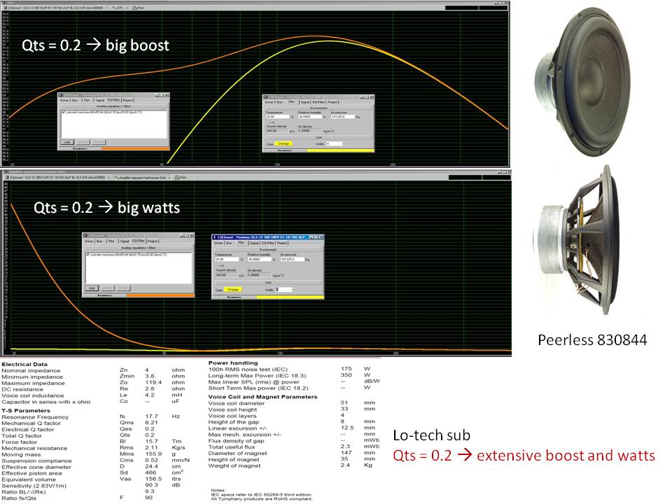

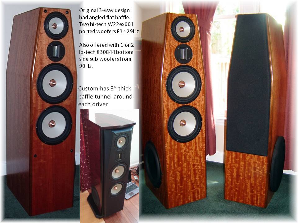

"In a vision I saw removing the four lo-tech Peerless subwoofers for a future project, replacing their holes with ports for the two W22EX-001 (E0022) in 3.8cuft, the two 3"Dia 9.8" long ports tuned to F3= 29Hz SPL=90db sensitivity for two in series(93db for 3.5-ohm parallel load). Replace the ribbon with a dome tweeter using LR4 @2Khz to the W15CY-001 (E0015) after chopping open the front baffle tunnel into 0.25cuft fiberglass-lined volume Qtc =0.57 F3= 66Hz SPL=84.5db, acoustic. L-R-C filter on W15CY to remove cone breakups starting at 5Khz, plus LR4 at 300Hz to woofers. W22EX-001 acoustic LR4 Xovers at 300Hz + some baffle step comp."
Sadly, my prayers for audio jubilation and exultation could not be answered. .... but I found great organic Kale at Whole Foods.

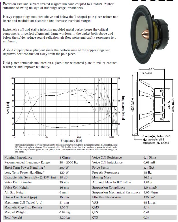

Two hi-tech Seas W22EX001 8" woofers will provide detailed midbass plus strong ported alignment bass down to F3~29Hz. 5th Element's sims in post #117 prove solid bass plus good baffle step comp is possible from the two W22 midbass.
"Precision cast and surface treated magnesium cone coupled to a natural rubber surround showing no sign of midrange (edge) resonances. Heavy copper rings mounted above and below the T-shaped pole piece reduce non linear and modulation distortion and increase overload margin. Extremely stiff and stable injection molded metal basket keeps the critical components in perfect alignment. Large windows in the basket both above and below the spider reduce sound reflection, air flow noise and cavity resonance to a minimum. A solid copper phase plug enhances the performance of the copper rings and improves heat conduction away from the pole piece."
The Peerless 830844 is a lo-tech subwoofer. Qtc=0.2 and Fs=17Hz requires extensive boost and high watts to generate 20-30Hz bass. Heavy 176g cone, Le=4.2mH, probably best to use these in separate subwoofer boxes with Xover below 60Hz, instead of 90Hz used in this speaker.
There is a version of this design without the subs.
The XLS drivers are not low tech, they have large linear excursion that isn't suspension limited and advanced motors with shorting rings and low distortion. They have a low qts because of theIr extremely powerful motor. This has been done by design to result in an EBS alignment when used in a small box with a suitable passive radiator, giving 20Hz extension in a small box with high SPL capabilities. If you want to use them in a sealed box then they need EQ to get there, but this doesn't make them low-tech, pretty much all sealed subs work like this.
I agree. I often run my system (same woofers and mid) with the subwoofers turned off as most of the music I listen to has little below 40Hz anyway. In 2 channel mode driven by a measly 90W amp it more than satisfies in a 30x14x9.5' room. My listening position is about 1/3 from the back wall which in reality is a wide window (the entire width of the room).
It may well be the difference between my room and Jojip's (I have a marble floor over 4" RCC slab and brick walls) but I would also assume much of the differences is in the cabinet (oversized, 3" baffle, etc..).
This has been done by design to result in an EBS alignment when used in a small box with a suitable passive radiator...If you want to use them in a sealed box then they need EQ to get there..
Exactly. But the EQ or the PR would only affect the low bass right? Would this improve the mid-bass 'slam' or 'punch' which seems to be Jojip's speaker seems to be missing?

"In a vision I saw removing the four lo-tech Peerless subwoofers for a future project..."
How about a vison of using Peerless units for multiple subs and the main
pair of speakers wired as 3 way without woofer HP? I presume at least one
person (Greebster) would be in favor of it.
^^Me too.
Subwoofer holes should be filled with passive radiators, inside divider perforated, the volume would be opimal for BR. Perhaps .5 configuration for BSC.
Baffle modifed to give the mid more air. With active xo or new passive xo this would be optimal. The excellent (X)XLS woofers make good BR-subs in moderately sized boxes.
