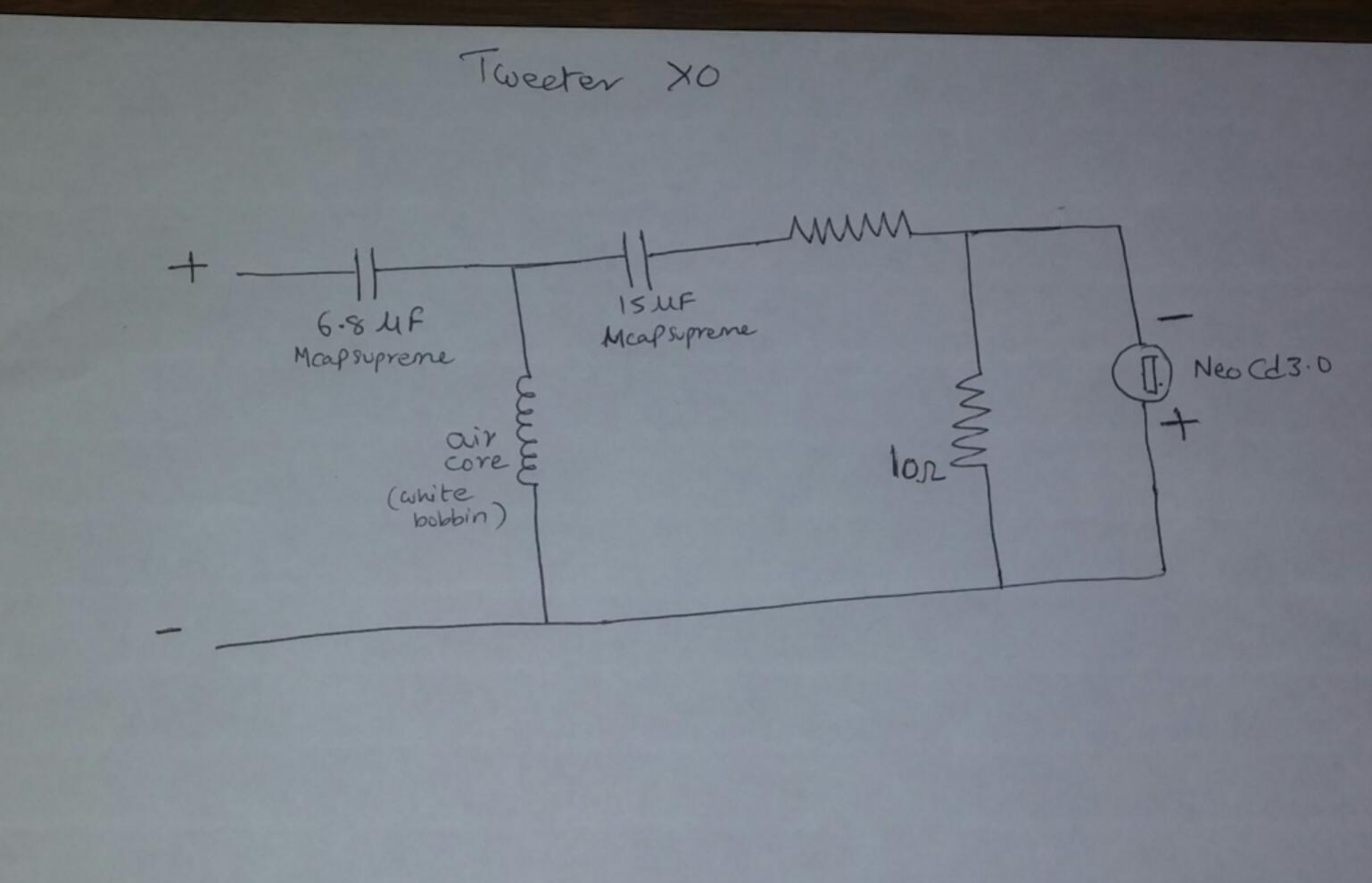

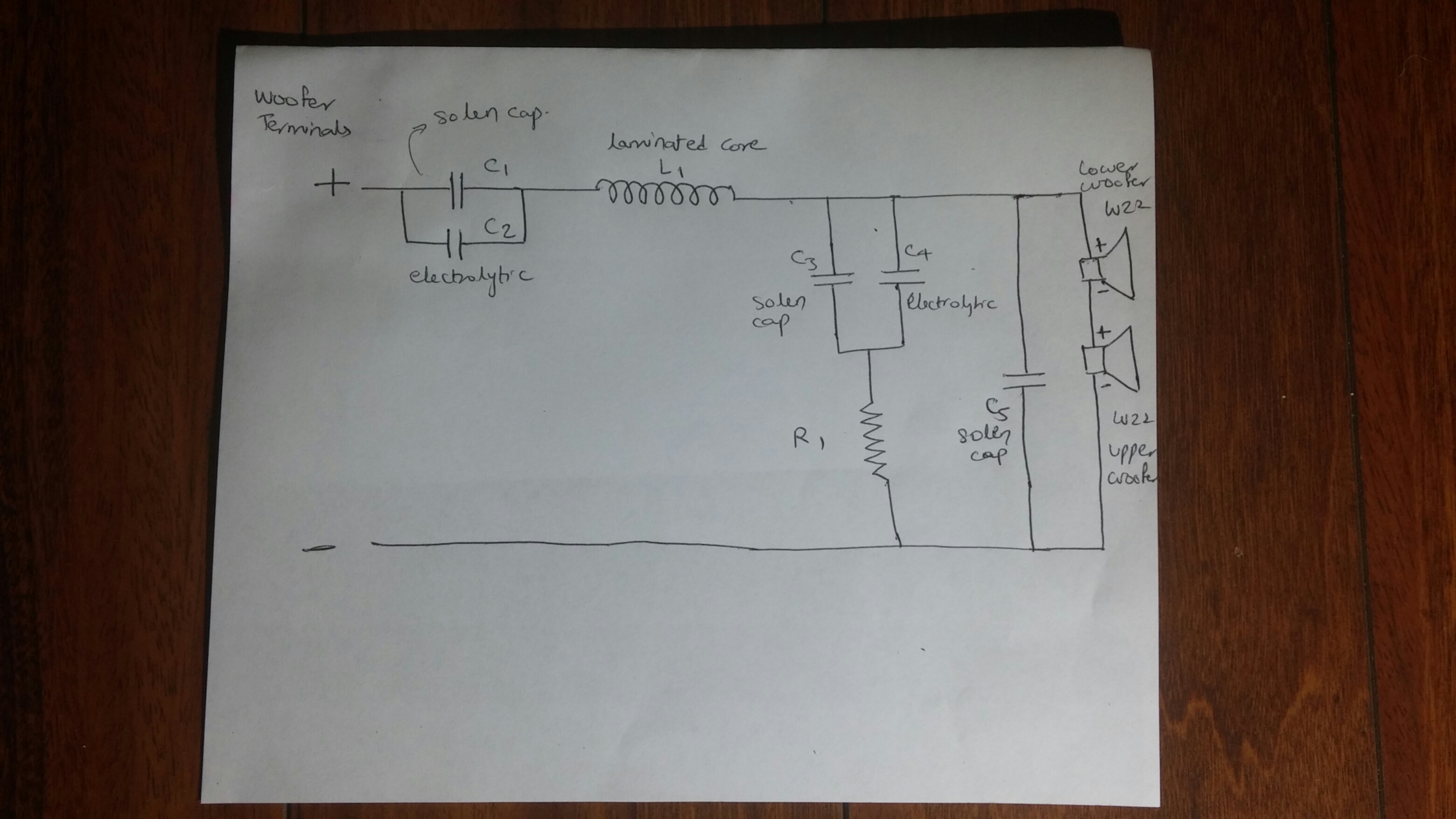

What should we do about the values?
ideas? suggestions?
and please bear with the quick hand drawn schematic
thanks
Joji

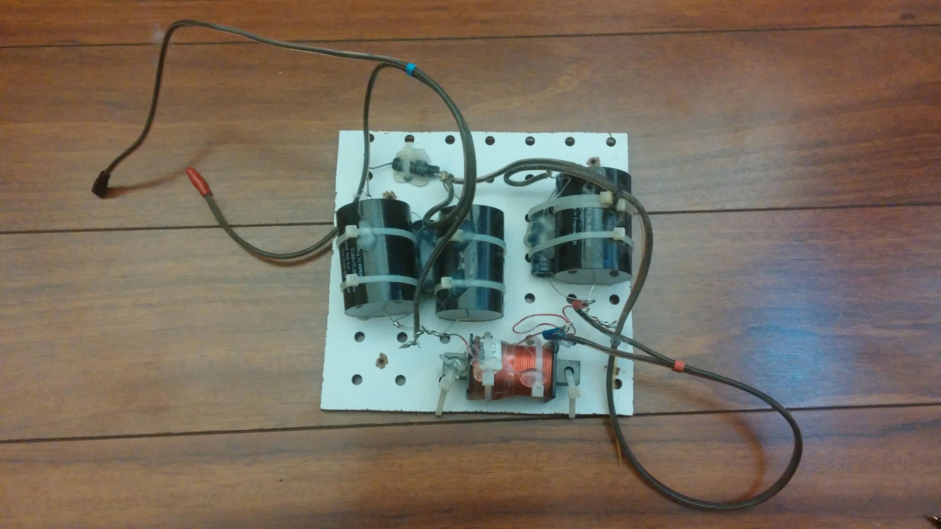

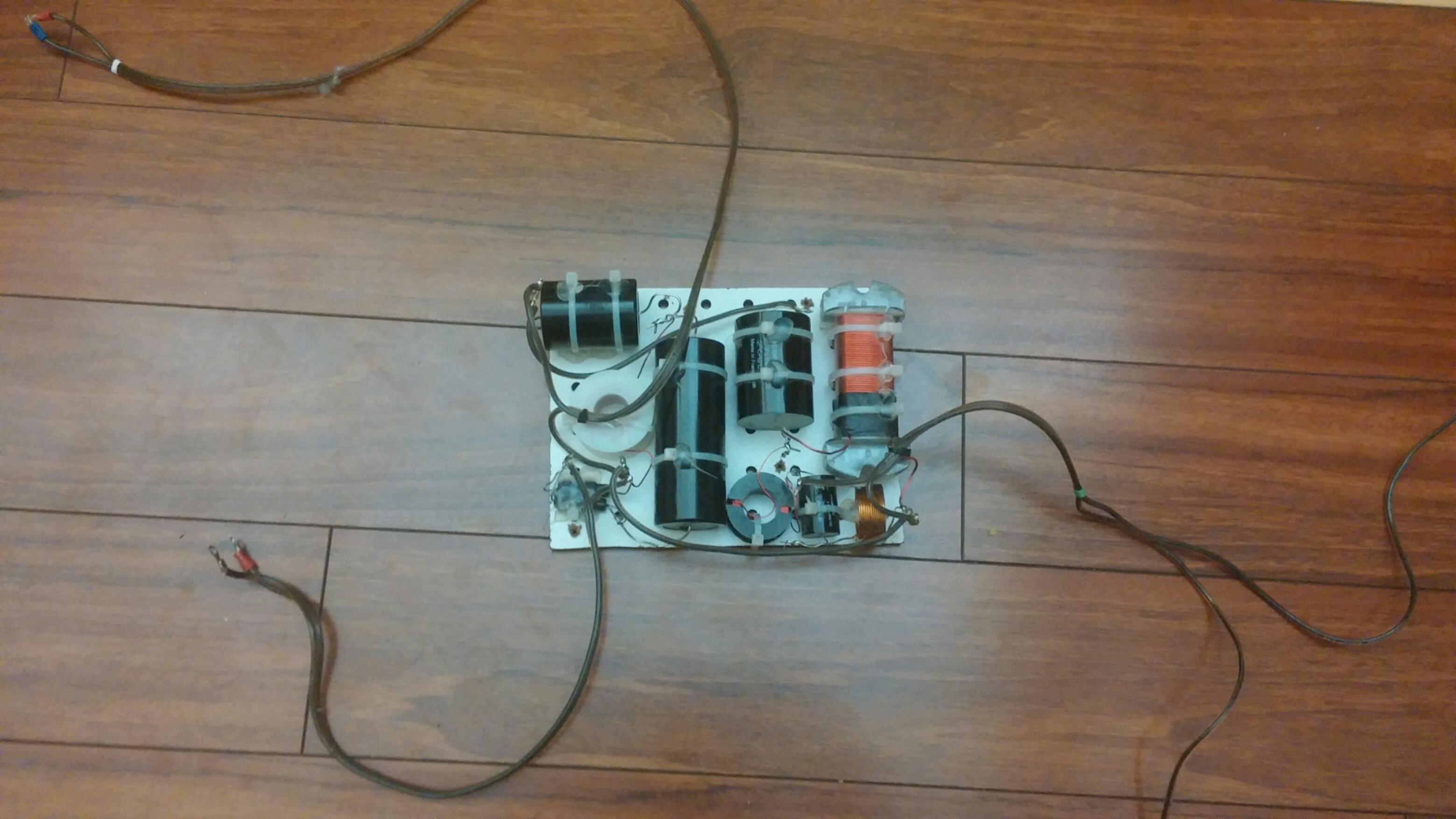

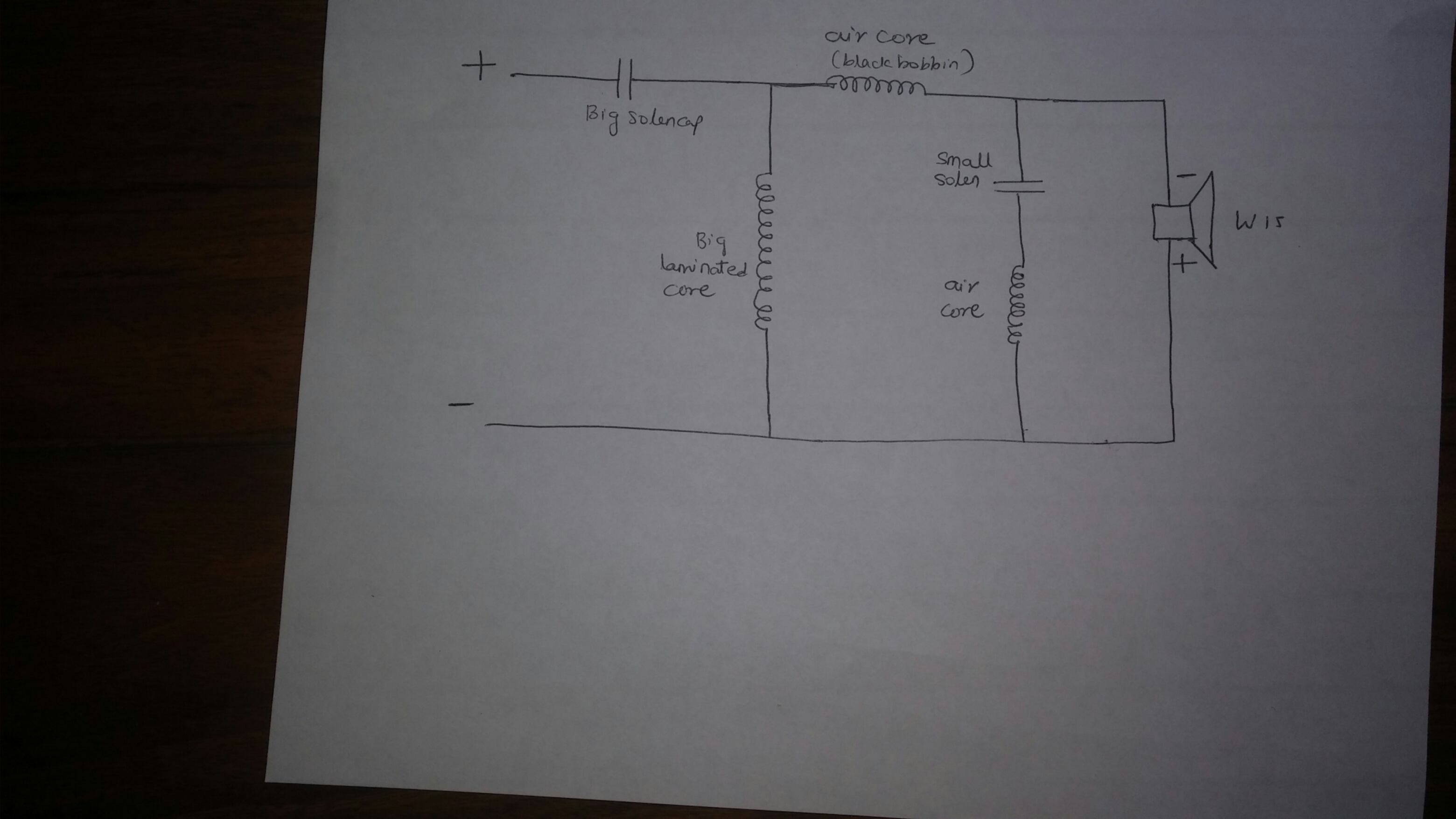

Based on the pictures of the crossover boards and the impedance plot I tried to estimate the current crossover. It's just a guess, but hopefully good enough to answer some basic questions. 🙂
The woofers do not play below 100 Hz because they are high-pass filtered. As Lojzek already mentioned, the frequency response shows a peak below 200 Hz. Two 8" woofers costing a fortune just to play from 80 to 300 Hz does not make much sense IMO.
The midrange covers the range from 300 Hz to 4 kHz. The crossover to the ribbon and the tweeter level may not be perfect, but that doesn't explain why the speaker sounds so disappointing. Either it's the mounting issue or the midrange simply is wired in wrong polarity. The lack of sound stage is a typical sign for wrong polarity too, so check that out carefully!
Ribbon tweeters are known to have high distortions, but some people like them anyway. My advise is to keep the ribbons and to fix the major issues of the speaker first. Then you still can decide on their destiny.
The MID and HIGH are eerily similar to what Dissi posted here, but they appeared to be wired out of phase in the speaker.
The circuit can be simulated and the values adjusted to match the measurements. An impedance plot would be helpful but is probably not essential and we already have an "intended" impedance plot from earlier.What should we do about the values?
ideas? suggestions?
Having established the circuit then tweaks can be examined to see how much they can move things in the right direction. If the tweaks cannot move things enough then a new circuit with the woofers in parallel along the lines of the one posted by 5th element could be simulated and developed. However, there will be reasons the designer opted to do things the way they are and not the more conventional/obvious way. If they were good reasons then expect a struggle.

Andy, Do you think the phase on the mid and tweeter is right and as likely intended?
Your in room response of the mid/high crossover region suggests the mid/high crossover is probably functioning as intended. If the mid or tweeter was incorrectly wired the drivers would cancel instead of sum in this region and there would be a cancellation dip like the ones you can see caused by the room at low frequencies.Andy, Do you think the phase on the mid and tweeter is right and as likely intended?

On the topic of the subwoofer I am not sure that particular Peerless model was optimised for use in a sealed cabinet but the Tymphany website has been down for a day or two and I have been unable to check. Was the number read off the driver or obtained from somewhere else?

Andy/Navin,
I was actually referring to the mid/tweeter XO being out of phase with respect to the woofer XO. That also seems to be the case in the XO layout that Dissi had predicted.
I was wondering if that can explain the large bass dip around 100 Hz.
but both speakers seemed to have this, so it was likely as designed and not an error.
I read the model number from the driver.
Datasheet attached.

Lojzek,
Most of these measurements are in the pdf i attached. I havent made any off axis. All on axi at 1 m at midrange height.
Good idea on the solen cap. Thanks.
Might get an LCR meter to do it the right way.

The fountek is IMPOSSIBLE, in my opinion, to integrate properly with the W15. For large three way designs I'd want to cross the fountek over at 5-6kHz so that it'd have the ability to play loud without any trouble. The W15 literally requires a crossover no higher than 2.5kHz to work adequately. I've used this driver extensively myself and to get the best out of it you really do need to xover it more around the 2kHz mark. We're wanting no compromise right? Well it needs to be crossed that low.
2. The 8" woofers are not wimpy, they are pretty great in and off themselves. Regardless of the design choices this loudspeaker will have plenty of bass between the W22s and the 10" XLS drivers.
3. As per your pictures of the cabinet, yes the mid range drivers baffle cut out needs chamfers. Why anyone would go with a baffle that thick I do not know it is completely unnecessary and makes lot of other things a lot harder. The designer should really have gone for the W15CH001s with this motor structure to allow the cone to breath more.
All the design really needs to make it sing is...
1) A replacement tweeter, such as the T25CF001, which will fit into the 110mm cut out.
2) Chamfering on the midrange baffle cut out.
3) A 2kHz crossover with 4th order acoustic slopes between the tweeter and the midrange.
4) A crossover on the midrange to bass drivers that soaks all of the baffle step losses within the bass drivers. You need to maximise the sensitivity of the midrange driver to ensure a good sensitivity match. Given the width of the cabinet you can probably cross around 300Hz to good effect. You may need to raise the Q of the midrange high pass to compensate for a smidgen off baffle step losses on its low end. Band pass gain on the midrange and insertion losses from the woofer crossover will make up for the slight difference in net sensitivities between the bass and mid range drivers.
5) Blend the sub modules to the W22s like you would a normal sub using the inbuilt plate amplifiers.
A good crossover design will be 100% necessary in making these sound amazing, but all things considered I don't think what you paid for them is a waste at all. Hopefully you'll be able to reuse some of the xover components.

The 8" drivers are in series which provides the best level match to the midrange and results in a reasonable impedance across the entire range of the speaker. The extra surface area also adds impact in the range that they cover. Could they be ported and crossed lower? Sure, but the cabinet volume increases beyond what was practical and low bass isn't really the best attribute of the W22.
The plate amp I supplied for the kit was intended to be mounted on the rear of the cabinet. The customer who built this kit added the outboard Dayton amps since the curved rear didn't allow for a plate amp. The Dayton amp will suffice; however, I don't have the specific settings for that unit. You can use Arta to calibrate the amp as needed. The sealed sub uses equalization from the amp to extend the bass response.
I want to address the speculation on the mid /tweeter combination and crossover for them. The feedback on the sound has been positive from owners and I have no problem with the crossover point or slope. Given that your room has a high ceiling and wood floor it might present some problems, especially if you have mostly hard / reflective surfaces (as many homes do). The resistor values I gave you will help reduce the level of the tweeter and midrange as desired. Also be sure to have good reliable source material when changing the voicing so that you're not simply adjusting for problems in the recording.
I originally made a mistake when I gave you the 60hz figure. The crossover point to the subwoofer was 90hz and the 8" section without the high pass filter was -3db @ 60hz (maybe even a little lower than that - it's been ten years!). If the subwoofer isn't set up correctly there could be a dip in the response where it crosses to the 8" drivers. That can easily be tested.
Now for the bad news. Sometimes kit customers make changes without consenting me. In this case mistakes were made that could've been avoided. The overly thick baffle is going to add some coloration so chamfering the openings will help.
The estimated volumes you gave for each section are not correct. All three are oversized, especially the midrange and 8" sections. The subwoofer section could be changed with some added bracing or blocks to decrease the volume. The same is true for the midrange. The 8" section is a little different in that the volume is really closer to what a ported cabinet would be; however, the cabinet layout prohibits adding a port. The volume could be reduced in the same method as above to keep it as a sealed enclosure.
The volume issues with the midrange and tweeter could be part of the audible issues that you've noticed. Without being there to listen it's difficult to say exactly what you should do; however, if you make the changes I've suggested it will point you in the right direction. Work in small increments so that you can listen to the results as you make changes.
