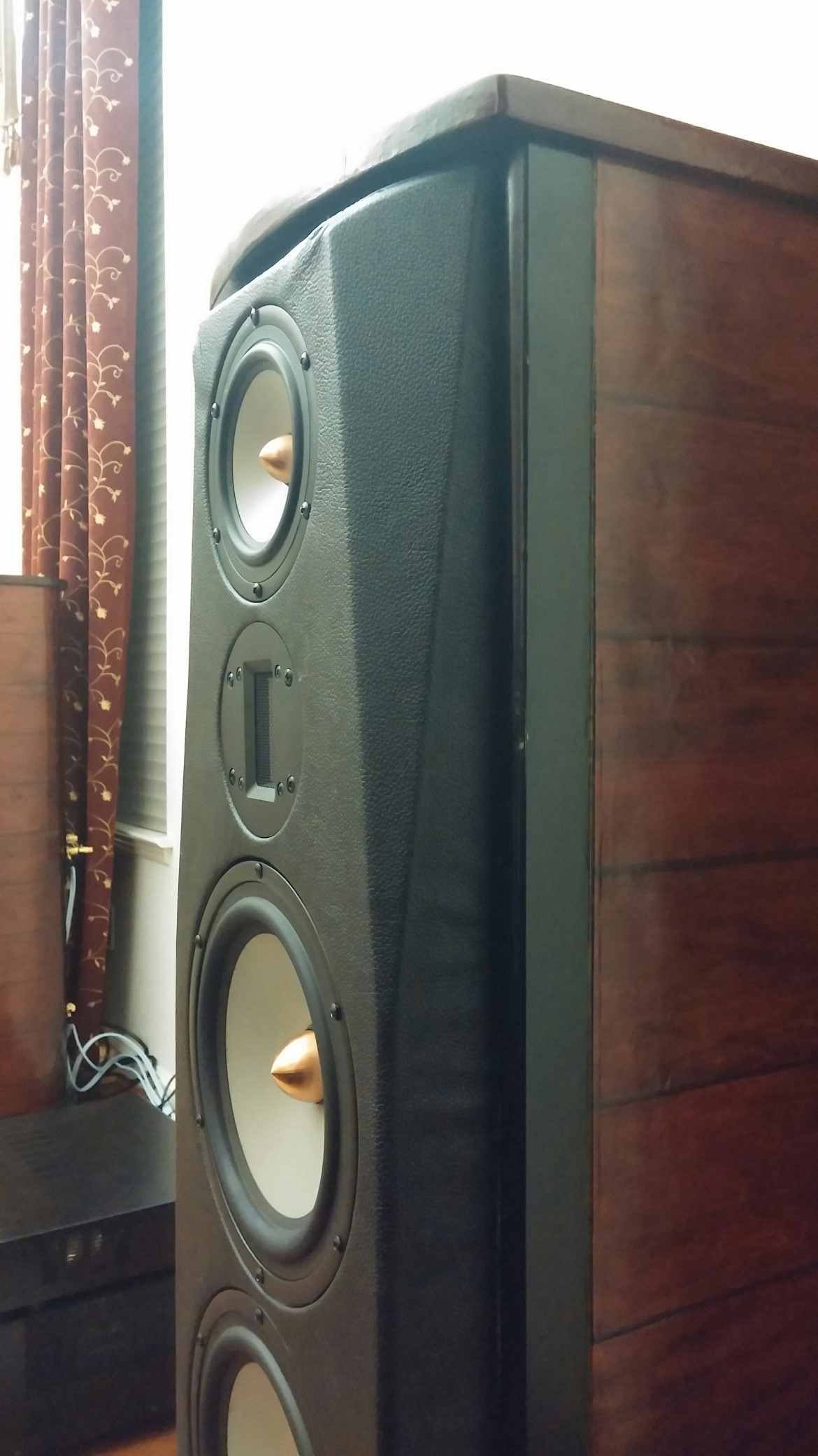

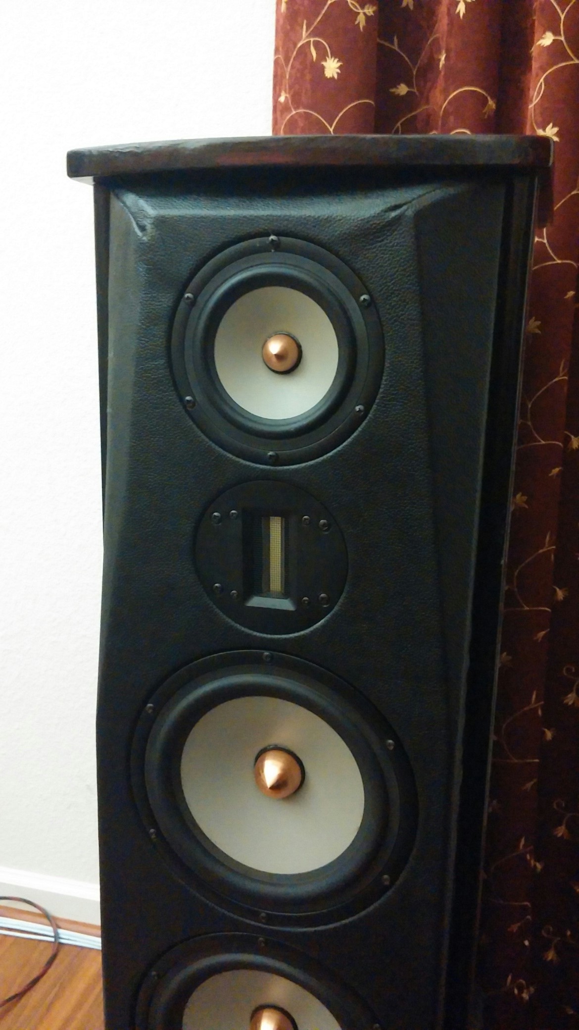

Jojip, Can you send us some pictures of the cabinet especially the baffle edges. My failing memory (I remember the old Audiogon advert) tells me that this might be another area of concern.
Navin, please see some of the pictures i have posted earlier in the thread. I can post some more if it helps understand the problem more.
Anyway from the OP's original post the problem areas seem to be
1. Anything fast and complex like rock cause it to completely fall apart.
2. Music loses all resolution and everything sounds strained and muddy.
3. Sound stage and good imaging is practically non-existent
Could these be attributed to the cabinet? Baffle edge diffraction perhaps?
Yes experts, Please also offer some views and comments on the exact effects i seem to notice. Can all that be attributed to cone breakup and distortion? Then why do slower music seem to sound very good?

I did see the pictures. The cabinets are lovely, the leather wrapped baffle, the woodwork is just exemplary and I can see why you don't want to discard them. I was just wondering about the edge of the baffle and the way it meets the side walls. I could not see this detail clearly.
Here are couple of additional pictures

baffle pics
Thanks, I was wondering is the sides that are not flush can interfere in any way. Matt? Andy? anyone?

I thought the TL tweeters used even larger cut outs?
Yes I believe the flange is 120mm which is not a lot more. BTW Morel's ST11xx tweeter and ET338 also use the 110mm baffle as does the MDT33 I have (all are soft domes though).
