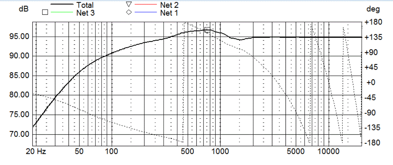

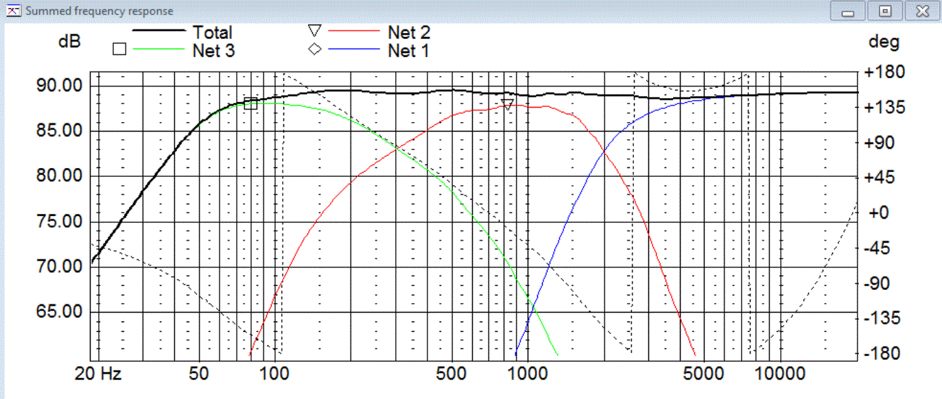

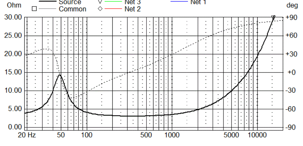

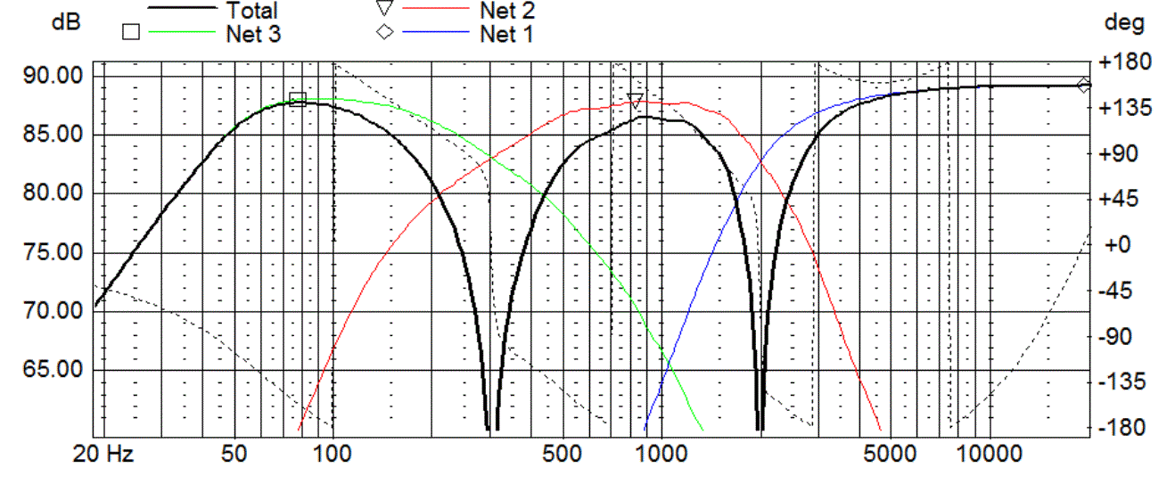

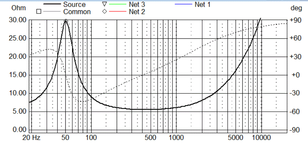

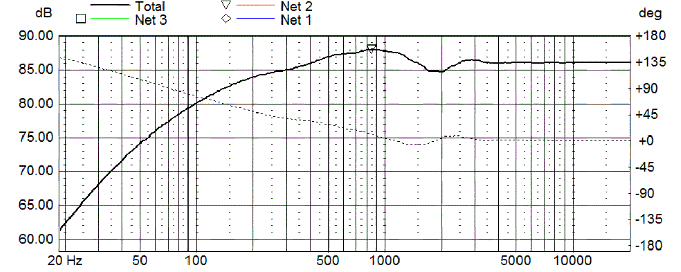

Once again I will point out bandpass gain before it's glossed over again.

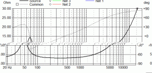

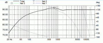

Here is an in depth simulation showing the frequency response and summation of exactly what I was talking about.
For the woofer simulation I used SEAS T/S parameters for the W22EX drivers and modelled them in a sealed cabinet. I then added in the effects of baffle step and baffle diffraction.The same was carried out for the W15CY, in a sealed cabinet, with baffle diffraction and baffle step added on. This was done in a cabinet of 1 meter tall and 30cm wide. I figured this would be a decent place to start.
The impedance files for the simulation were created using the T/S parameters in their modelled boxes with the effects of Le applied. I made no effort to include the drivers innate upper end frequency responses as the point of this was to show the effects of bandpass gain and the model one can use to put together a three way using these drivers with the bass drivers in parallel without any issues with regards to sensitivity matching.
First up is the frequency response and impedance for the W22EX.
attachment.php
attachment.php
Here's the W15CY. Note that baffle diffraction also adds in a hump at around 1kHz which is quite useful.
attachment.php
attachment.php
The tweeter is irrelevant to this as it operates purely within half space, but was included to show band pass gain.
Here is the summed frequency response for all three drives, integrated perfectly for phase with perfect rolls offs. This was done using standard passive xover components but with digital delay added in to simplify phase aligning. Trying to phase align this simulation with asymmetric slopes is completely pointless anyway as the initial phase data isn't going to be accurate for anything other than the simulation itself.
attachment.php
Flip the midrange polarity showing the driver integration for the simulations purpose.
attachment.php
This uses 4th order Linkwitz Riley acoustic slopes at 2kHz between the tweeter and the W15. I opted to use 2nd order Linkwitz Riley slopes at 300Hz for the xover between the W15 and the W22EX. Both W15 and W22 are more than happy with this, it keeps the crossover component count down and reduces insertion losses.

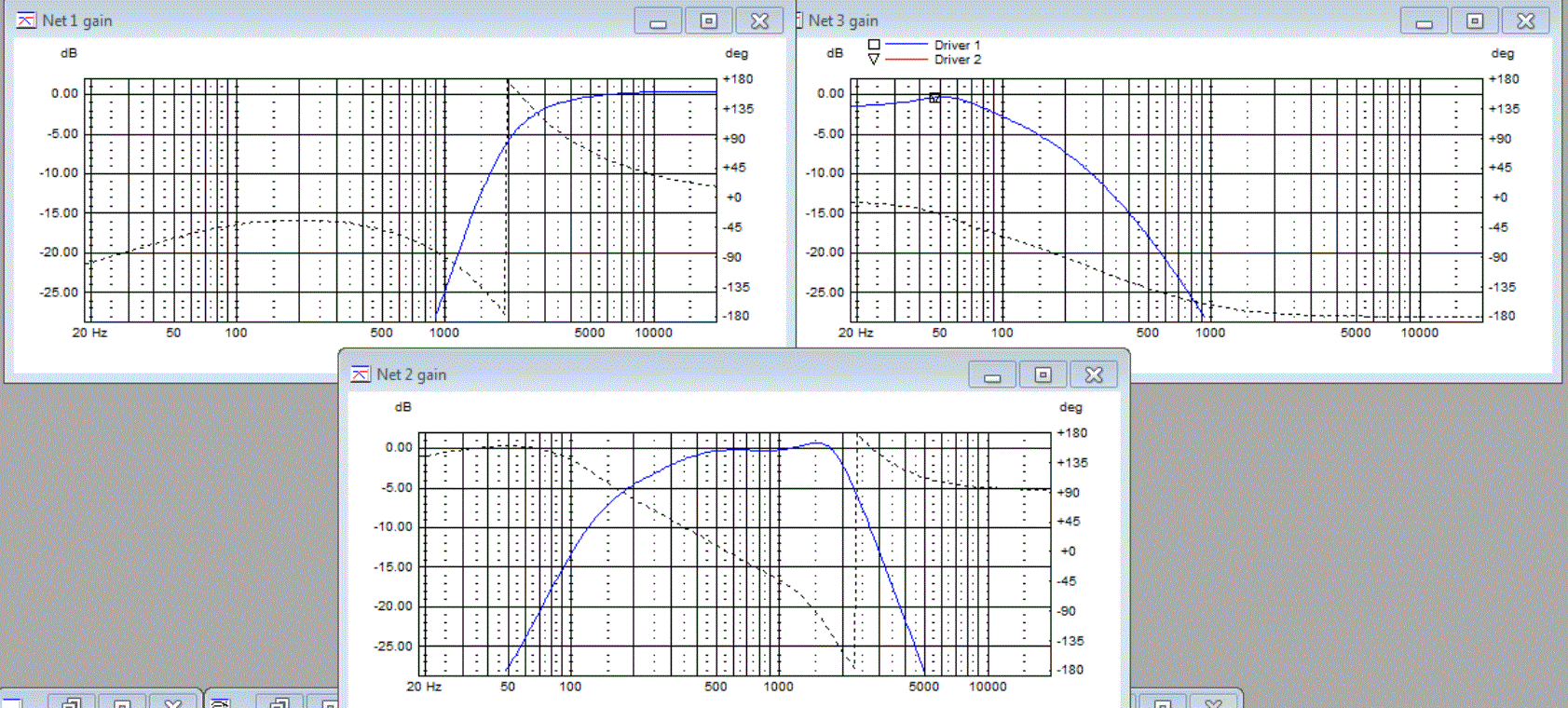

Here is a diagram showing the network gain.
attachment.php
Nothing surprising on the tweeter or the midrange. The one to mention would be the woofer network gain. As you can see, towards bass frequencies there is an attenuation of around 1dB, this is due to the insertion losses of the passive filter. As I mentioned earlier on in this thread you are going to lose some sensitivity to this. The primary inductor is 5mH and I chose a value of 0.6ohms for the DCR. This was a middle of the road value with some inductors having as low as 0.3 ohms and some ending up more around the 1ohm mark.
What you can notice here is that there is no excessive attenuation applied to the bass section to make it match up with the midrange, I have simply compensated for BSC losses whilst dialling in a perfect 2nd order LWR at 300Hz.
As you can see from the summed frequency response the overall picture is perfectly acceptable with the amount of bandpass gain clearly visible. The midrange driver might not be as sensitive as the woofers or tweeter, but bandpass gain requires that the tweeter and woofers put out more than this by more than 1dB to meet it sensitivity wise. This is less clear on the woofers part because the sealed alignment is starting to roll off towards low frequencies, but if it were flat down to 20Hz it would look the same as the tweeter.
The nice thing about this design is that because BSC is compensated for entirely with the woofers and or/if the midrange doesn't quite meet specification you can play around with the crossover values and DCR values to compensate for a bit of sensitivity loss or the requirement for more/less BSC.
5th element,
Brilliant work!! Absolutely brilliant!!
Just one question: you have used a 2k/4th order LR HP on the tweeter. However is the NeoCD3.0 capable of going so low? If we raise the XO to 3khz (more likely for the tweeter) will there be a hole in the response?
Anyway from the OP's original post the problem areas seem to be
1. Anything fast and complex like rock cause it to completely fall apart.
2. Music loses all resolution and everything sounds strained and muddy.
3. Sound stage and good imaging is practically non-existent
Could these be attributed to the cabinet? Baffle edge diffraction perhaps?
None of these apply to the speakers I built (using the same mid and woofer but in bass reflex). I made 3 significant changes.
a. Moved the subwoofer into a separate box
b. Went bass reflex instead of sealed for the W22
c. Used a tweeter with a lower Fs
I suspect Jojip's issues might be related to the subwoofer and woofer sharing a box and the bass loading of the W22. What do you think?
Andy/5th element,
Either of you noticed any bass phase issues with speakers having side mounted woofers (either passive or active)? I have heard this on 3 speakers - it was obvious on the NHT3.3 (Ken Kantor design) and the Def Tech BP7002/4 (Sandy Gross) but less so on the Audio Physic Aventara (maybe because Joachim Gerhard used 2 woofers on each side).
Jojip,
Can you listen to the speakers with the subwoofer turned off and report? I know it will sound anaemic but it might also lead to a solution and it costs nothing.
Matt,
Thanks a bunch and indeed very detailed design and analysis.
Though i will confess that i dont have the expertise to even fully understand some of the details you mention here.
I see that such an effort with real measurements in the cabinet are needed to get the best out of this speaker.
But this also means a full rework of both XO.
With some measurements and details of existing XO we would know.
thanks
Joji
