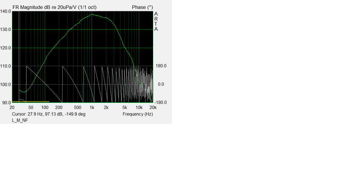

Hi Matt, Andy, others,
Posting first in room measurement on the left speaker.
Not experienced in this, so not entirely sure if the measurements have come out useful. Also i can see basic trends, but cant read and infer all details.
Please comment and explain observations
thanks
Joji
thanks
Joji

Interesting stuff. It seems to confirm what people have been deducing about the crossover. Where was the microphone placed for the all drivers plot.
What does the response of the subwoofer with no low pass filter look like? Not that it is a wise thing to do but I am wondering how well it might match the in room response.
What does the response of the subwoofer with the low pass look like? How well does it match the roll off of the woofers.
What does the near field midrange plot look like.
The mid/tweeter crossover frequency is too high for the midrange and the notch on the breakup probably should be stronger. The mid/tweeter crossover is probably too low for the ribbon but that would show up in the distortion plots at more elevated SPL as was shown earlier.
What does the speaker sound like with a full baffle step added with an equalizer? To get an idea of what the baffle step looks like for your speaker baffle and driver layout try this program or equivalent.
All far field measurements were taken at 1 m, on-axis and aligned to the center of the midrange.
Near field was taken at about 1 cm from the phase plug of the corresponding driver

Andy i dont fully understand the cause of the woofer issue. Please do explain what you observed from the measurements. The original owner had a decent listening room and the bass issue wasnt as noticeable even though i felt the mid/high were a bit forward even during the audition.
I somehow feel that part of the bass issue is the unfavorable proportions of my current room dimensions.
I am goign to try out the BSC simulation you recommended and try out if any PC based software EQ helps out.
Other than that, are there simple XO mods available to help this issue?
What in your opinion are the options for the bass issues.
Also i am fairly convinced that mid/high XO rework should now be undertaken as guided by Matt
I do see the response rapidly rolling off going below 400 Hz
We dont see this large roll off in the plots provided by the designer, where the response seems to be fairly flat down to 200Hz
If you plot the baffle step correction for your speaker it is probably going to be quite close to what seems to be missing in your in room response. The speakers are out into the room and so you will need most of it. It looks like the crossover might have little or no baffle step correction as we speculated earlier. Drawing the circuit will help firm up the designers intention and, perhaps, reveal possible incorrect values. So we are not quite there yet but not far off.I am goign to try out the BSC simulation you recommended and try out if any PC based software EQ helps out.

One solution is to use an equalizer and live with it. A better solution would be a passive crossover along the lines indicated by 5th element earlier with the woofers in parallel and a new woofer/midrange crossover. However the circuit shown earlier did not include the difference in phase between the woofer and midrange on your baffle which will needs accommodating and will make things messier and so there is still work to do on this solution. An even better solution would be to use active DSP which will make things easy and avoid most of the compromises.
I am not sure the mid/high crossover can be successfully reworked without changing the tweeter or is this what you meant?
How were the measurements taken?We dont see this large roll off in the plots provided by the designer, where the response seems to be fairly flat down to 200Hz
Measuring bass in rooms is a problem. If you look at the measured frequency responses shown in, say, Stereophile it is a gated response at 1m (or so) on the speaker axis above about 500 Hz (I haven't looked up the exact frequency) and below it is a measurement taken very close to the woofer/s and port/s, summed and joined onto the high frequency measurement.
Now a flat near field bass response might look nice but it will wrong at the listening position. You need to see a rise due baffle step correction like that shown in the measurements of that Sony speaker I linked to earlier.
