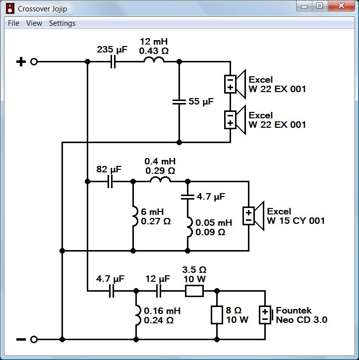

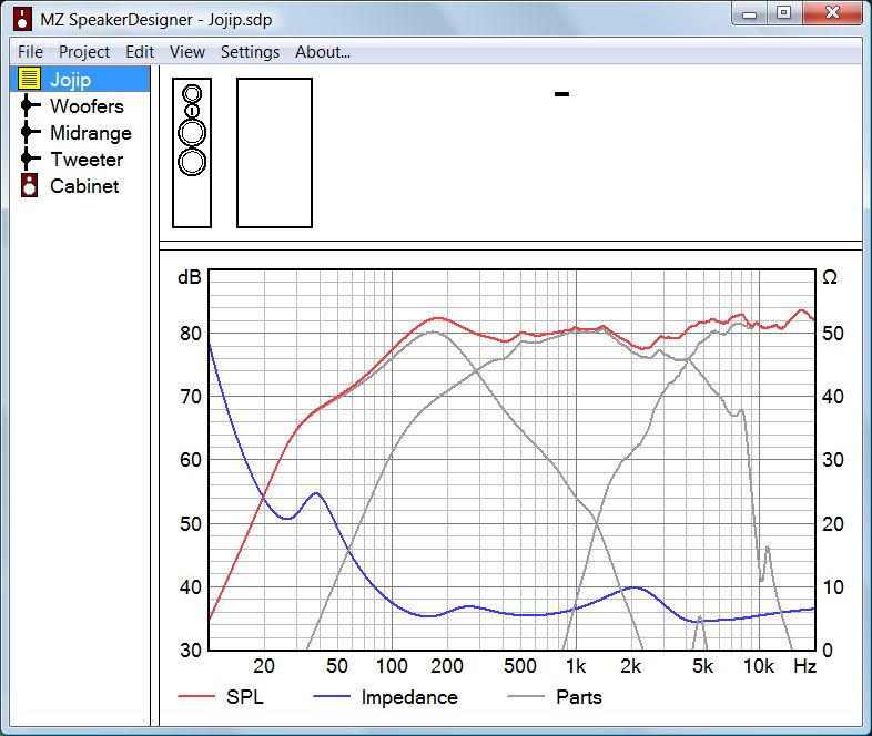

Based on the pictures of the crossover boards and the impedance plot I tried to estimate the current crossover. It's just a guess, but hopefully good enough to answer some basic questions.
The woofers do not play below 100 Hz because they are high-pass filtered. As Lojzek already mentioned, the frequency response shows a peak below 200 Hz. Two 8" woofers costing a fortune just to play from 80 to 300 Hz does not make much sense IMO.
The midrange covers the range from 300 Hz to 4 kHz. The crossover to the ribbon and the tweeter level may not be perfect, but that doesn't explain why the speaker sounds so disappointing. Either it's the mounting issue or the midrange simply is wired in wrong polarity. The lack of sound stage is a typical sign for wrong polarity too, so check that out carefully!
Ribbon tweeters are known to have high distortions, but some people like them anyway. My advise is to keep the ribbons and to fix the major issues of the speaker first. Then you still can decide on their destiny.

Thanks Lojzek. How are you running this simulation?
I am aware that some simulation softwares are available there.
I havent tried them yet. As i understand, they have a learning curve
and the results need good measurements.
I am using Jeff Bagby's set of simulation spreadsheets.
These are capable of simulating cabinet volumes and their
FR responses in bass region ( Woofer box and Circuit designer),
then there is PCD for simulating XO filters and Response Modeler
to manipulate response curves by adding baffle step response
and merging curves.
In its nature these crunching numbers software are accurate if the
input data is accurate as well. Input data in my case were manufacturer's
measurements of FR and impedance which I obtained by using SPL Tools,
a program that turns pictured graphs into textual files ( frd and zma)
which can be loaded to any simulator.
With additional data on acoustic centres of the drivers in the baffle and
their position, it can be observed how the performance changes over
different angles ( listening position).
My simulation is only accurate sufficiently to have a taste what one might
expect. For better accuracy, measurements of the real drivers in the real
box are mandatory.
Squeeze the last drops of juice these units can give you before you decide
to open your wallet again.
Personally, I would modify this speaker of yours to be a 3 way box with 22EX's
in series filtered passively at 300 Hz and somewhere around 3,5-4 kHz.
The inner volume for the woofers should be in the range of 100 liters vented
to properly play bass notes.
