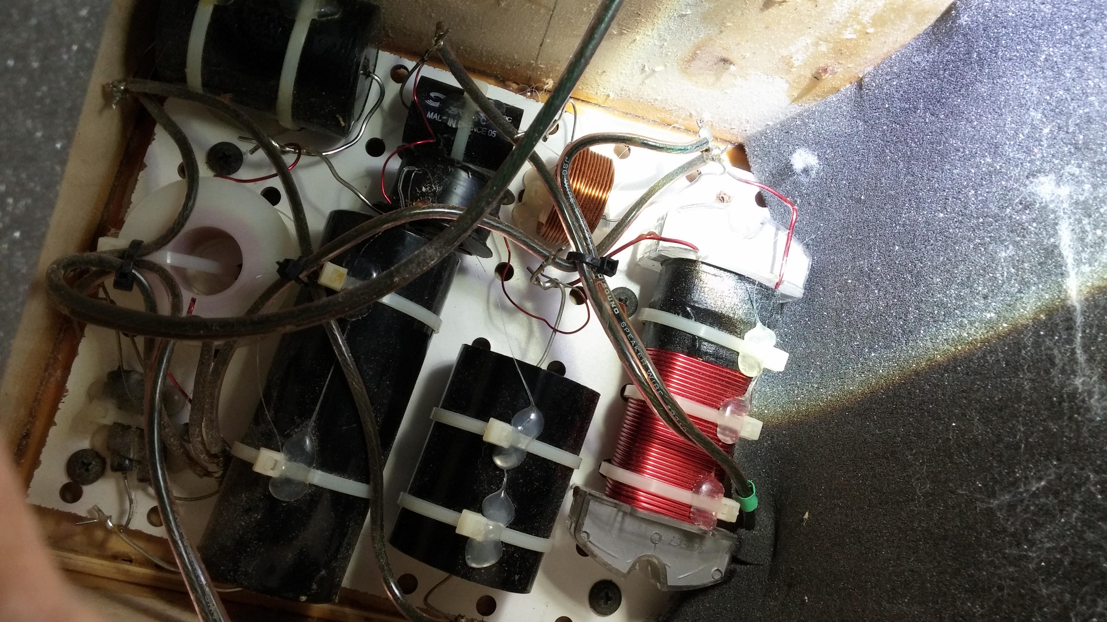

Some photos of the open cabinet, all taken through the driver mounting holes.

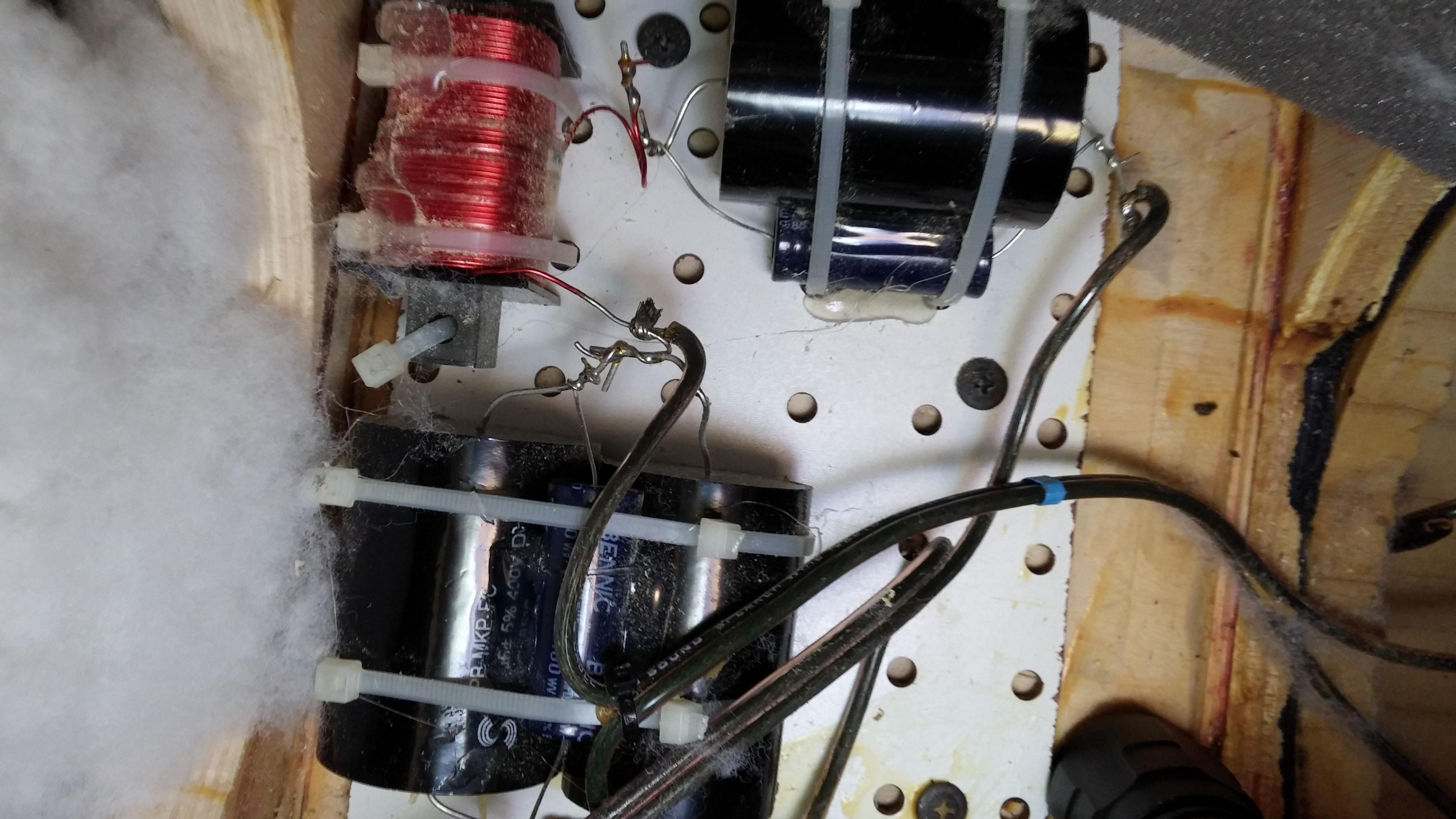

Some Xo pics
I think you may need to get them out to determine the component values and the circuit.

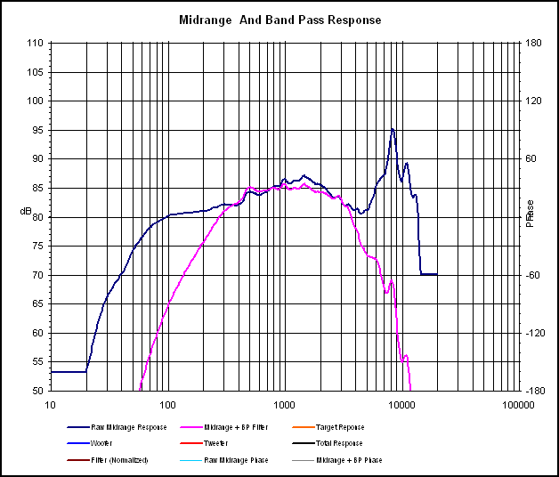

Interestingly the same author has developed a crossover for the the OP's metal midrange and ribbon tweeter albeit in a tiny 2 way. Possibly some ideas there. Of course the OP's speaker has a different baffle and the substantially higher SPL requirement means it is hard to believe the combination will be viable but it would be an interesting exercise to find out quantitatively where the limits lie.
Some points to consider:Seas W15CY001 appears to be doable for a XO point
in the 3-4 kHz region, according to my simulation.
A 2nd order HP with 3rd order LP+RLC.
Is the breakup of the midrange adequately suppressed?
Is the distortion from the tweeter adequately low near the crossover and at high SPL?
Will the ribbon reach its power handling limit at around the same point the other drivers reach theirs?
Is the directivity change smoothly handled?
OP should start simulating a setup with the drivers
he has right now to see if he can come up with an acceptable
solution. The chance to waste more money on some other
drivers will always be there.
Component values werent very clear as i looked for them. But will take the boards out for a closer look as i find time
