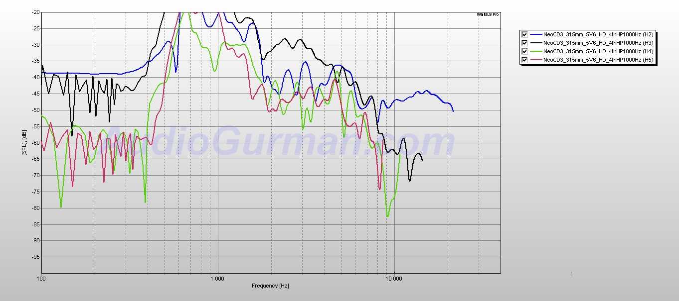

Have you read the datasheet of the Fountek Neocd 3.0.
This driver can only be used above 4.0Khz.

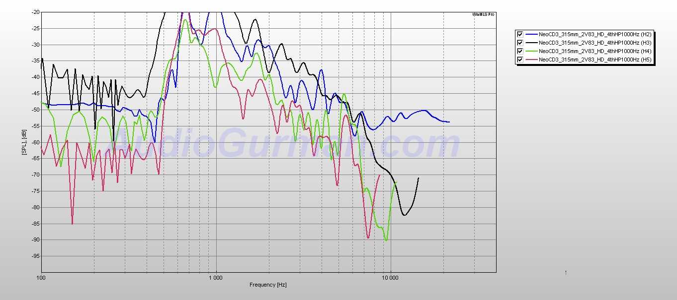

Did you have a chance to looks at the plots that i attached?

The recommended upper crossover frequency of the 5" drivers is 3kHz -see datasheet here: http://www.seas.no/index.php?option...8s-w15cy001&catid=49:excel-woofers&Itemid=359
These suggest nothing is drastically wrong with the crossover although there may be a number of modest modifications that could add up to a significant improvement.some plots i could obtain:
Crossing a largish 5" metal midrange with severe cone breakup to a small ribbon strikes me as very difficult if not impossible to do successfully. I would suggest finding out what was done in the crossover, measure more on and off axis and particularly the distortion (should be fine in room at these frequencies). Then have a bit of a ponder about your options.

Out of interest here are some distortion measurements of the ribbon. The first is done at a drive level of 2.83vRMS.
Here you can clearly see the distortion rising below 4kHz necessitating that the tweeter be used only with high crossover points.
Next is the tweeter tested at 5.6vRMS.
This is where things really get interesting as it shows what happens when the volume is turned up. Large three ways have the ability to play loud, so seeing how a tweeter response under duress is important. Here we see the performance literally fall to pieces, with the tweeter now needing a steep crossover at 6kHz to work acceptably. It is not a good choice for this loudspeaker.

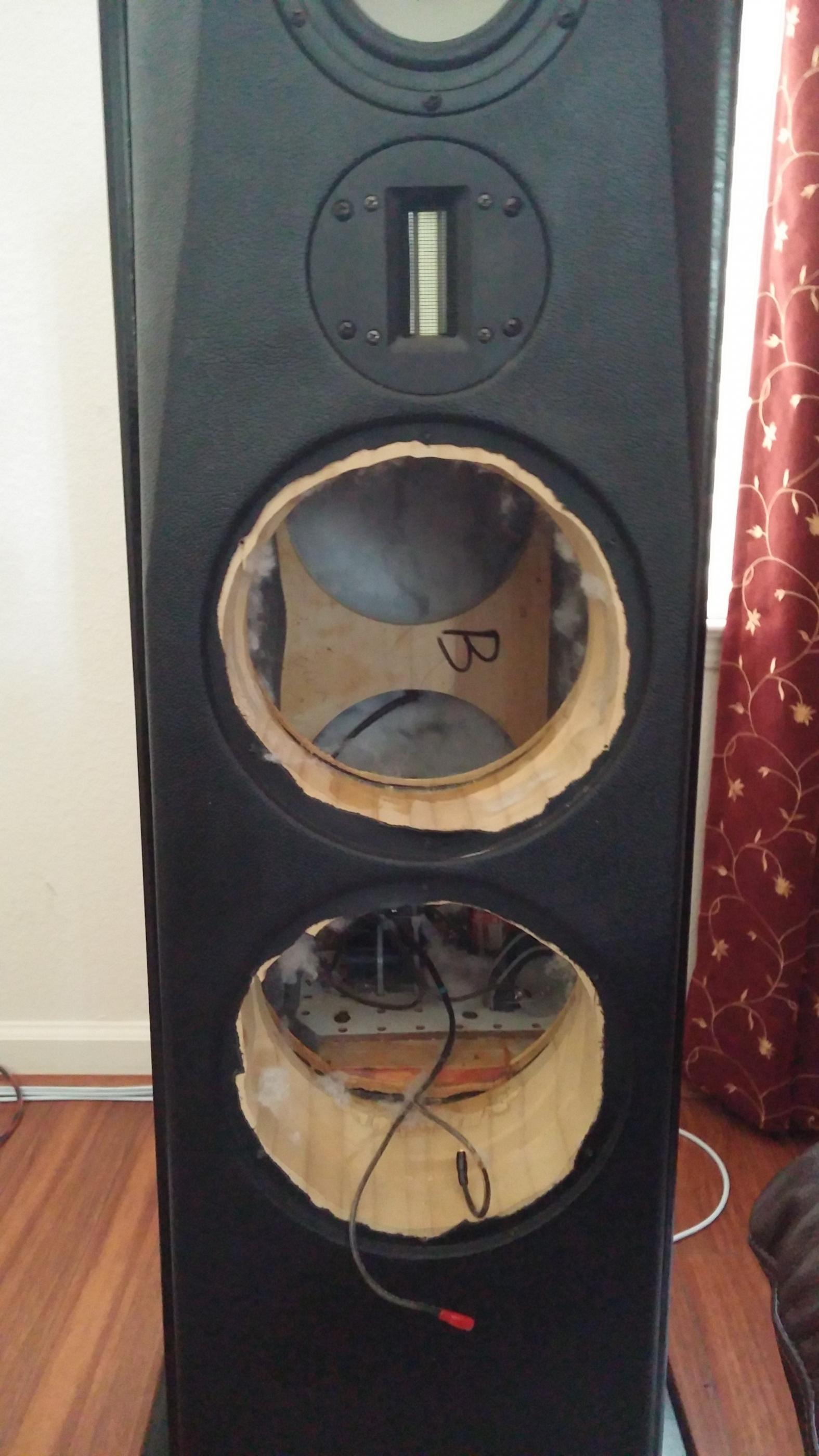

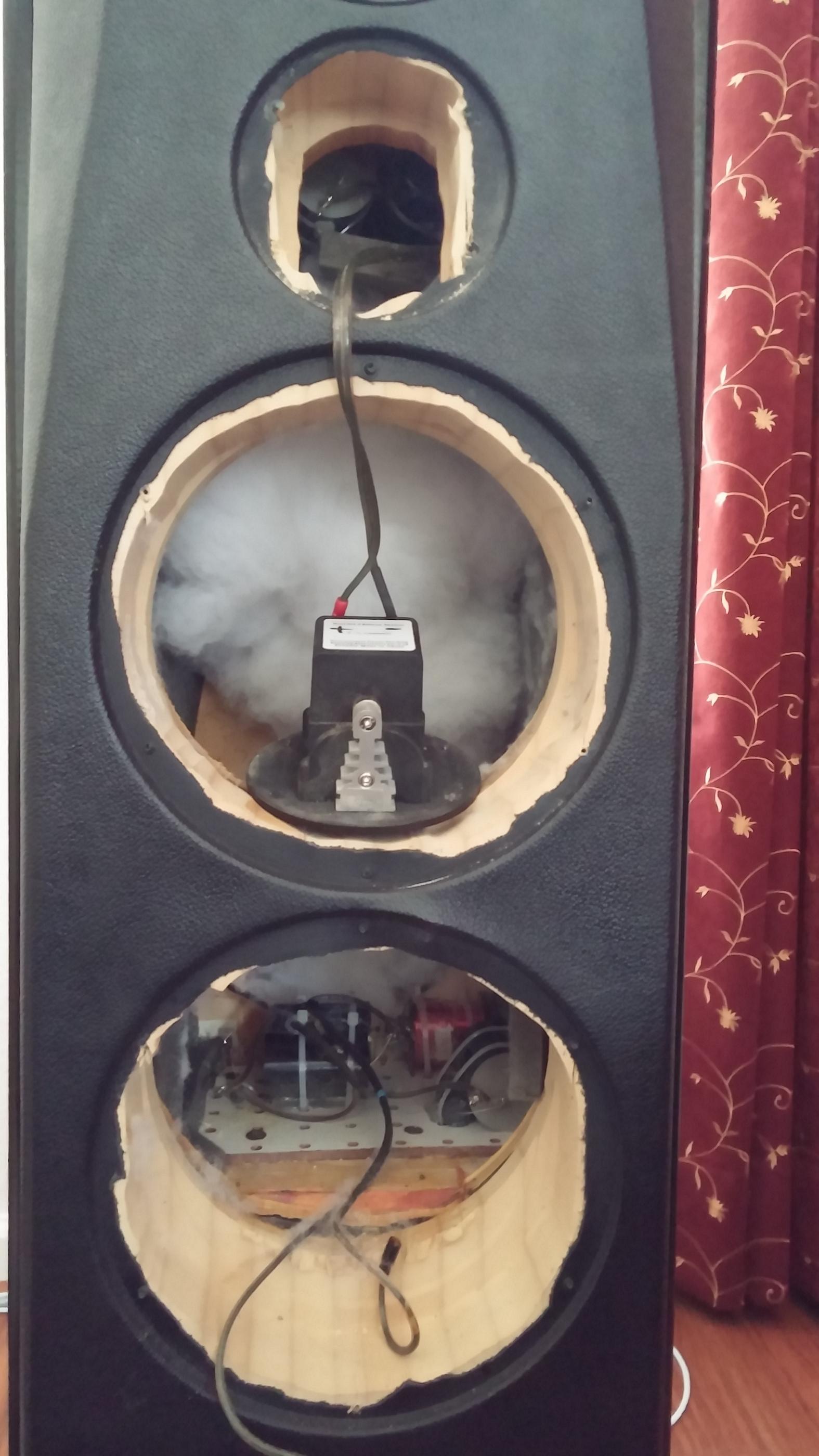

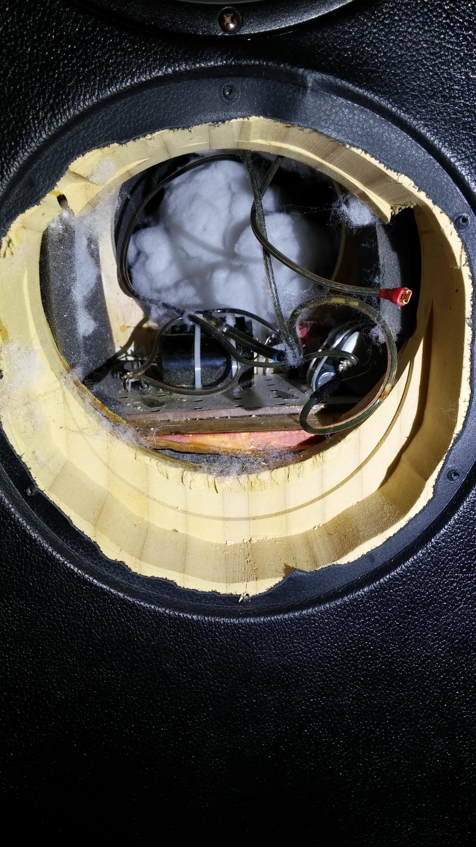

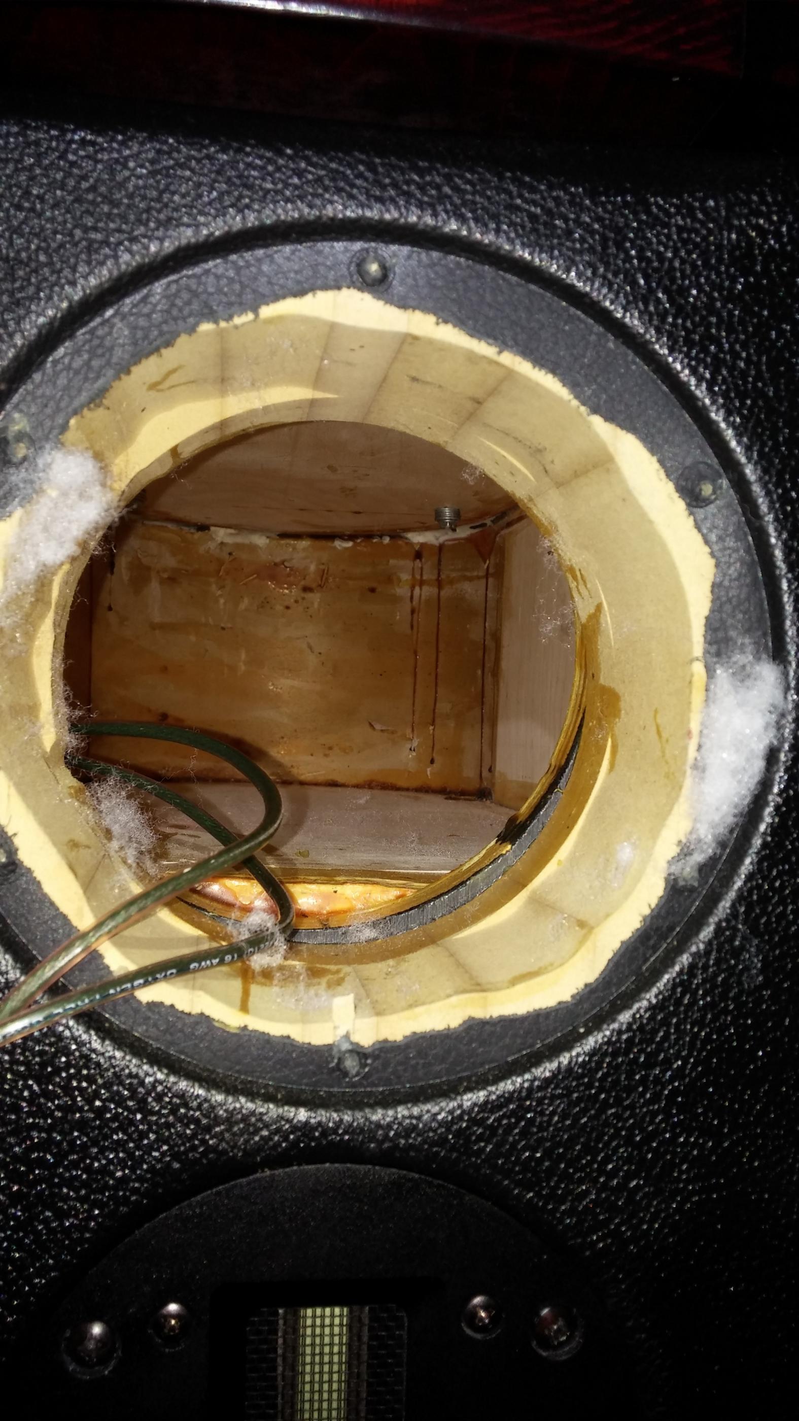

Some photos of the open cabinet, all taken through the driver mounting holes.
Crossover is not very clear. Again schematic is not provided by the designer.
1. tweeter and 8" woofer holes
2. baffle
3. lower woofer mounting hole. Hardly a circular hole. The roof of the closed subwoofer enclosure is seen at the bottom.
4. mid enclosure. Note the baffle thickness without chamfering
