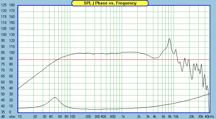

W15 :

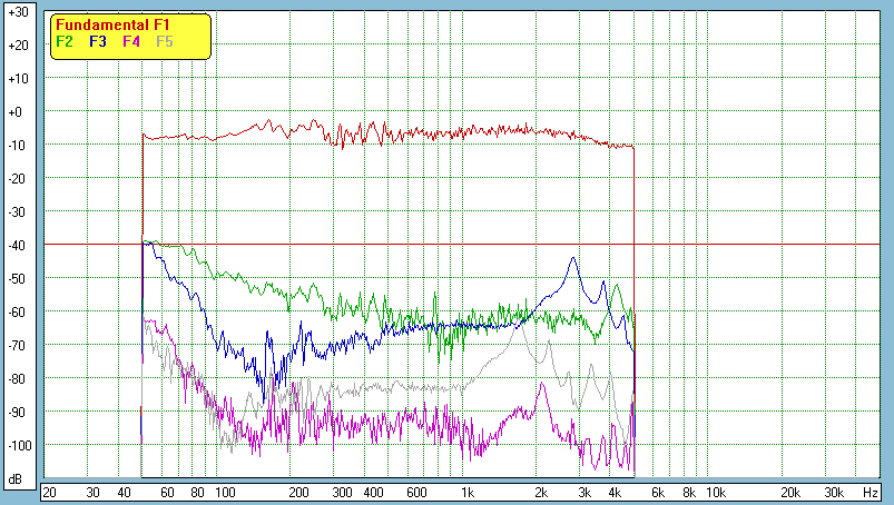

Distortion :
Note how the the 8+KHz peak tracks distortion peaks to 4+KHz
for 2nd, 2.7+KHz for 3rd, 2+KHz for 4th and 1.6+KHz for for 5th.
Its pretty obvious for optimum distortion you x/o below 2KHz,
though if you don't its only third harmonic that really gets worse.
5th if it was generally higher would be a real problem, it is not
great by any means, hitting the same as 2nd and 3rd at 1.6+KHz.
Supression of the 8+KHz peak in the x/o has no effect on distortion.
Its the x/o response roll off that reduces the drivers distortion.
rgds, sreten.

Third harmonic distortion is always 3x higher than the fundamental. If the fundamental
is 2700 then the third harmonic would peak at 8100 which is not being shown in the graphs.
Breakup does not infere it downward resonates eg IM.
Hi Mike,
it does peak at 3x the frequency, only it is plotted at the excitation frequency
so with each higher order of distortion graph, the peak moves more to the left side.
There is an AES paper on "How To Graph Distortion Measurements" presented
at the 94th Convention 1993 March 16-19 Berlin which covers the subject briefly.

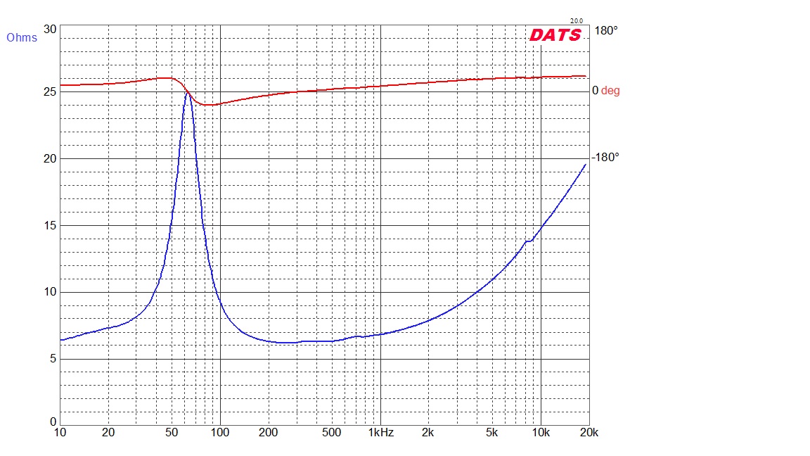

Impedance plot:
The combined speaker impedance seems to match Rick's original plot.

Either you did not measure raw drivers or something is wrong with the
measurement setup. It ought to look similar to the ones made in free
air (manufacturer). W22 and W15 impedance peaks would have shifted
to the right side being in the cabinet.

The drivers were measured with the crossover in the circuit. I compared to my software and the transfer functions are correct.

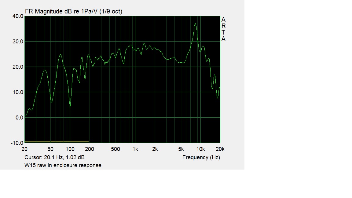

Another couple of measurements Rick had asked for and reviewed. This is the W15 raw driver measurements in the enclosure.
W15 low end roll off remains a concern. To be retaken after enclosure obstruction and volume adjustments.
Why is it a concern? It looks fine and lines ups with the published measurements by SEAS. The slope downwards is due to the low frequencies progressively radiating in an omnidirectional fashion rather than mainly forward which they do at higher frequencies. At the very lowest frequencies the roll off is due to an overly large sealed chamber which is good in giving in plenty room to dissipate the rear radiation and since it is high passed has no adverse effect in use. The driver configuration and crossover should provide the "baffle step correction" to counter the downward slope. There will also be a bit of a bump/wiggle at the highest frequencies making the peak to trough greater than 6 dB. As suggested earlier, it only takes a few minutes to get a feel for all this for your driver and baffle combination using software like edge or similar.Another couple of measurements Rick had asked for and reviewed. This is the W15 raw driver measurements in the enclosure.

PS Looking at how the response changes with your narrow baffle versus a wider flat baffle may also be interesting.
As Andy says here there is no problem. You can see from the impedance plot that the driver is tuned to a little over 60Hz. For a fully stuffed cabinet this puts the driver working in a box of around 7 litres. If the really tight hole around the driver was causing a problem the resonance peak would be significantly higher in frequency and/or highly damped (the peak would be flattened) as a result of the resistive nature of the tight space.
