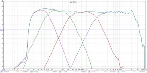

^What is measuring distance and IR gating? I mean, does this represent direct on-axis sound only or more of power response?
Summation at xo looks good!
Obviously measured 0¤ straight in front of speaker? It would be nice to know also horizontal off-axis at 15, 30,45 and 60¤ !

This is at 3 ft distance on-axi, auto gating window picked up by REW.
I will measure horizontal off-axis at other angles

jojip, REW degaul is 500ms - too long for this. For 3ft (1m) distance you can use eg. 7 or even 20ms right window gating. Then you will get some reflections, but not too much. Measurements are saved "per se", gating parameters are saved too but they can be changed every time you open a measurement.
Default can be changed in REW Preferences/Analysis subpage

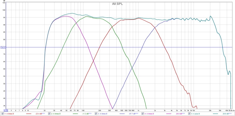

All XOs are LR4
@ 60Hz, 300Hz, 2.2KHz
W-M XO appears 400Hz on the plot. May be due to the level matching applied to the W drivers.
further any explanation for the dip at 200Hz?

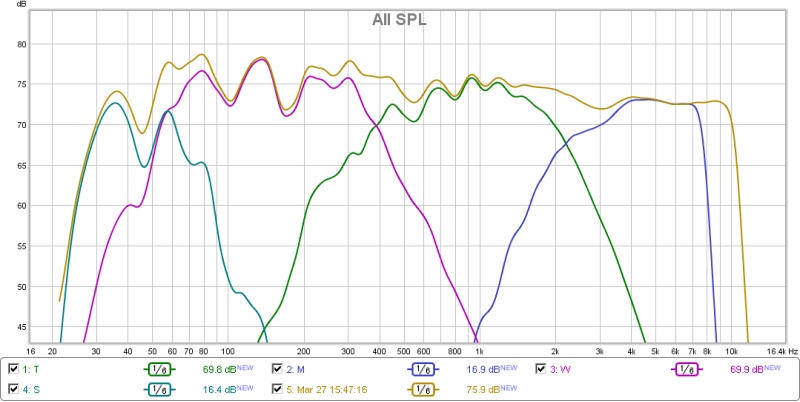

A guess could be you have approx. same distance to two boundary, example center between the two mid-woofers is 2 feet to floor and distance to back wall is also 2 feet. Some of the tools from Jeff Bagby and Charlie Laub can help, as example Jeff Bagby "Baffle Edge Diffraction Simulator v1.2" (link - software). It's sometimes very irritating acoustic facts to work with in real world, as example your two parallel wired mid-woofers will probably have exactly same response when measured close mic near-field but not at listening position because they not sit in exactly same position in space and therefor gets different distances to boundary.

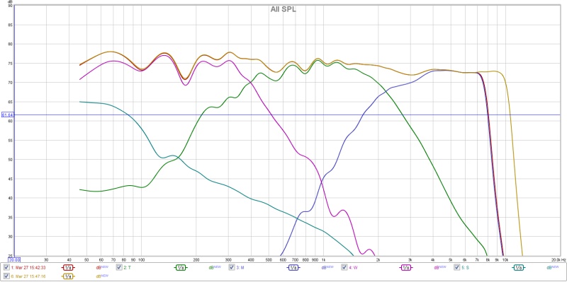

5E commented that the slopes in the plot above are not matching acoustic LR4. Do you know of a way to load a reference target acoustic curve in rephase, so that the manual corrections can be done in a guided manner?
Dips at 100 and 180Hz are most propably first reflections. That is the reason why indoor measurements are not valid below 300Hz even at best.
my 4-way dsp-controlled speaker has it's lowest xo around 150Hz, I do know how difficult it is to measure! It always leaves some questions, no matter which distance and gating. Long gate or rta measurement are needed too for this trouble shooting. (if outdoor measurement is not possible)

Up until now i only use Rephase to neutralize XO phase turn and play around with phase idea effects at system stop bands, so had not missed ability to set a target curve inside Rephase. I correct IRR domain in JRiver and use target curves inside REW to do that, and they created in Rephase on "Minimum-Phase Filters" tab, then imported to REW plus "Estimate IR delay" plus offset spl level to speaker sensitivity. There is some signs one can use inside Rephase to have virtuel target curve, as example if one is correcting for a specific IRR slope then check if phase goes 100% flat by picking the same slope in "Filters Linearization" tab and vise versa, also the clue phase have to turn 90º per order of a slope can be a check point.

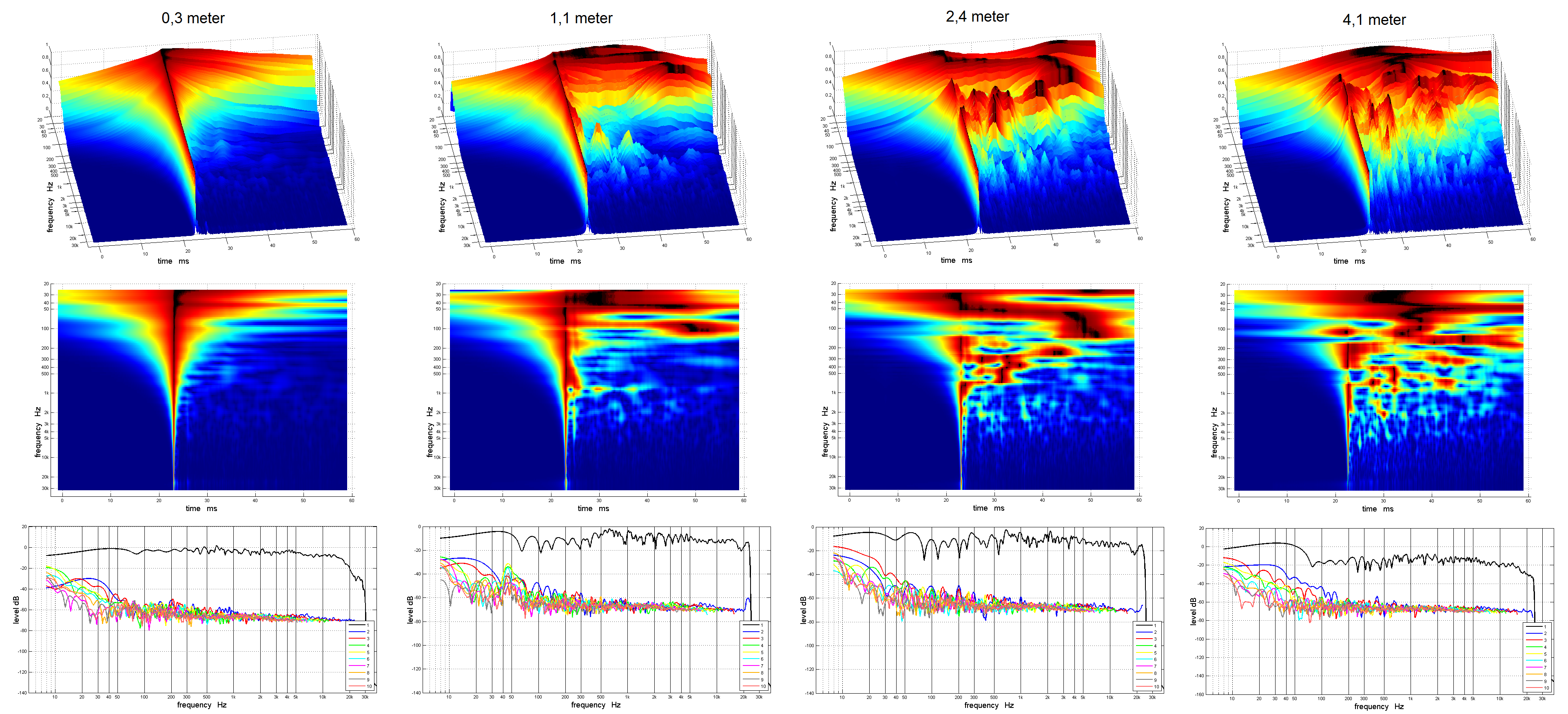

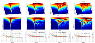

Think hard thing is how good is measurement that is base for correction and in our speaker there is two XO points and three drivers to blend in the hard to do frq area below 500Hz which makes task harder and time consuming. Think at those frq doing perfect slopes outside or in a anechoic chamber won't help much, as soon as placed in room again it will fall apart. My own two-way is corrected at 30 cm and sound crazy good there and also best sound i had subjective out in room, but must admit measurement at listening position looks bad so in future will look into tune slopes at listening position with FDW as described over in Rephase thread, have hopes for that method in that FDW filtering presents more what we hear and what can be corrected or not.
Below is not current frq response setup but very close, look the mess that happen in real room full of furniture and not acoustic optimized.
