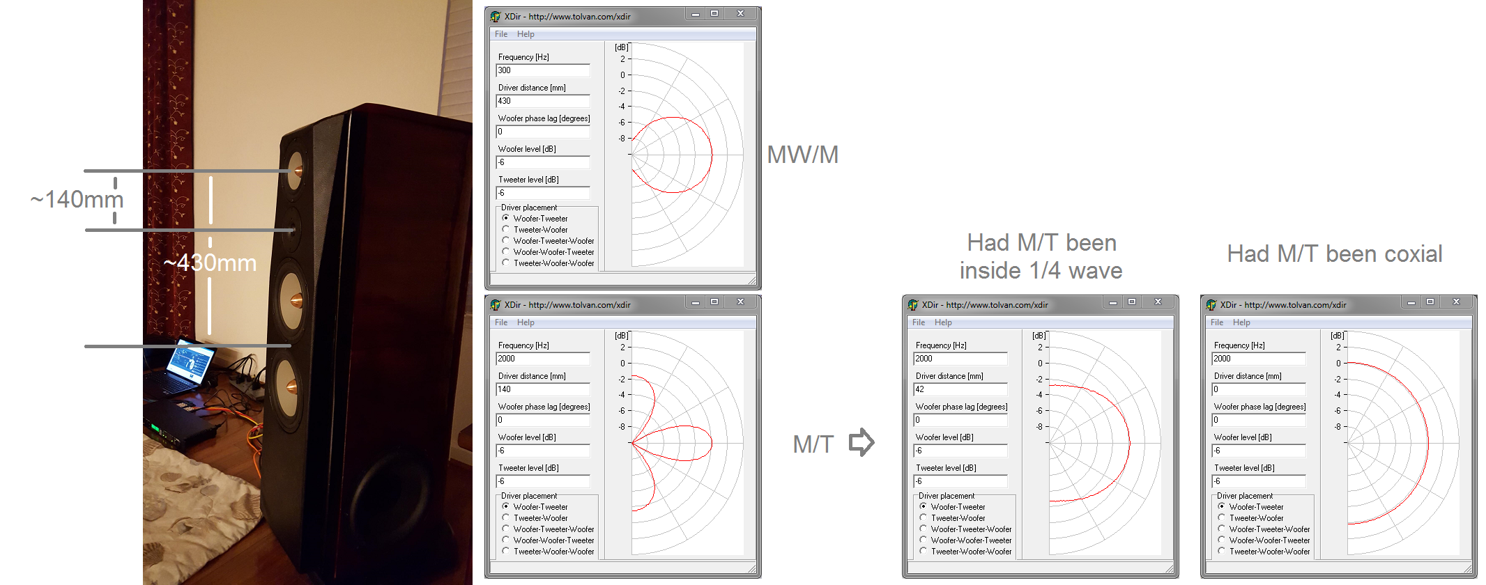

You have got a notch on the +20dB resonance? Two octaves down at -48dB plus 20dB is -28dB which is going to be audible.But i do sense something lacking in the mid tweeter integration. I recently setup an Lxmini for a friend and with just a two driver system, that speaker sounds spectacular.
The lxmini has a different sound radiation pattern to your speakers and so is going to sound different. Very broadly it should be increasing a sense of space with the increased reflections but at the expense of the precision of the stereo imaging. That it isn't to say your observations about the crossover integration don't hold but confidently separating it from the probably stronger difference in radiation pattern won't be easy.

The room has a strong influence on the sound particularly at low frequencies and so without things like multiple subs, room treatment and supporting filters to bring it under control one should probably be wary of pointing the finger too strongly at the main speakers. Nonetheless if there is a tweeter/midrange integration issue it is the sort of thing one might expect to hear through the room.the DSP-RC4 also presents a very clean and precise stereo image, though on rapidly panning stereo in a sound track, the speakers briefly become visible. But i do have to consider that they dont have a very symmetric placement wrt the room walls.
If the issue you are hearing is related to the 2 kHz 4th order LRR crossover between the midrange and tweeter then modifications to the crossover should change what you are picking up on. For the better or worse is less important than that it should change because this will confirm the source.
2000Hz XO point i would try up from LR4 to LR8 and let listening test rule which is best especially because you have FIR power to correct for the more phase turn distortion going steeper slope, reason is at 2000Hz its impossible get inside 1/4 wave ctc distance so at/inside XO region there will be a off axis error difference to a LXmini where yours will be more design axis dependent and therefor think lets get over this error and X more steep. I could be wrong so make your own mind to not steal your time but same tweak worked good for me in a 2-wayer and it maybe also help a bit for HF distortion profile.
XDir for vertical simulation is free and available at Tolvan data.

BYRTT, thanks for introducing xdir.
I have tried LR8 2K, LR4 2K and LR4 2.2K before. I think the later two voice subjetctively better. But i will try LR8 again with measurements to watch out for other anomalies
to meet the 1/4 wavelength CTC requirement around M/T, Coax appears to be the only option. I know 5E is a big fan of Coax and has developed some nice projects.
I want to try a coax at some point.
Yet, i feel a 4Way is something i want to explore.
in Linkwitz's Lx521 the 3"upper mid crosses over to the tweeter around 7.5K, ctc is hard to meet.

You right up there in frq Coax is one solution to vertical problem, i'm also crazy about Coax mod 5E did to his FST mid and expect he can sit or standup without much notice to change into frq area mid and tweeter control. A way to explore a better quality Coax driver was maybe to get a pair of KEF LS50 with driver in ones prefered naughty color and use driver for a home build exercise.
4 way is great and also lx521 at 7.5kHz works on design axis, horizontal should be fine think its mostly sit and standup plus power response that gets limit in XO region outside design axis and really nice these modern age we can control also in time domain with DSP.
Ctc distance is one of the reason myself do in full rangers as mid-tweeter, Vifa TC9FD, SS 10F/8424 and SBA SB65WBAC25-4 is great sounding drivers. Post 358 graphs is 10F and 10 inch woofer LR8 355Hz ctc 240mm, have since lifted HF extension little bit by freeze JRiver computer to run always at 192kHz (ASUS Essence STX II 7.1) so its possible do EQ in 20-50kHz area and have DACs stretch their legs. Drawback freeze it into DSP all from intput downstream to output for DACs at 192kHz is its not good as player anymore when files are lover rates as CD's are missing some natural DAC filtering. So now use another computer where second allowed JRiver license play files with native sample rate so DAC's digital/analog filters is present. Feel more comfort now as time go to control JRiver and Rephase so next exercise to learn is pair a 5 inch 5FE120 and 15 inch woofer to that 10F mid tweeter, should be possible get all three inside 1/4 wave even 1 octave above real XO point and is curious to hear such coherent data on paper in reality.
