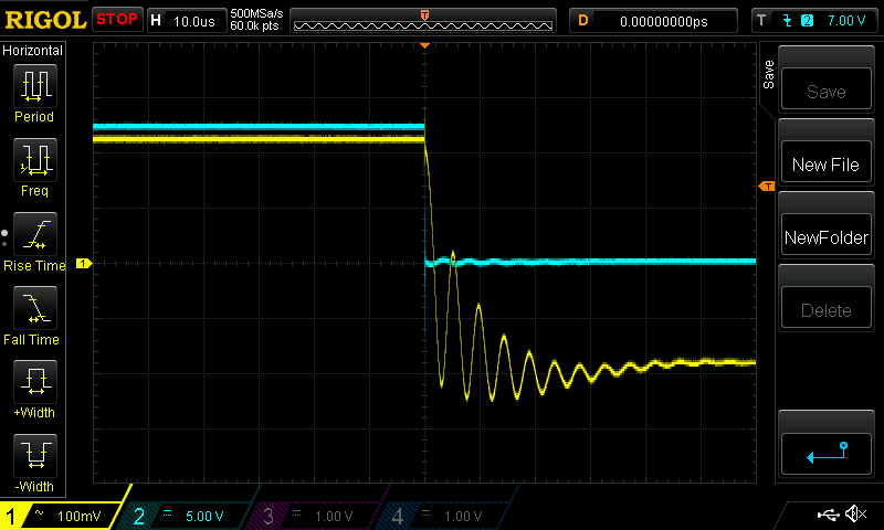

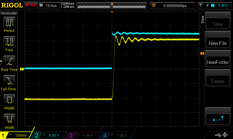

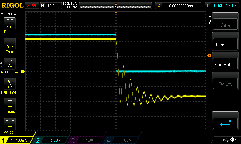

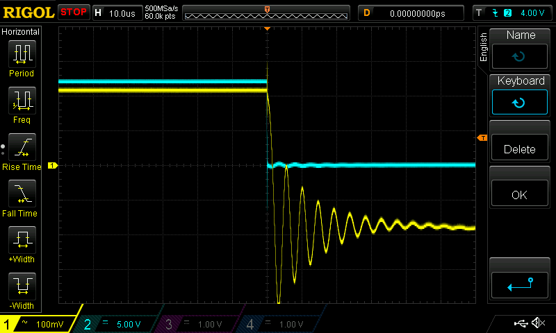

Okay so I am at a bit of a loss...
Are the scope shots above really merely showing me the impact of the trace inductance in the board, output caps and, much more significantly, wiring to and from the chop chop box and load resistor?
Is the latter completely obscuring any further analysis? I see the same thing on my scope screen even when I power the op amp and Vref from Vout.
Do I simply take some comfort that it didn't go completely unstable and move forward or do I have a real circuit problem (and perhaps should ditch the entire project!)?
I can model the circuit and see good phase margin, good transient response (except for the impact of output cap ESL) etc. But if I put it on the bench and can't see through the test setup wiring inductance I'm unsure what to do next.
Capacitance at the load should bear the brunt of any transient current needs...
I can tweak the board's output capacitance (smaller caps in parallel for better impedance profile, or even make any further iteration of the board use 2.5mm spacing output caps for lower ESL) but can only do this based on desktop modelling rather than observing the impact in the physical circuit. (Powering Vref and the op amp from Vout will provide a good deal of efficiency in any further board iteration as well.)
Argh...
:wchair:
One way to get a clearer picture here is to measure with the scope probe directly at the point on the board where the error amp is connected, so across the two resistor divider that sets the feedback to the - input.
If that is very different from what you measure across the load, you know that at the load you see the impact of wiring etc.
When you measure at the load, try to connect a good cap directly across the load across the same points where you have the scope probe. Only then do you measure the supply as the load sees it.

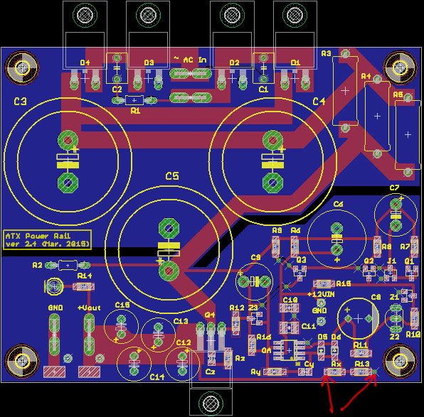

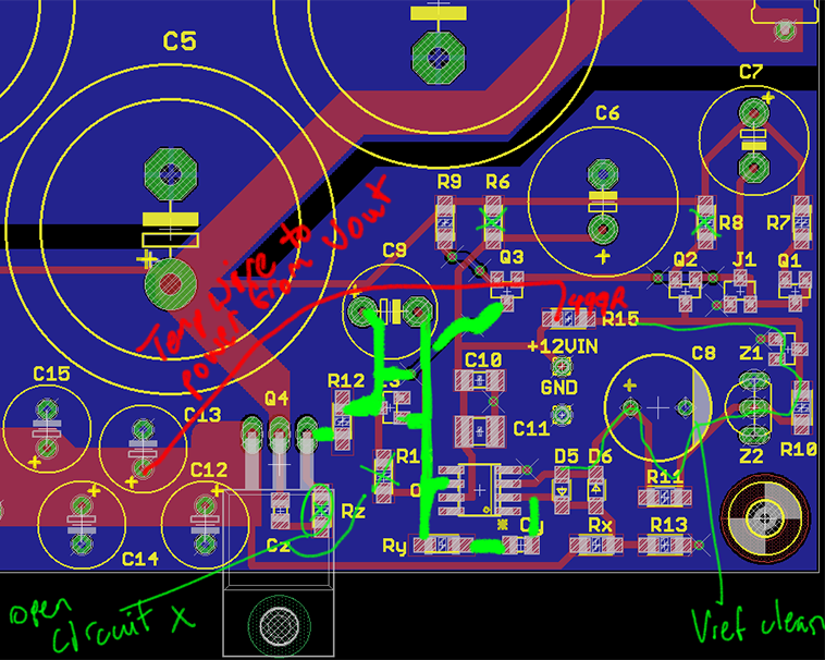

Thanks Jan. Where I have marked on the attached image?
Jan
What would, in your opinion, constitute a 'good cap'? I'm measuring right at the pads below the fasten terminals, very close to the board's output caps.
Doesn't temporarily adding a cap just shift the resonance frequency lower? Remove it and it goes back again?

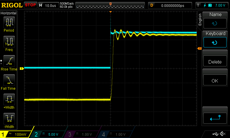

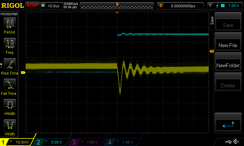

Thanks guys. I was measuring at the pads under the fasten connectors at the output of the regulator board. (Bottom left of the image in post 503.)
After reading the above comments I took a series of additional scope snapshots probing various other points in the circuit. Please see attached.
(All of the positional comments should be read in conjunction with the board image in 503. I will try to be as explicit as possible.)
This is with the rising edge of the stimulus and was taken at the anode of Z3 i.e. basically the output of the op amp. The GND spring of the probe was sitting in the GND pin connection to the lower GND plane to the right of C11.
Same as above but falling edge of stimulus waveform (i.e load off)
Probe at left edge of Rx; ground spring at the via to the lower GND plane to the right of R13.
Same as above. Falling edge of stimulus.

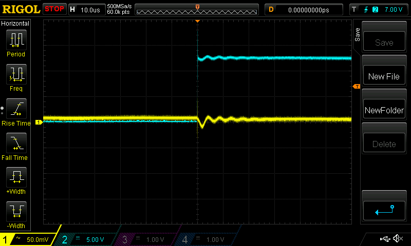

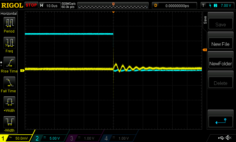

Probe at the GND pin of the op amp (pin 4); ground spring of the probe at the GND pin connection to the lower GND plane to the right of C11. Falling edge.
FWIW this surprised me. Both probe and spring at ground. Same thing if I connected probe and spring to ground at various other points in the circuit e.g. the via to ground between C10 and C11 and the pin connection to the lower GND plane to the right of C11.

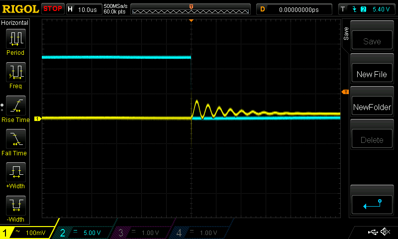

As above except probe at the unconnected pin 1 of the op amp.

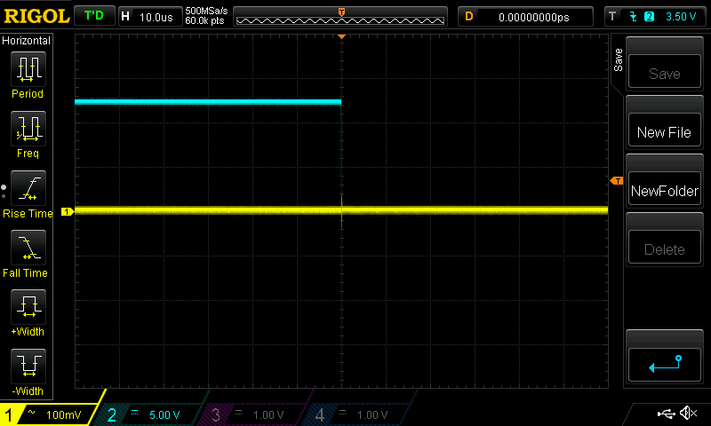

How are the grounds of your two scope channels organized?
Is your scope earthed, and is there another PE connected on your system?
How is the waveform if you connect the tip and ground of your probe to exactly the same ground of your prototype?

Hi. See post 492 for a pic. Channel 2's probe is connected to the chop chop box with it's GND connected there as well. I trigger from Channel 2. Channel 1 is probe and spring placed on the reg board.
My scope should be earthed. It is a standard UK 3 prong plug into a 5 socket extension (in turn connected to wall socket).
Another PE?

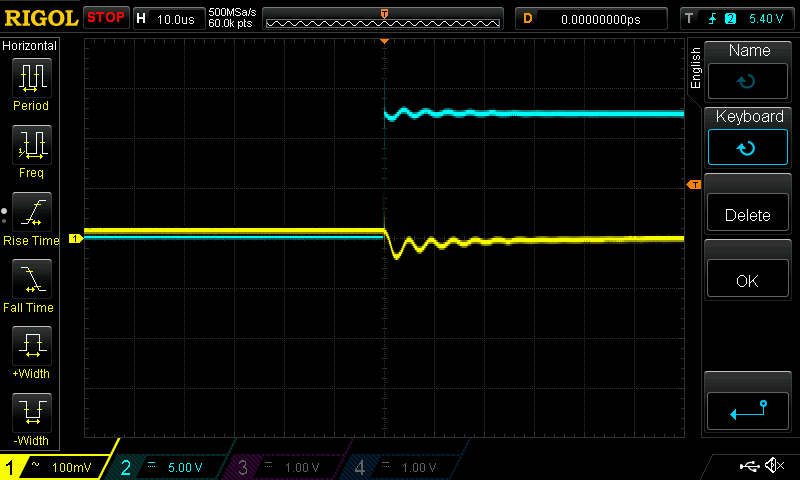

See attached three waveform pics:
1. scope channel 1 probe sitting idle on desk
2. GND spring only placed on GND pad at output of regulator (probe tip in air)
3. both spring and tip placed on the same pad
Well, that's probably the main cause (if not the only one) of your troubles:
The ground connection of the chop-box is subjected to the current transients, and the resulting voltage is applied between the grounds of your two probes. They probably drop each a more or less equivalent voltage, and most of this voltage appears on the inputs, because of the finite coupling between the sleeve and the inner conductor and the non-zero screen cutoff frequency.
In such instances, you should ground one channel only, the most sensitive one, and leave the ground of the trigger channel unconnected.
When you absolutely need two sensitive channels with two different reference potentials, there are remediation means, but here you don't need them: just eliminate the ground loop.

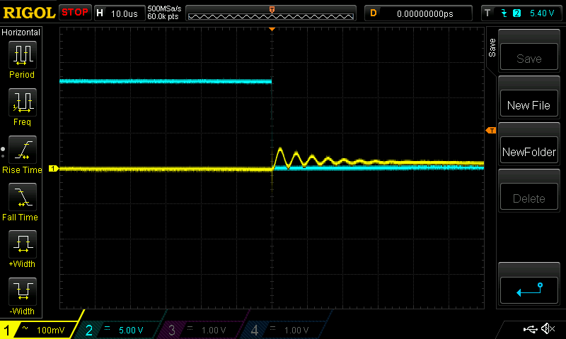

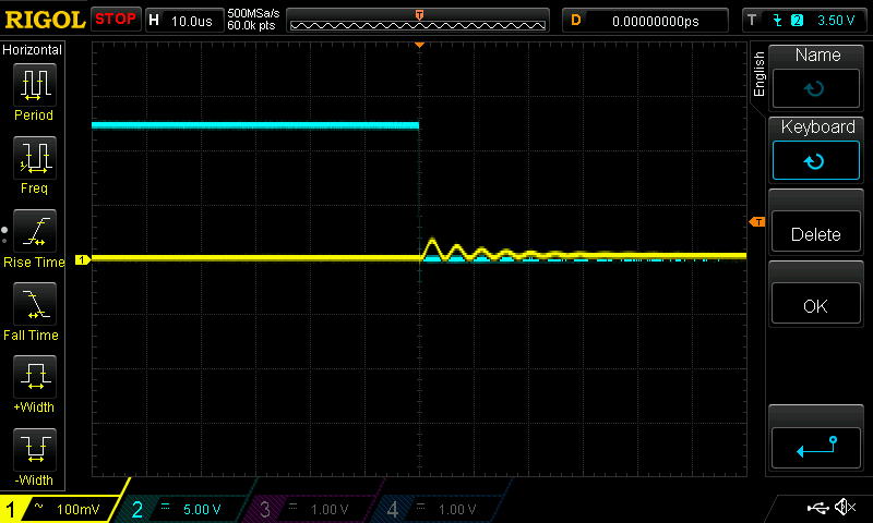

From your third pic, it seems you have a problem with the PE, or at least a common mode one (I assume the channel 2 is completely disconnected)
For a moment I was thinking it was that simple. I removed the alligator clip from probe 2 and everything looked rosy. No oscillation at all. I thought I was home free....until I thought about it some more and realised what I was seeing - no trace of transient response - couldn't possibly be right.
So I went back and did everything again. No easy joy.
First two pics are from the op amp output, rising then falling load (100mV vertical resolution). Next two are from the pads at the output (50mV resolution). Last is the from the output (rising load) at 10mV per division.
Oscillation still appears to be around 220-230kHz.
(Note, I still have the board rigged to power the op amp and Vref from Vout.)
I still had channel 2 connected to the chop chop box and was triggering off this.
Back to loop issues then: 220~230KHz must be the unity-gain frequency
Yup. At least now I am now more clearly seeing the impact of changes to circuit components. Thanks.

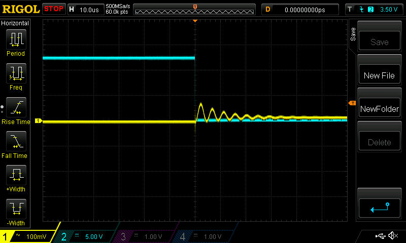

I embedded in the board layout a couple of tools to play with. (1) Zobel, Cz and Rz, from drain to gate versus (2) gate stopper resistor R12 and (3) compensation cap Cy around the op amp (from the inverting pin to output) and (4) resistor Ry in series with Cy.
You commented with respect to (1) and so recently I have used a gate stopper resistor of, currently, 47 Ohms. What I find very odd thus far is that I can change the level of damping by adding resistance in series with my compensation capacitor, but altering the size of the compensation cap Cy (none->47p->100p) doesn't seem to change the frequency of oscillation. In contrast, the LTspice model suggests a UGF of 1.2MHz with no Cy and 212kHz with Cy=100p, i.e. rather significant impact (and decent phase margins in all cases).
For example, see the attached 3 scope shots measured with a falling load and at the op amp output. All 3 are with a 47R gate stopper resistor. The first is with no Cy compensation. The second is with Cy=47p and Ry=7.5k. The series resistance would seem to dampen the oscillation but it seems about the same frequency. The third is with Cy=100p and Ry=0R jumper. Ordinarily I might conclude from this that compensation of the op amp is unlikely to cure the oscillation. I'm going to try increasing the gate stopper resistor and see what what impact that has.

I don't see any oscillation, I only see ringing. You abrubtly change/cut a current in a circuit with inductance and you get ringing. Its called dI/dT. The giveaway is that it dies out.
It is directly inproportion of the current rise/fall time dI/dT.
This is not a circuit problem; it's a measurement problem. You keep measuring unrealistically and you will keep seeing this. Nothing to do with the regulator per se.
How then to measure realistically? For those first two pics I was placing the probe at the anode of Z3 and the GND spring at the via to GND sitting between C10 and C11. (I get the same if I (gingerly) place the probe on the op amp output pin and the GND spring in the via to GND at pin 4 of the op amp.)
I don't want semantics to be a problem. Forgive me if I use improper terms. Perhaps I should have said 'damped resonance'.

There are three basic paths to the MFET gate: (1) via the op amp output, Z3 5V level shift (LM4040) and C9, and R12 the gate stopper; (2) around the op amp via Cy and Ry and onward as in (1); and (3) from Q3 and the current mirror. The fact that a resistor at Ry partially dampens the resonance would seem to suggest that (3) isn't the source of the problem but perhaps I am wrong? I guess I could lift Q3 again and drop a 1k resistor back in as a test.
